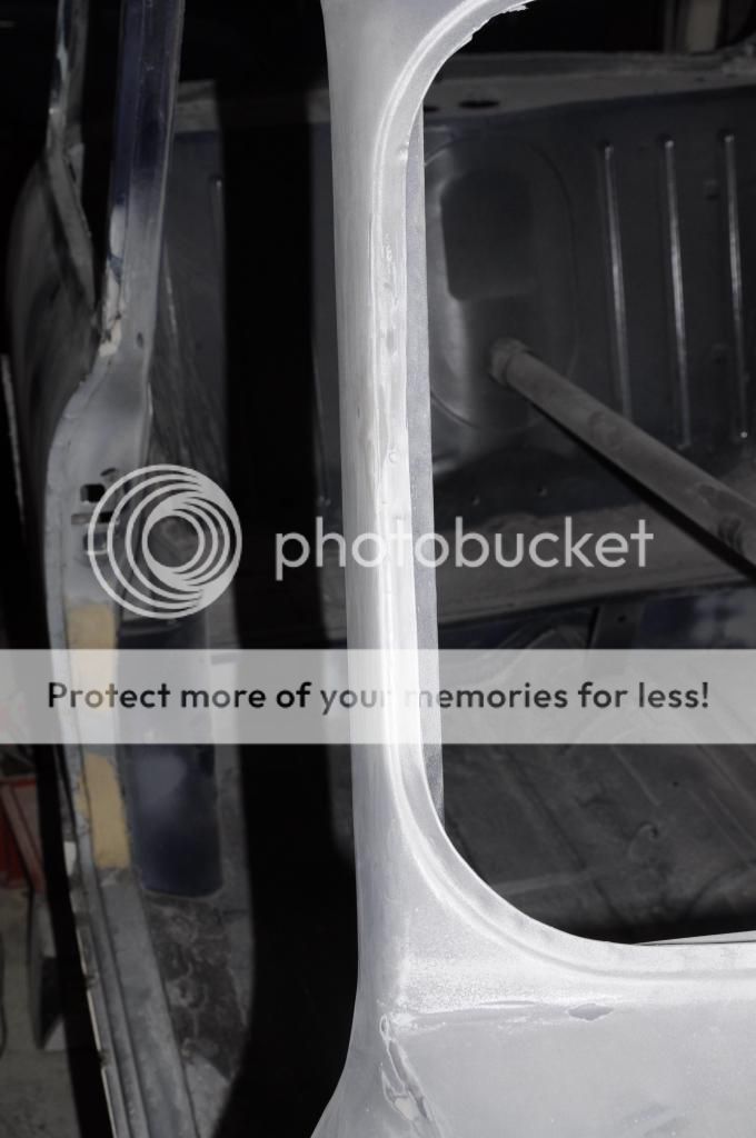

I've been down and taken some proper pictures with a proper camera!
I've decided my phone makes the car look better than it it, but the camera seems to make it look worse!
It's coming along

Posted 20 February 2014 - 06:33 PM
Looking good mate, getting to the exciting bits now.

looking really good mate! you gonna make minis on the rec 20th July near Brighton?? ;-)

you done some great work on the deseaming there :-) I'll have to make sure i make the IMM
