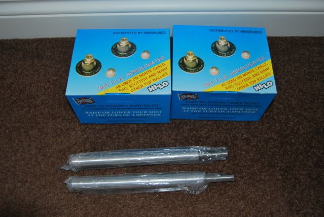

Look what arrived today. Damn, I love parcels! :thumbsup:
Yup yup, HILO's. Fully adjustable, need to find my new rubbers before I tackle this one :wink:
Cam followers also arrived. Time to get cracking :D
