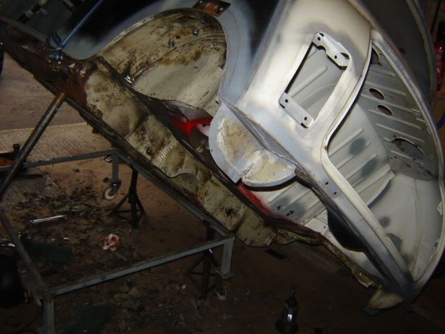

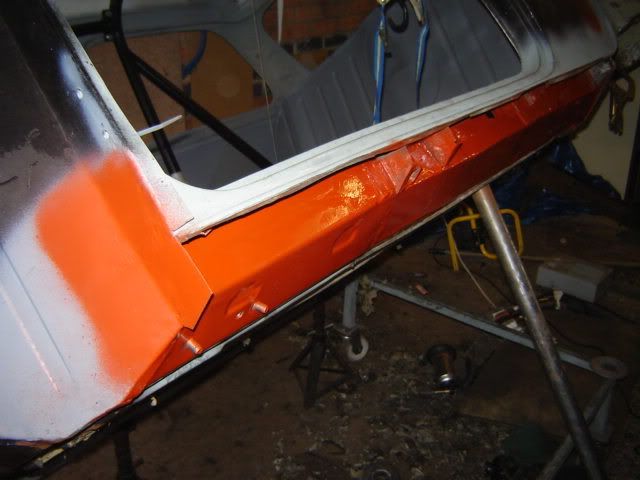

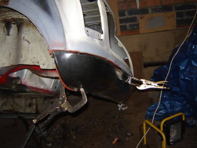

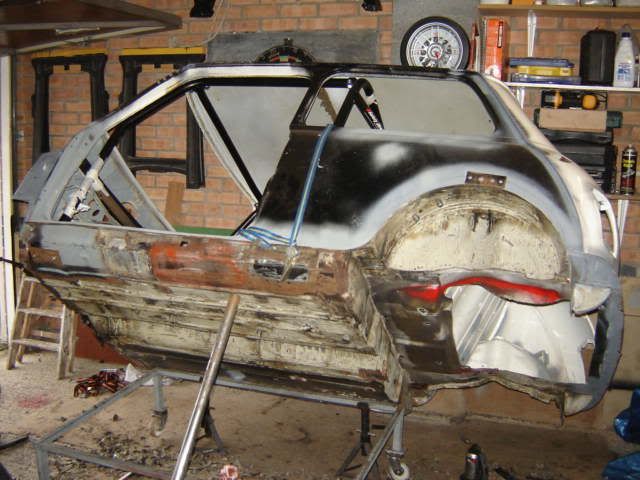

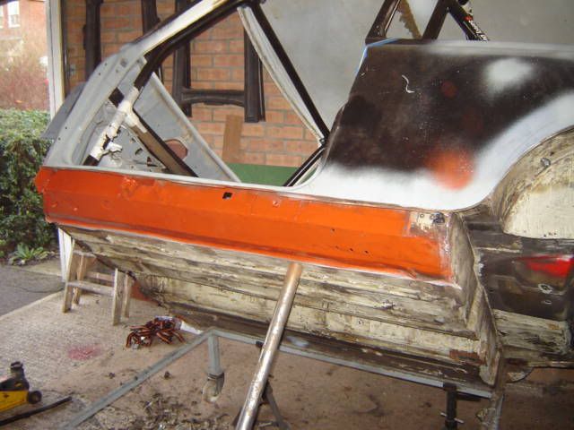

well i had a busy weekend on the car and can now say i have finished all the repair work welding now so its onto panels in a while. i still need to dress a load of welds that i did on the car and also prepare the sills so they go on nicely but thats it!
so i hope to get that done by the end of the week end and its then off to the sand blasters!
i also scraped off all most of the undersill, thats a nice job! NOT. need to tip the car up the other way to finish that!
i spent this evening with the dremel smoothing all the internals of my block, i can now say that the oil is just going to glide staight back into the gearbox so easily! looks trick but you will never see it!
so here are some pictures

Posted 09 January 2007 - 07:01 PM
use a grinder with a wire wheel, its will get the underseal off so easy, i did the whole floor and arches of a cooper s at work in no time back to bare metal, comes up much nicer
#523 andywaller
andywaller
  • 1,636 posts
Posted 10 January 2007 - 08:00 PM
yeah the whole floors going to be sand blasted so it will all go anyway, just needed to get the worst of it off.
