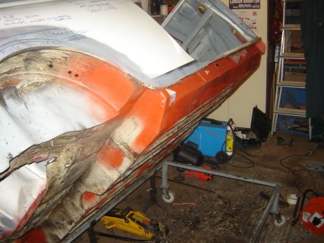

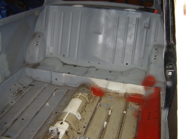

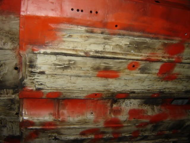

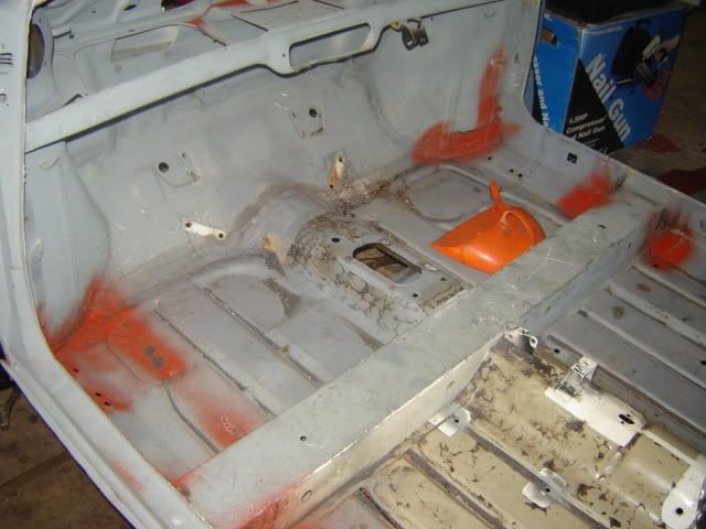

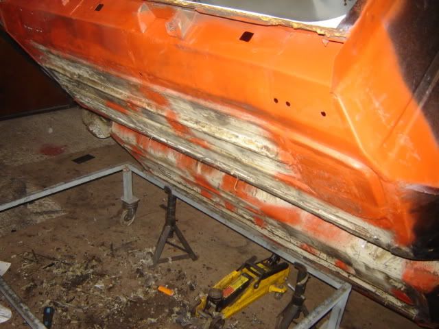

well im getting somewhere with the shell now
all stonechip is removed
welds are ground back

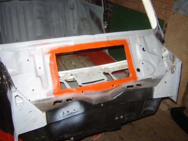

baulkhead cut for box
boot floor is on its way
i now only need to gring of the old sills and its go go go, so this week i shall book it into the sandblasters for the end of the month once i have been payed, so this gives me untill then to sort out the sills, wire brush the underside and cut the boot floor so the carbon one fits!

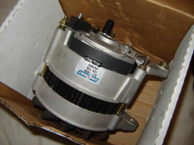

ive got my hands on a new altenator now which i am going to take to bits and polish.
my mate is going to make me a baulkhead box aswell.
engine wise im going to be getting a very nice head done for me and im going to be using a weber, swiftune are also going to swap my sw5 for an sw10, ive been told i should get 120bhp with my new spec. which is going to be cheaper and im almost garranteed that power rather than a guess with the 7 port.
here are some pictures then
and this was really satisfying to cut in, it was the start of the work im going to enjoy!!
