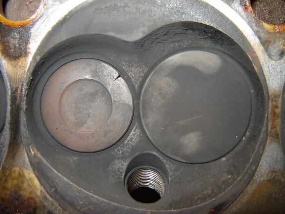

i have found 2 reasons for my minis poor performance over the past couple of months before i took it of the road! i am surprised it ran as well as it did now.
1st when i looked at the head gasket i noticed that bores 2 and 3 had not sealed properly and the major thing is that there is a massive great crack in one of the exhaust vavles, i have never seen one like it before!

wow :|
thats not a crack ,its a burn valve .
carl
#115
Posted 28 March 2006 - 06:50 PM
carl
yeah took it into work today and that was the general thought, they say it could be caused by the valve clearance being to small(i didnt set them they were done at a garage)

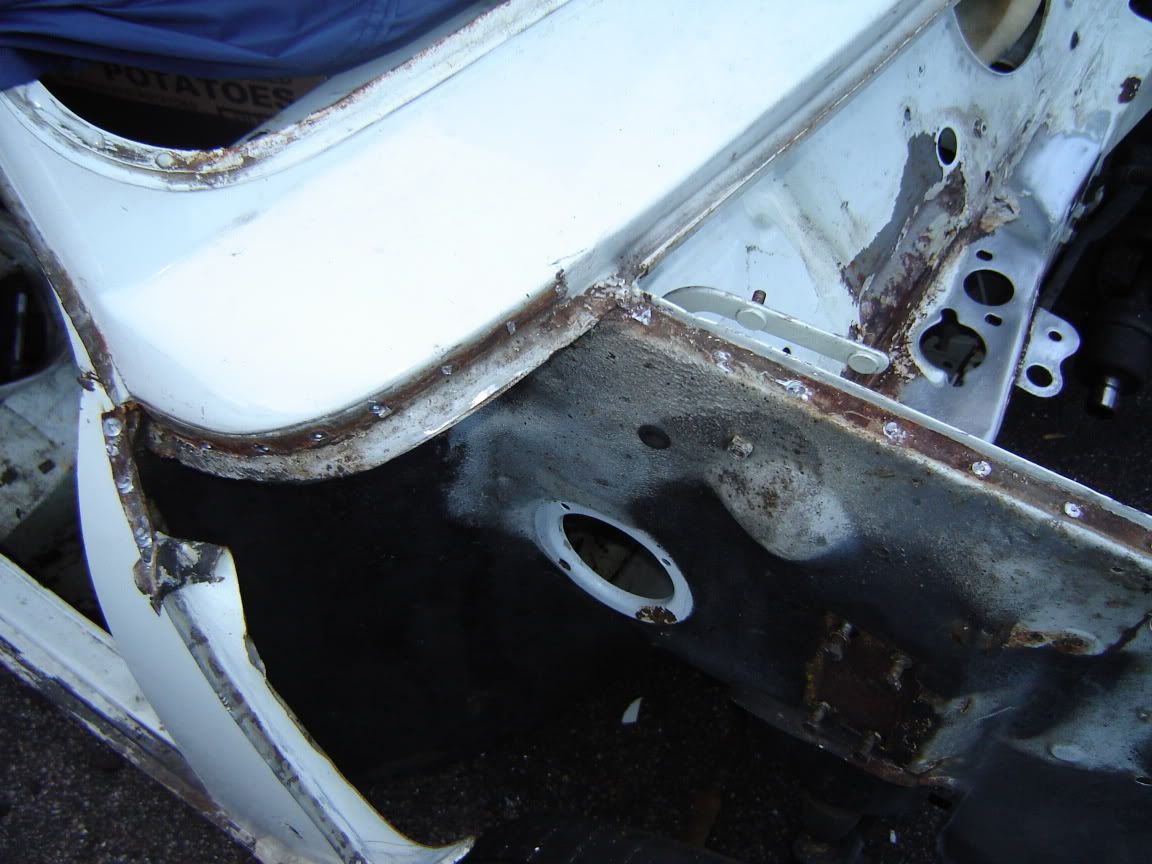

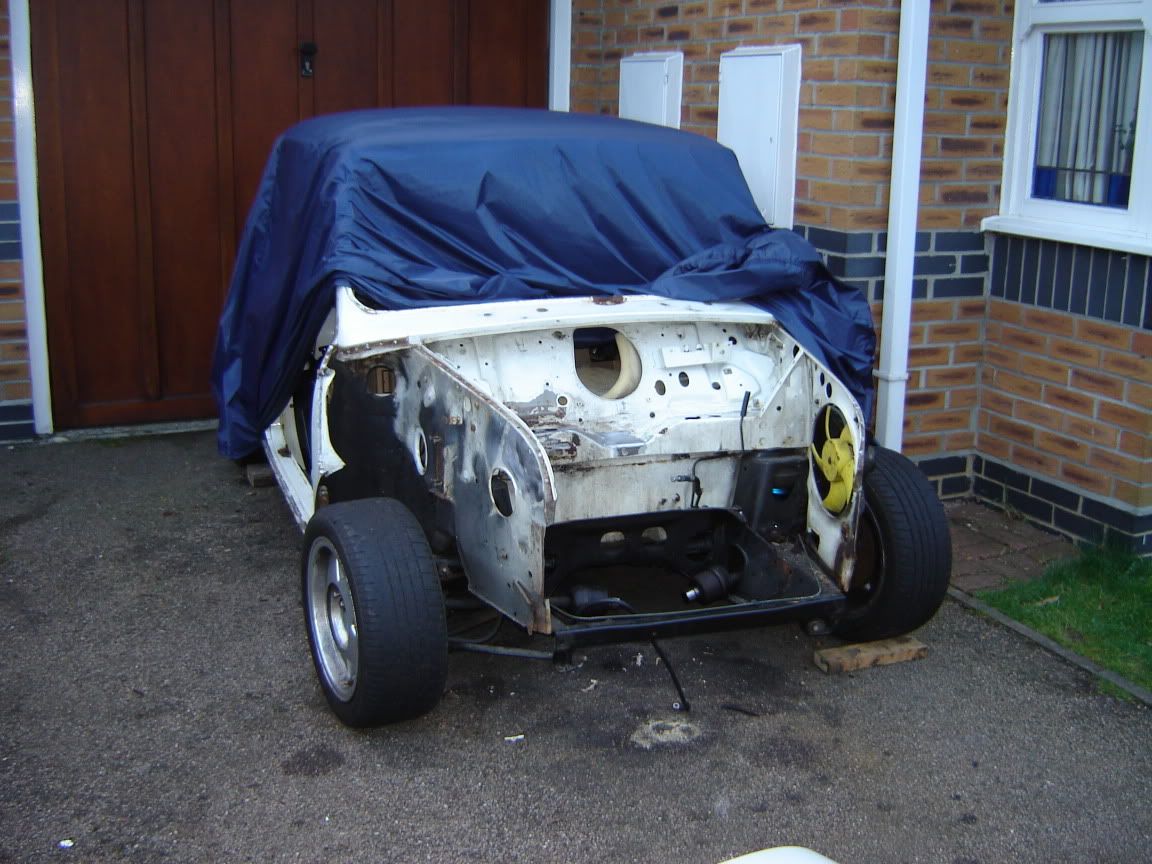

i have started drilling out the spot welds along the wing seams and scuttle, i have also tried out some paint strippers that i bought as i want to take the whole balkhead and inner wings back to bare metal. i will then stone chip the lower balkhead and inner wings, and seam seal all the joints on the upper bulkhead. i will also be treating them with por 15 and 3m zinc primer. i hope this will give a good clean looking finish.
i will also be taking off all the unused brakets in the enigne bay and welding up unused holes. this should look decluttered so the engine can be appreciated more.

wow ur mini is coming along nicely! it looks fab
hehe i noticed the mcdonalds box is that off ur richard?
#120
Posted 30 March 2006 - 08:17 PM
yeah i got rich to bring back a load of boxes, got loads in my room too with all the new stuff i bought!
