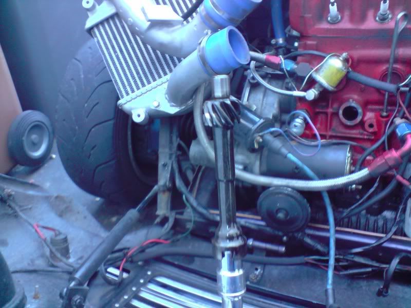

first job was to remove thy old distributor
and the gear it drives. i left my magnet at work but luckily a socket fits the end!
