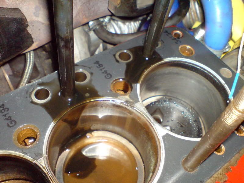

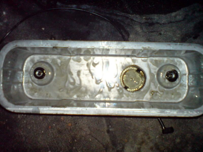

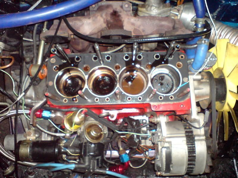

right now, again i was on the motorway, giving it abit of stick, and hear the tell tale pinking noise. i back off and get off at the next exit, only to find a roundabout beggin to grace my wonderous rubber. pooof! white smoke belows out the back. poo. thought bugger it, i'll just get home as i'm not waiting 2hours when i only live 10minutes away. that was yesterday. took head off when i got home from work, and its blew in the same place on cylinder 2 in the water passage. so with the head off i thought i'd get some measurements of the size of the dishes. just roughly it looks like its 21cc, which i think is standard so my compression ratio must be higher than i thought! will calculate the compression ratio tomorrow as i'm too tired now.
on a lighter note i manage to get hold of some 1.5 ratio full roller rockers for a price you wouldn't believe.........free! they are second hand and have quite a bit of wear in place but all the important bits are in good nick

right, accurate measuring of the head chambers revealed that they were indeed standard cc (21 ish). this made my compression ratio around 9.5. standard metro turbo has 9.4. so not a great start! currently i have modified 2 chambers to around 23cc, but i plan to take them all to around 25-26. this should lower my ratio to somewhere around 8.6. which means i can run more boost, which makes more power!
