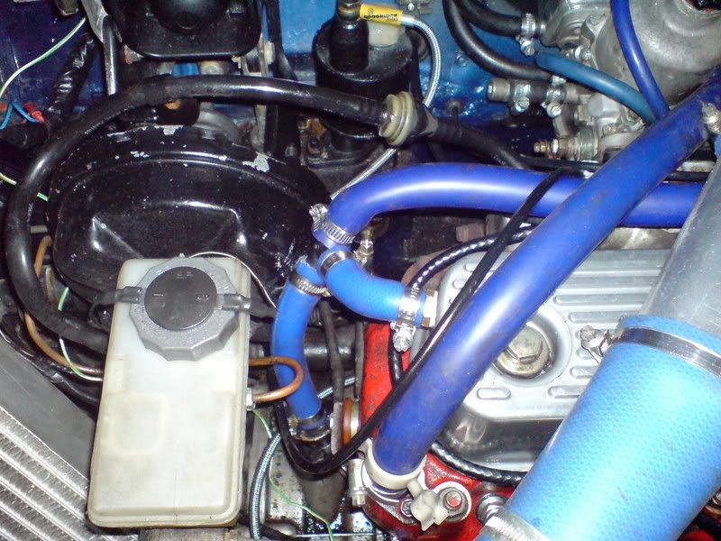

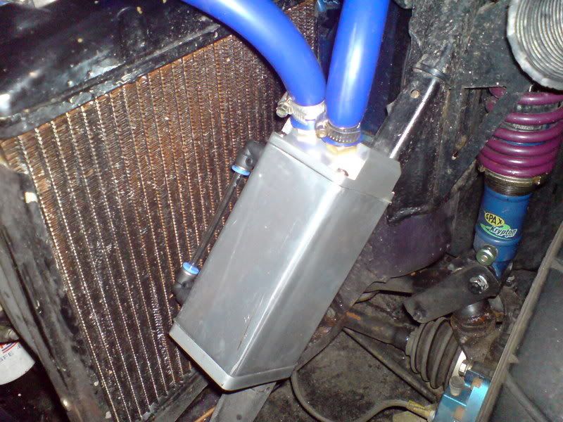

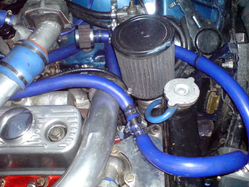

well i have been enjoying it so far! she has got a few mile on her now. had a few problems with batterys and alternators, but new ones solved that problem. shes travel to blackpool and back twice, going strong. snapped the front engine steady bolt, so a new one was used. also fitted a rear engine steady. also oil found a nice way of leaking out the oil cap, dipstick, and out of the breathers. i've fixed this (hopefully) by fitting a oil catch system to the engine. aswell as using both standard breather points, i drilled and tap a point into the rocker cover. the zip ties are only there for a day till i can get some jubliee clips.
