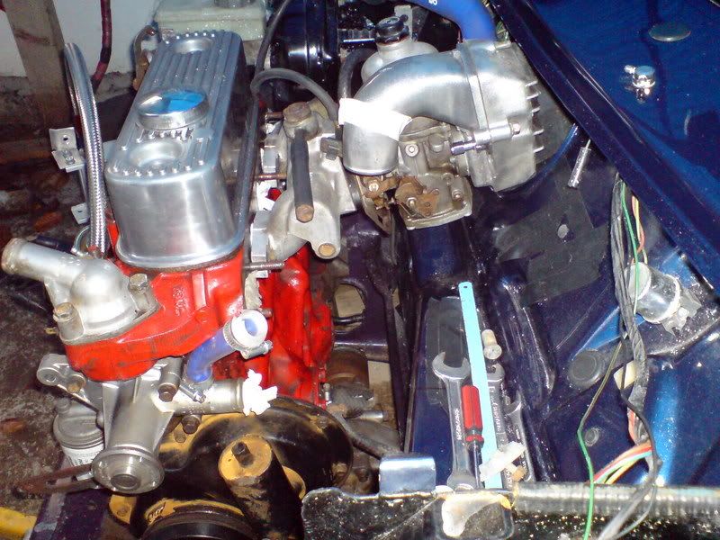

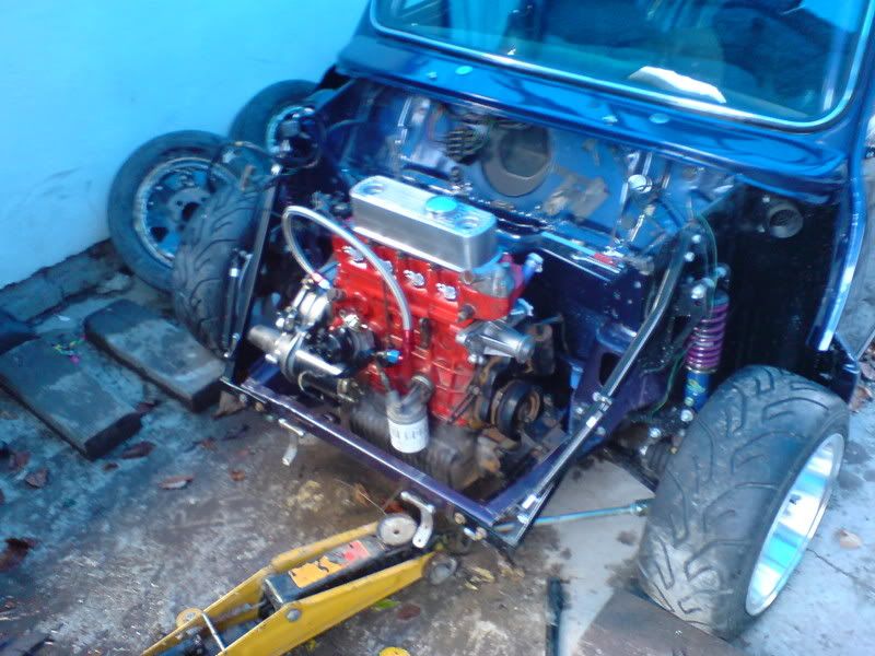

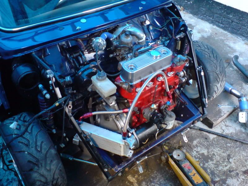

slung the engine in to see where i need to cut for my turbo box. while i was there i mocked up what it will look like.
have almost cut the hole, but it was raining in the afternoon, hope to have the turbo box welded in and primered by next sunday.

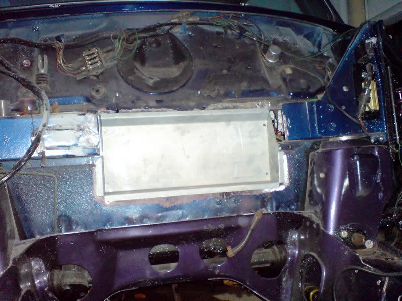

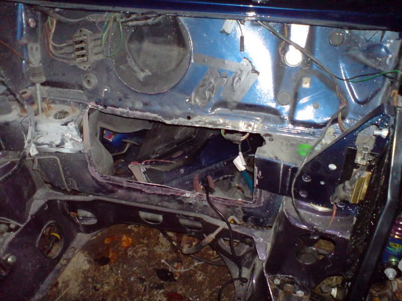

Posted 08 December 2006 - 10:16 PM

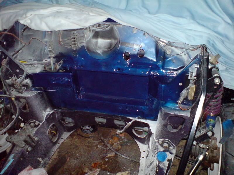

a wee bit of progress, finished the hole in my bulkhead. the box sits in nice and snug now, should hopefully have it welded tomorrow afternoon if the weathers good
before
after
and how it fits

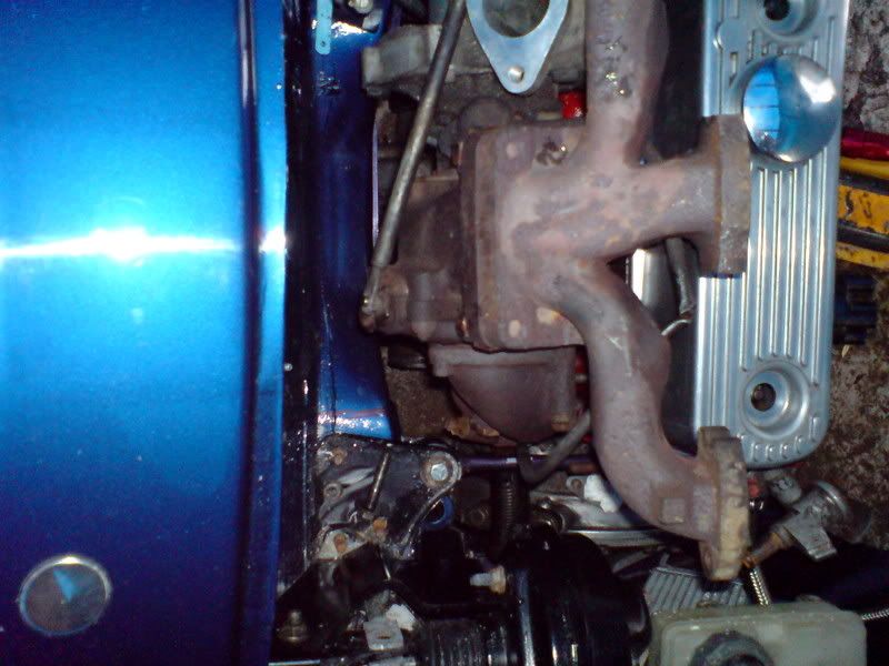

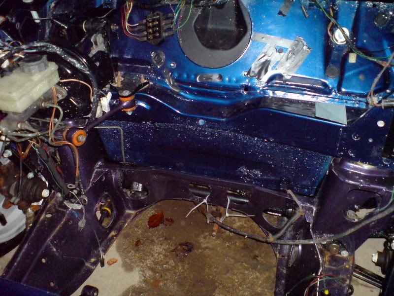

got the turbo box welded in and painted. i know i rushed it, and it would have looked better if i took my time, but most of it will be covered anyway! picture was taken while it was still wet. the colour match won't be perfect as i did this using rattle cans.
thats it for now

only proble with the turbo box was it was a bit too long, so when i came to cut the 45o into the cross member for the small plate, i found it didn't quite fit, but i used a bit of old metal for it. hopefully thats the body work complete!

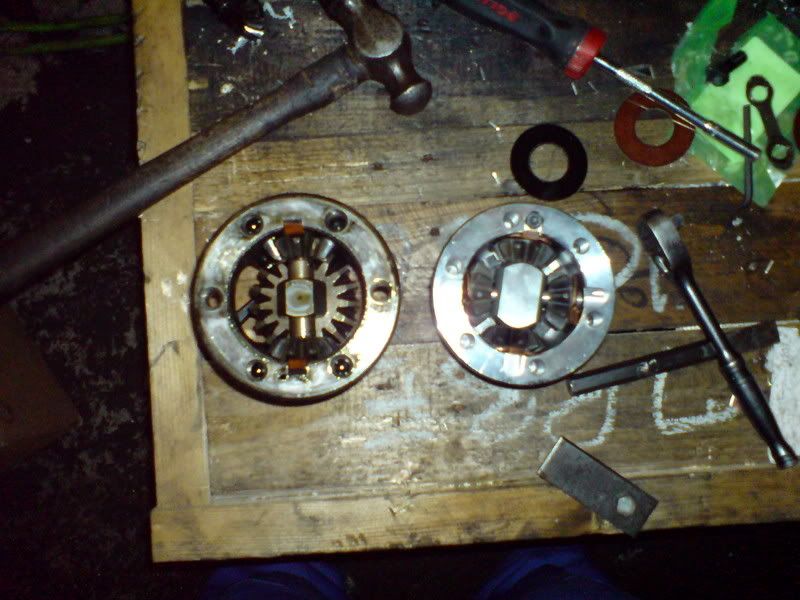

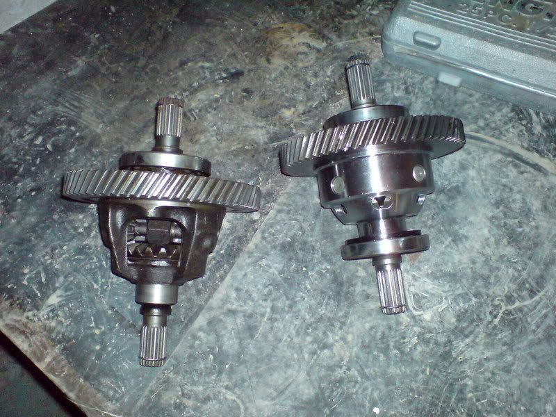

anyway, spent money i didn't have on a new cross pin differential from minispares! built it up today in work :gimme: , and plan to put it in the box tomorrow.
comparison to standard differential
hmmm i wonder which one i will fit..... :crazy:

for someone that has never taken a diff out of a car
which ones which :D
