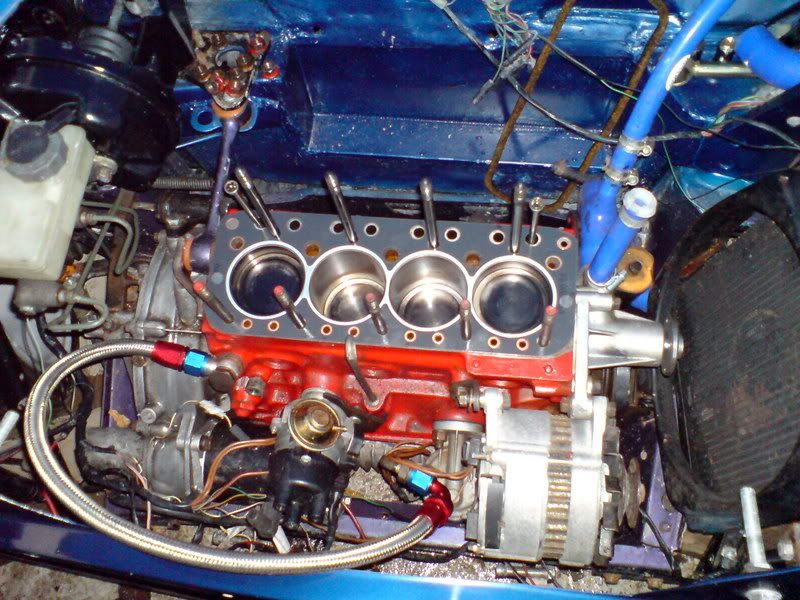

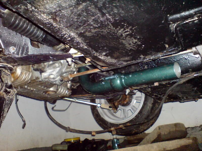

and the only other thing was to fit the turbo down pipe, which i struggled with for an hour! but its on now
and a random image of the car in the air

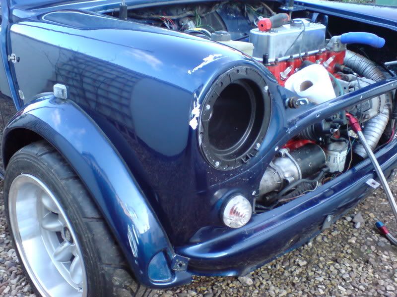

complements for your hard work and beautifull car. Seems like a nice paintwork.
I'm wondering if your flipfront-hinges wont crack the new paint when you flip. Did you make any strengthening at the inside of it?
Does the new bumper covers the skrews and bold wich are visible from the front?
Keep up the good work!

and onto the hinges, they are to be honest C**p. the whole front was bought from minispeed as a kit, and the hinges i got were straight ones. so i had to bend them myself. in the future i plan to make some more robust ones, and i'll change the support method, so i can lock it open.

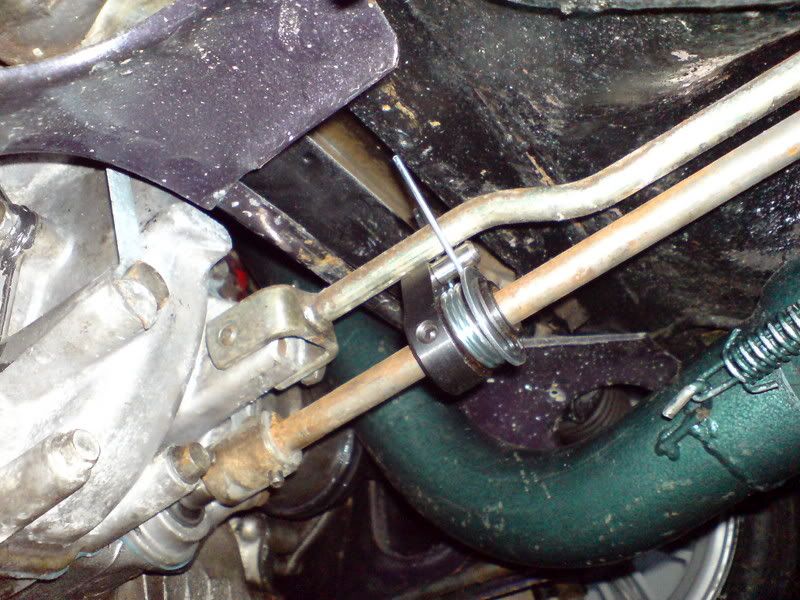

now we all know the mini shifting mechanism on a mini seems abit loose and well sloppy. i will be getting a kad shifter to help but also i am trying this minispares slick shifter. it certianly makes a difference, for those who don't know what its for it is basically a spring used to center the gear stick in neutral right between 3rd and 4th. it was originally created for 5speed gearboxes to prevent 2nd to 5th shifting. gives it a more modern feeling.
#130
Posted 15 January 2007 - 09:52 PM
i have one fitted to my mini and yes it does take out the slack and make it feel like a modern car

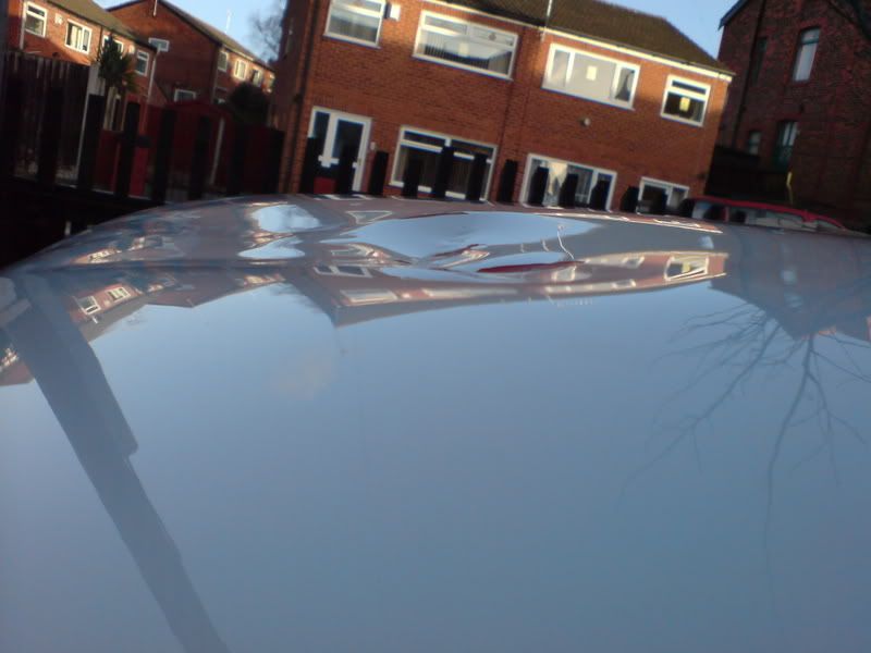

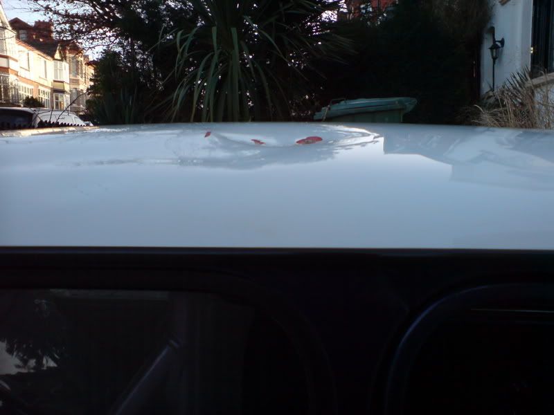

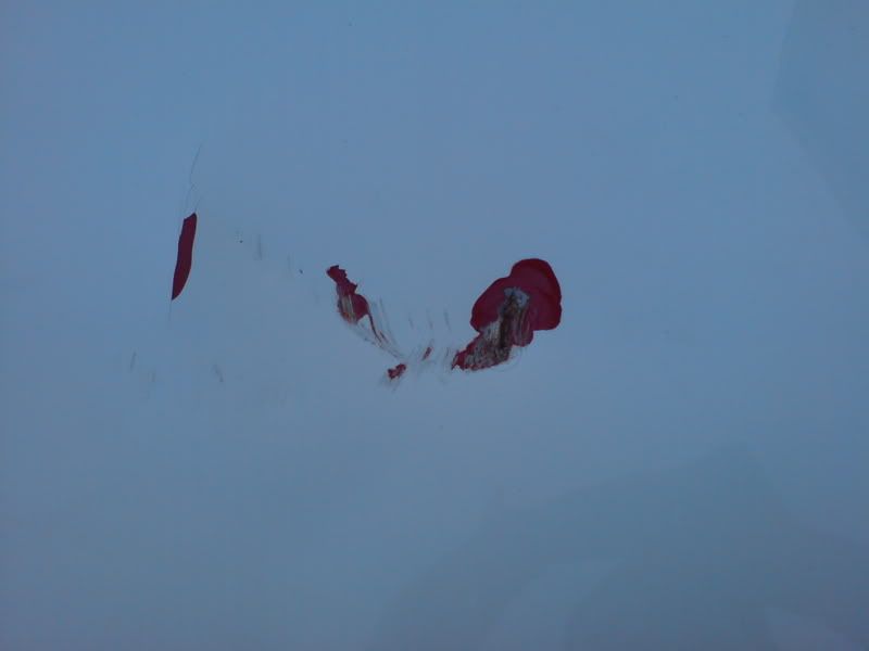

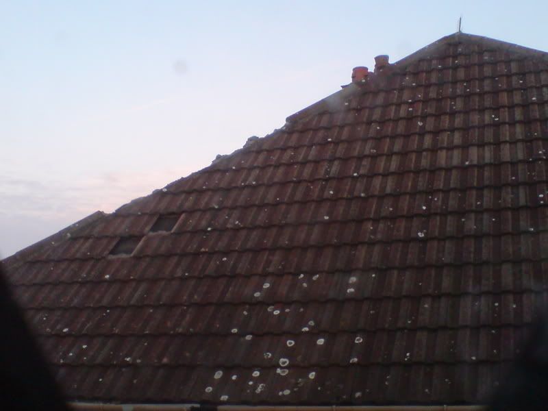

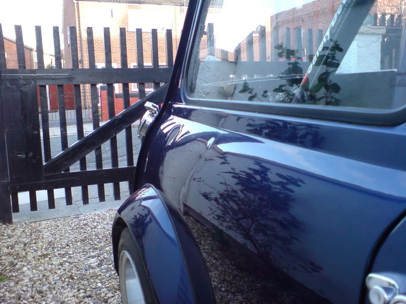

here is what hit (this one took out our fence)
and this is how their roof looks!

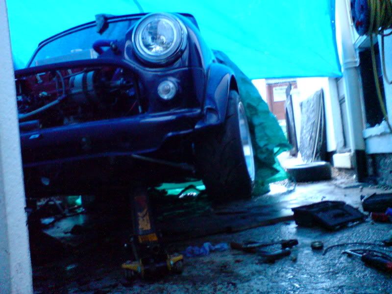

unfortunately house insurance doesn't work like car insurance, so if we wanted to claim it would be on our own insurance, which we may do to help lighten the load on paying to fix it. now i could march round there with a bill saying pay up, but i know they would say no, and i'd take them to court and blah blah blah. it would just escilate (spelling) and we would probabily end up paying anyway! so i'm getting the bodyshop to pop round and give me a quote on how much to fix it next weekend, and i may get a professional dent person round to smooth things out! here is some better shots of the damage.

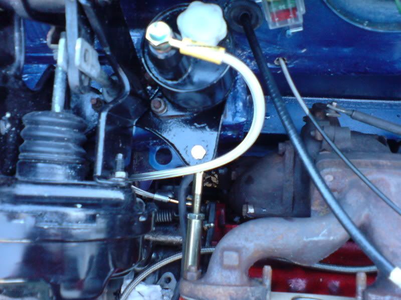

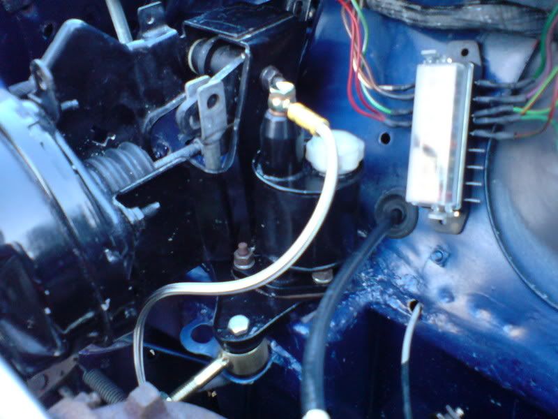

right so with that out my mind for now, i have done abit more work on the bugger! clutch master is now fitted and plumbed up, with a new goodridge stainless steel braided hose. the feel of the clutch is nice and strong! and adjustable engine steady has also been fitted, so i can adjust the engine position if i need to!
