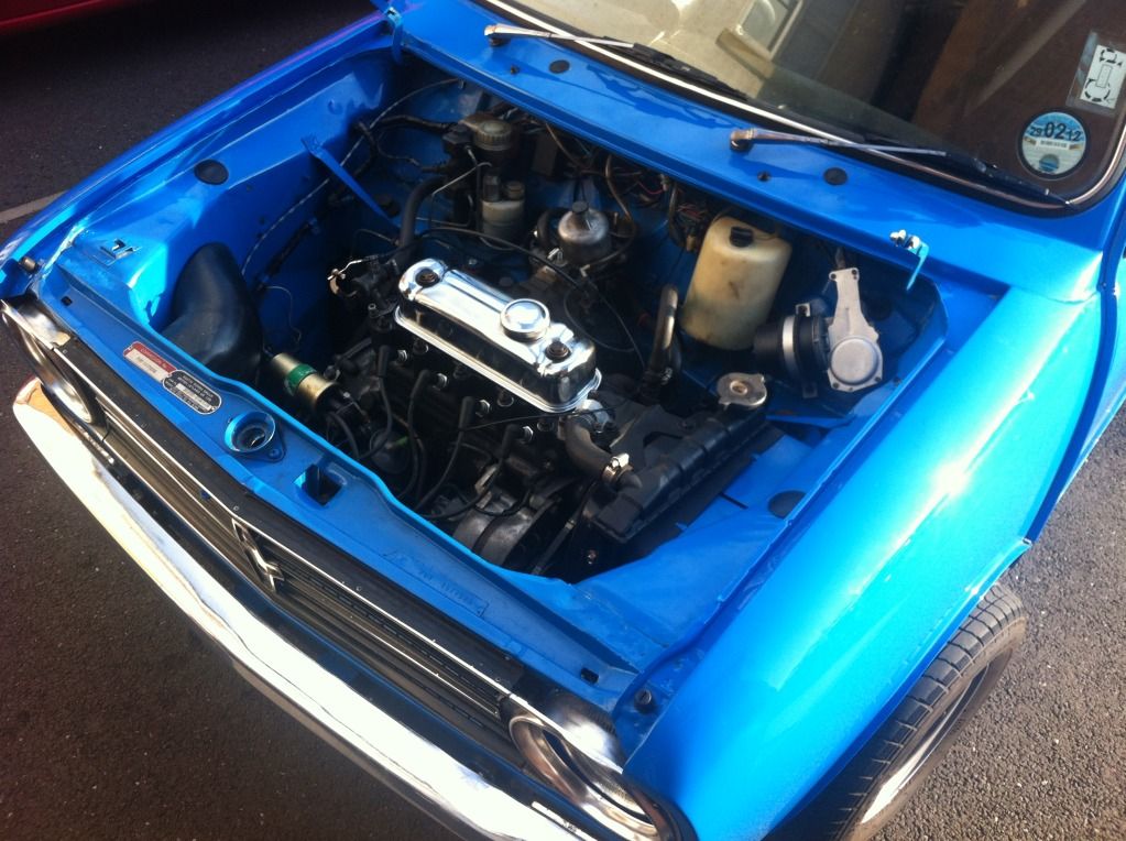

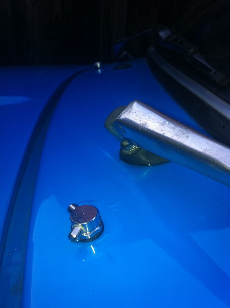

and these, they actually spray water on the screen, what a luxury, the originals just hit the wiper arms, was terrible!
and finally a quick under the bonnet as there isnt a pic as yet of under there

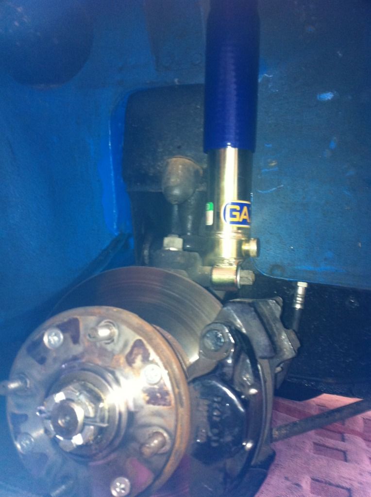

So................ over the Christmas period Noddy hasn't been used, and still today is being unused!
I changed the pot joint seals as a massive oil leak occurred, still seems to be leaking, i now think its from the gear selector???? is this a normal place to leak????????
I also fitted one of my Christmas presents.....
Minisport camber and tracking brackets!
However, on the drivers side, a bolt sheered. Its the furthest in so i plan to get him over the pit. Grind the captive nut off, and weld a new one in place!
I also managed to short the battery, so a fuse has gone so it wont start!
I just need to find the time to fix him :)

before tho, Noddy had about 1.5 degrees POSITIVE camber, and toed in about the same amount, it looked appauling, and i noticed that I am wearing the outside edge of my tyres out on the rear.
So I had to have them!!!!
Plus the back end would slide out a little to easily for my liking!
