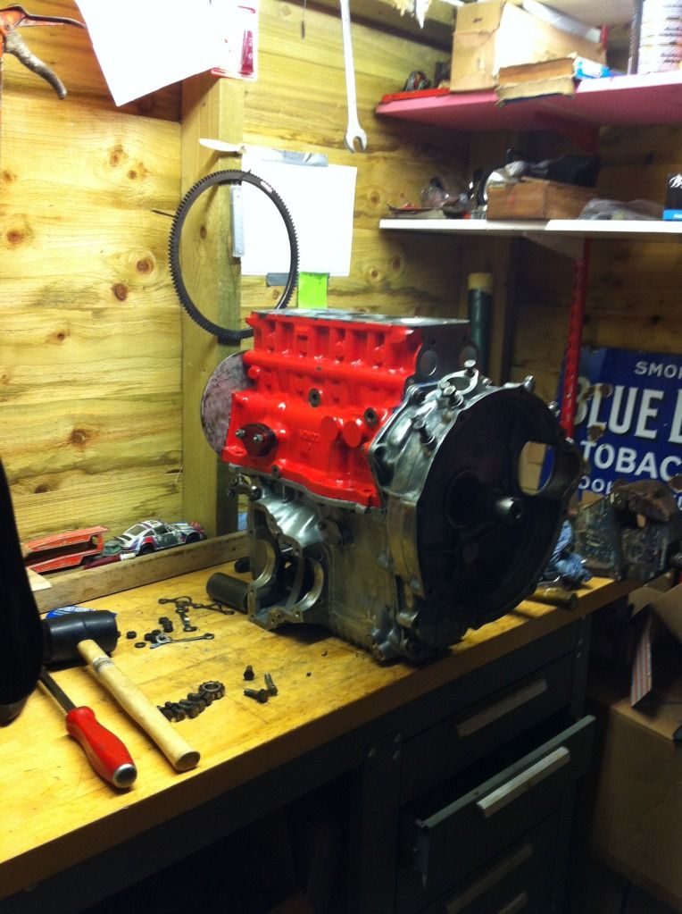

got the rest of the parts for the engine build the other day!!
let the build commence! should take good shape tomorrow :D

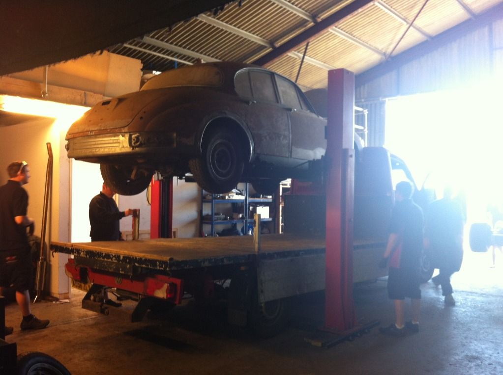

the conventional loading of a rusty vut solid mk2 jag onto a builders van... we didnt approve but did it anyways.. :P
a rusty jag... been in the warehouse long time. hunk of rust soon to be sold :D

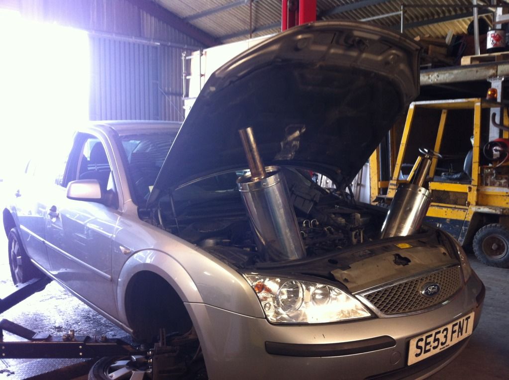

and finally, fitted a new exhaust system on to a mechanics car whilst he was doing his clutch. probably quite expensive, its from a chevron F5000 :P
hahahahaha :P

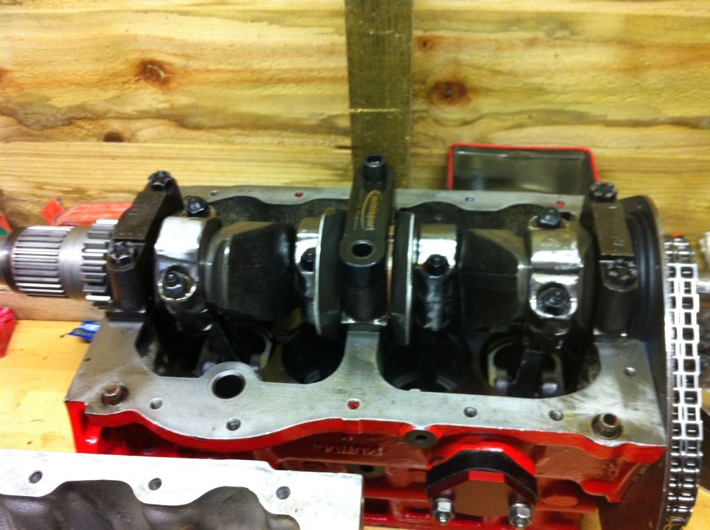

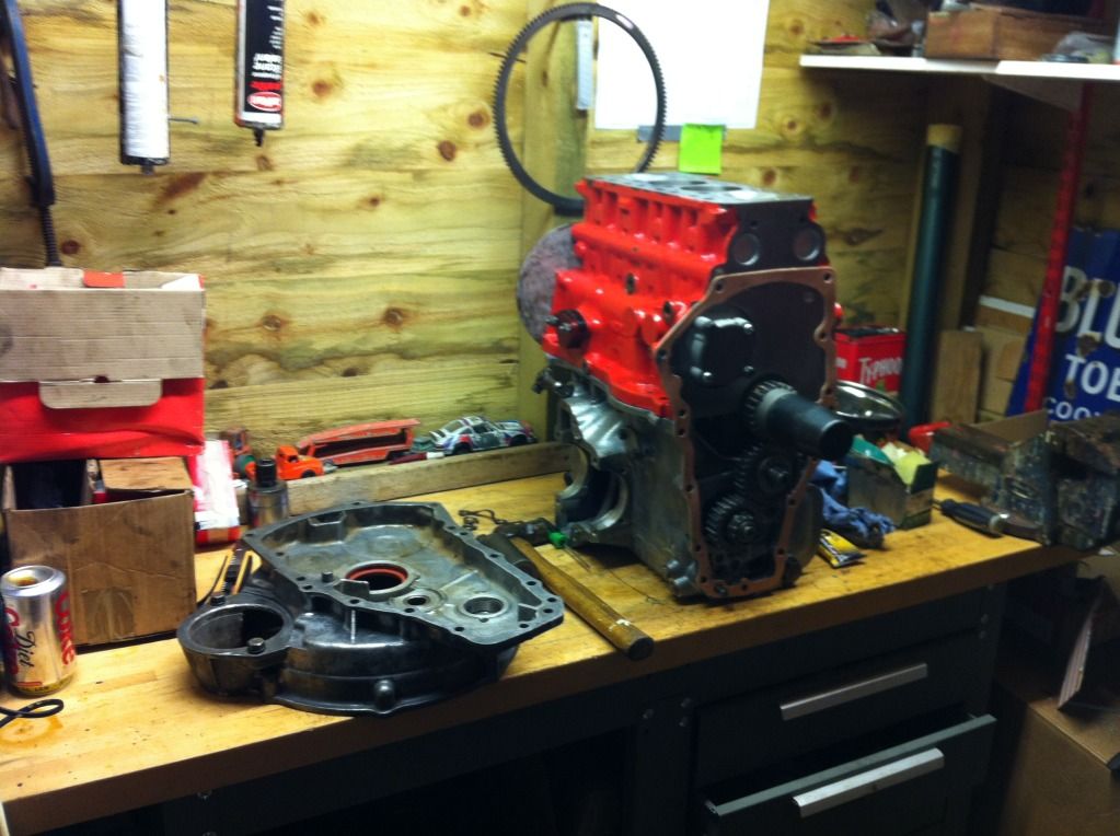

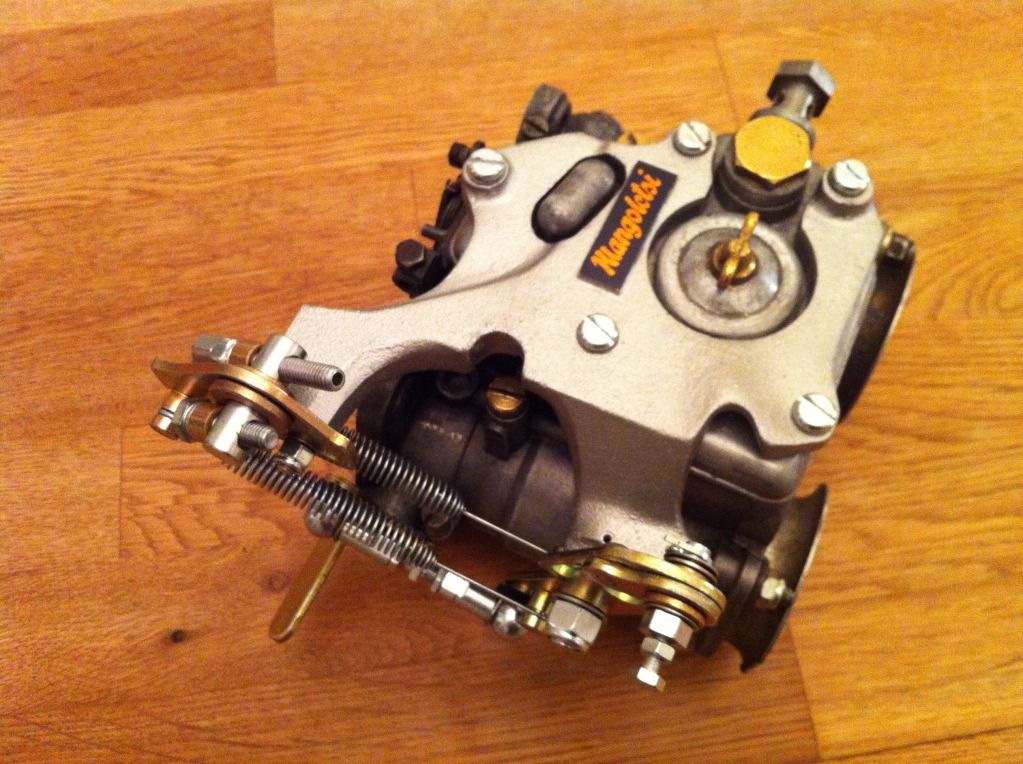

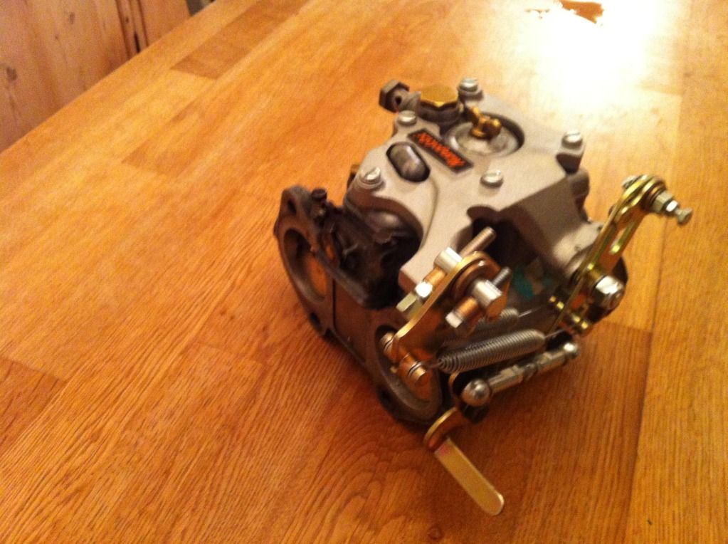

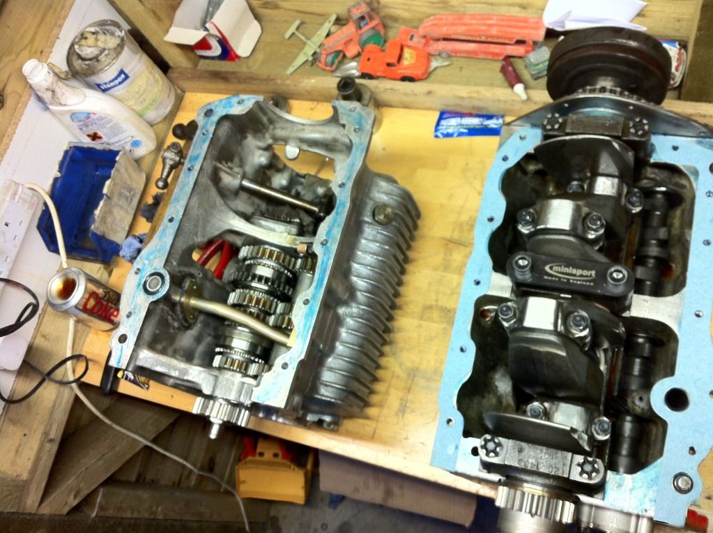

piston no. 3 in :D new cam in, oil pump in, timing gear in ( after ALOT of tinkering, bloody woodruff key was fouling:P )
and weber linkage, its bootiful!!
now need a thicker primary gear thrust washer, as i got 19 thou movement!!! and some sockets to do up the gearbox and big ends and mains :D need to finish this in september so work boots are officially on!

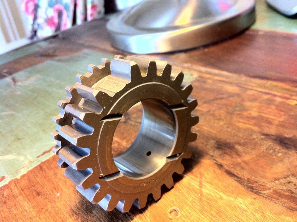

and this happened yesterday
DOH!
now just a bloody expensive paperweight!!

Posted 16 July 2012 - 10:22 PM
Locked the gearbox out to torque it up, gear snapped. Damn! Oh well new one coming tomorrow, get it all built up with flywheel on etc!
#102 AndyMiniMad.
AndyMiniMad.
  • 3,295 posts
  • Location: Under The Bonnet.
Posted 17 July 2012 - 08:03 AM
I always lock the box in first and fourth..I had heard that it was possible to snap off a tooth from either second or third gears but never thought it was possible really.....Untill now!!

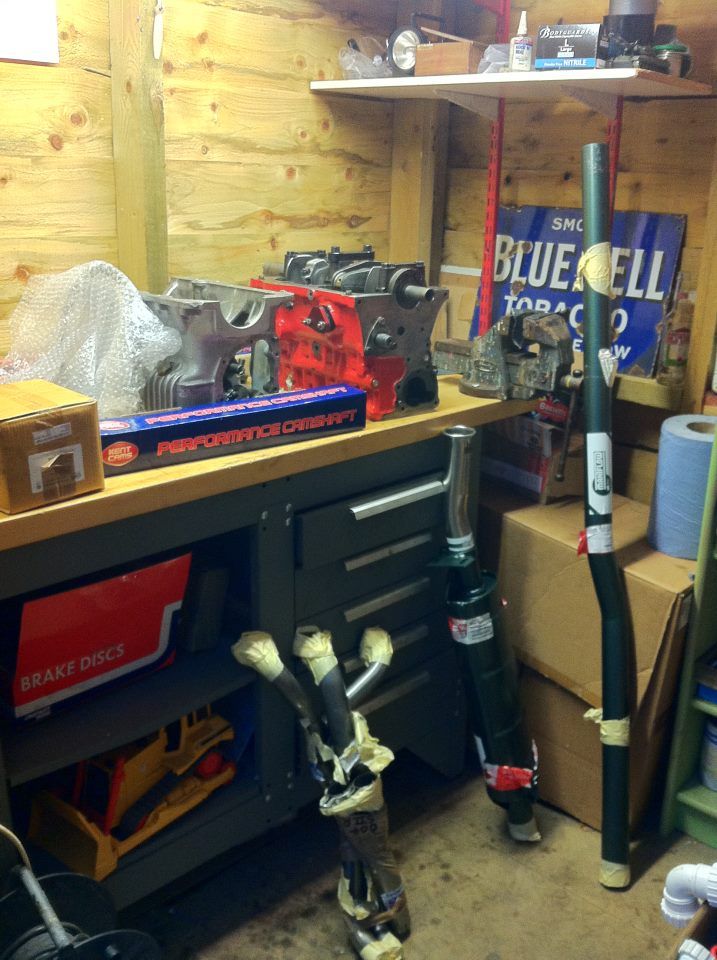

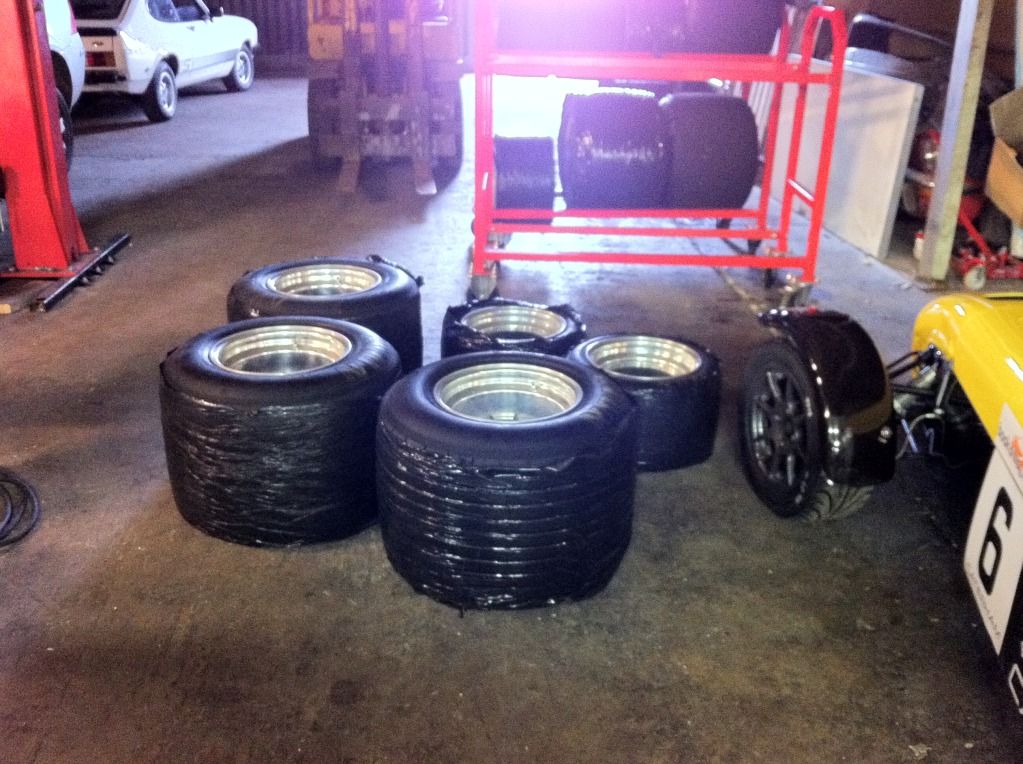

and the F5000 lives!! this is easily the loudest car i have ever heard, testing friday so expect a video!!
check out those wheels!!!
