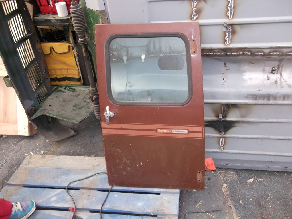

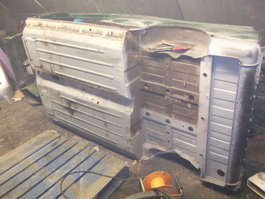

So first thing today i went and picked up my new d/s rear door ! Been sat in brown paper in someones shed for 20+ years very happy with it saves me alot of work! Plus my old man fixed the welder!

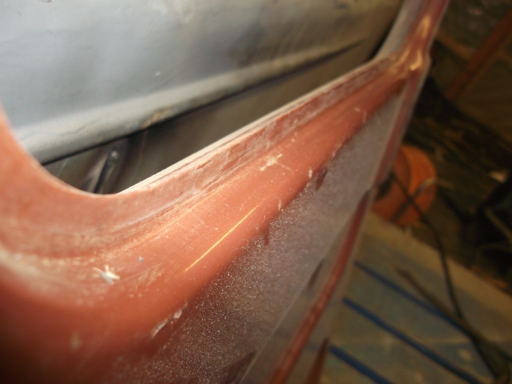

Stripped it down and realised why it was in such good condition! it has been zimbarted !
Took the glass out to find shiny paint :D

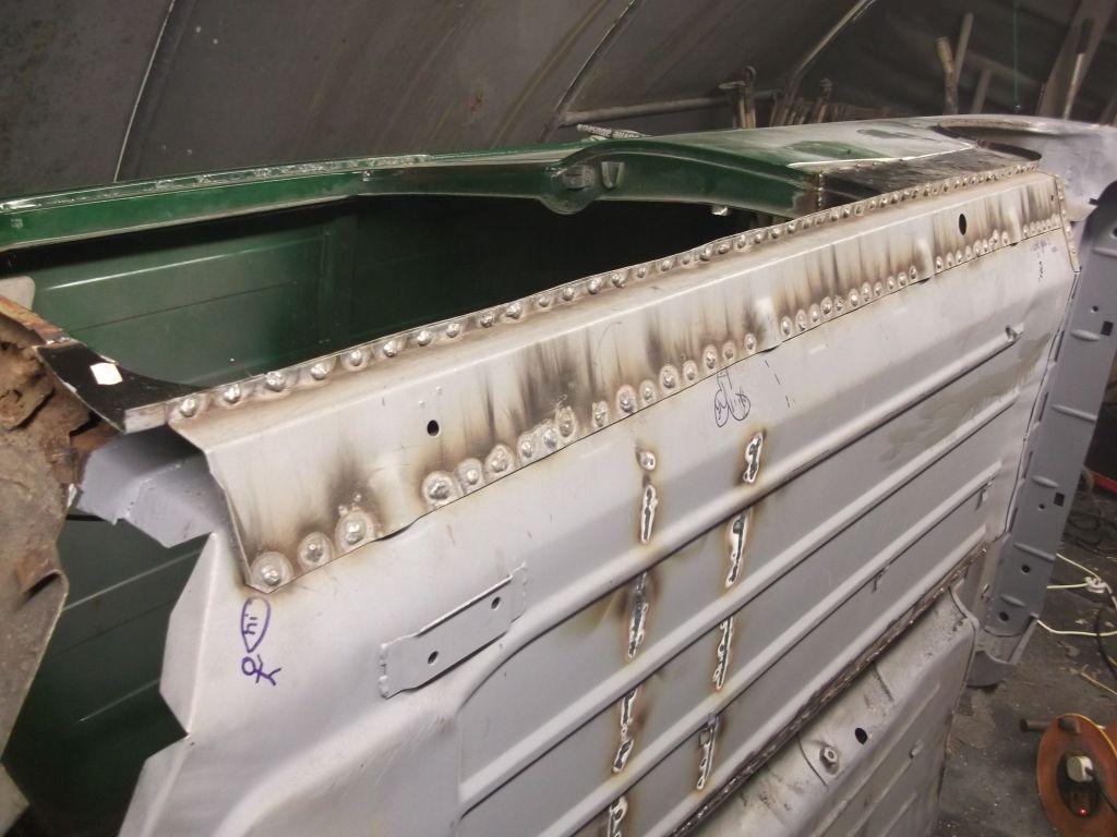

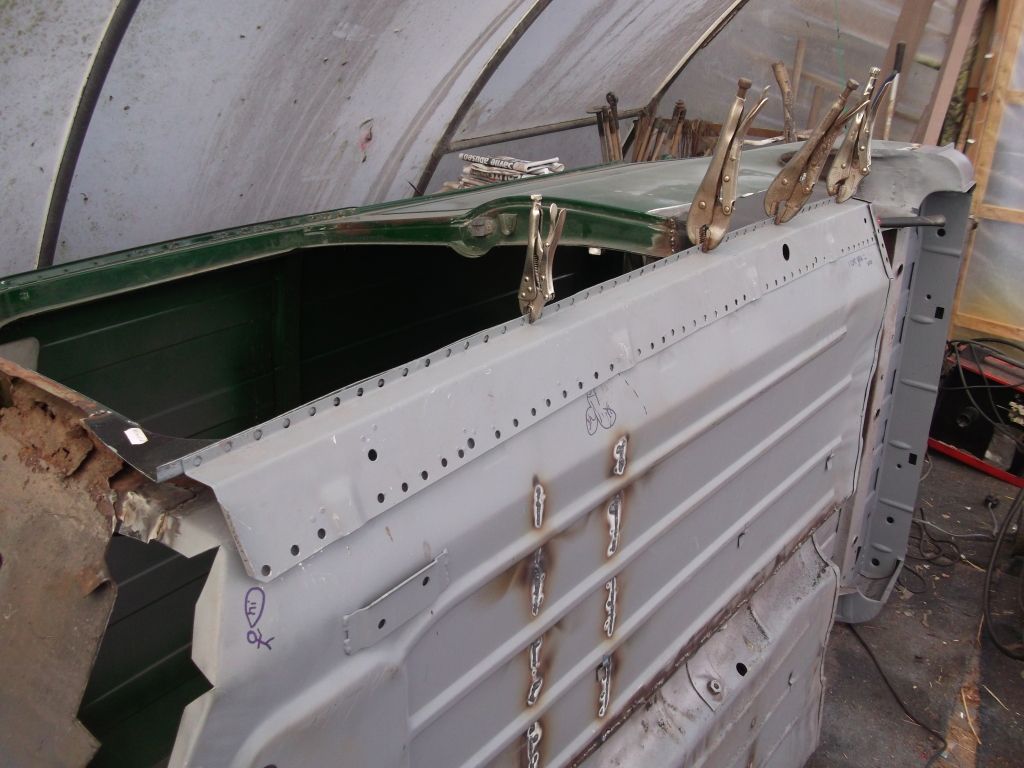

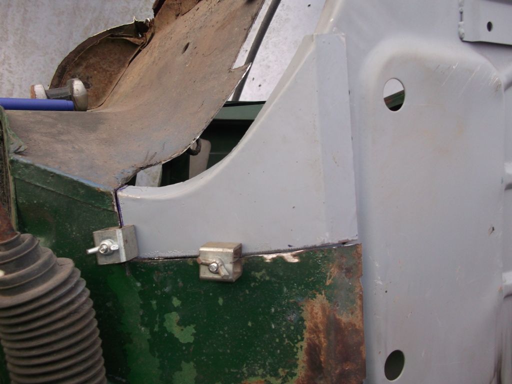

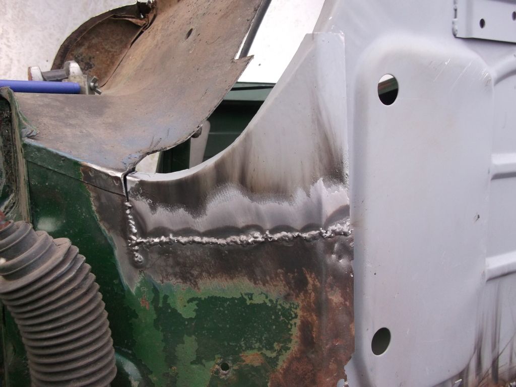

After this i cut the toeboard repair panel and welded it in
I then finished welding the door step to the inner sill wire brushed inside and re painted the burnt areas inside with zinc 182. Then i could clamp the sill in place
Welded 1 then missed one to avoid distortion untill i had done them all
Fully welded in

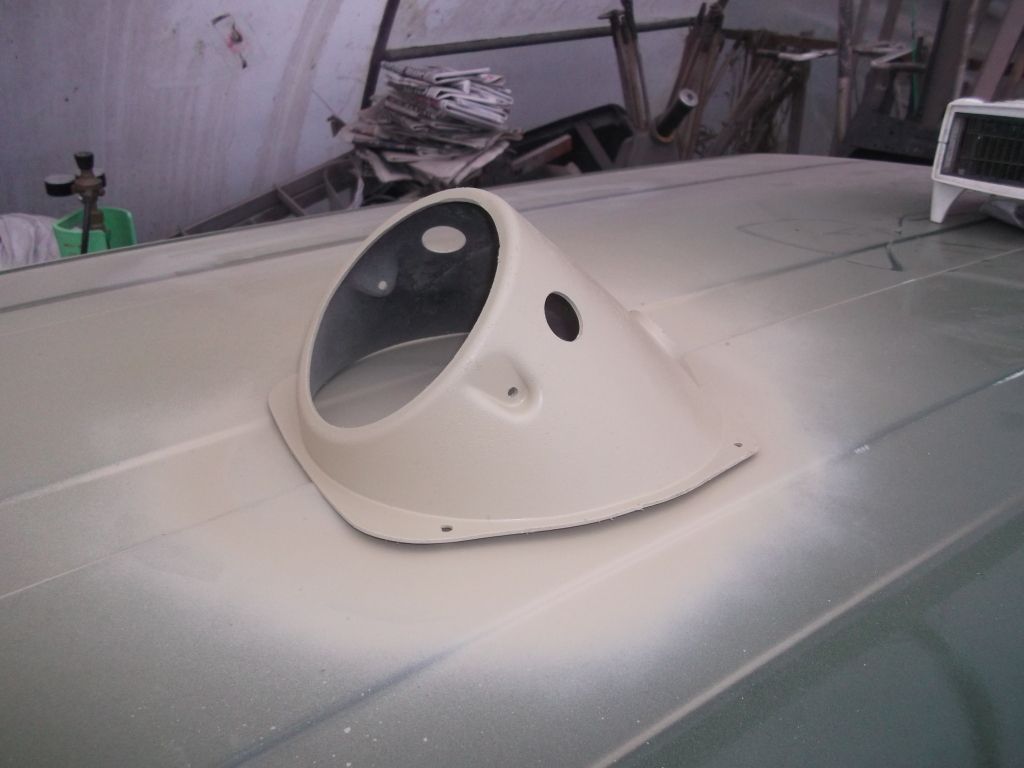

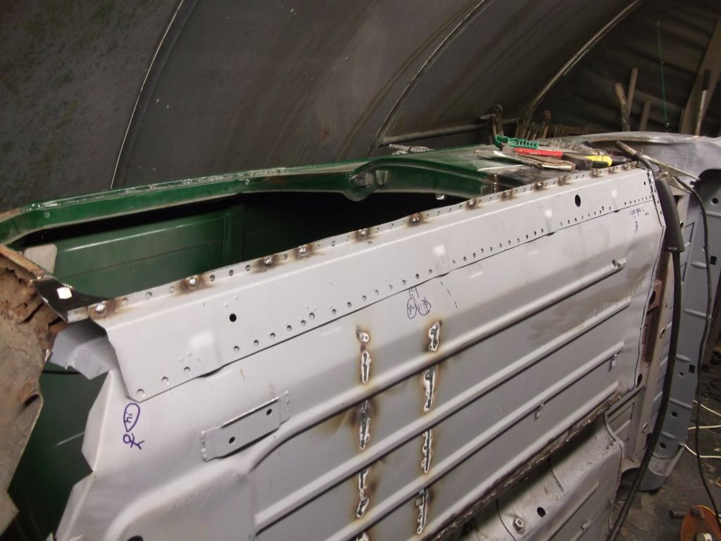

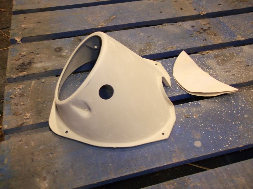

Also rubbed down and primered the clock housing
Sunday afternoon i will be doing all the grinding and last little bits of welding to get the floor to the 'done' stage!

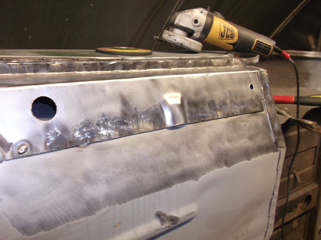

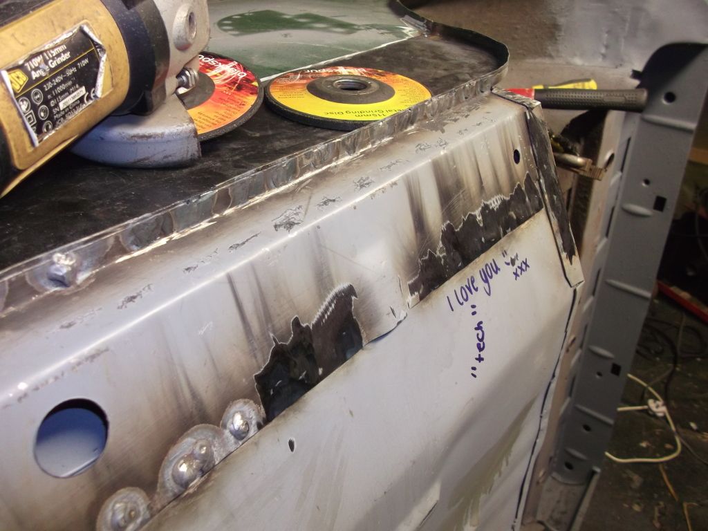

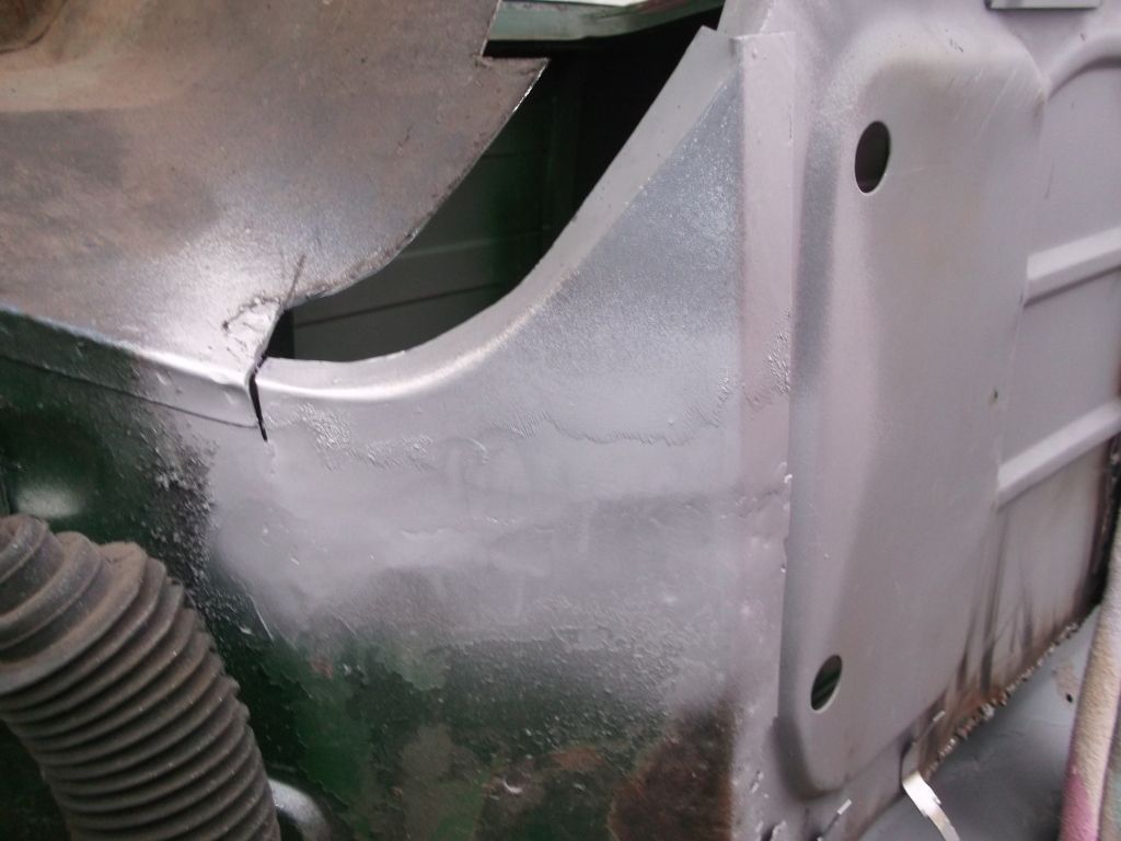

Went down for an hour tonight after work just to do i bit of grinding as all i can think about is the van progress lol
Grinded some down
cleaned it all up
Zinc primed

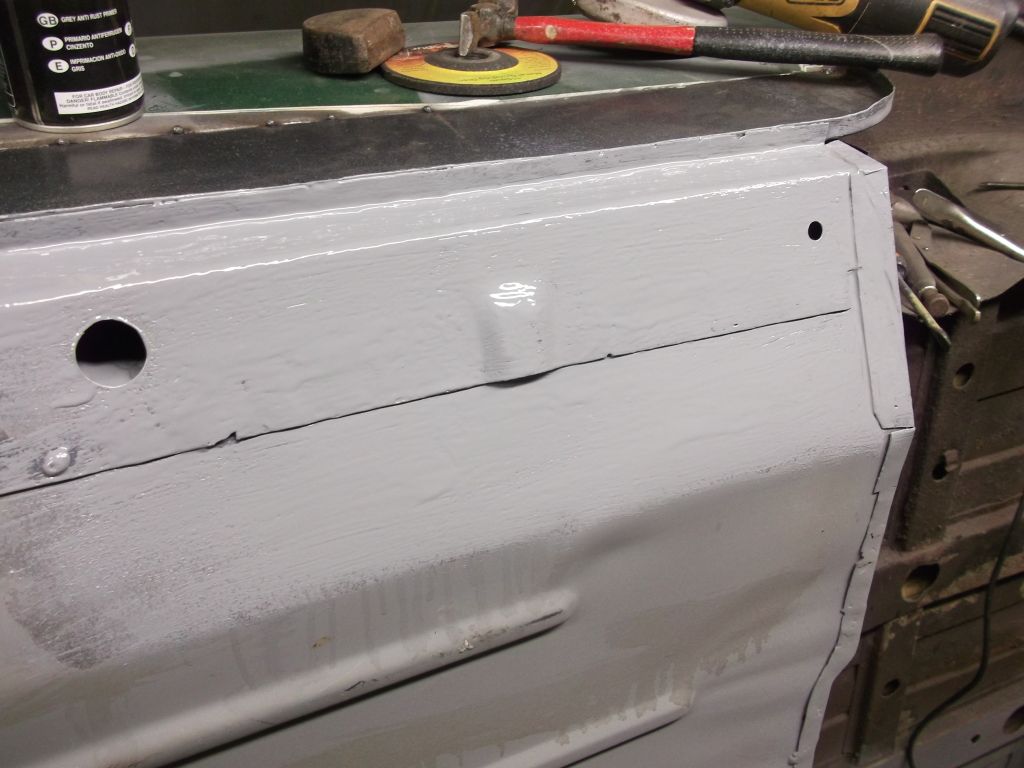

Then i used 500 to rub the primer on the clock housing down. i think im going to re-primer this using my spray gun insted of a rattle can as i want it to be a better finish! ( it isnt that bad now!)

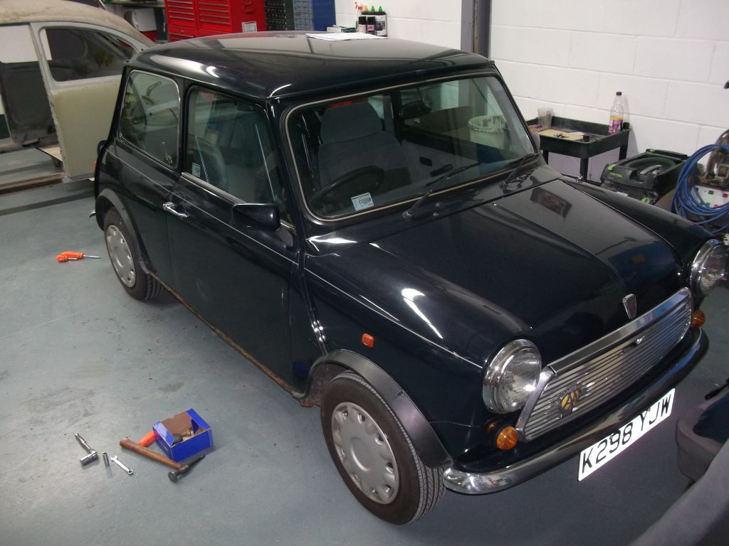

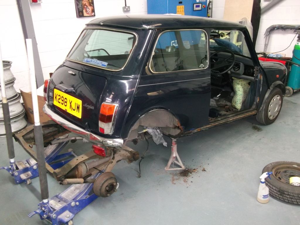

Right went into work yesterday to find this!
1993 Rover mini 1275 auto. My boss greets me with 'alright ryan i have a test for you, you think you can do it?'. He dosent really know how much i know about minis i just said yeh and got stuck in! Needs doorstep/rearquarter, sill, front floor pan, repairs to inner sill and arch to heelboard closer panels. Took me 1 day to get it looking like this!
Ordering panels tomorrow need to get them all welded in this week as we only have it 2 weeks!
So vans on hold for a while i will be doing overtime on this!
