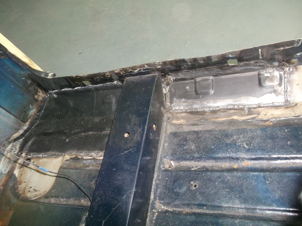

Repaired the wheel arch by making up a section then repaired part of the rear quarter. Waiting for panels from somerford so rest of rear quarter has to wait
I hope to do a bit on the van tonight! XD

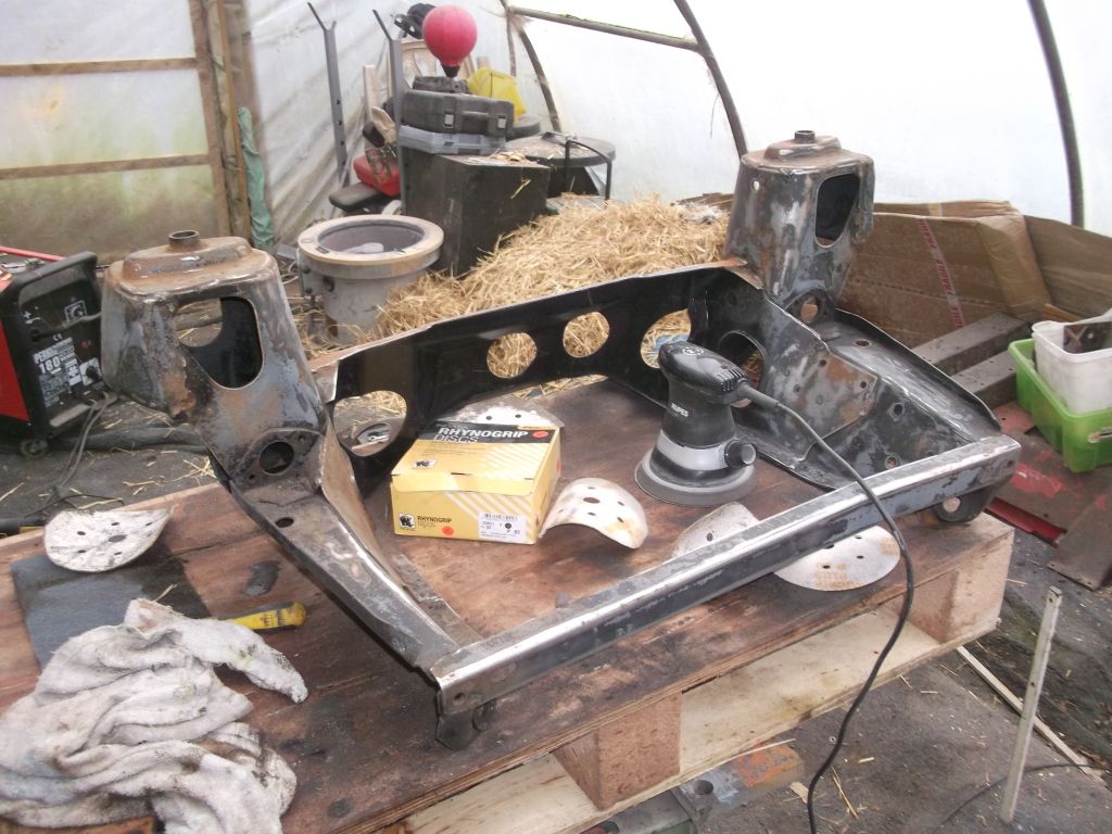

Degreased and started to rub down the front subframe the other day

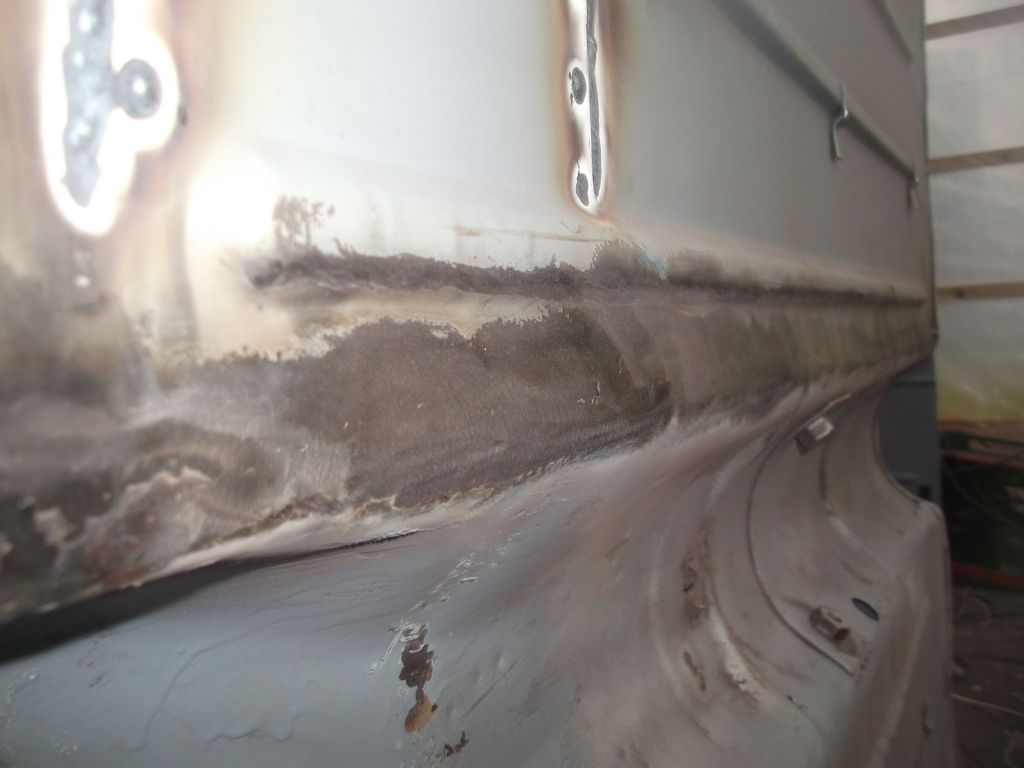

Then grounded down the weld on the p/s floorpan
Need to get some etch primer and get this subframe done and built back up asap! need to get it rolling soon.
did some more work to the other project aswell!

Why not powdercoating the subframes?

Cheers mate!I hadn't really thought about powdercoating I don't think there are any places near me that do that kind of thing :/

Over here powdercoating is pretty randomly available.
Is it just the pic, or does your front frame have a bend in it?

Yep there is a dent along the bottom edge were someone has jacked it up at the front. I will straighten it out before I paint it :)

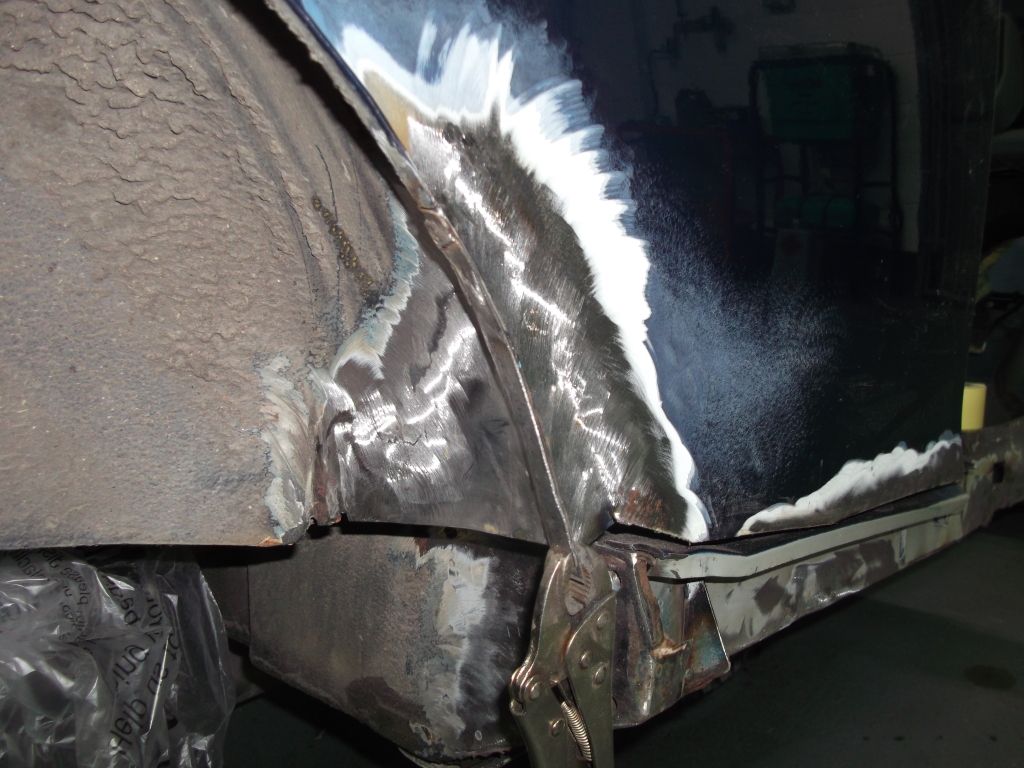

got some discs from screwfix today! so i cut and clamped the panel with my intergrips
Tacked it and removed the grips
started to weld in different places each time to avoid distortion
fully welded
ground it all down and sprayed some 182 over the top :)
Also welded up the holes on the other side that were covered with tacked on patches
I will be starting on the other corner next! cheers !
