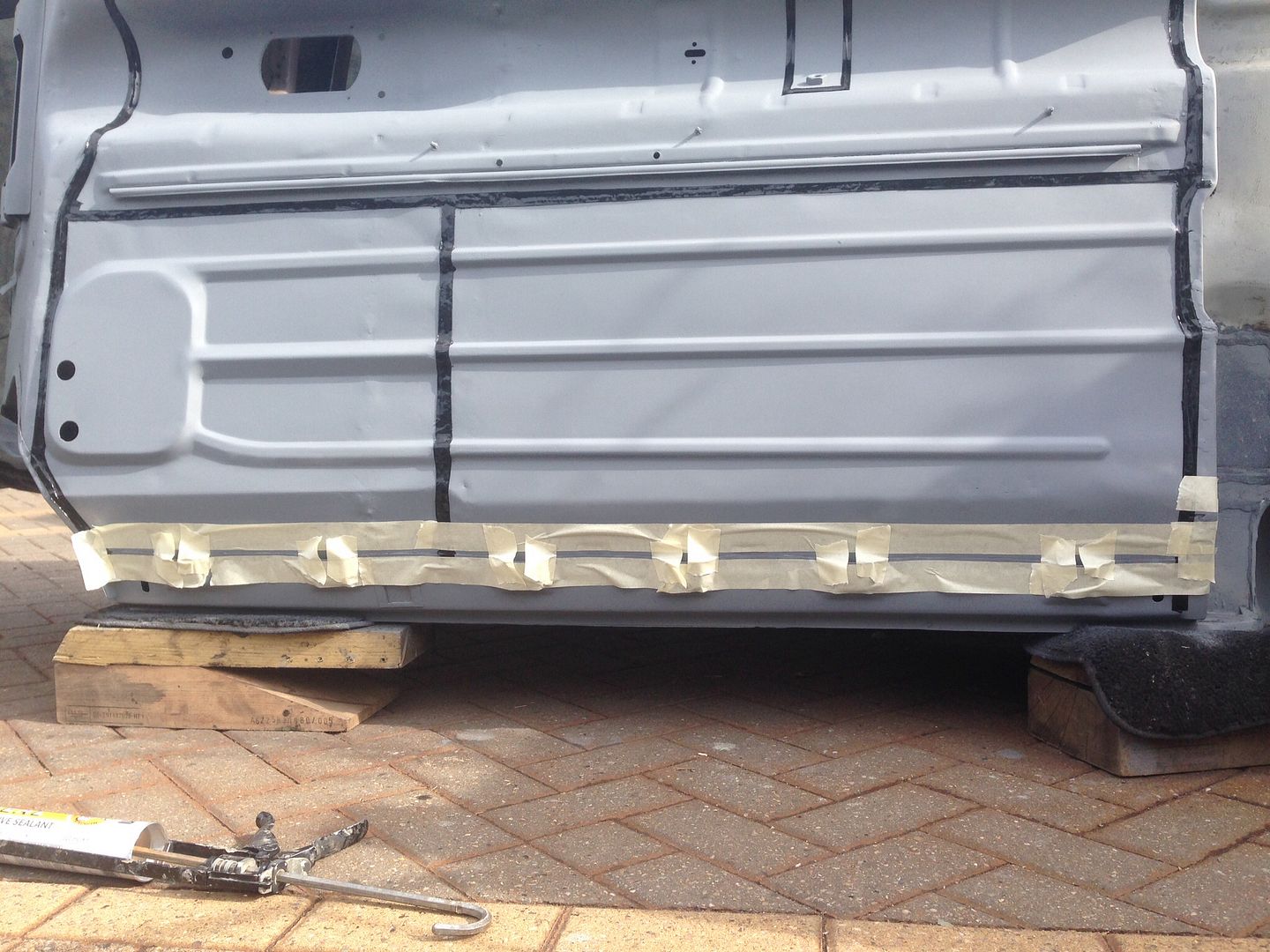

Then it was on to the mammoth task of cleaning up the floor pan, (I haven't done the boot floor yet though). I sanded it back, treated the surface rust, zinc primed and then applied some regular primer over the top -
2e8140dbb2acfac47759035198d94118_zps4980
Next job was to seal it all up, I masked out where I wanted to apply the sealer so I could get nice straight lines -
a124ac36484f4b4831af6380efe39e7e_zpsa1d0
Sealer being applied -
7898abcf42bb33d77ea7fb3517723cc2_zps8f25
Rubbed in and the tape removed -
7b2d7031c4b89df663f60d17343d9344_zps3ea1
Same process for the bottom half -
5ed31cc7f4770e5adaf0b7a7725c00aa_zps73f6
95ea02ceed72740b4130c029e79d2c04_zps0d9d
Very happy with the outcome, I'm also going to run a thin bead where the outer sill is plug welded to the floor and also around the seat belt bracket in the tunnel, just for added protection. Will do this tomorrow as I ran out of time today.

Update,
Managed to get a quick hour on the mini today, done a bit more sealing.
Taped up ready for the sealer -
333d6fee84187efe917e5a510310ed32_zps3d5e
9f7d5eb4a61fef8ac9d9857eb6d5e6a3_zps0044
ef55c30fd2cb600c11f8037b9a045edf_zps0dd6
