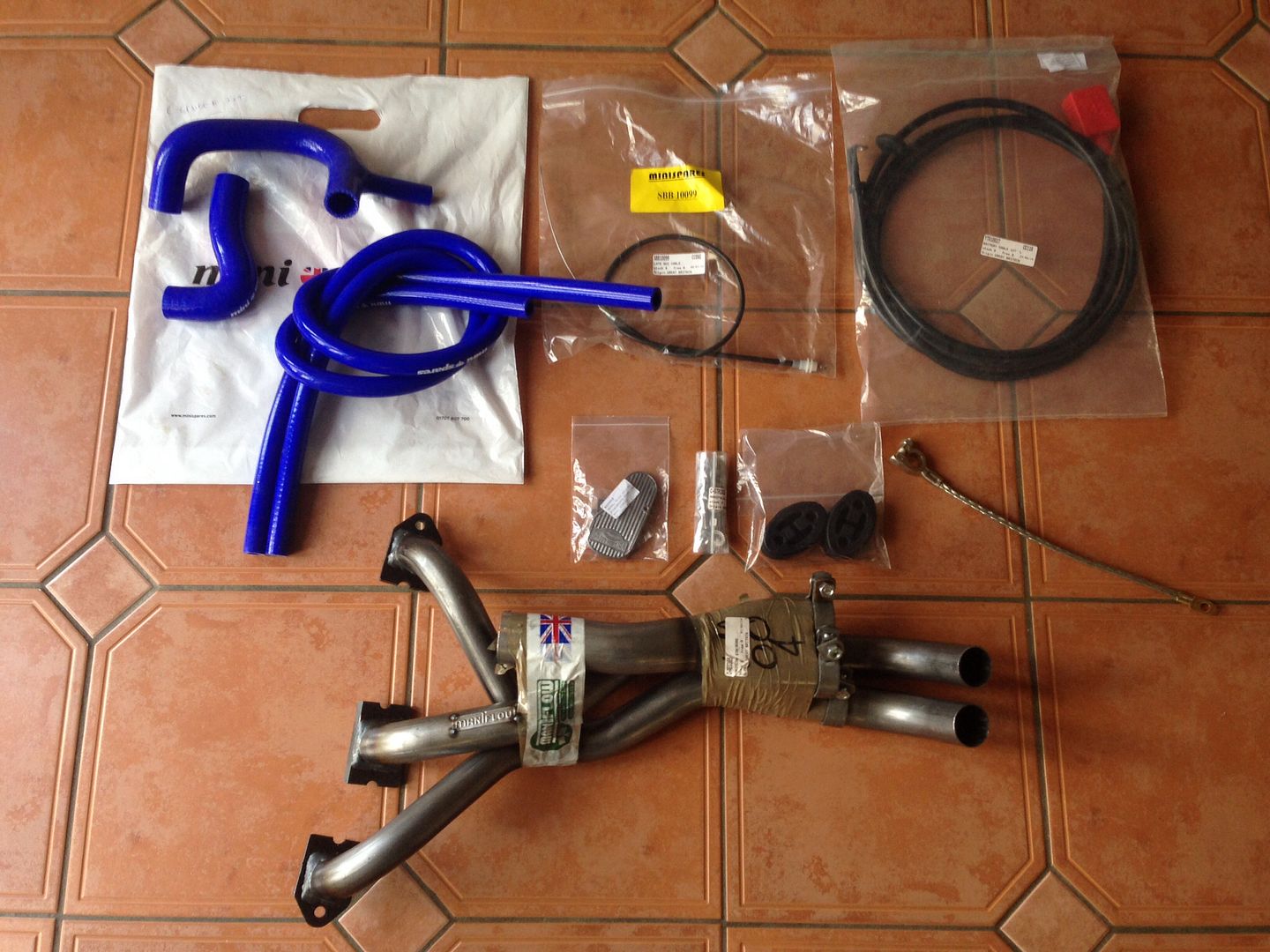

#478 big-jay
big-jay
  • 518 posts
  • Location: Birmingham
Posted 19 December 2014 - 03:02 PM
Parts Update,
Been down to Minispares today and brought the last bulk of items I'll need before it all closes for Christmas, here's what I got -
2255a215a71044cec75c4808e1d8ebdb_zpse444
Close up of the Paddy Hopkirk pedal -
247fcc56761c97ccaf762db5bce0138c_zps60f0
I also received my stainless Fletcher exhaust system through the post today, here it is -
eae086dc6ab3094a93cf0781531418b0_zps7498
df36dd085fc24d48c2449bc76d7d4f37_zps8e9d
Massive thanks to Minispeed for posting that next day delivery, probably wouldn't have received it until after Christmas otherwise !
I've also ordered some more Dynax S50 cavity wax, aswell as the bits I'll need to refurb my front loom, so hopefully those should arrive soon.
Anyway, that lot should keep me busy throughout the festive period, will make a start tomorrow !
