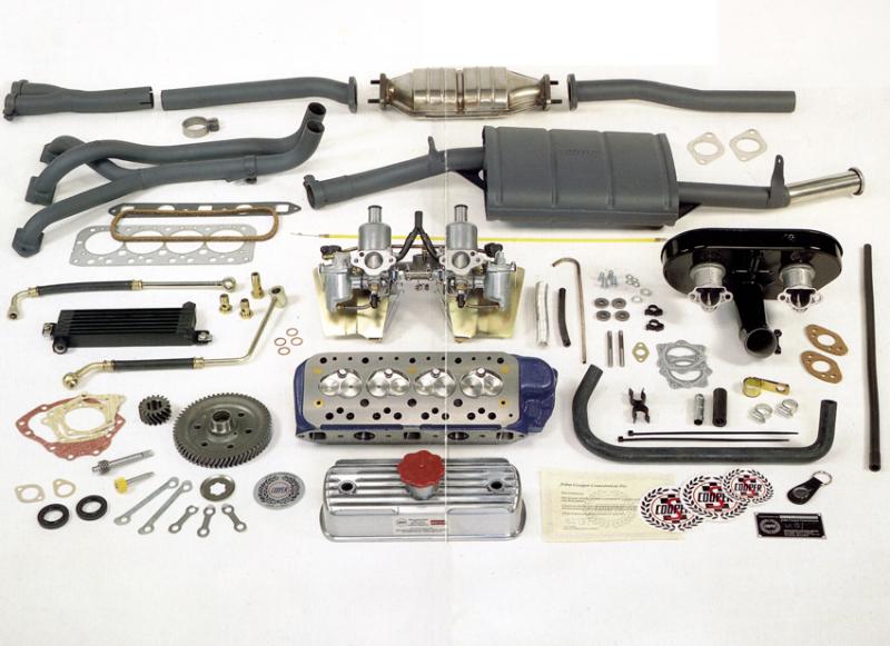

These are all the bits for the S conversion. The air box is not essential as John Cooper Garages fitted K&N pancakes as an option.
You may be able to get a new correct Janspeed exhaust system through the RSP Cooper Register
Does your car have a plate with the conversion number on the cross member to the right of the driver's seat?
