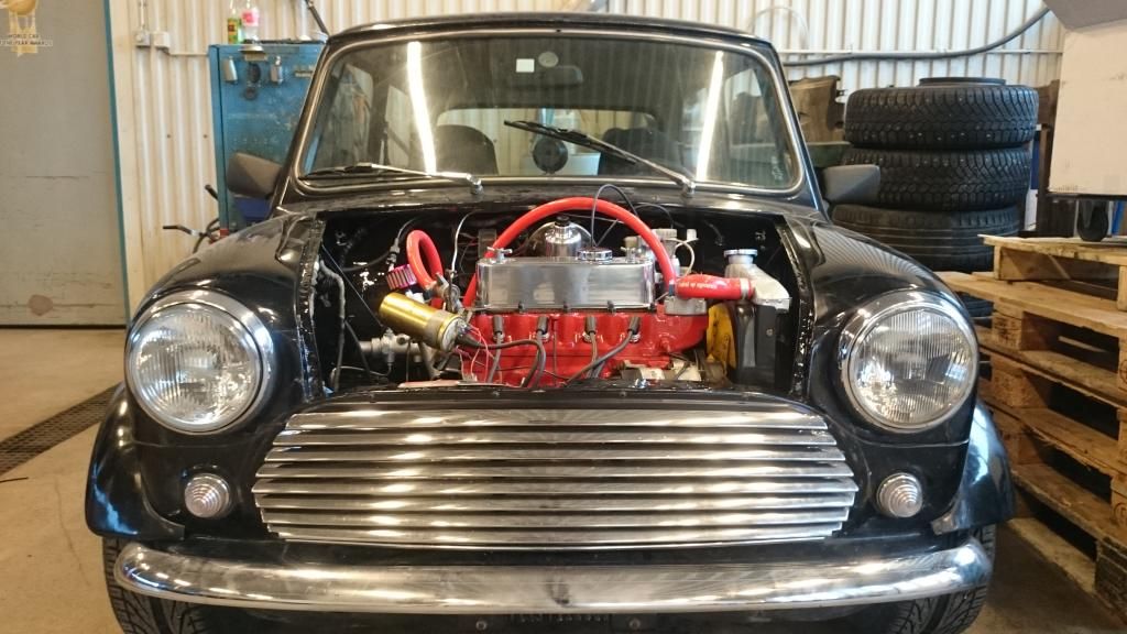

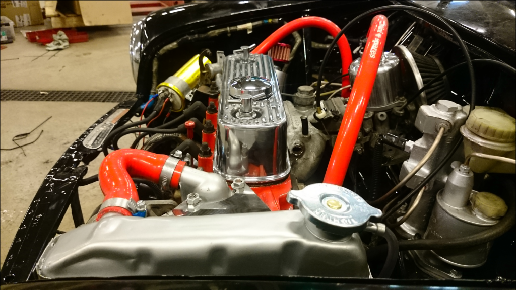

Finaly got something done today!:)

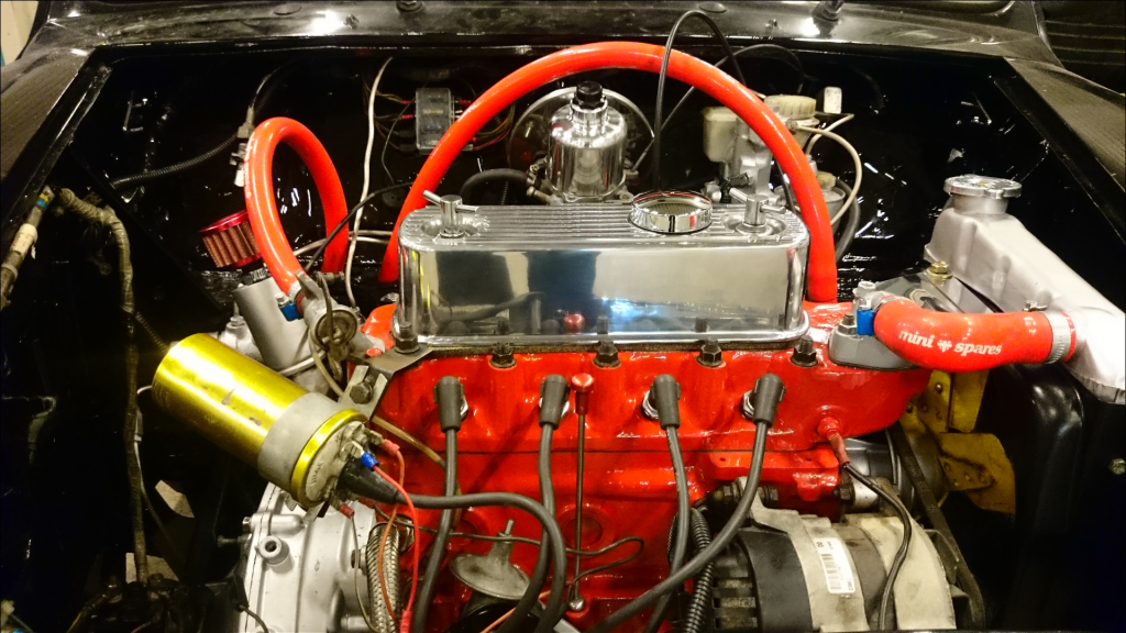

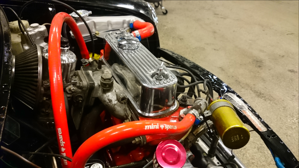

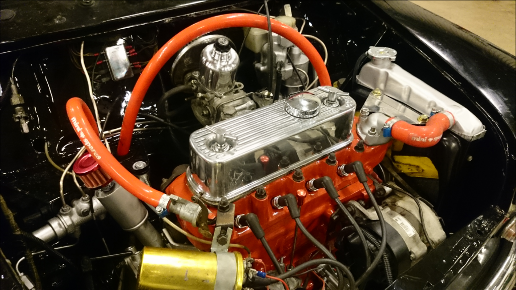

After alot of hours beating the **** out of the Y-pipe on the Lcb, i got splited, it had rusted together.. So now i got allmost everything fittet and over the weekend the firing up is happening, can't wait :)
How do i set the timing the easyest way? and do i have to reverse the oil in to the oilpump the first time?

What do i have to check before firing up?

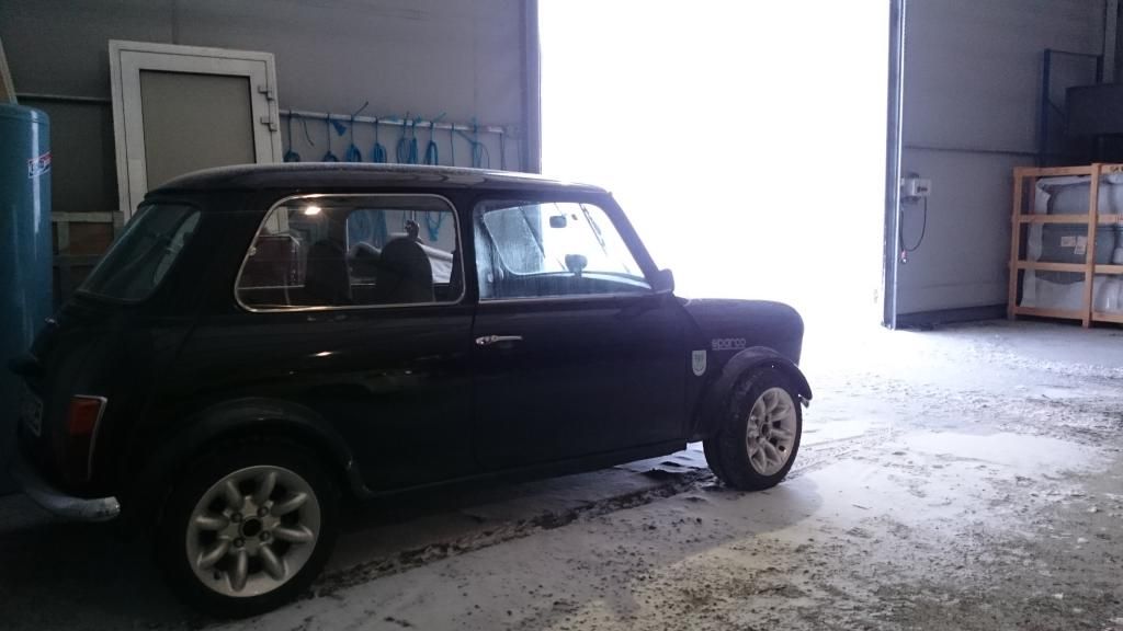

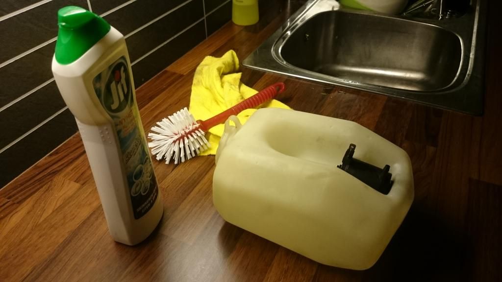

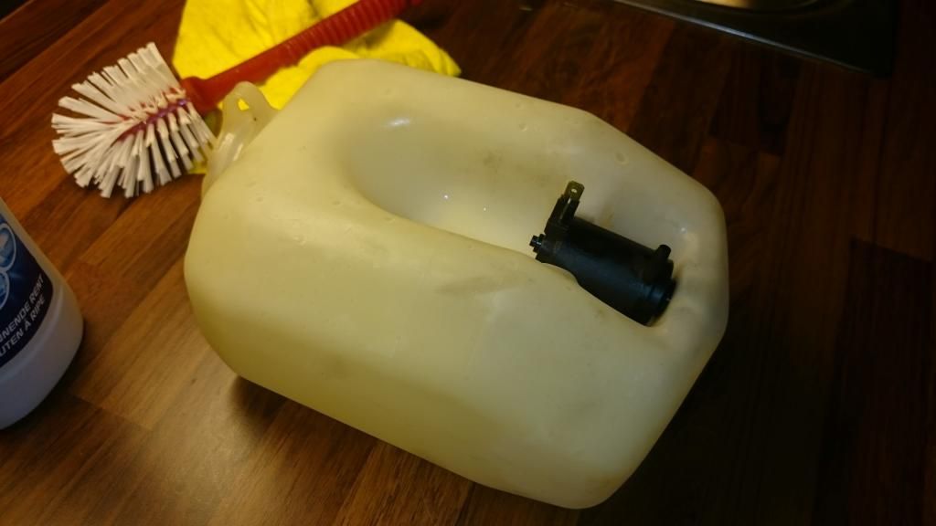

My washer bottle was beyond dirty, could see through it, so i tried the dishwasher cleaning that i read about, but that did not work, so i scrubed it with some "jif" ditergent, and now it's alot better! 😁

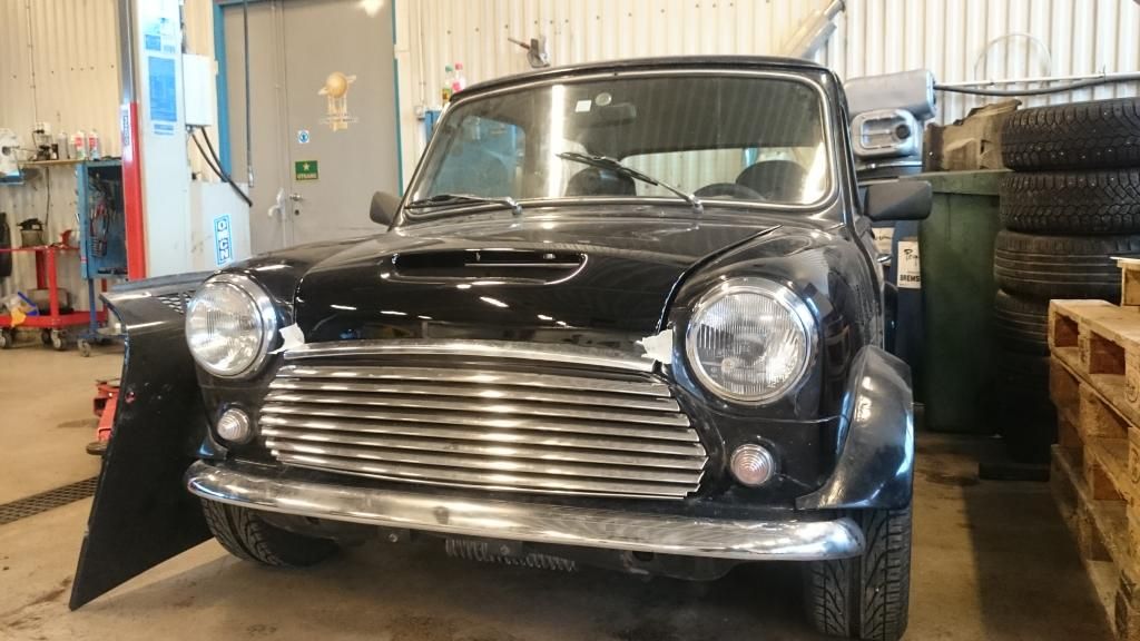

Tried on the grille and bonnet, i don't like the Bini bonnet so much, but the other one i got is scrap. So this will do for now :)
#96 Vinay-RS
Vinay-RS
  • 2,115 posts
  • Location: Cape Town
Posted 01 March 2015 - 04:28 PM
That worked really well! I think I should give it a try as well as my washer bottle is in a similar condition.

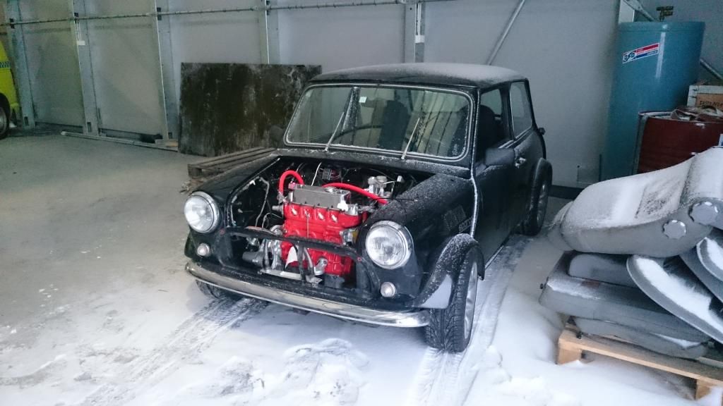

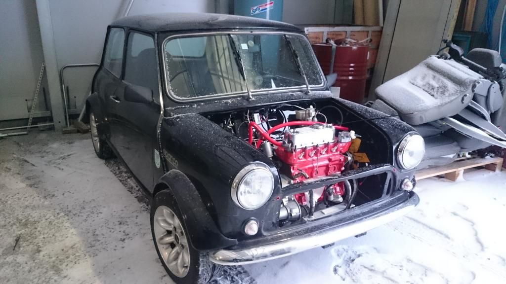

Adjusted the tappets, filled up with oil and coolant, reversed oil through the oilpump, got indikated oil pressure, but when i tried to start it, the starter wont go fast enough and the cables to the solenoid is hoooot! So i have to wire up the solenoid and the starter with all new wires and connections i think! Hope thats the problem:)

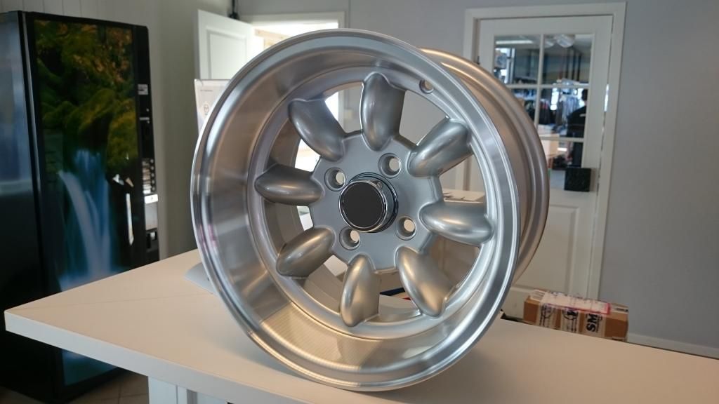

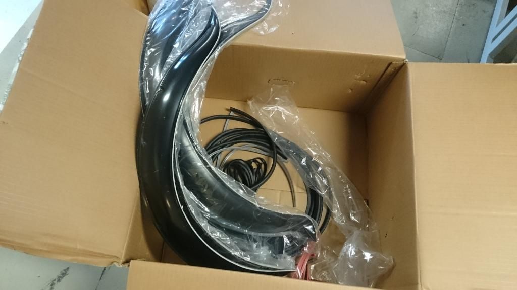

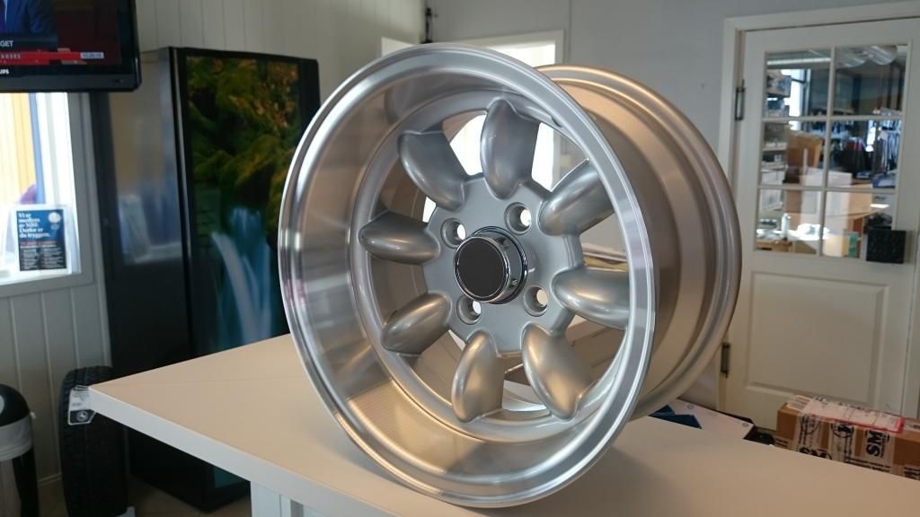

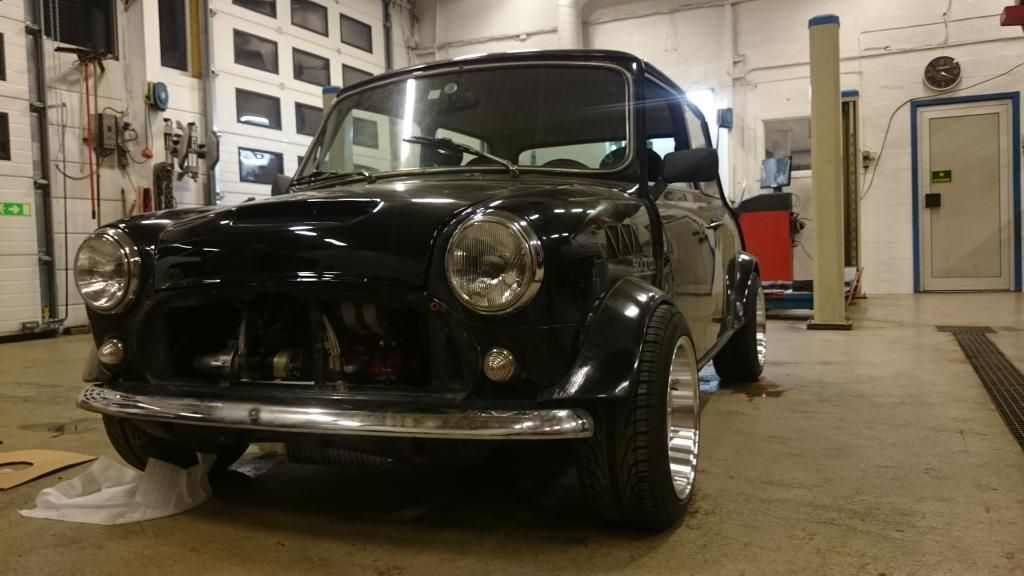

Today my Group 6 arches and Superlites arrived :)
#101 Aasnes1
Aasnes1
  • 120 posts
  • Location: North of Norway
Posted 04 March 2015 - 07:50 PM

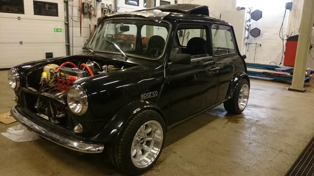

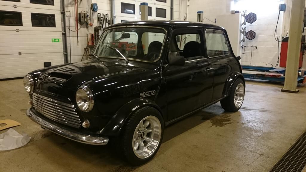

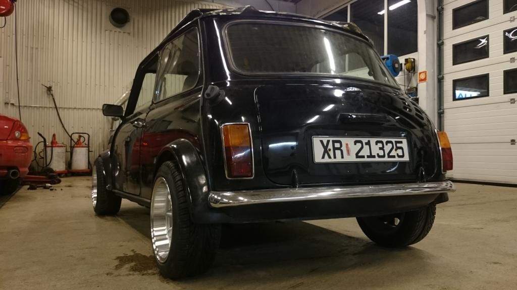

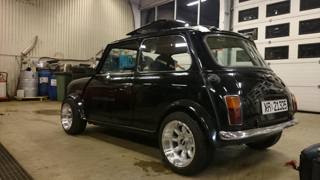

It fired up today!! But then i have a big oil leak in the oilpressure sensor... And the new accelratorcable is crap, need a new one.
And i love the wheels! They are awesome, but i think the spacers need to go in the front:p
Edited by Aasnes1, 04 March 2015 - 07:50 PM.
#102 alex-95
alex-95
    I am THE CLAMP MAKER
  • 6,078 posts
  • Location: l
Posted 04 March 2015 - 09:32 PM
Looks great!
#103 Vinay-RS
Vinay-RS
  • 2,115 posts
Posted 05 March 2015 - 07:51 AM
It is sitting really nicely with those arches and wheels

yes it does, but i have to change the arches, they are cracked, have group 6 thats going on :)
