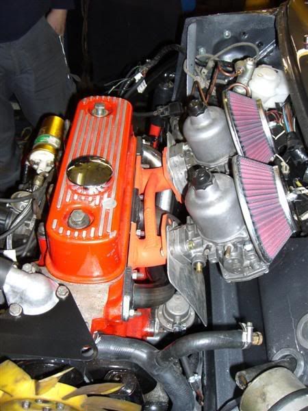

Exhaust is all done, I've got the chrome tip on as well now. I love maniflow - it all went together in about 20 minutes, then we just had to mess about and make a bracket to hang it from the rear subby. I also got one of the sparkys on the site we were working at to put some crimps on my battery cable, so thats all done and connected up now, just need some clips to hold it up. I'm going to get one of those sealed batteries as well, dont want it venting in there when I'm sleeping in it! Hopefully the electrician will be coming to make a start tomorrow as well so everythings really coming together now.

Got the clutch bled up yesterday, going for the brakes today. Tis coming together quickly!

Got lots done today - most of the wiring is figured out, just the switches, stalks and dash to do now really. The battery cable is clipped up onto the floor, brakes are totally finished, heater is all plumbed in, engine steady has new bushes, fitted the engine earth strap, replaced two rocker studs that got a tad bent when I lefted the engine in :crazy: , filled the engine with oil and did a load of other little bits and pieces. I'm knackered now!
