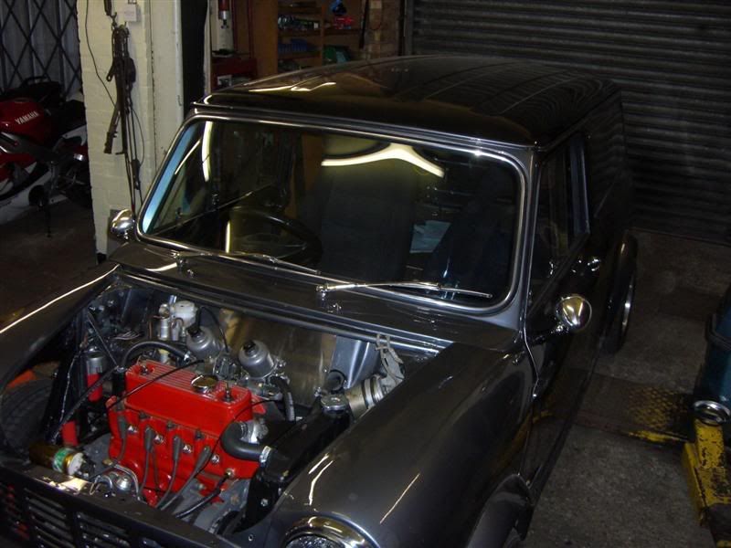

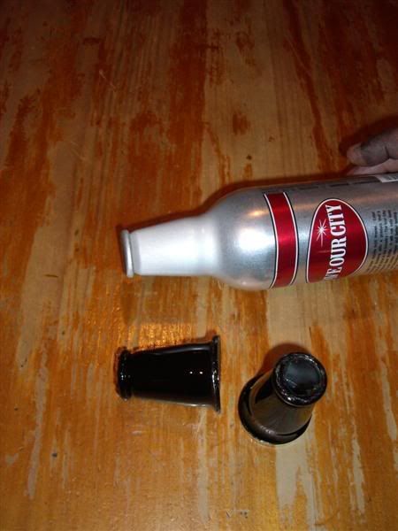

Mirrors fitted. Awesome idea for the mounts from dad - some little aluminium beer bottles, chop the necks off, bit of trimming, hammering and painting and:
And fitted:
Also got the speedo sorted - JB welded the magnets to the pot joint, made a bracket for the sensor and wired it up. Took it on a quick run down the lane and it seems to be working >_< I don't think theres much it would fail an MOT on now!
