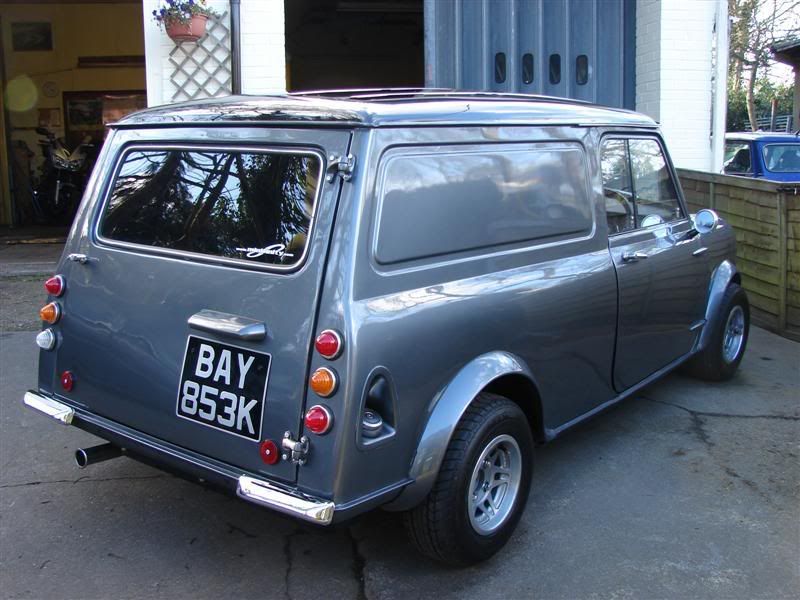

Stamped my vin plate today and fitted it, then got evicted from the garage so Dad could service my brothers car. So, with nothing really to do on it, I gave it a quick polish! It looks mighty fine too! First thing tomorrow I'll be booking an MOT, and getting my insurance sorted O_O
*edit*
Yes, that is a finity sticker before anyone asks - there will be a TMF one going on there when it turns up!

Looks lovely!
#520 sweetser
sweetser
  • 3,995 posts
Posted 09 March 2008 - 07:11 PM
OMG that is lovely

Thanks for posting that shot! I've been anxiously awaiting a full real-world shot. Beautiful! O_O Can't wait for a full photo shoot!

Looks awesome dude!
Wheels look great in the daylight... tis all good, 'part from that Minifinity sticker on the back window O_O

Nice one Tom. Looks great O_O

FANTASTIC!!!!!!! My hat goes off to you buddy .

nice looking van mate
looks great
