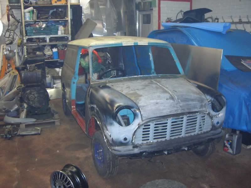

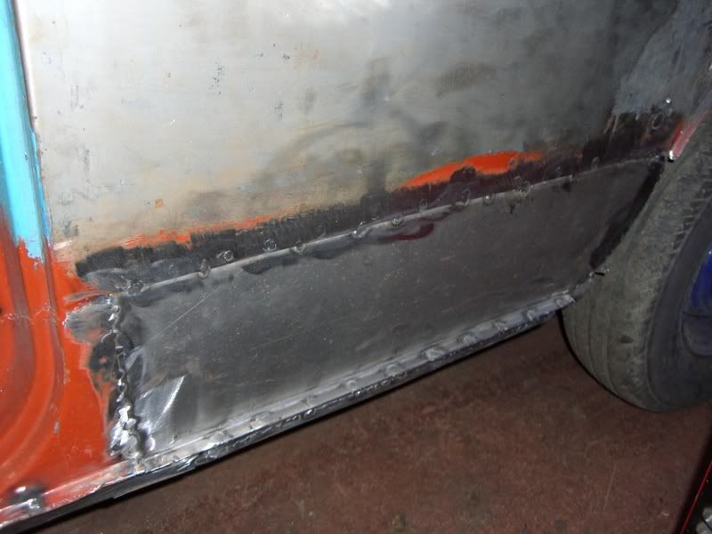

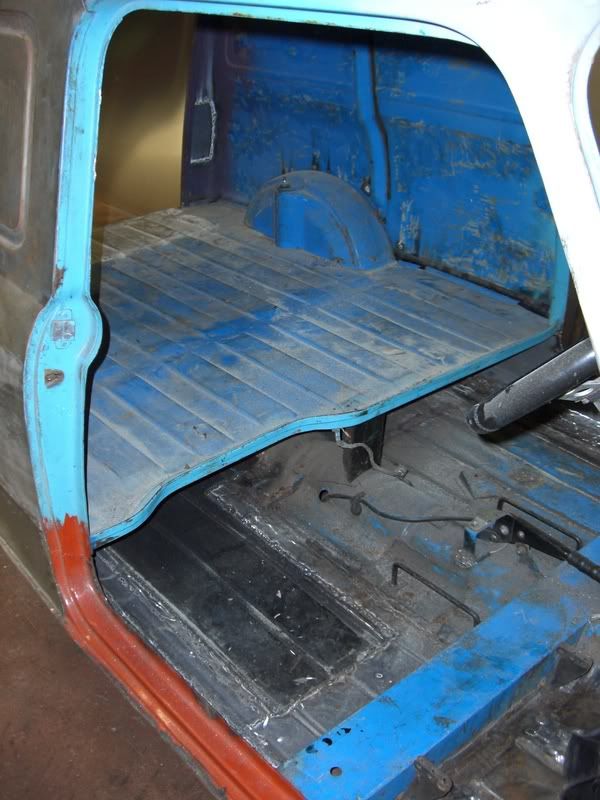

Progress at last! Spent the last two days welding, and its really coming together now. We got the side repaired, and the front wings done. Cut out the floor panel we made ourselves and got the proper panel put in. It looks like a mini again!
Nearside repair. One of the best we've done so far, if I do say so myself :angel:

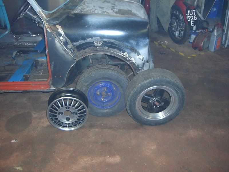

Decisions, decisions! Which wheels do I use - the revolutions or the 100+ ones? I'll just have to wait and see which fit best under the arches...

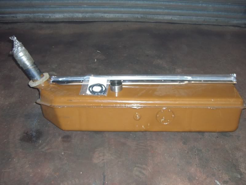

More bits - sliding window channels, brake rebuild kit and fuel tank. Painted in a fetching shade of turd brown. That paint is some serious stuff tough - I think its about 1/4" thick now, I put so many coats on it! I'll give it a quick splash of black hammerite before it goes on though.

i recon you should wait till the cars painted before deciding on wheels recon you should get tyres on the +100 tho will b easier to see what there like

Nice to see some progress, looks like its really coming on. I also reckon the 100+ wheels :)

Thanks. The only reason I said about the wheels was because I'm not sure if the 100+'s will fill the arches out. They seem to have less offset than than the revos, but I may put some little spacers on to push them out a little. I won't make a decision till its all painted and the engine is in, becuase its on drums at the moment. When I get the disc setup on, that changes the track width I think? God I'm getting bored of welding!

100+ wheels without a doubt. doesnt even need thinking about

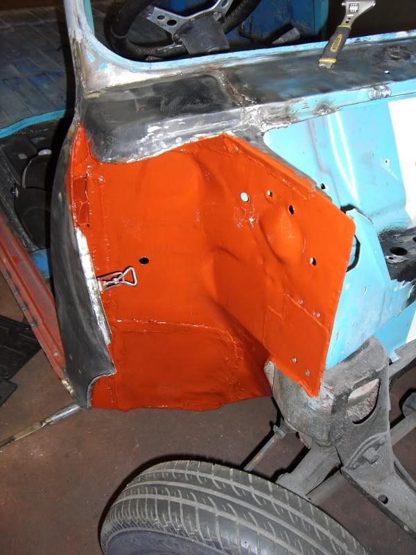

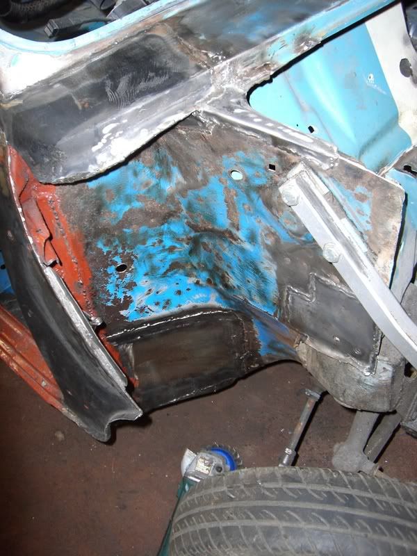

Offside innner wing, cleaned and everything welded. At last. Hopefully I'll get the other side done tomorrow.
Floor, almost done. Just need to weld a little bit underneath the tunnel, then when the subby comes off do across the back edge. Everything in front of the crossmember has also been stripped and de greased as well.

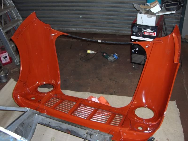

The flip front. The brace across the back holds it really rigid, and the fillets at the back have the locks in for the bonnet pins.

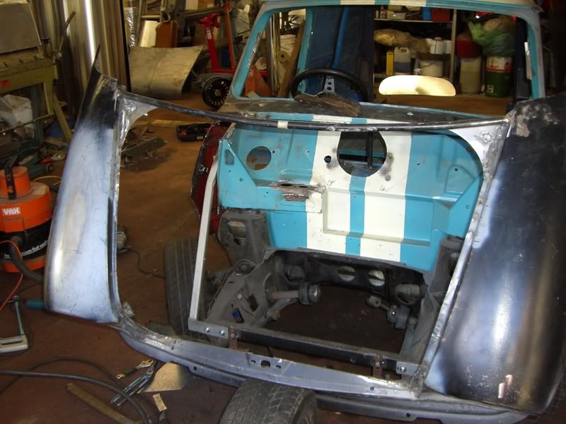

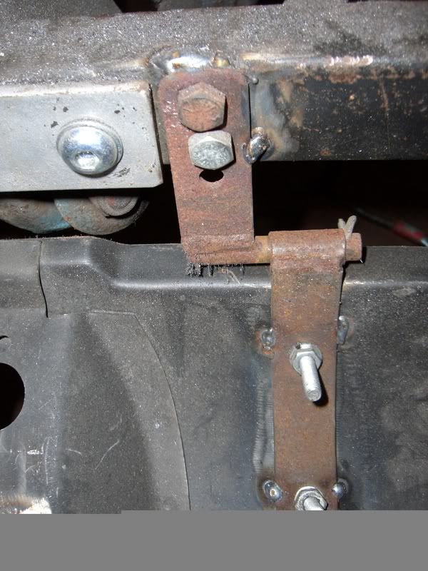

hi could i be cheeky and ask for some pics of the hinges?....

The hinges on the flip front retro? I'll get a picture tomorrow.
I've spent today tidying it all up. I think all the welding is done now on the flip front, just got a little bit of grinding to do now and I can paint it. Welded a new master cylinder bracket on, the old one was welded on so badly I just pulled it and it fell off! I've finished cleaning down the inner wings - the cup wheel in the grinder and plenty of thinners soon got rid of the waxoyl. Too much of the thinners makes you go a little :gimme: though... I *think* that I am done welding up to the heelboard now as well, so tomorrow I will give it all a splash of red oxide to keep it from rusting.

Just for you Retro:
Not very technical I'm afraid!
Flip front is all welded up and painted. Amazing how just a lick of paint makes it look so much better.

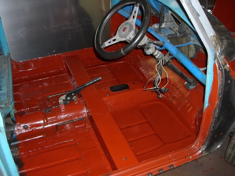

The floor, all welded up and painted.

looks good mate!. are those hinges home-made... i notice you've put a split pin through (i think), i take it that's so you can remove it should you need to?....

They were already on it when I got it - they certainly look pretty simple. Theres just a bit of wire through them atm, I will put an R pin through instead so I can take it off easily. I've got four days of holiday left to do as much as I can now. When all the welding is done I'm going to get a quote to see how much it will be to get a pro spray job. After that its all easy....
