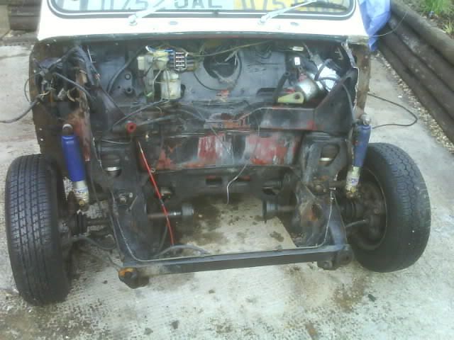

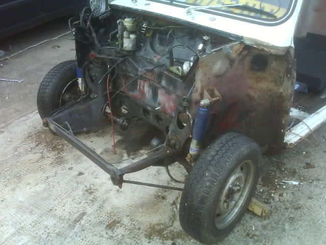

Enignes out... took a while, as it hasa so much rap conented to it, that isn't normally there!
But its finally out! and I think there may be a problem... there was LOTS of water in the oil! :(

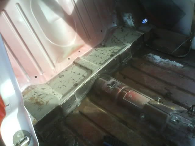

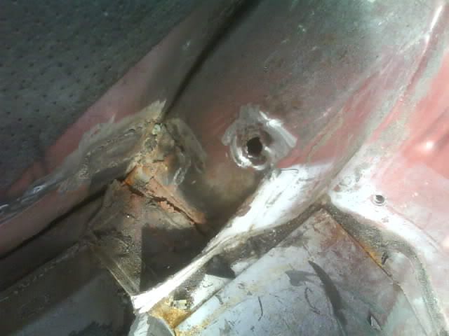

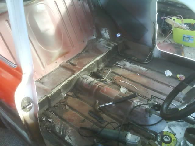

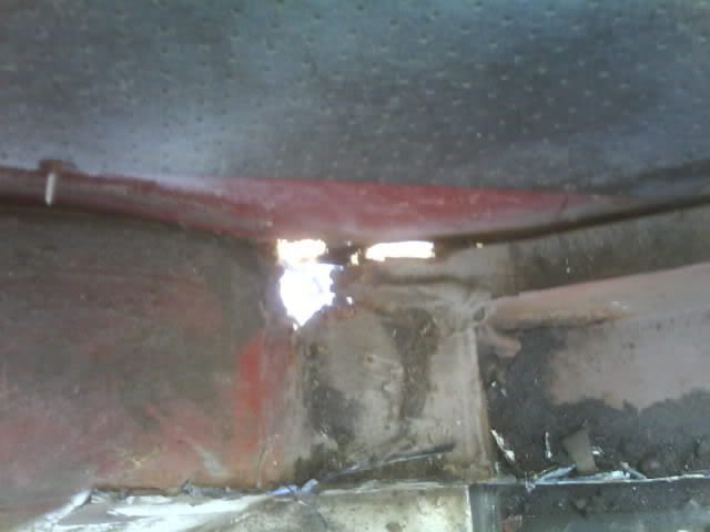

Finished off taking the rear seat out! easy job :P but found a few holes ^_^
Some of the holes I need to patch up!

you want to get rid of all that sound proofing on the floor, will save you a good couple of kg's

Yeh removing the floor sound deading is a job I can do when the Mini is back in the garage!
All I have left to do, is welding...
Few patchs on the inside seat...
outter sill
Boot...
I can see me finishing the welding next weekend, quite easily!

isnt the hole in the neer side bottom wheelarch the same one from outside bottom of quatre panel?
#338 Dog
Dog
    Deathwish Fairy
  • 9,550 posts
  • Local Club: Shatrats.com
Posted 30 October 2006 - 08:31 PM
Yep your correct Dave!
Its one big hole lol!
So I've got a bit of patching to do, but nothing tooo hard! well not compared the the rest of the holes etc!
