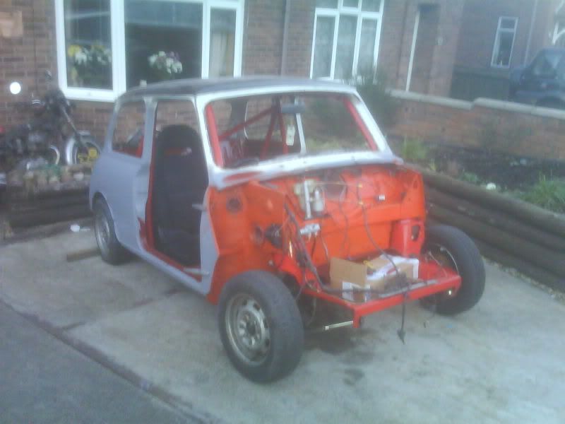

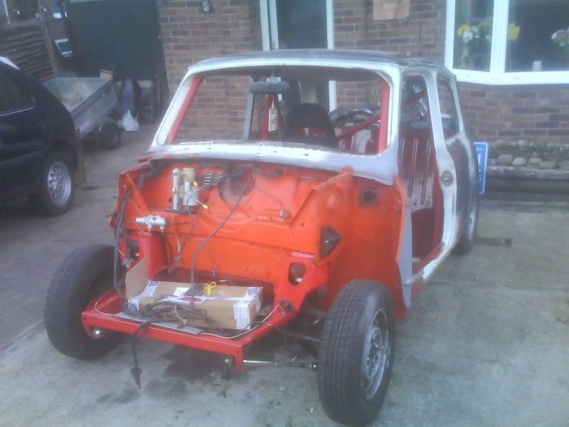

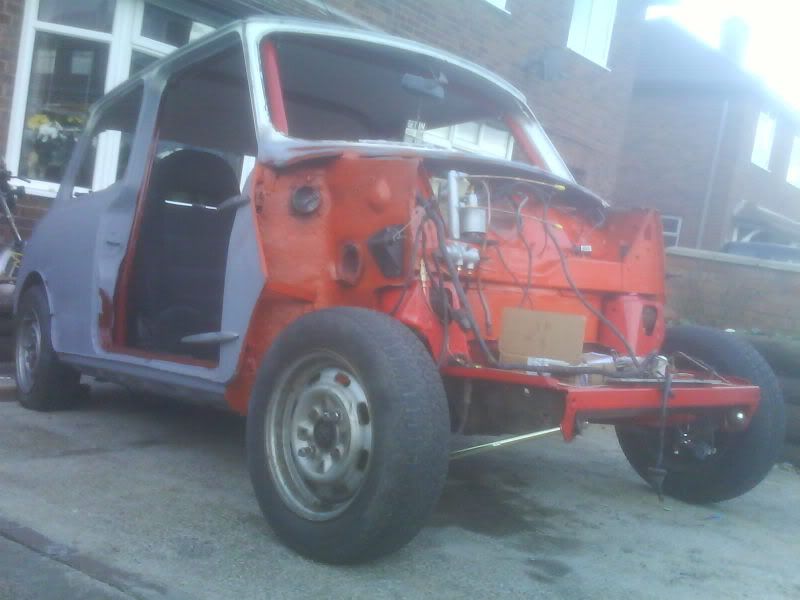

Just a random photoshoot, when I pushed the Mini down from the Garage...

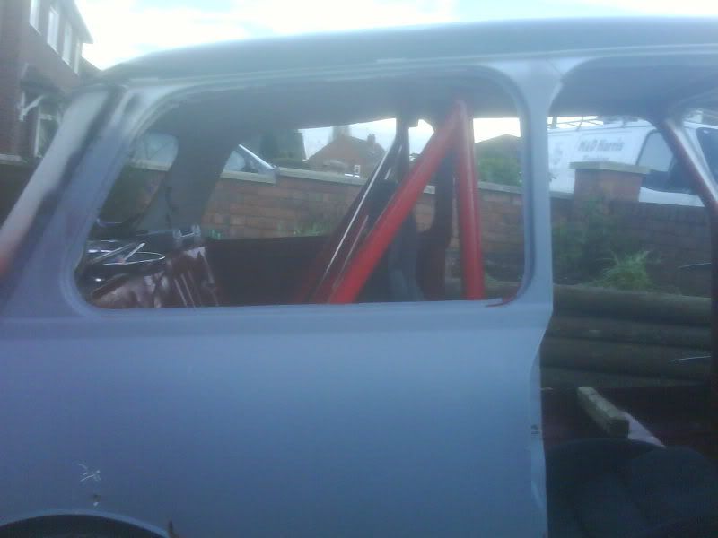

what paint is on the cage? im gunna paint mine red i think
#712 Dog
Dog
    Deathwish Fairy
  • 9,550 posts
  • Local Club: Shatrats.com
Posted 27 January 2007 - 09:08 PM
Rustoium red...

#715 camp freddy
camp freddy
  • 3,696 posts
Posted 27 January 2007 - 09:48 PM
So far so good!
Even better after tomorrow... I get my new front :genius: :( :)
are you getting your front from bingley, Dog
I'm hoping to pick one up to.
I'll send you a pm with my mobi no so we can say hello!
Carl..
Edited by camp freddy, 27 January 2007 - 09:49 PM.
#716 camp freddy
camp freddy
  • 3,696 posts
Posted 27 January 2007 - 09:51 PM
Don't mean to be picky ,but are you having neg camber rear subframe brackets as your wheels
look a bit square to the body ??
#717 Dog
Dog
    Deathwish Fairy
  • 9,550 posts
Posted 27 January 2007 - 09:55 PM
Nope, not negative...
Fully adjustable :genius: Its something I've going to do this week, now its down at home, the things I'm going to do are;
Roll cage - Finish bolting it in
Finalise seating postion
Make my internal shifter kit
Fit my spare doors - see how they line up etc
Fit my rear brakets
So thats 2 days work lol
Got a few little welding jobs to do, that I missed beforehand, but nothing major...
