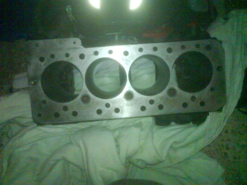

Well been to Bingley Hall today, got a few other bits n peices!

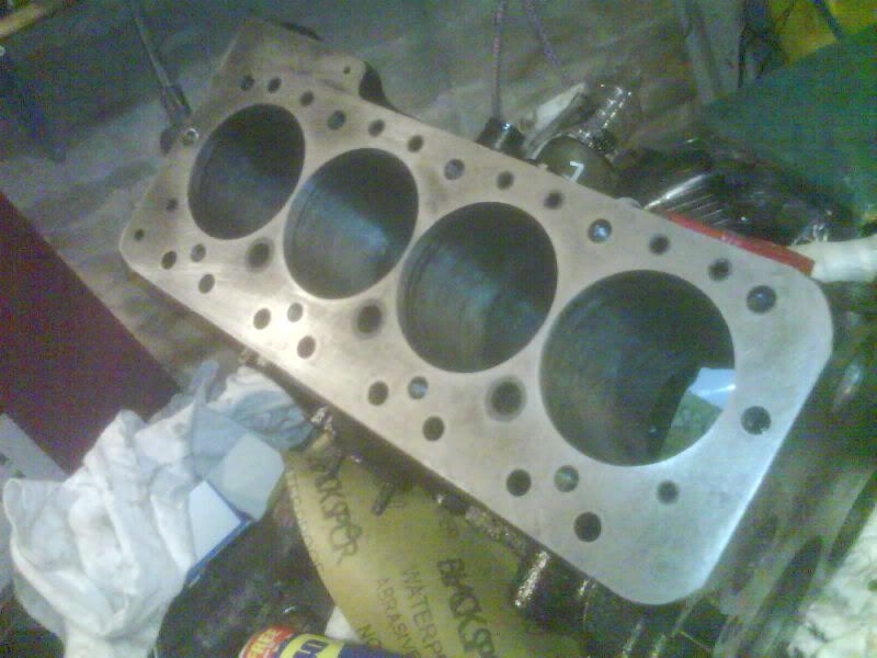

11 stud, 1380 Block ;)
Only £40 :wub: wooo! Bit better than £300 to get mine done!
I think its an A Series block... need to find out what A+ bit fit now...

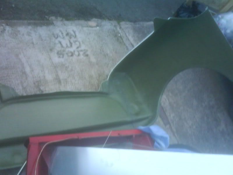

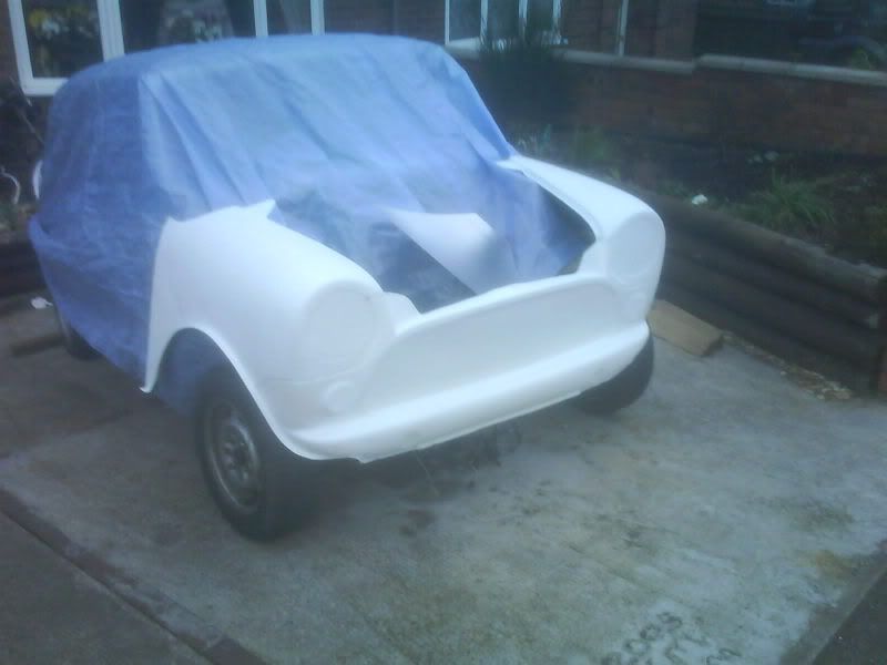

Carbon Fibre & Kevlar mix front end :P everyone kept asking me questions about it on the way out lol
Bit of fettling needed...

Posted 28 January 2007 - 06:53 PM
i take it its not going to be a flipper what with the a-panles on the front

Posted 28 January 2007 - 07:03 PM
Its can be, not a problem...
But I've for the chop the A-panels off, as Ive extrunal hinged Panels...

Posted 29 January 2007 - 11:39 AM
11 stud, 1380 Block
Only £40 wooo! Bit better than £300 to get mine done!
Bloody hell, where were you going to get that done, I got mine done for £160 which included chemical wash, rebore (1380), skimmed 15 thou, crankshaft polised and balanced, piston rods fitted to pistons.
Looks as if it needs a hone though, but good price ;)

Posted 29 January 2007 - 04:59 PM
Yeh expensive isn't it, reason why I got a S/h block, its ok, doesn't need a rebore or a hone, its looks dirty because the bores are oiled...

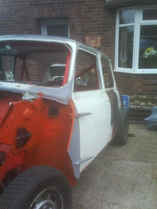

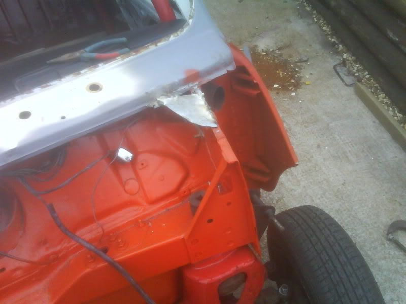

After a day working on the Mini, I'm not far from fitting the doors, so I shoved my old doors on just as a test...
Looks awesome!!!!! I can;t wait to get my doors on, and bolted up.
(Please note, the doors are just placed into the recess, they are not bolted in yet....)

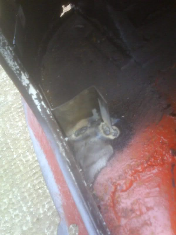

This was funny... it was easier to put the cage back in, than it was in the first place!! How weird!

You need to strip the A-Panels off, so all you have is the flinch panel, get yourself an inner A Panel (aftermark one are good (£7)) weld that onto the flinch panel... then weld a Mk3 on, A Panel over the top...
Remember if fitting Exturnal hinges... the doors need to be lightened a little, otherwise you'll put excess stress onto the hinges...

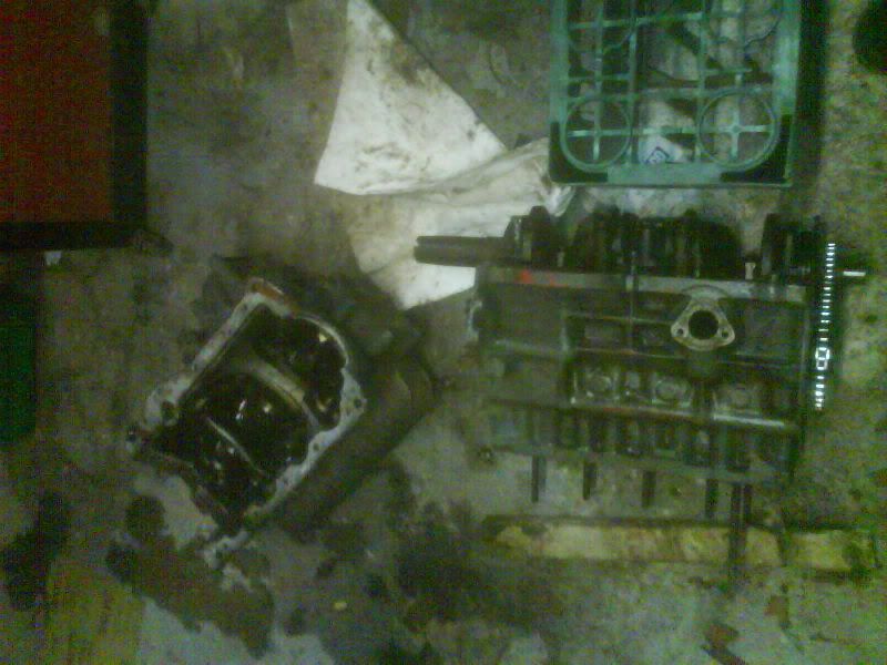

Split a 1275 engine over the weekend - this is a 1275 A+ Turbo enigne... who ever had it last used Bathroom sealant as a gasket :dontgetit:
And the engine bit me! basturd! :- :bah:

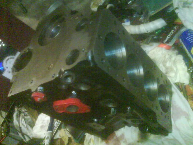

My new 1380 block ;)
I've ordered a NEW crank, and I've got to order my new Powermax pistons, and balanced rods, along with a Morspeed Trackday cam...

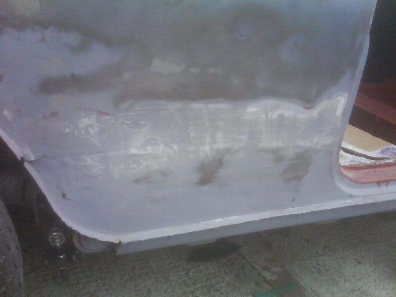

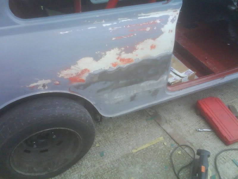

Started doing some sanding - bloody boring job that is...

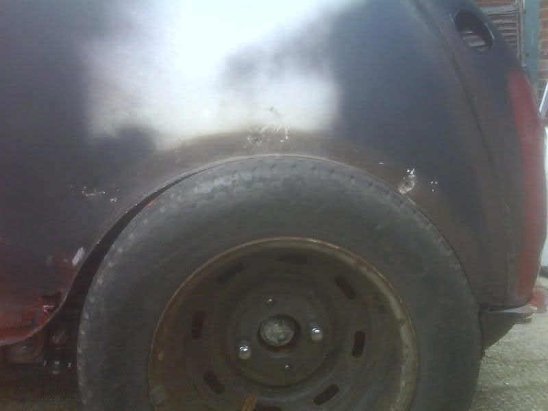

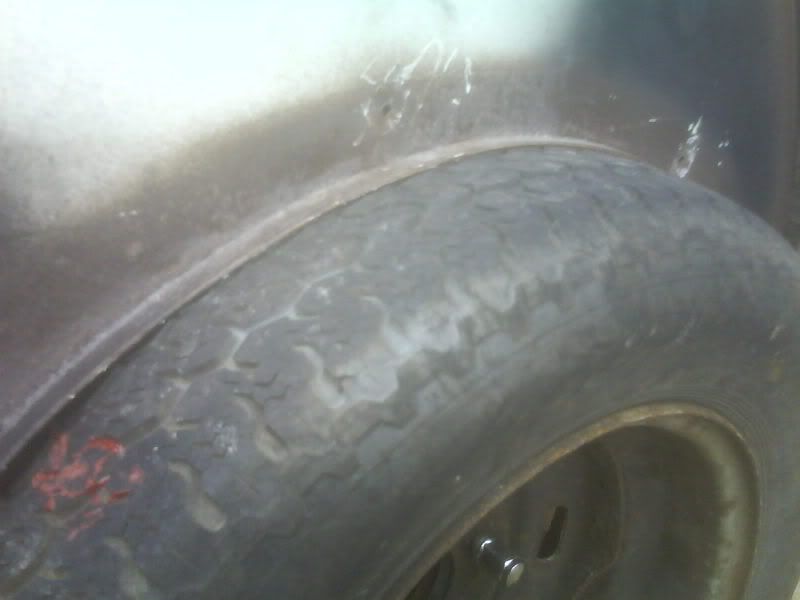

and finially some random pics... I also turned the steelies inside out... jiust to see what it'll look like...
Someone say the Mini isn't low?

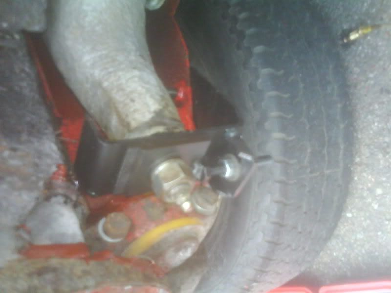

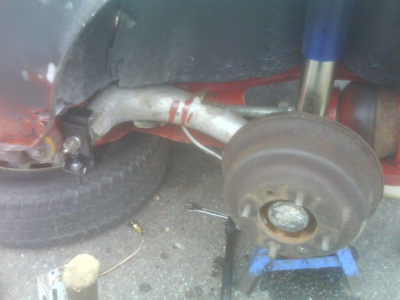

Adjustable brakets fitted, along with my braided hoses that I have gotten for the brakes and clutch...
And due to the manafatrure of the brakets... Minispares... the bolts wouldn't go on... so some mild w=tweaking with the drill was needed, and I had to round one bolt, and put a slot into the top, to make it a screw to get it on!!
