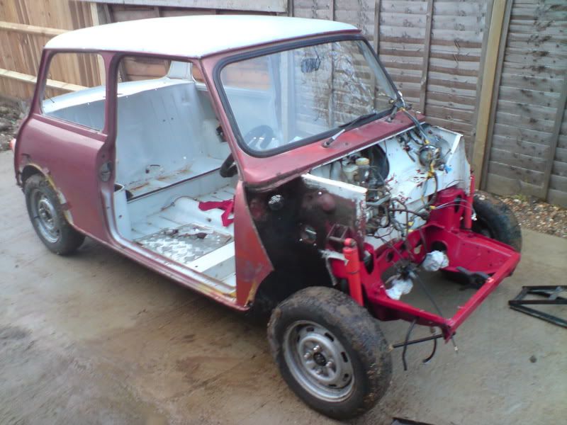

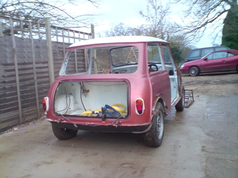

the car is stipped to a bear shell again, all arches, windows etc are of!
hopefully getting a gearbox and some other toys for my engine soon! saving up for a spray job at the mo so not really spending much if i can help it.
aiming for back on the road for Malvern next year! and i WILL be driving it to IMM09 in Brum even if i have to flintstone it!! :lol:.. lol

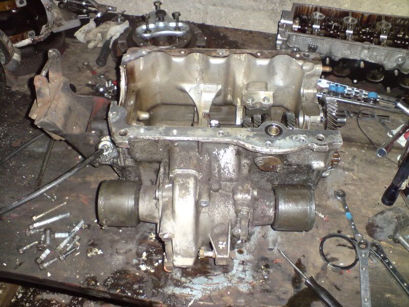

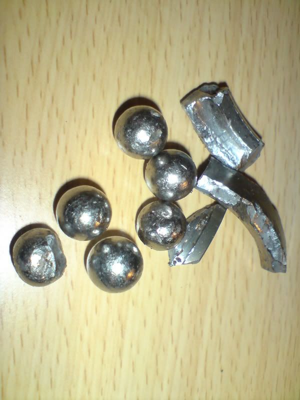

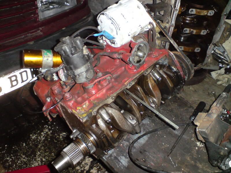

Well it’s been a year (yikes that long) since i had the car in the road. And I have finally had the time and space to strip the engine down to see what the reason for it jamming in gear. When I went to a few mini garages they suggested it was the diff pin, which had snapped…
So first job was to pull the block away from the gearbox (after removing the flywheel)

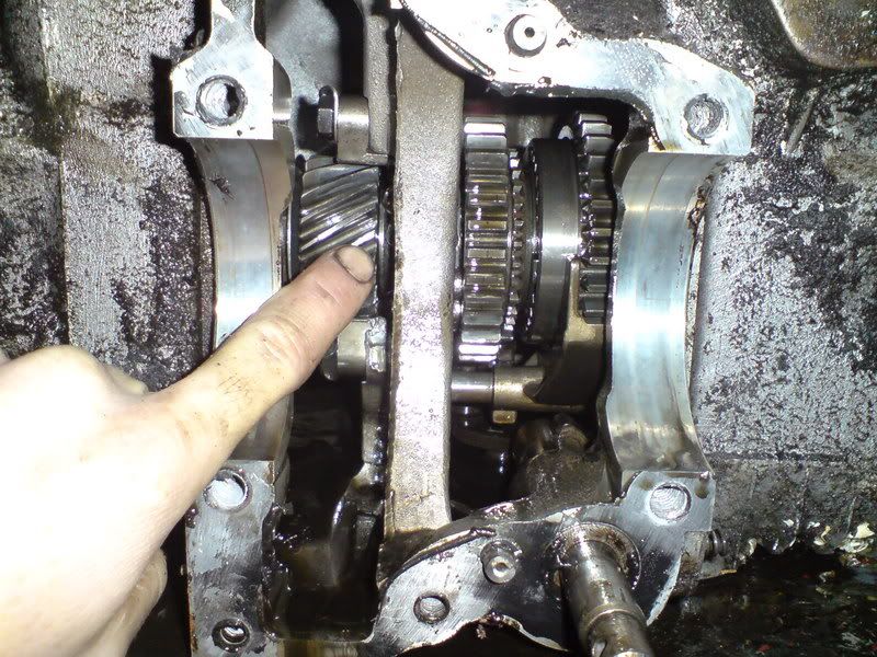

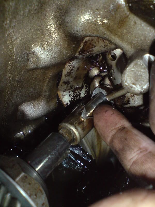

With my limited knowledge of mini gearboxes, I think what’s happened is the speedo drive (which incidentally makes sense as I haven’t been able to get a reading on the speedo since I’ve had it) has sheared its casting mount and allowed the main shaft to flap or slop about causing the shaft bearings to break and also cause the crown wheel to score against the gearbox casing.
Speedo drive
These are the ball bearings, which have shattered.

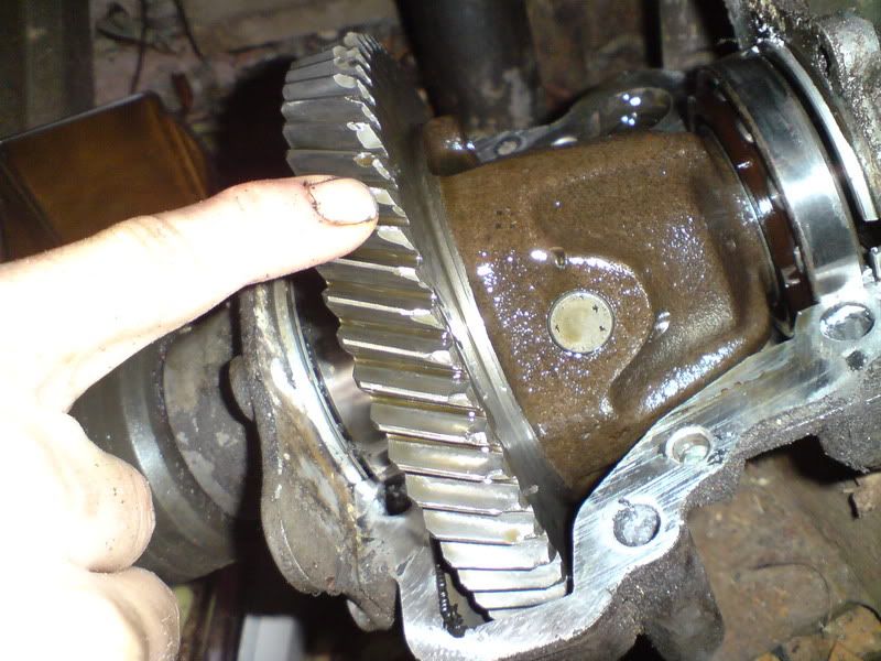

As you can see from the photo below the diff has scored against the box, which I assume is the reason the wheels freed up every now and then.
And here is the some of bearing balls and bits found in the bottom of the gearbox! :S
So hopefully in the next few days I will have a look at a mates metro turbo box, which he is going to sell me. Hopefully that should reduce the power loss to the wheels!! >_<
Well the car is along way of roadworthiness but at least I know what caused the problem..

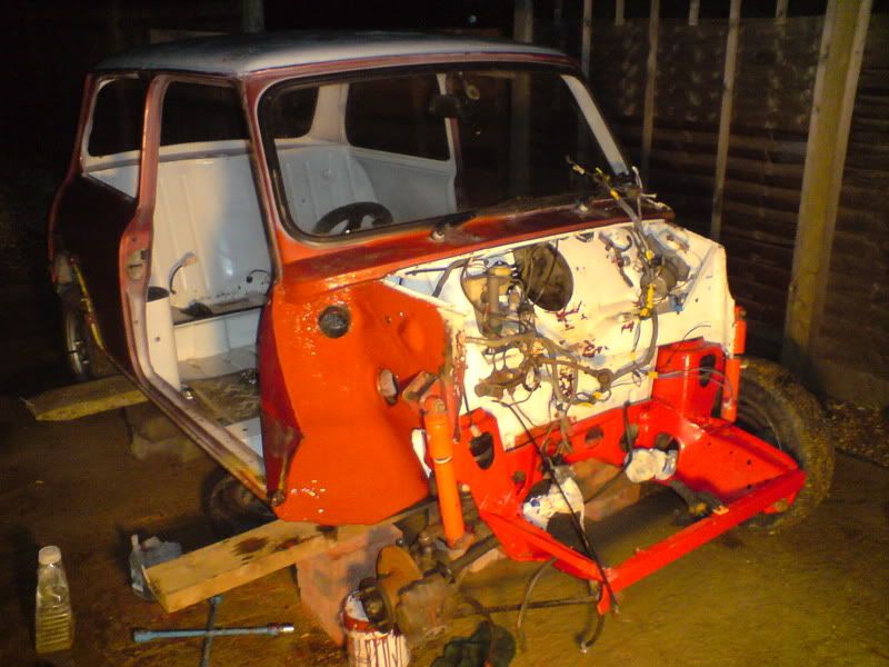

small update, not done much! always seem to have loads of projects on the go! :thumbsup:
so i pulled it out from behind the garage and onto the new concrete my dad and i laid two weeks ago. (sooo nice to work on!!)
got the car on blocks, then stripped and painted the front inner wheel arches with red oxide, black hammerite and thick wax oil next. (functional!)
next jobs to get it ready for paint in easter (hopefully):
not exact order..
  • strip compenents of the engine bay, sand down, red oxide and spray body colour.
  • cut out rear bins
  • buy and fit full roll cage
  • make and fit some brace bars
  • fit flip front
  • set arches for 10 inch wheels.
  • wax oil underside of car
  • tidy up and spray boot interior
  • strip internal brake and fuels lines and start sanding interior ready for paint
  • strip external parts and start sanding exterior ready for paint
  • mask up and spray!! :thumbsup:
if i think of anything else i will add to the list, but at the mo i think thats it.
im also gathering a load of bits together to take down the anodisers / powder coaters.
