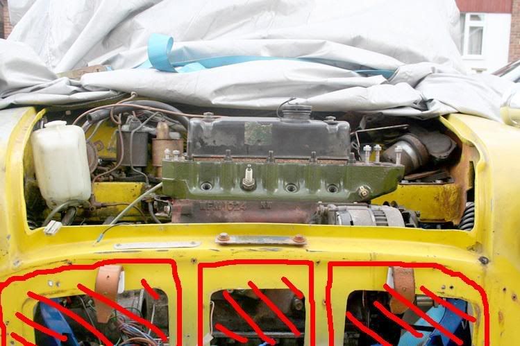

Jammy - Heres my tuppence worth:
Enlarge the holes behind the grill by getting rid of this material:
Leaving two bars in the middle to fit quick release grill buttons. Mount your long F3 rad behind the grill and another smaller one in line on gearbox side if the long one isn't man enough, which it should be.

Even with removing that material, and changing to a smaller starter motor, and a Nippon Denso alternator, and distributorless ignition, and a remote oil filter, I'd still have to have the radiator sticking out the grill by a good inch. And it would still be touch and go whether I'd get a fan behind/in front of it.
Stig told me a mate of his has a load of motorbike rads, some of which he said I should be able to get around my clutch cover, but I'm looking this weekend at mounting my two F3 rads up in the rear subframe, and then just run some lines to the back.

Scrap my idea about putting them up into the rear subframe! Because of the lower boot floor, the battery box and the exhaust backbox theres about enough space for a small cereal box, about 2/3rds of an MPi rad! ;)

can you mount it above the slam panel and have a bini coopers type bonnet ?
#487 Jammy
Jammy
  • 25,397 posts
Posted 18 April 2008 - 06:17 PM
Possibly. Not above the slam panel, but at least behind it. Then possibly a couple of fans next in front of the sparkies, next to the alternator.

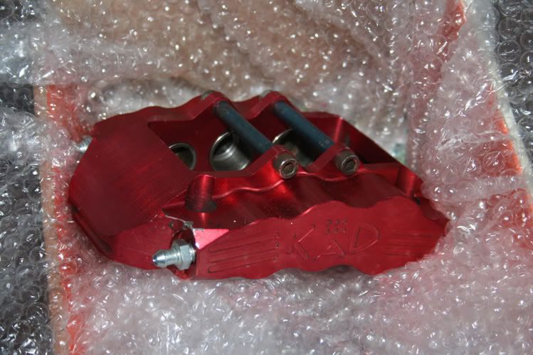

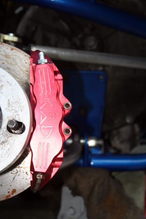

Got the first of two packages I should get this week, and this one was the biggy! :) When preston pill put his 6 pots up for sale it would have been rude of me to have not bought them! Not only do I get more pub points (most importantly), but it also allows me to fit as big a brakes as I can under 10" wheels and still have a decent amount of clearance. Having now fitted them over 8.4" disks, they do fit, but the clearances are very tight. I think when I get more time I'll take things apart and get the disks turned down to about 8.2".
Also had a bit of a scare when I fitted one of the caliper retaining bolts and it started to just spin. Having taken it back out again I realised it was a few mm smaller than the other bolts. I fitted the other bolt for that side and it tightened up nicely, so I've since changed the bolt for a spare. For a few minutes I thought the thread in the hub had gone and that I'd have to take apart the hub assembly and change it!! :mrcool:
