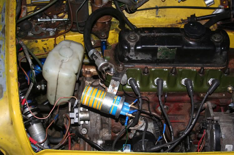

  • Wire up engine
  • Fit carb after buying a fitting correct needle
  • Fit thermostat and housing
  • Fit oil filter housing properly
  • Fit heater tap
  • Fit dizzy cap, HT leads and coil
  • Mount washer bottle
  • Fit front brake pipes
  • Change front brake calipers
  • Get shorter fan pulley bolts
  • Fit exhaust (basically just the link pipe into the Y piece)
  • Fit gear linkage
  • Setup suspension angles
  • Fit engine steadies (might need to buy the one that bolts to the water pump)
  • Fit rear roll cage (needs modifying)
  • Fit harnesses
  • Modify drivers seat subframe
  • Fit DD2 lite
  • Sort out doors (big job)
  • Work out where radiator is going and plumb in
  • Fit arches
  • [s]Change headlights
  • Fit battery
  • [s]Mount solenoid
Still steadily getting through the smaller jobs, leaving the biggies for the weekend. Tonight I took the washer bottle bracket off again, filed a little notch in it, so it fitted better on the clutch housing bolts. Then got around to fitting the solenoid. After a bit of a think I decided to attach the main earth cable that comes direct from the battery straight to the engine via another clutch housing bolt. Doing it this way meant I didn't have to worry about an engine earth cable, and I could just bolt earths to certain points on the engine, plus it also meant I could mount the solenoid on the transfer case and not have to worry about earthing that either. So thats what I've done. Only after fitting the battery, I got one click from the solenoid then nothing. A quick trace with the multimeter found it was the solenoid at fault, so swapped that for spare and the engine span a couple of times on the starter! :cry: So at least I know I'm getting somewhere.
Hopefully my order from Minispares will turn up tomorrow and I'll be able to fit the carb needle, then fit the carb to the engine and possibly fire up the engine at the weekend. Although will have to keep reminding myself to tighten the sump plug and fill with oil!!!
Interesting, when the ignition was on, the sidelights came on. Nothing too surprising you might think, only the headlights aren't earthed yet, and there is no headlight switch plugged in...
To be honest, its not the best use of space, and I don't think I have any clutch housing bolts left without something attached to them, but it does make it quite easy to work on still.
