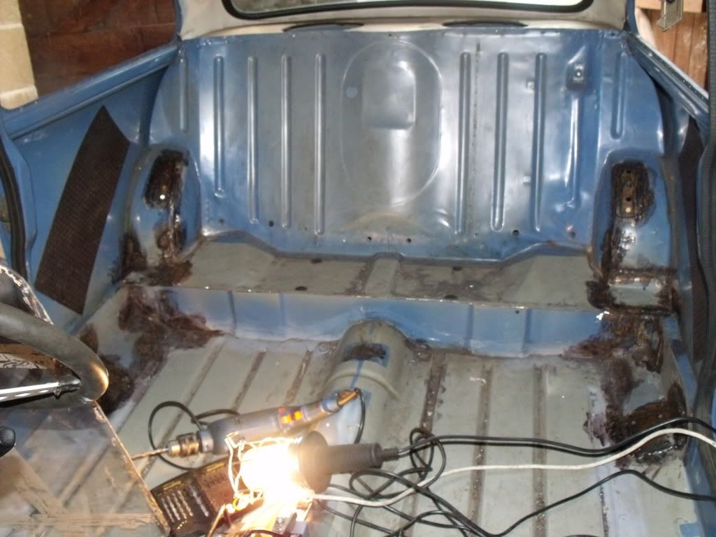

Whilst cutting out my rear bins and seat base to install the rear cage i've found more rust! Thankfully the heel board is still solid so not too bad jus need to plate over some holes in front of the arches. Want to have the car actually on the road this spring/summer so i'm going to plate over from inside and treat as best I can underneath and see how it goes!

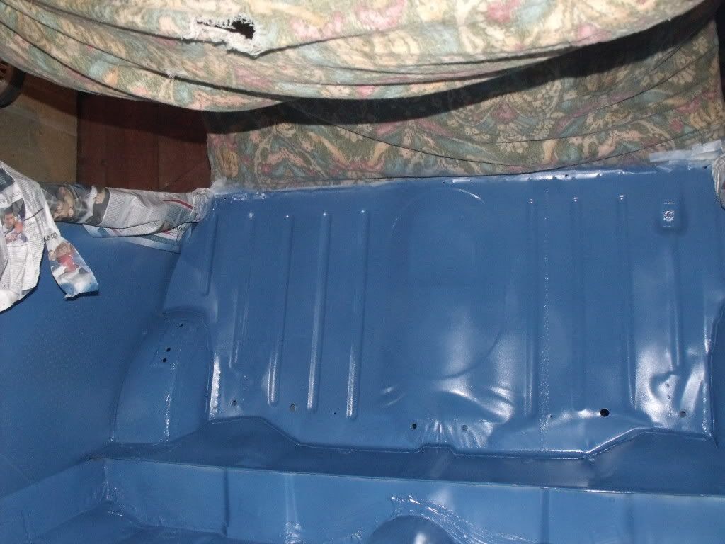

Got the seat base and back sprayed and the cage in and sorted out my seat position nice and low!! Anyways i'll let the pics do the talking!!

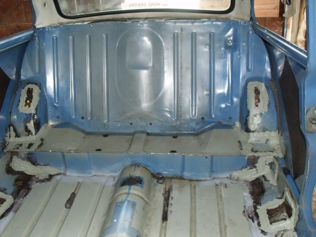

Seat cut out and plates welded in:
Seam sealed:

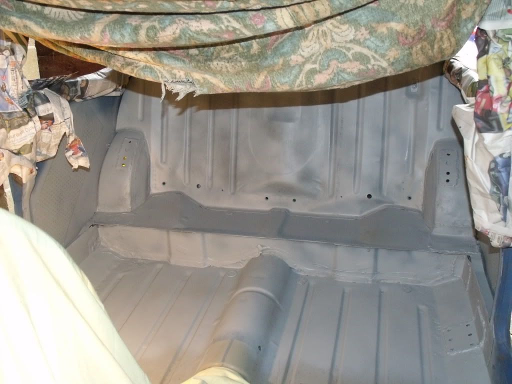

Primer:
Top coat:

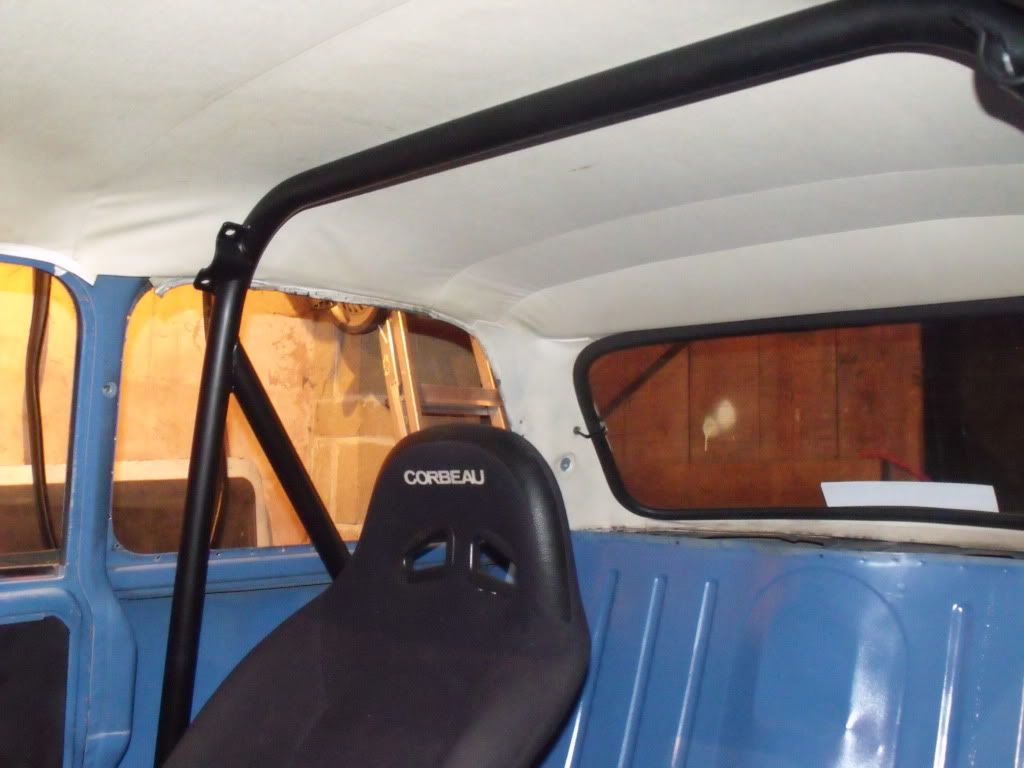

Cage and seat bolted in:

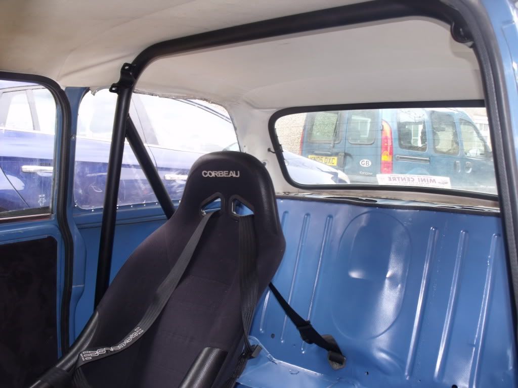

Rear Interior:
Front Interior:
View from the drivers seat:

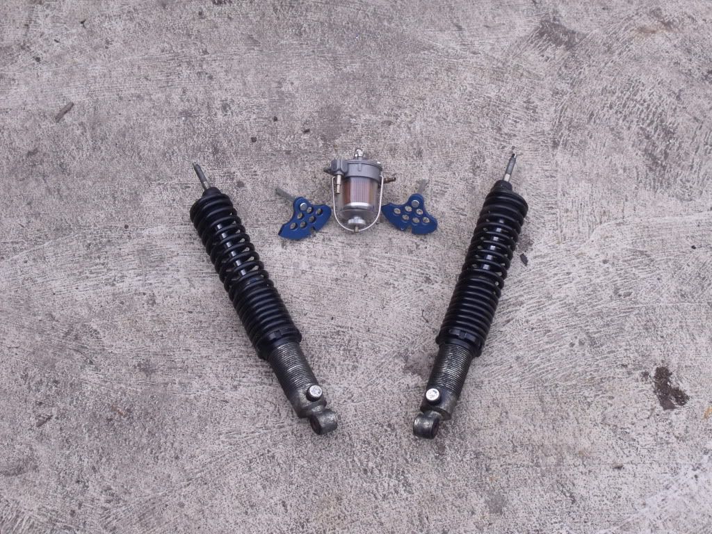

And finally some new shiny bits to be fitted:
