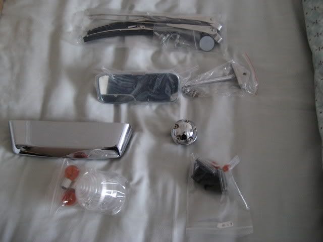

Bingley Bits
Had a good day at bingley today, really good show. Great turn out :).
Heres the bits I bought, mainly chrome stuff. Will be going on tomorrow :-.

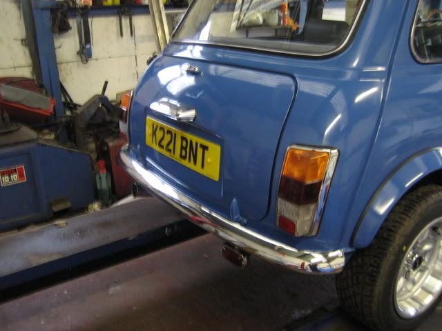

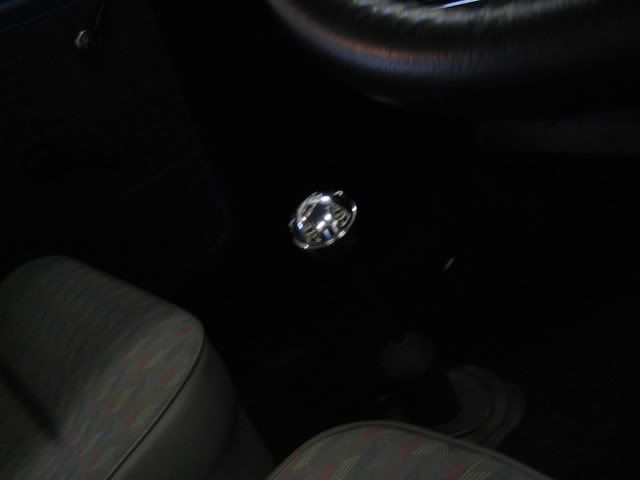

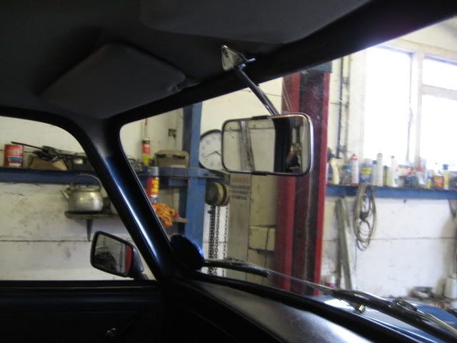

Got some pics with the bits ive put on from bingley.
Clear indicator lenses.
Chrome wiper kit.
Chrome numberplate light.
Mirror
Gear knob.
Paul.

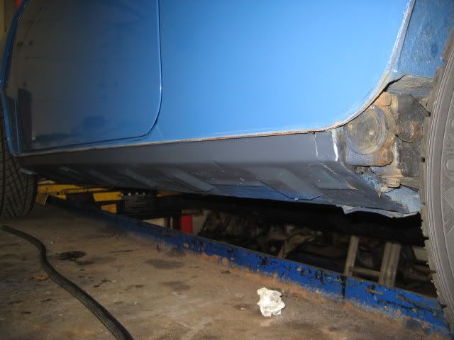

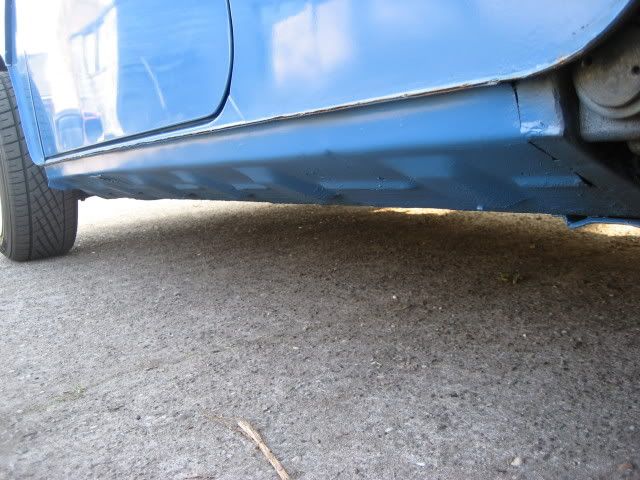

Noticed the paint on the sills was chipping off as I didn't stonechip them, so Ive gave them a coat of stonechip and they will get a colour coat aswell.
The arches have gotten badly stonechipped because we didn't put enough paint on them (1 coat I think :)) so they will get a few thick coats of paint. They are all preped now and ready.

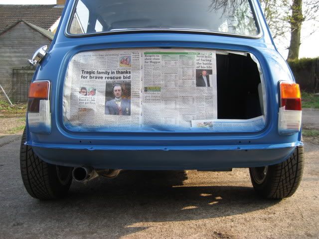

The back hinge panel, the paint was chipping off, dont know why, so ive cleaned it up, preped and now ready for paint.

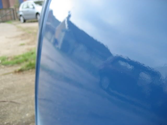

Also done a test panel today to see if I could spray, because my dad sprayed the car and I have only sprayed primer, which is easy to do.
Seeing as its my first time with colour coats and think its come out nice, might be slightly better than dads finish :o.

Sills stonechiped.

Finish of my first go at colour coats (finish straight from gun)

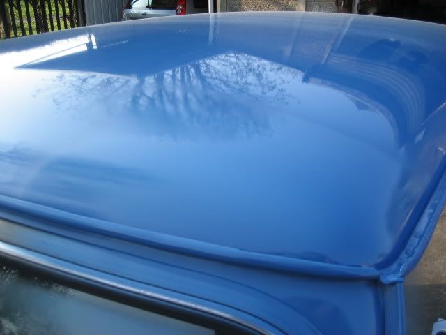

Done a bit of spraying today, got most of the bits painted just the arches and the drivers wing to do.
I sprayed the drivers wing and it fish eyed because theres still brake fluid on there, so its going to need to be flatted back down to almost bare metal, primered, flatted then painted.
Other panels have come out spot on!
Roof touched up, can just about see the area Ive painted.
Sills painted.
Back hinge panel painted.

I know a sprayed the seals, lol. 1st pass I did, I catched them, so I thought stuff it, its done now, no point in masking it up :thumbsup:. It will come off with thinners anyway, the beauty of cellulose ;D.
