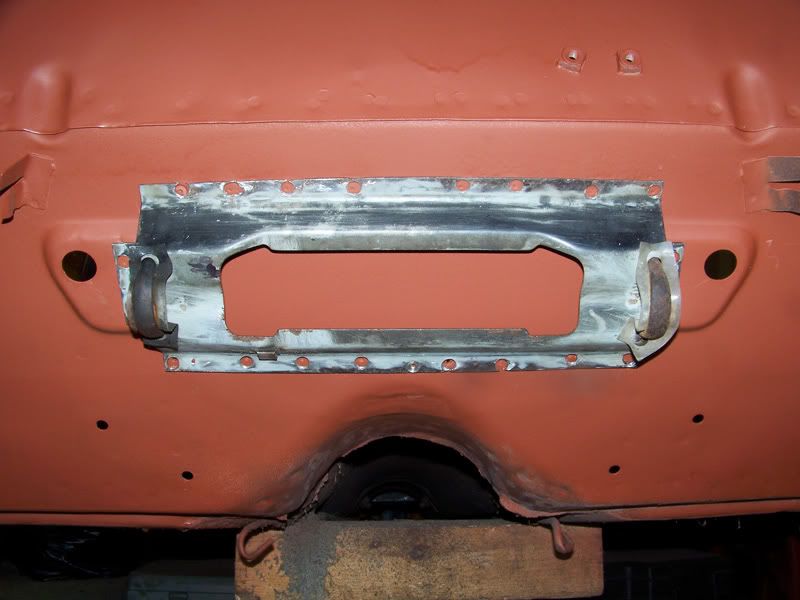

More:
Steering rack bracket removed.
Grotty.
Bulkhead quickly cleaned up.
Took longer than I expected to remove the bracket. More progress tomorrow. I'd like to get the bulkhead and under the wings in their first coat of primer before I come home.

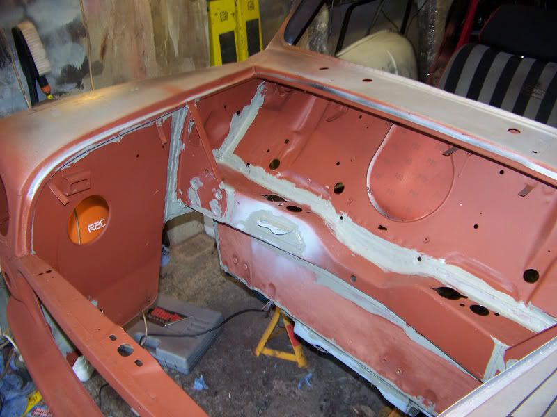

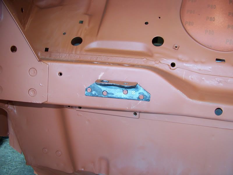

Didn't get a huge amount done today as the majority of the day was spent running about collecting bits here and there that I needed. Here is what I got done though:

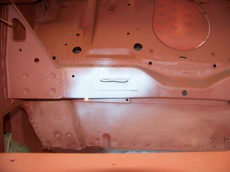

Bulkhead now dry, few runs I'll have to sand out but all good otherwise.

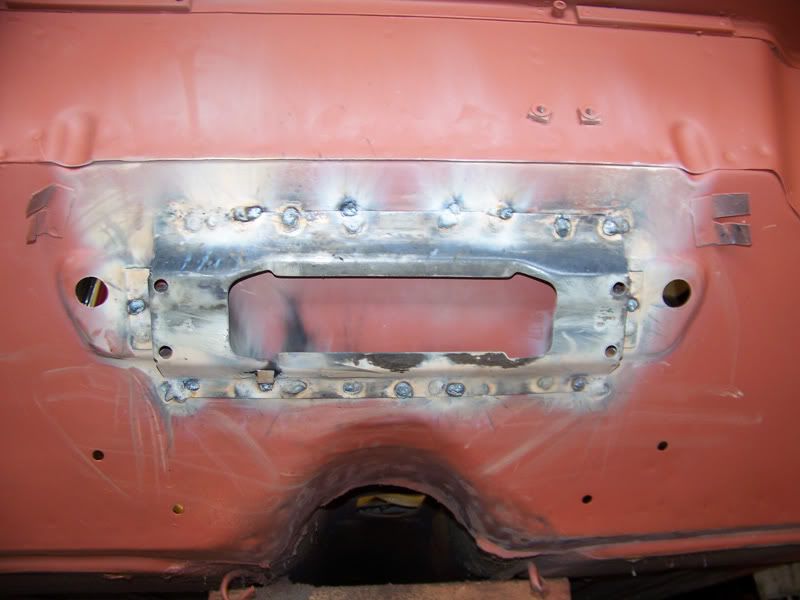

Positioned the steering bracket by the measurements I took before removing it as well as using the steering rack U-bolts to ensure the holes lined up.
Plug welded back in place.
I just need to remove the screws I used to hold it all in place, weld up the holes they left behind and grind the welds down, then I'll move on to the engine steady bracket, dress them both and get seam sealing! That won't be until Monday though as I'm off to MITP tomorrow :thumbsup:.

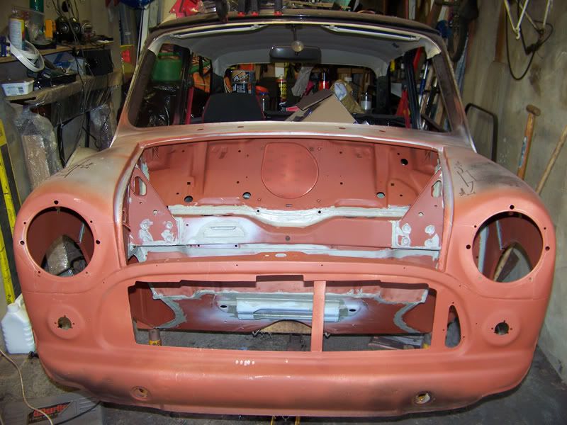

Righto, todays work!

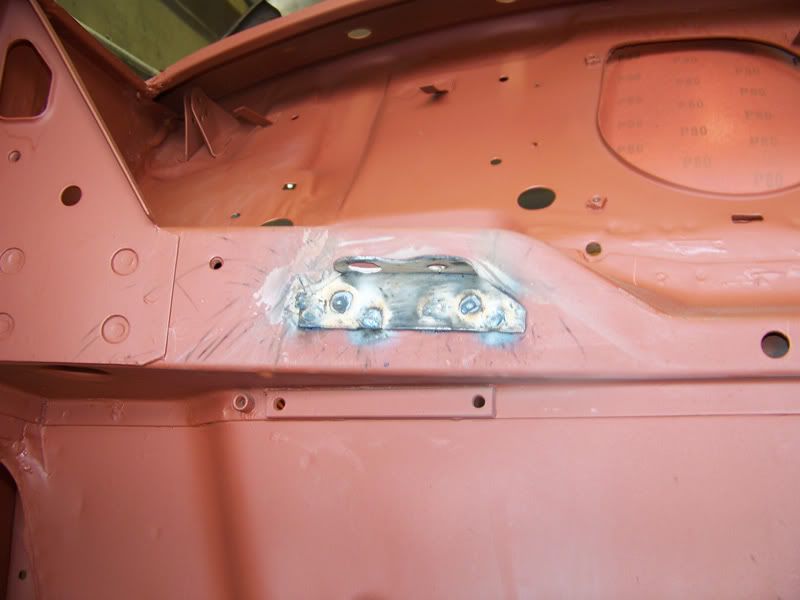

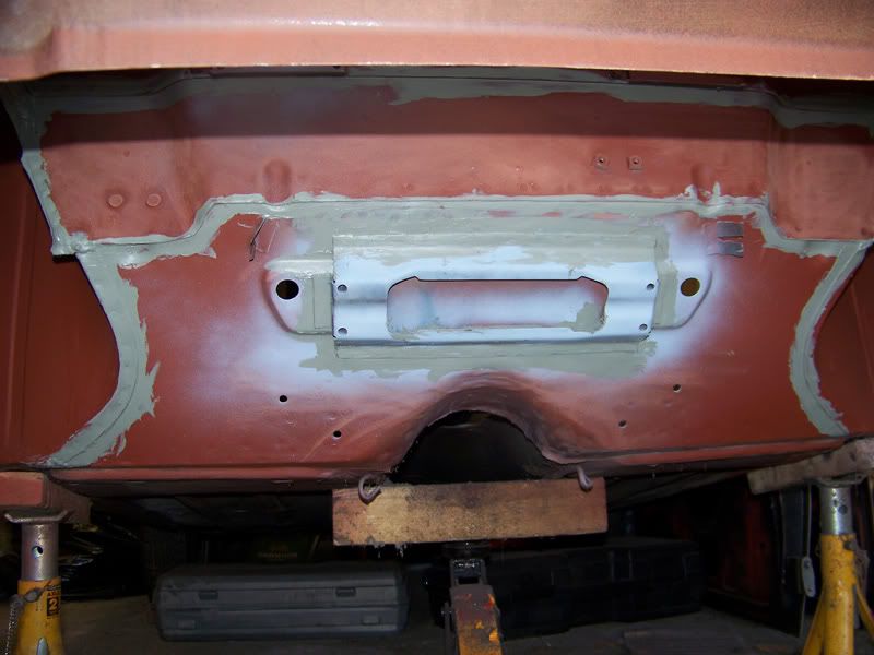

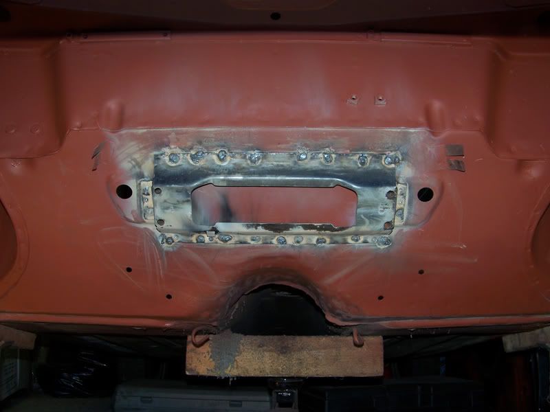

Engine steady bracket held in place with self tappers.
And welded on.
Steering rack bracket finished up.

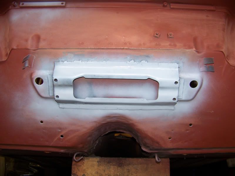

Welds dressed then cleaned off and etched.
Same goes here.

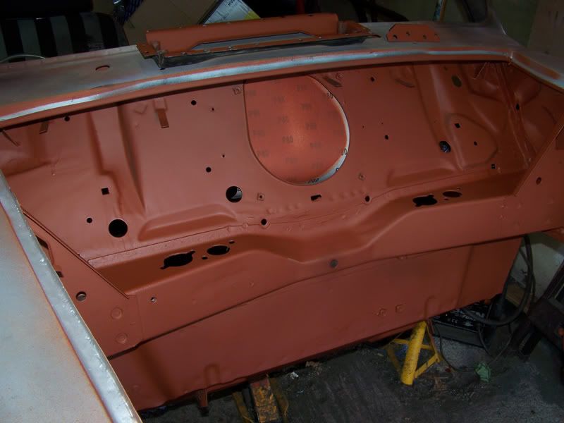

Did all the seam sealing I needed to in order to be ready for the next primer coat.
All sealed.
And the bulkhead.
Plan is to head down earlier than normal tomorrow, rub the front down again and apply another coat of primer before 11am. Then I can leave it to dry all day and come back to put a coat of black on which can have overnight to dry.

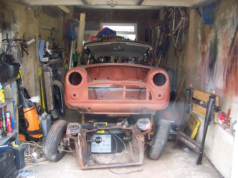

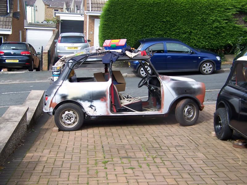

Here's todays stuff.
I decided to leave painting the bulkhead and the inner wings until the welding is finished and I'm happy with it all, just seems pointless to put primer on to burn it off again.

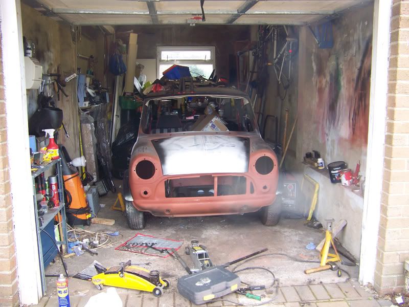

How I found it.

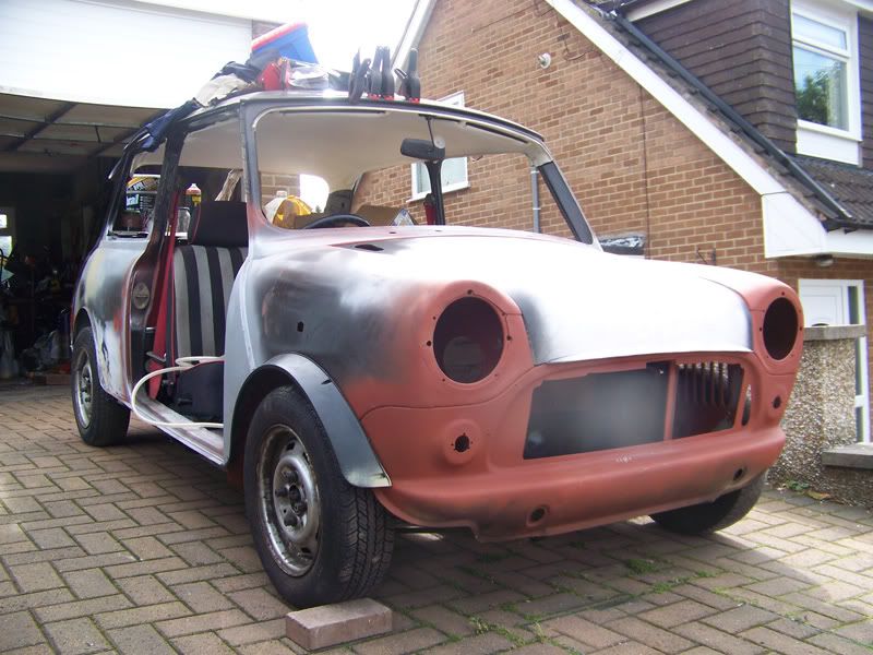

Back on it's front frame.
Rolled out the garage, hi-lo's wound right down.
Performing a 10 point turn on the drive, which is a slope proved a challenge. Really made me appreciate a car with an engine haha.
Tomorrow I shall start work on the heelboard ends I think.
