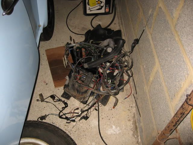

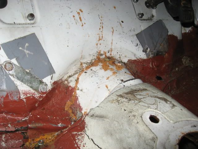

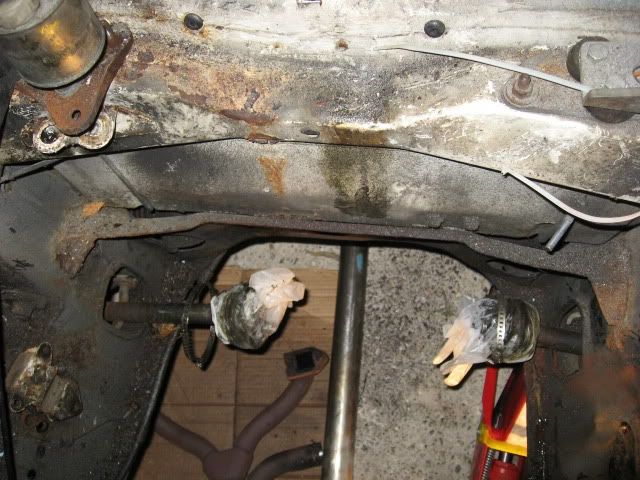

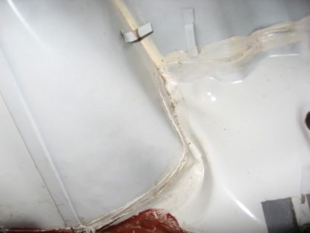

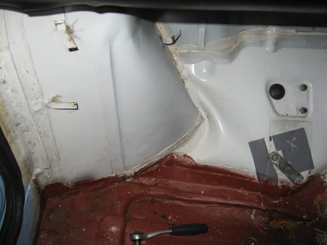

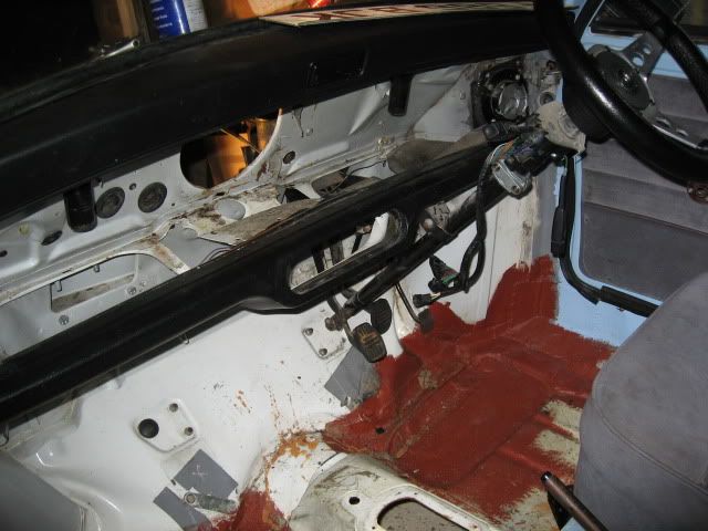

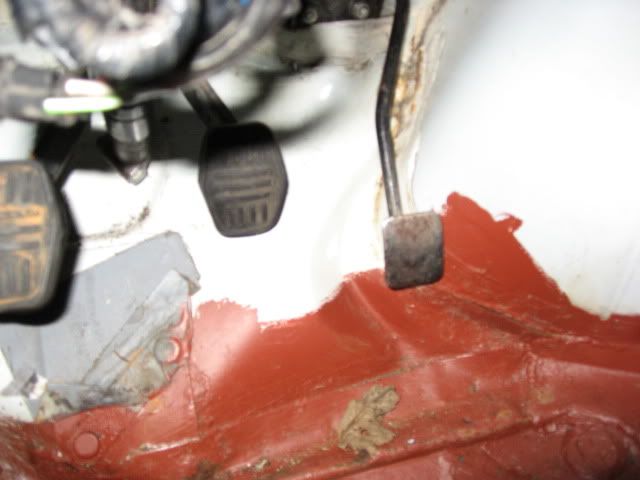

neatened everything up a bit more now, wiring loom gone and a few other bits so you can see the damage a bit more.
the top half of the bulkhead looks ok, only the bottom half has been squashed where it was pushed by the subframe. however im not entirely sure as the parcel shelf has been buckled.

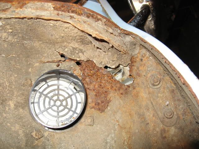

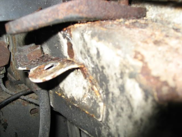

The rust

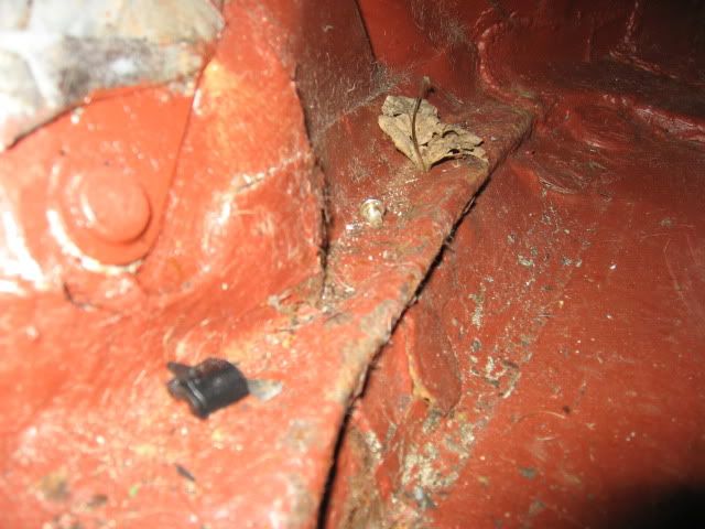

Mini innards

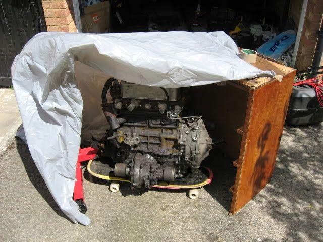

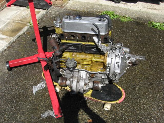

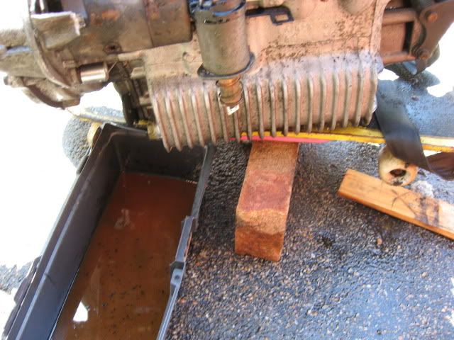

Up bright and early today to clean the engine, nice messy job but looks quite a bit better now, especially the manifold side. Although it will all be repainted anyway.
How to remove oil from an engine sitting on a skateboard
And finally got the head off
Run out of time for today though, so i'll be studying the 'How to build a 1380' DVD and will attack it again tomorrow

Never thought of putting the engine on a skateboard! good idea :P what colour is the engine being painted?

theIMAGE, thanks :) as i said ive got an engine stand but you need an adaptor plate to fit to the a-series and i just cant be bothered with it so the skateboard got the vote. not the easiest to move around and its annoying when your trying to loosen the head bolts and it twists the whole engine and falls on your foot :) but otherwise its good. The 998 will be painted the correct 998 yellow again, it will just look nice and new. the original plan is for something a bit more lairy to go in but it all depends on monies and its not looking good at the moment. so she might be 998 again for a while.
