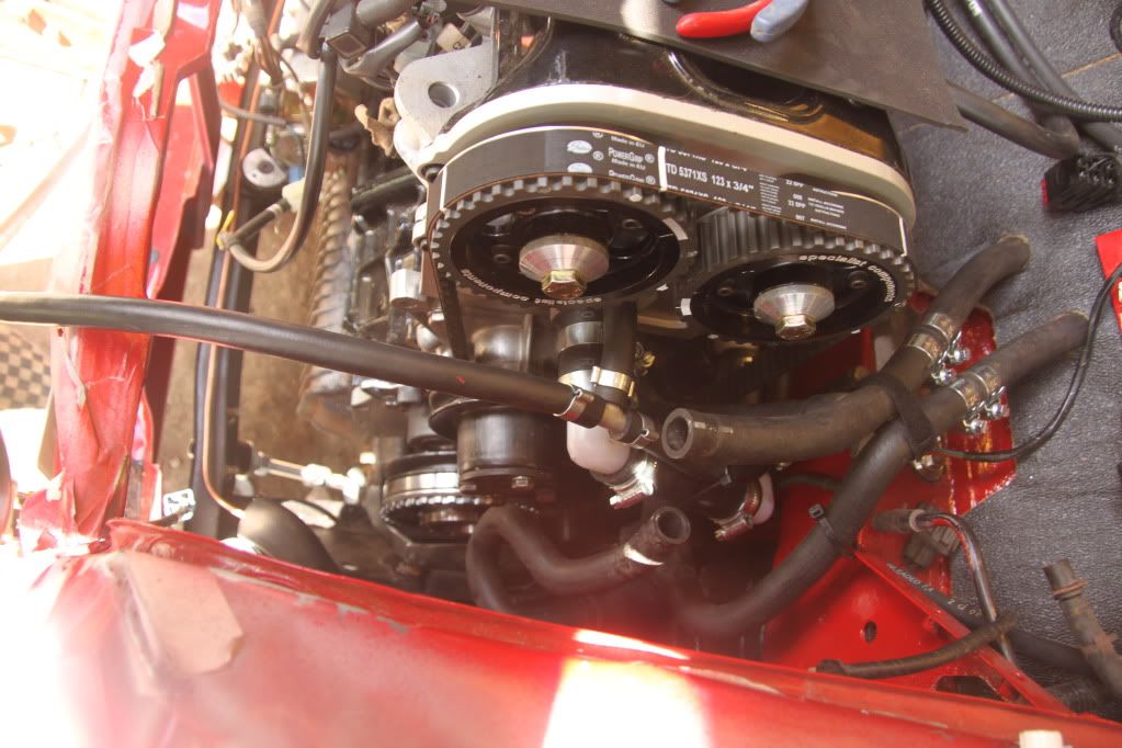

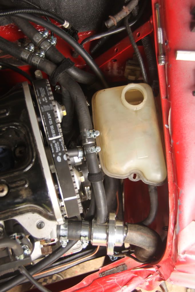

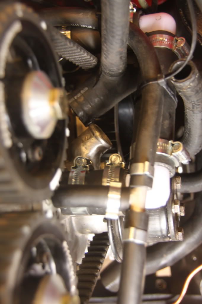

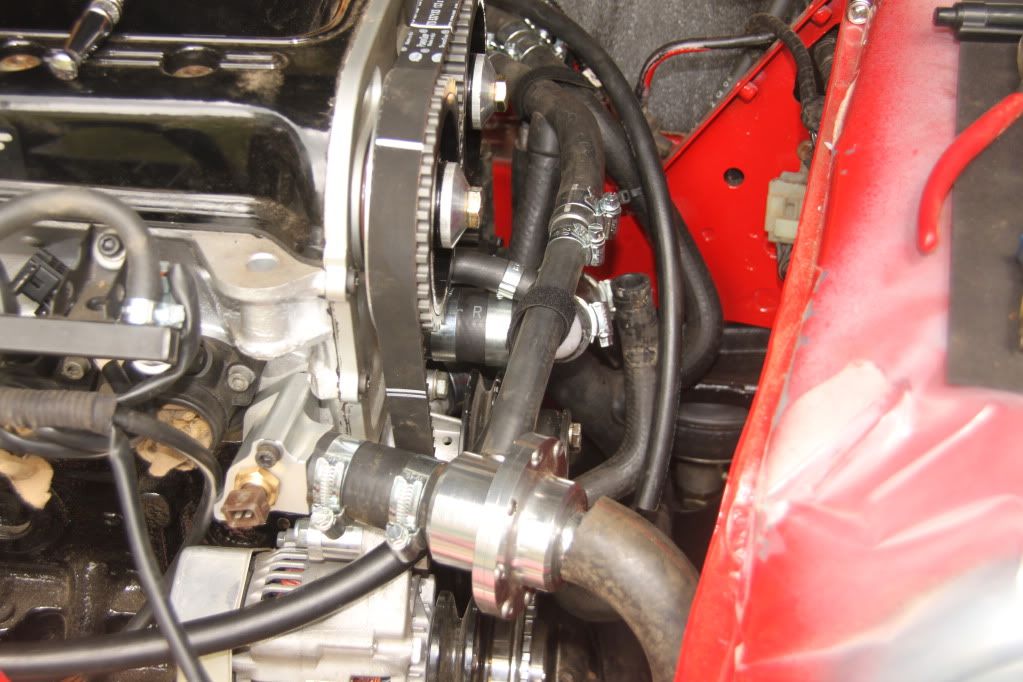

So today, I managed to get a lie in :thumbsup: lol. But I've started to pipe it up - the breather and oil drains are connected up, I'll let the pictures do the talking, I'm to tired :P
You can just about see the re-angled water pump outlet.

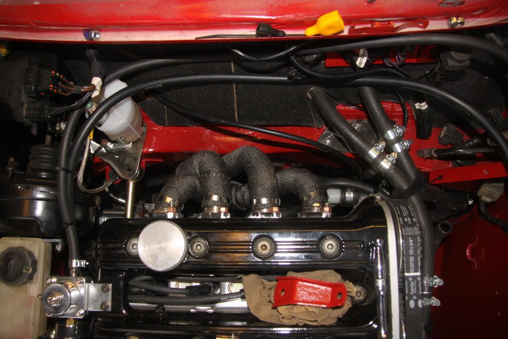

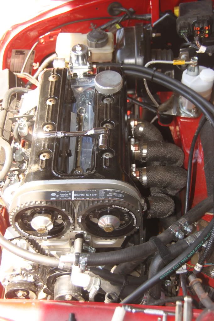

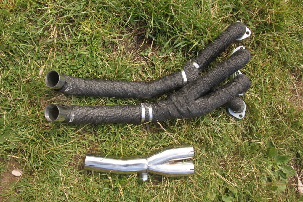

So all I could really do was wrap the exhaust and not alot else -

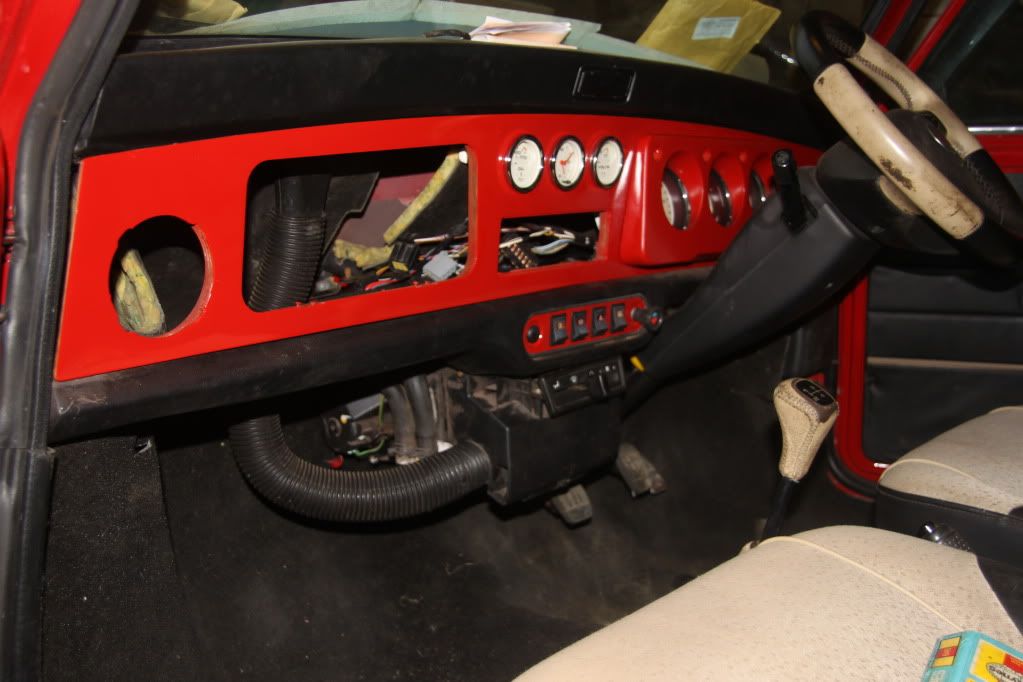

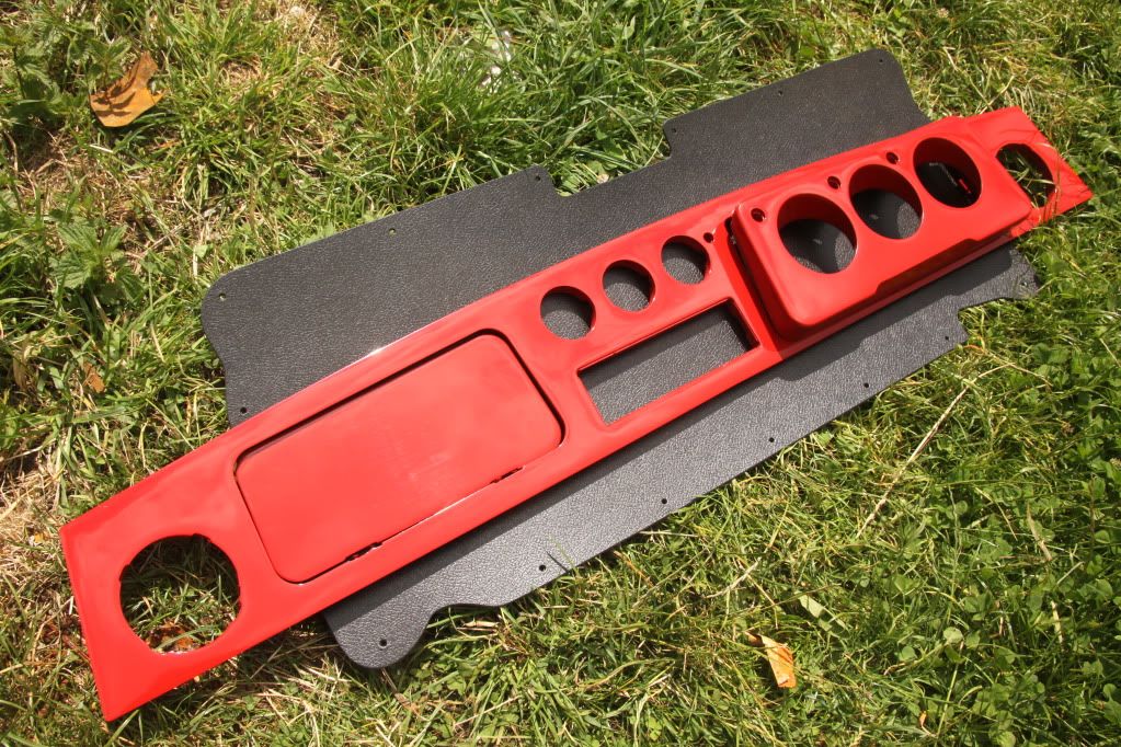

The dash is nearly finished :(

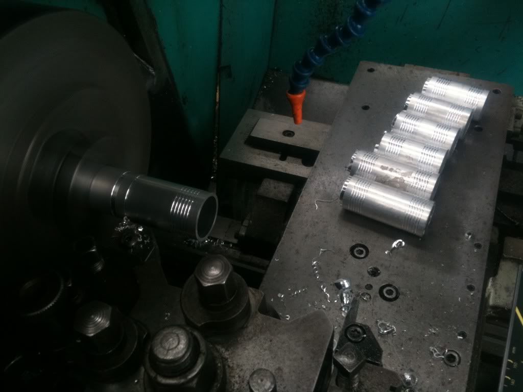

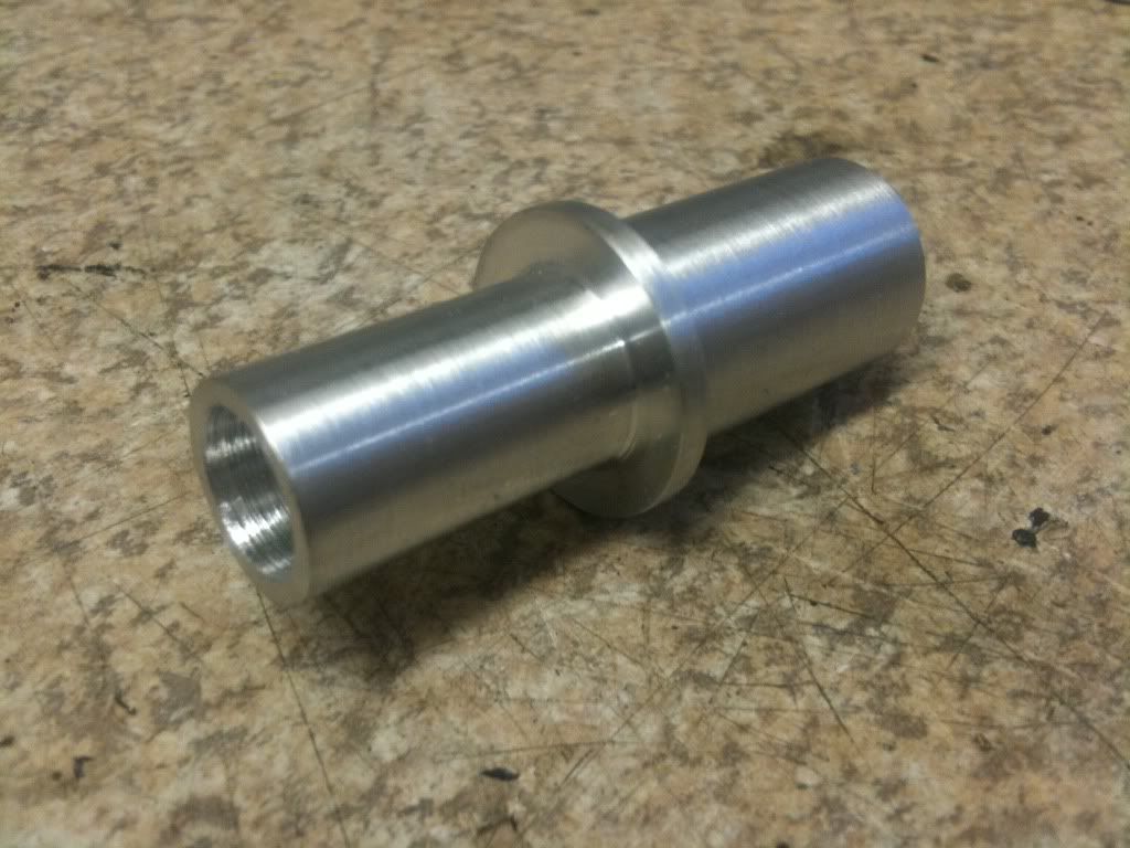

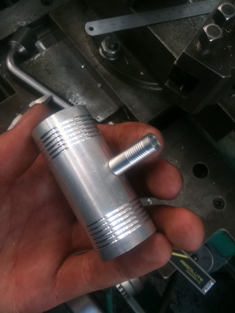

Little bit bored at work earlier, so I made a pipe connector to go from 16mm ID to 12mm ID for the heater pipe to bypass on the thermostat. The aluminium tube has arrived today so I can make up all the hose joiners and get all the cooling in place. I'm waiting for my rad and exhaust still, I'll be chasing Minispeed about that again in the morning ^_^

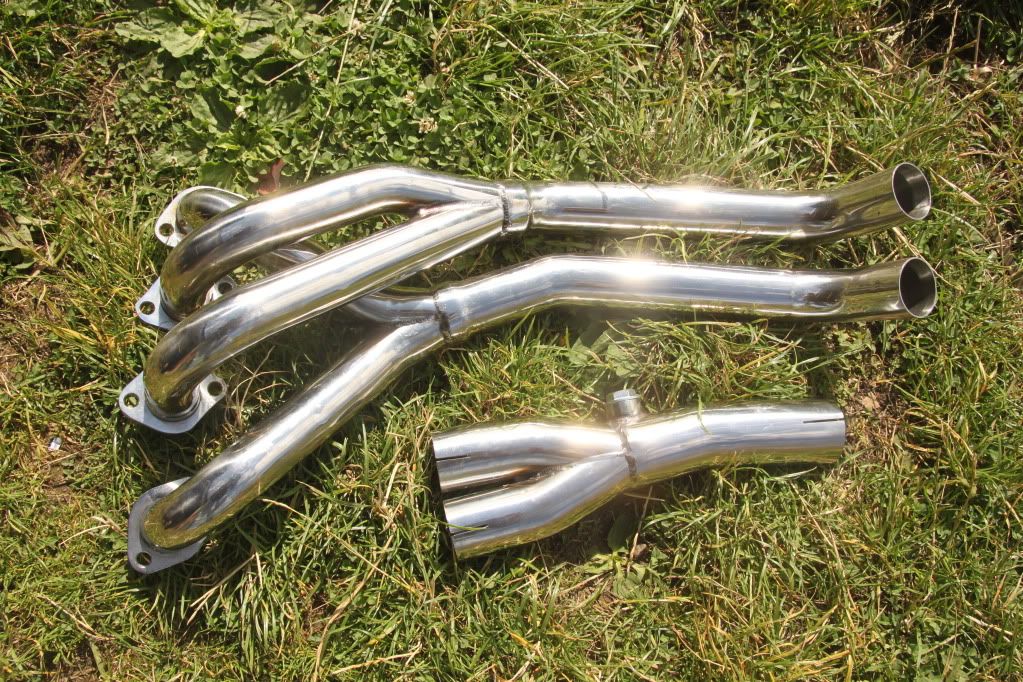

I ordered the leads, coil and bracket today from SC, so should arrive by saturday. Sorted the exhaust with minispeed now, so that should arrive tomorrow, but I won't get the rad until next week, so I'm going to use the original when I fire it up. =]

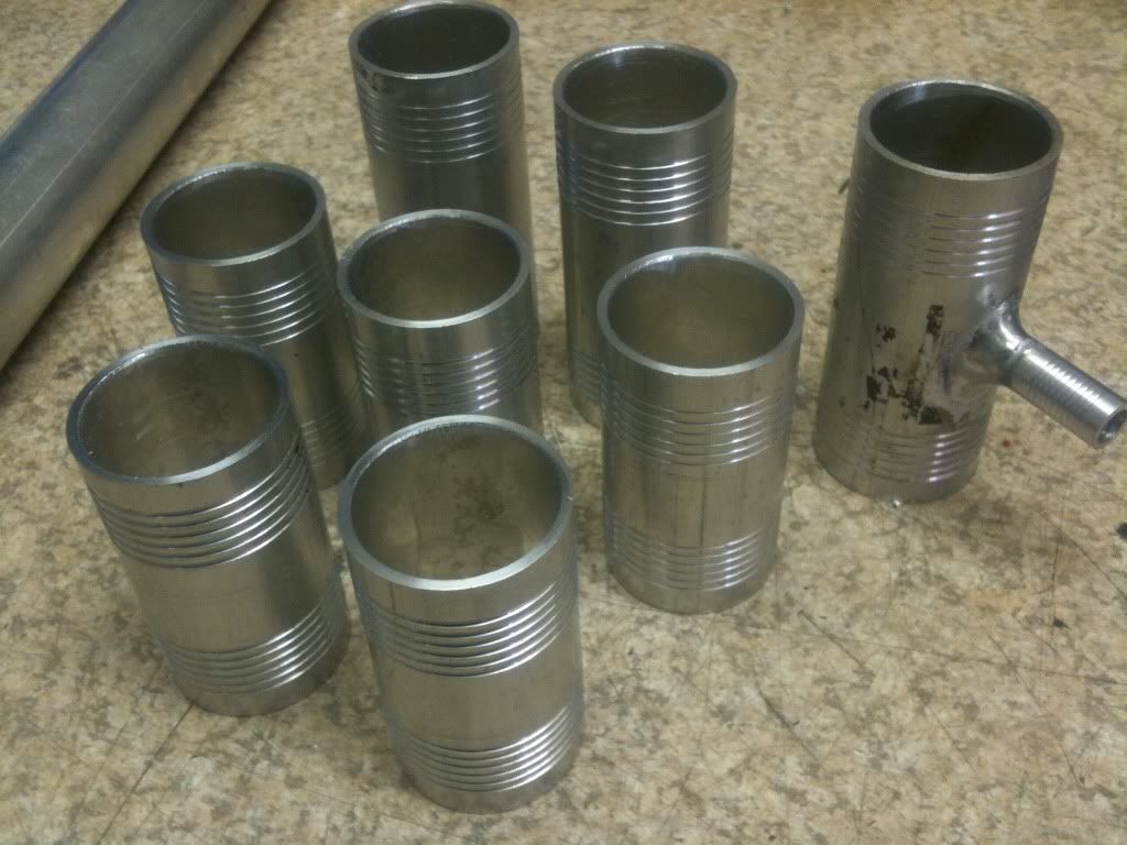

So I was very busy at work again tonight, so busy I only managed to make these hose connectors :- lol all hand turned no fancy CNC stuff here :teehee: -
Connector T for the overflow on the header tank -

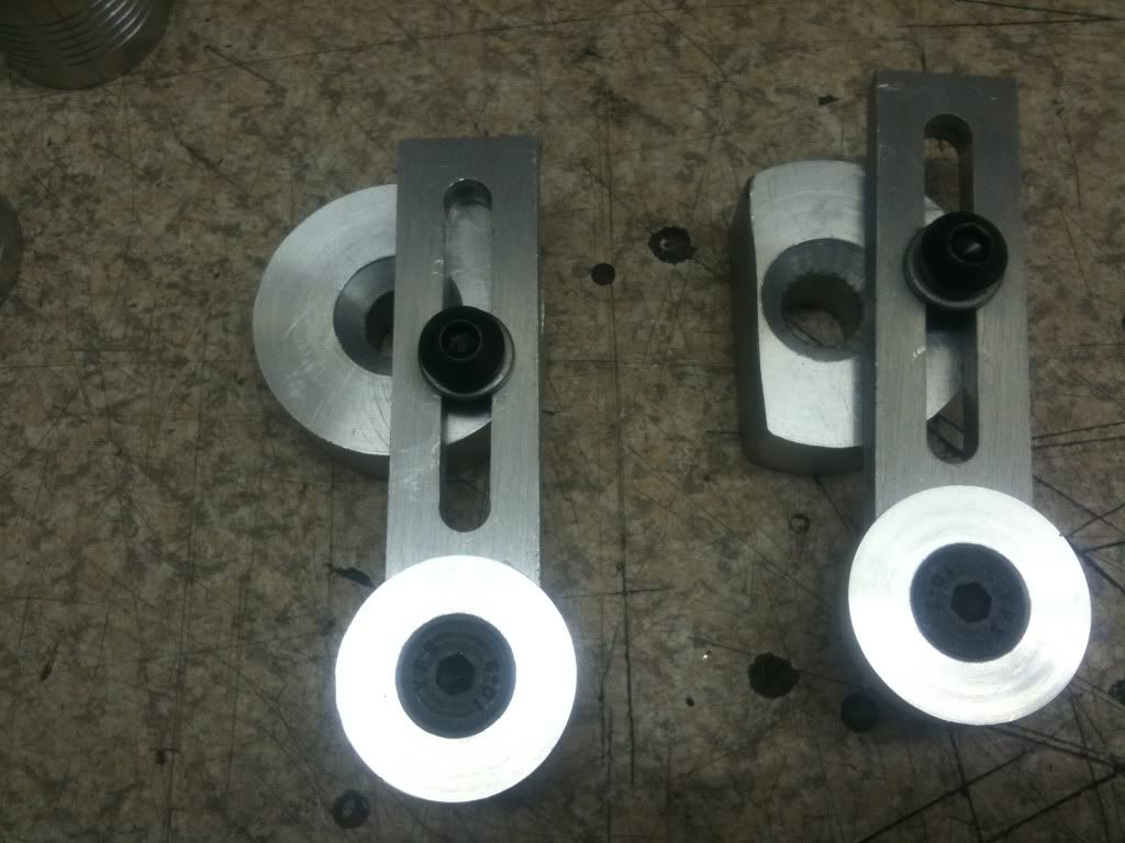

Then these are my redesigned lower rad mounts (I'll get a picture of them in place tomorrow) O_O -

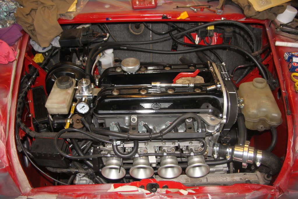

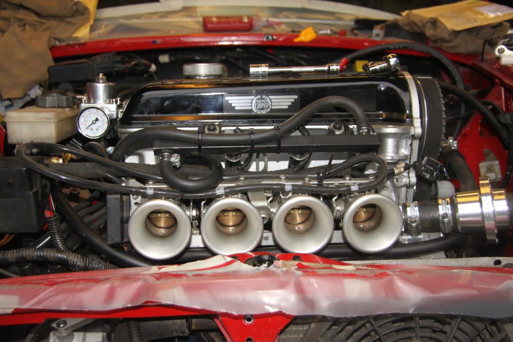

Anyway, here's the current state of the engine -
Yum yum, or brum brum :)

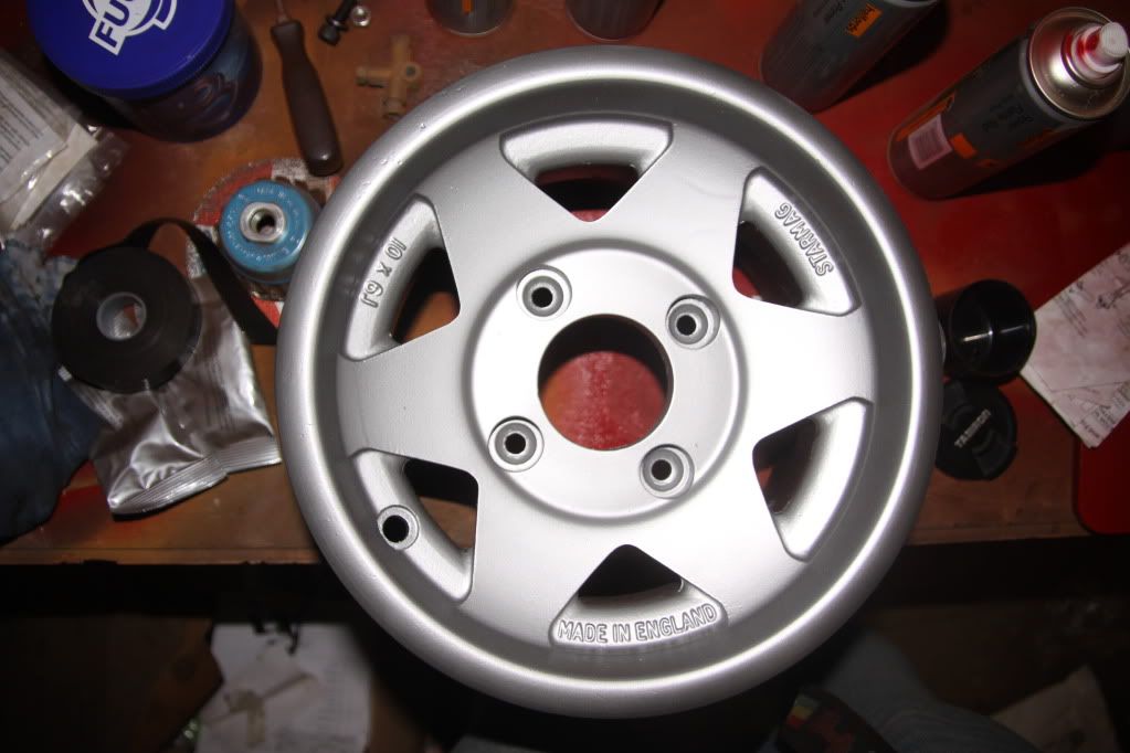

Oh, and my wheel plans have changed, I'm going to run my Starmags on this and the banded steelies on my 1000, I think they will suit it more. And I'm changing them from black to silver :genius:
They should look pretty damn smart with the triangly bits painted black and the uber sexy A032 rubber on them :gimme:
And I'm really pleased with the dash :) just got to put a few more bits back on it.

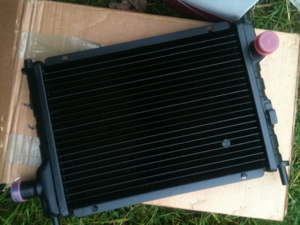

To start with the radiator turned up, all good :thumbsup:

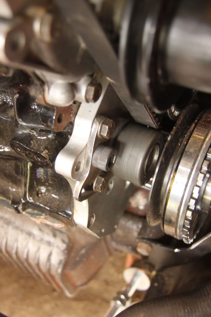

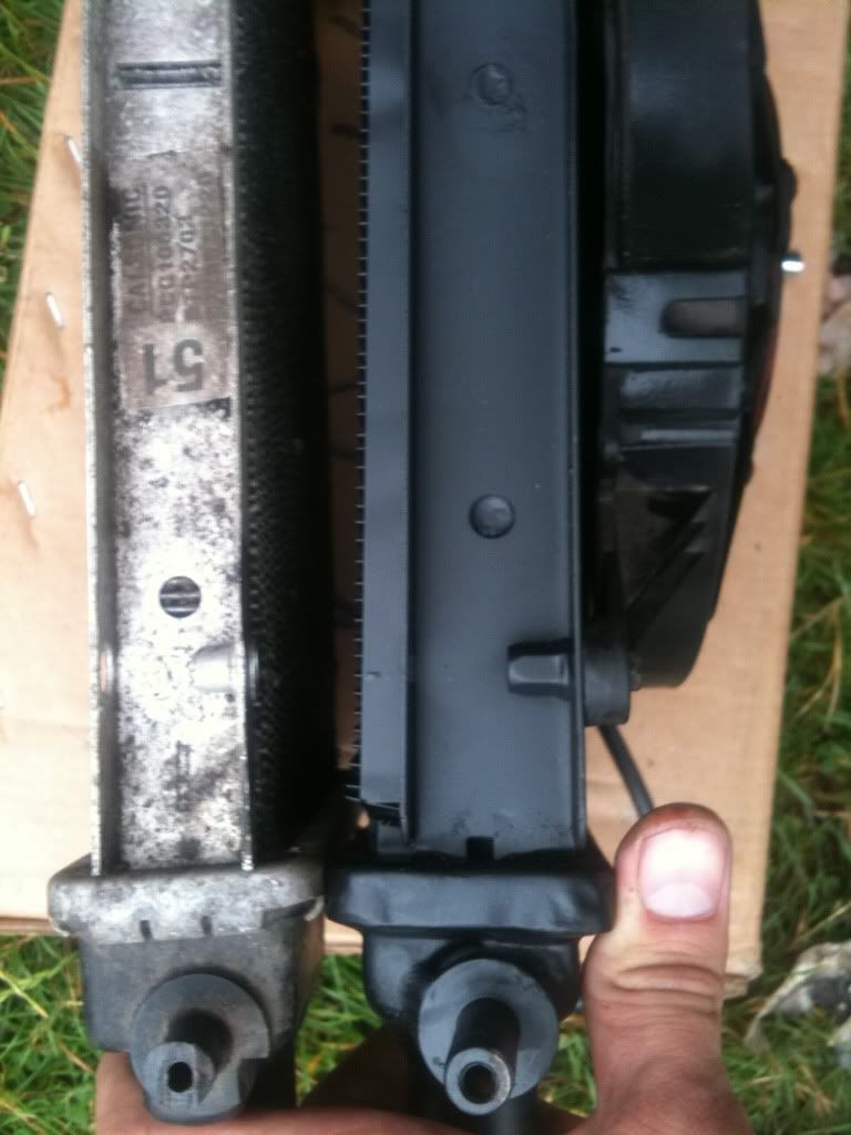

Went to the garage to see if it fitted, it doesn't :) The body work is going to need some more modifying. Because, as I feared the core is thicker :dontgetit: So it hits the alternator.

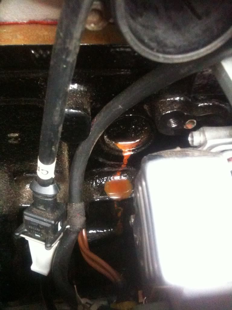

Then to add insult to injury one of the core plugs on the block is leaking :thumbsup: and needs replacing, not a hard job, just a ruddy inconvenience :errr:

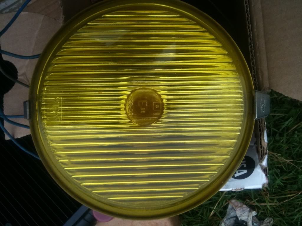

I bought these off ebay, look nice, the backs are chrome and not great :ermm:
