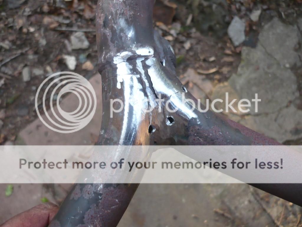

Took off the lcb for a check....the noise made me suspect it was cracked... O_O
Yup...a nasty repair and plenty of new cracks.. I need the car wednesday so there isnt really time to order a new one and wait for delivery, so i had to fire up the welder and grinder
ground off the old welds to get a proper look at the cracks.. then drill a hole at hte end off each one to stop it spreading as its welded
welded it all up and added gussets over the joins to add strength
Just got to stick it back together tomorrow... fingers crossed for decent weather
