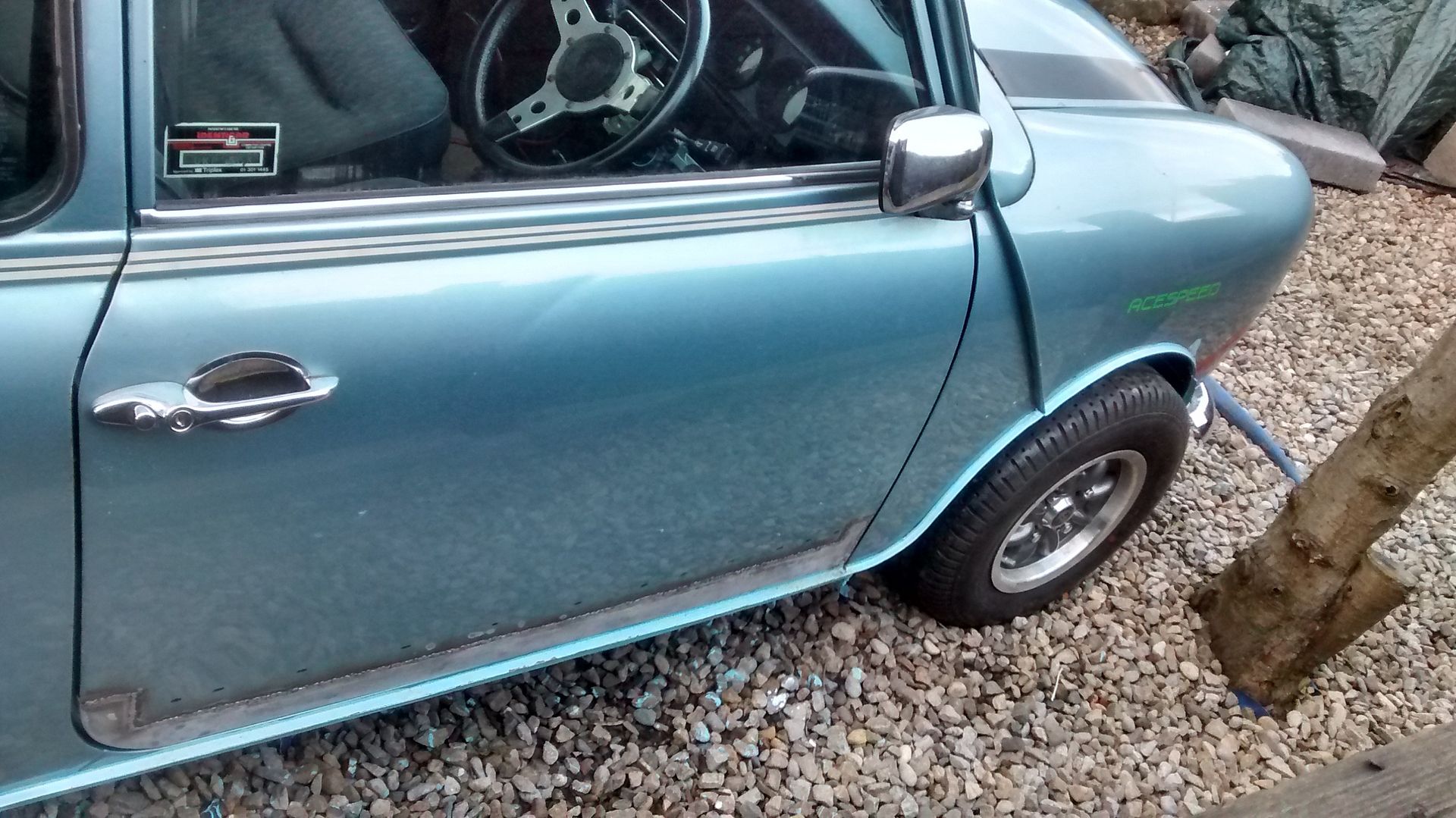

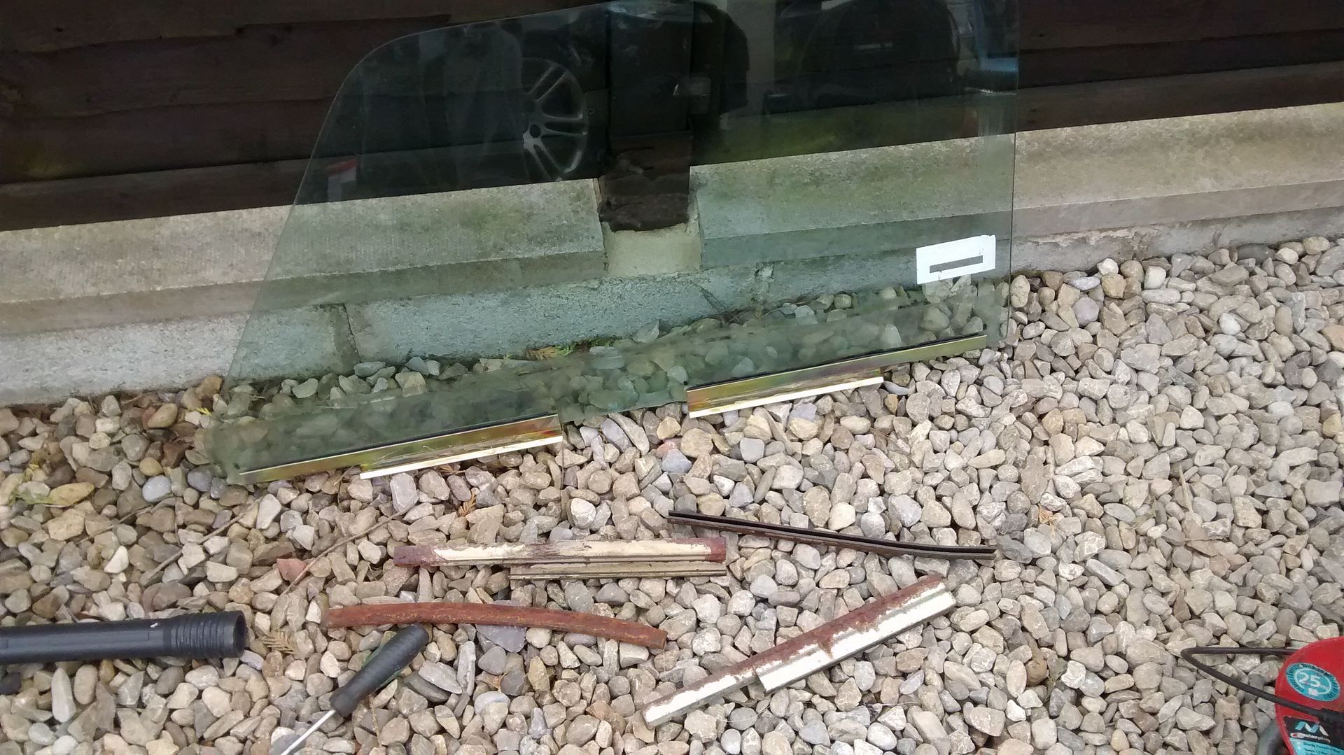

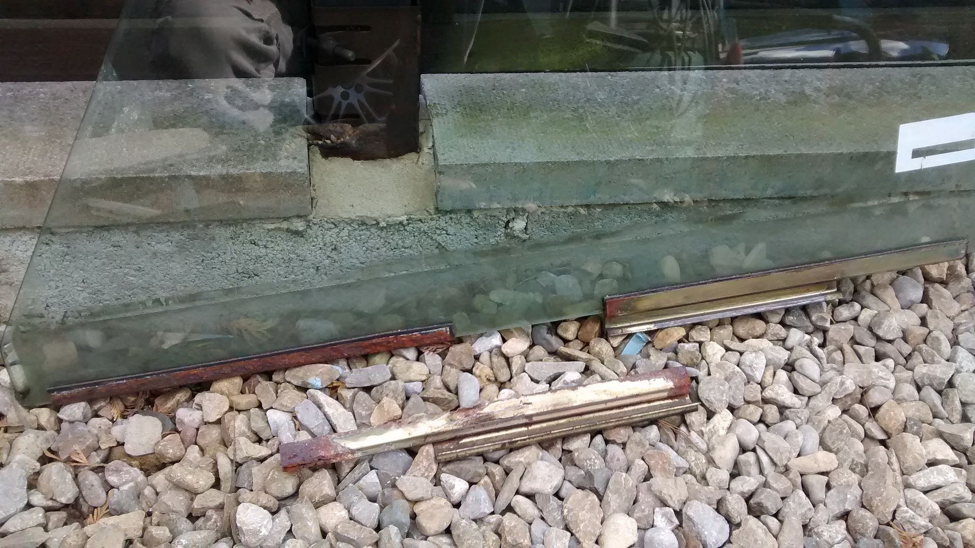

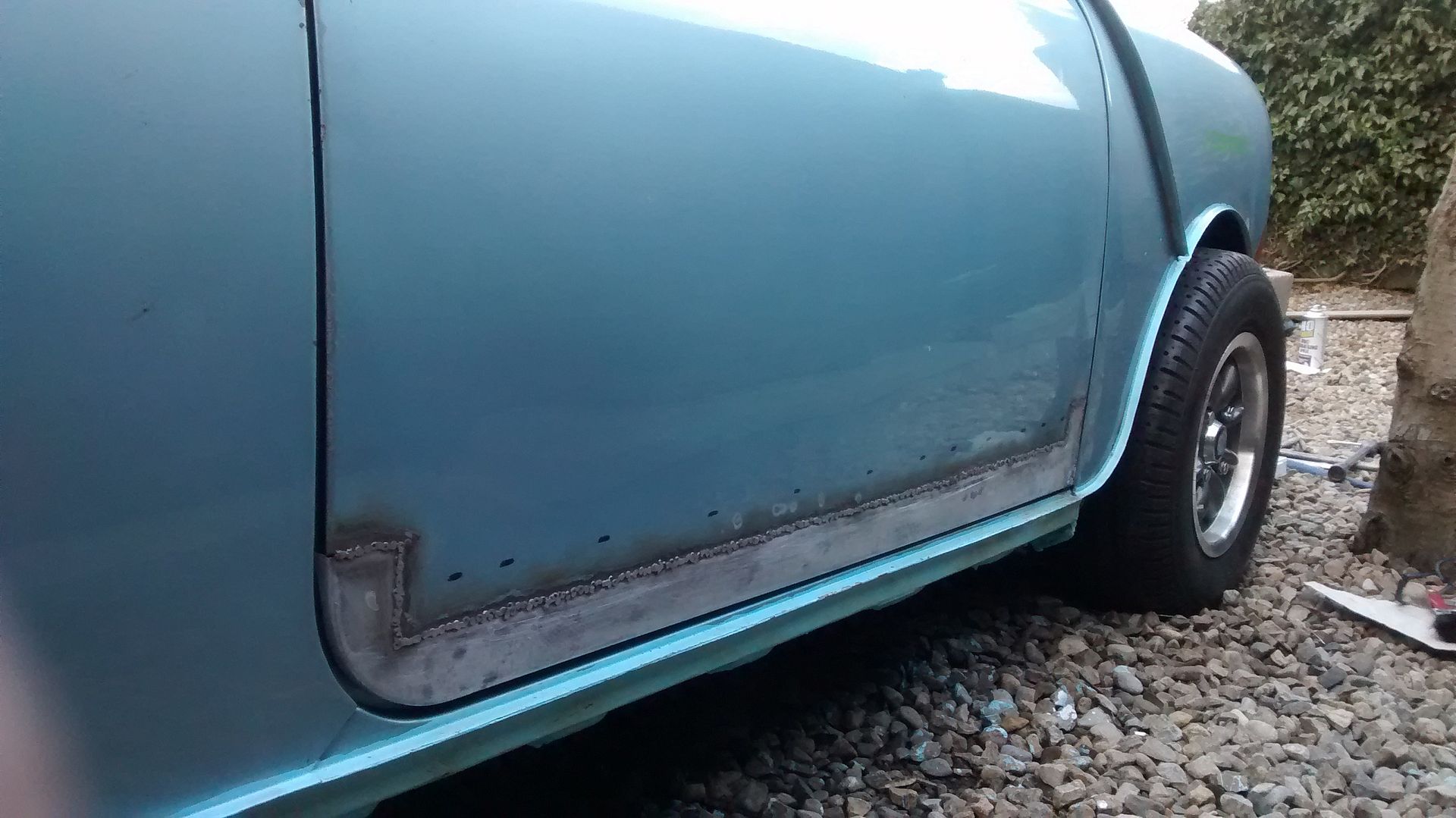

Drivers door window was sticking/jamming, one of the runners was goosed, so today went from this ..
To this..
Realise now that both doors also need new inner & outer wipers.
During the week repaired drivers door frame & the bottom of the door skin, went well, all welded, folded over, zinc primer applied before & after & fully sealed inside seams with seam sealer today while window winder was off, new drain holes drilled.
Also fitted stainless bumpers front & rear today.
Couple of weekends back fitted extra dials with the car under sheet & snow coming down outside.
Tomorrow weather permitting I'm hoping to fit front wheel arch liners that I bought during the week & if there is enough room I want to fit an "Ahooogah" horn & something else behind the liners.
Would like to get it in for an MOT next week but will need a fair wind to be ready in time.
Edited by mini-auto, 28 February 2016 - 09:02 AM.

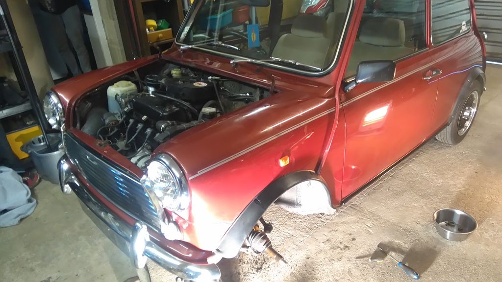

Posted 29 February 2016 - 06:27 PM
Refitted front suspension - New doughnuts, knuckle joints, bumpstops, rebuilt top arms and cleaned up hi-lo's.  Ordered a tap and die set as thermostat housing stud has potentially stripped one of the threads.. It never ends!! MOT in a fortnight and the car is booked to do a sprint in April so it needs to be sorted ASAP!
