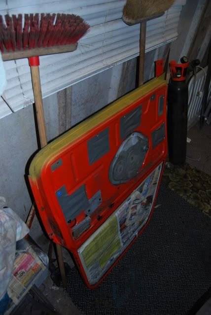

MK111
Door repair:
I'm after a set of silicon hoses now. :kiss:
