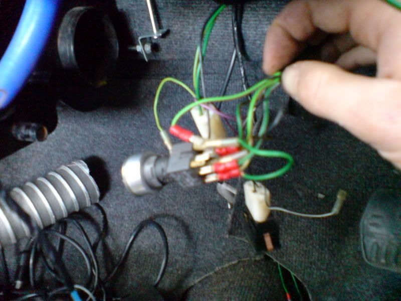

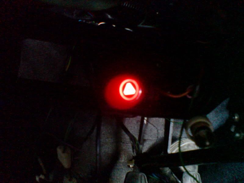

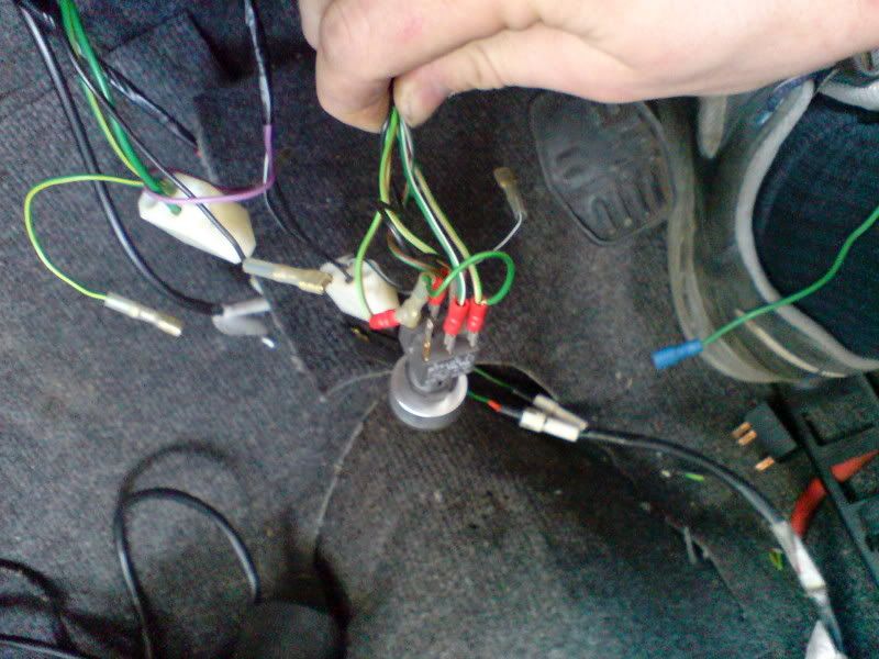

i have wired up my savage hazard switch! i think i have come to a solution of a problem everyone has with the hazards, there are 2 switches on the rear. as we all know the wire leading to the back of the switch need to be kept seperate, otherwise when you use the indicators both or no indicator lights will flash. to prevent this i've bridged the feed to the hazard lights (one of the group of 4 wires) to both sides. this is so one side does the left and the other does the right. excuse the spagetti on the back this has now been cleaned up. it works but i've wired the light to the switch on the right hand circuit so every time i indicate right it flashes, so i've only got to put it to a different pin.

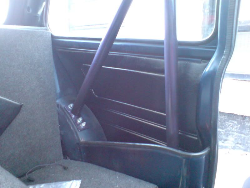

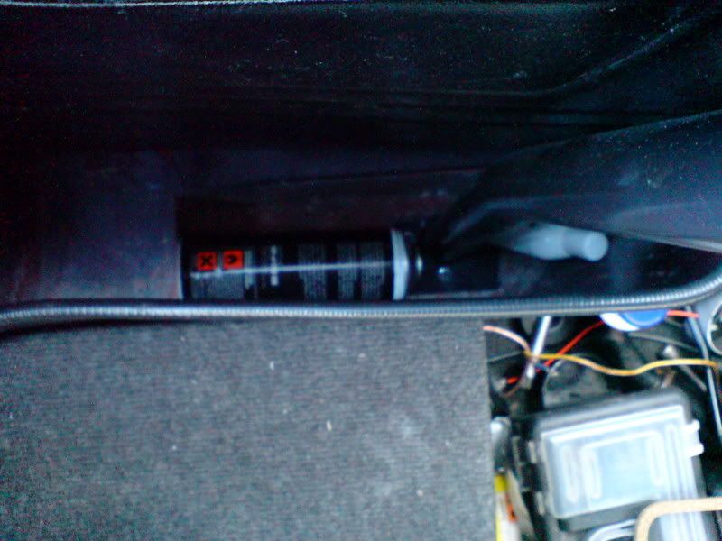

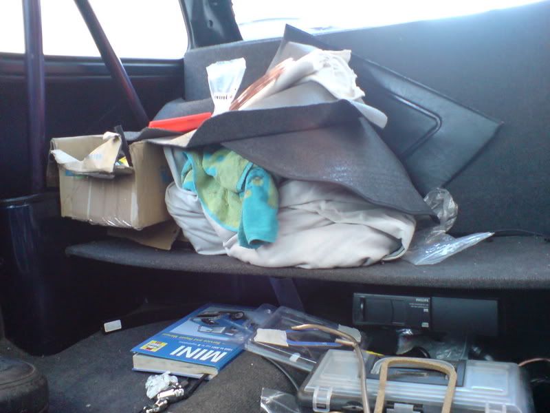

and as requested the rear space. excuse the mess, basically i'm using the 6disc changer and standard rover radio, so the changer is going behind the passenger side so i have abit of room behind the driver.
this is what i can fit in the rear bins
i've painted the dull grey cards

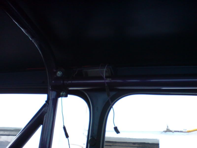

and finally my interior light is slight blocked by the cage, so i might have to improvise if i want to see inside in the dark
I will take a pic of how mine are done with lights both sides if you want

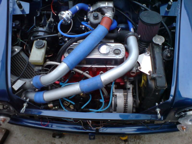

a wee bit more done
as you can see, the air filter has been fitted, and a new dizzy cap, coil, and 8mm silicone leads have been fitted. also this should be the final arrangement for my boost pipes. i've wired up the fuel pump, it goes via the fusebox, through an inertia switch, to the ignition live. flows fuel quite nicely! my pressure regulator is mounted on the brace bar, and has been plumbed in too.
i'm using the standard radiator for now, just to get it to the body shop, and then when its back i'll uprate it. i've got a bigger battery from work, to power it. i've also started to wire up my mpi style indicator stalks, just done the indicators for now, again the rest will be done when the bodywork has been fixed.
#204 Boab
Boab
  • 1,610 posts
  • Local Club: E*S*M*O*C
Posted 02 March 2007 - 10:18 PM
that would be great if you could
Bugger, I forgot will do it in a mo, sorry :proud:
If I remember right, they are the small caravan side lights. One each side attatched to the pillars and work really well
Edited by bigbadboab, 02 March 2007 - 10:35 PM.
#205 Boab
Boab
  • 1,610 posts
Posted 04 March 2007 - 07:38 PM
Sorry for not posting earlier Steve, but here you go
Purple/White wire is soldered into the top terminal switch (via connector and blue wire)
Blue/Yellow goes straight across the roof into the drivers side light, then back to the other terminal of switch via the green and black wire
There is no on/off for the light, just comes on when the doors are opened.

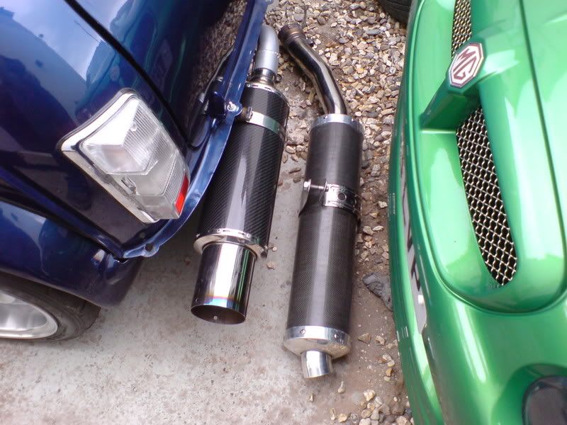

i got an r1 exhaust just to check whether it was smaller, but its bigger! :) , so for now i'm going to keep the original carbon one on, but change to a maniflow side exit before it gets on the road.

What bore is the R1 can? and does it need a new home? :thumbsup:

have been playing around with the engine, made sure everything was tight. the cooling system was very rusty, so i have flushed it several times untill the water became clear again. i've tried tuning the engine with a colour tune but without sucess so far, plenty more weekends to do so though. i plan on taking it to a rolling road once its done anyway. heres a random image.
