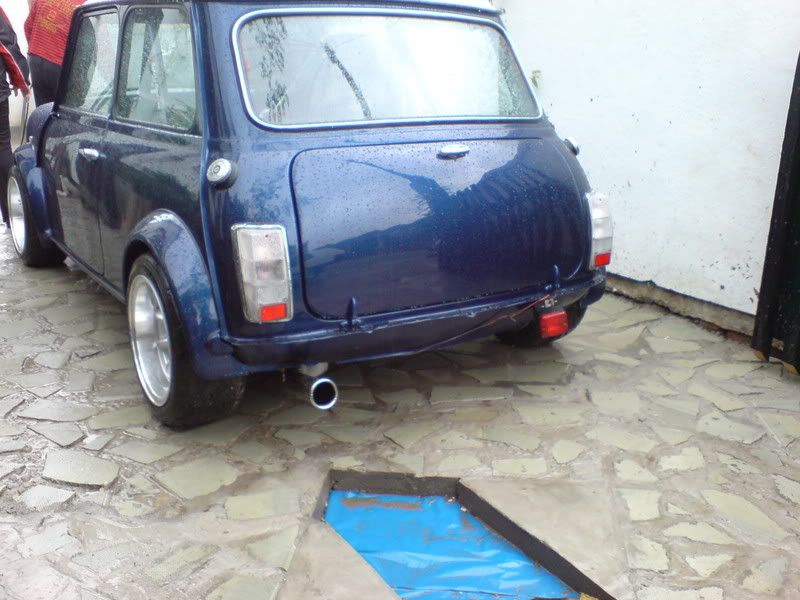

i have purchased a better backbox than the one that i came up with first time, a nice 3" stainless steel side exit backbox. keep thing nice and subtle. so today i remove the turbo down pipe, to get to the clamp. as many of you already know the original clamp was designed to fit a 1.5" (i think) down pipe. yet the one many are supplied with are 2". all that needs modifying is the collar on the clamp, which needs opening up. 2 hours with the dremel and its done. down pipe back on and i started to measure up the new system.
then it start to rain! just a note, the downpipe is a bloody awarkward doobrie to remove. it took me 2 hours, and lots of swearing to final remove the 2 bolts on the clamp. pics and hopefully more progress to come tommorow, for now a random pic.

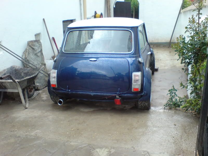

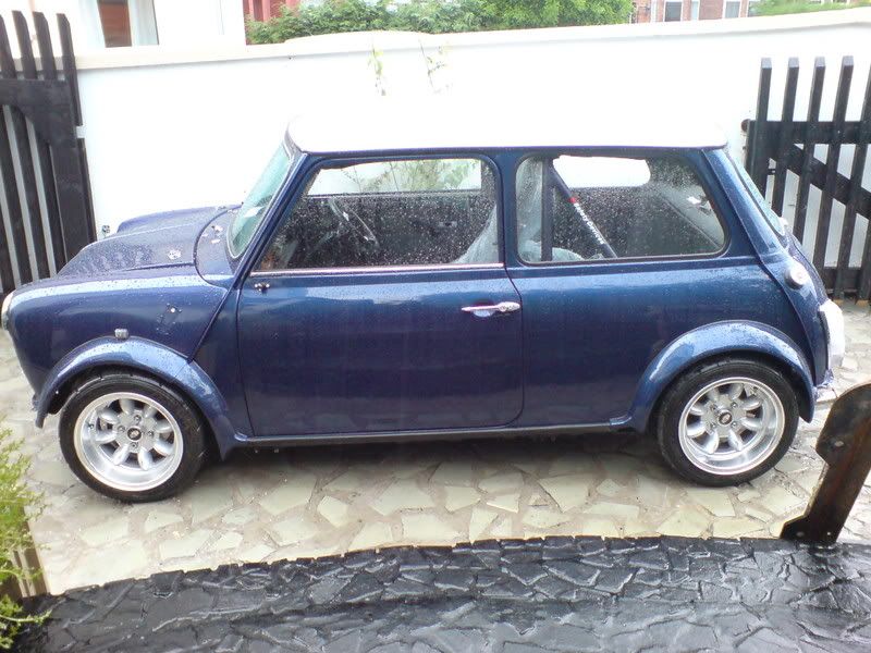

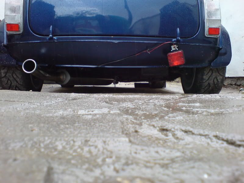

new exhaust almost fitted. spent all day struggling like a *Female doggy* just getting the link pipe sorted. started raining again today so for now the backbox is loosley on.
a much improvement over the original conception, also a side shot for you all.

Outta interest (not criticising)..Why aren't you running the fog lamp wire throught the hole you should have on the off side end of the rear valance?

That exhaust looks so much better than that one you had before. >_<

the wire running to the fog lamp is for the number plate lights, i am just using them to hold the fog lamp from the floor as i move the car round. the number plate will probabily be mounted under the valance, hence why the wires are routed there.
i've had that from many other forums i've posted on too, i think i'll keep my wacky ideas to myself next time! i just can't wait to drive the bugger, only a few months now.

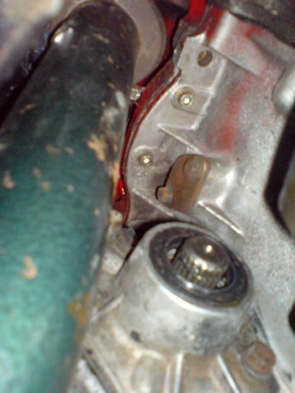

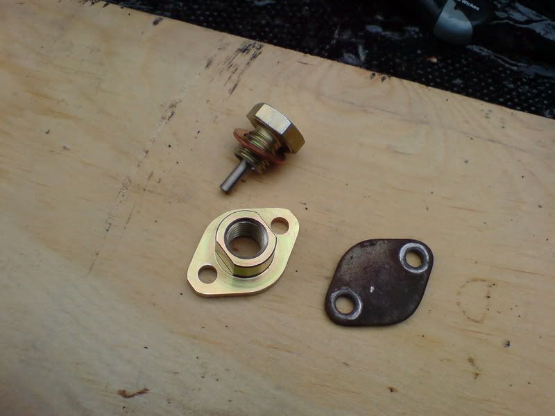

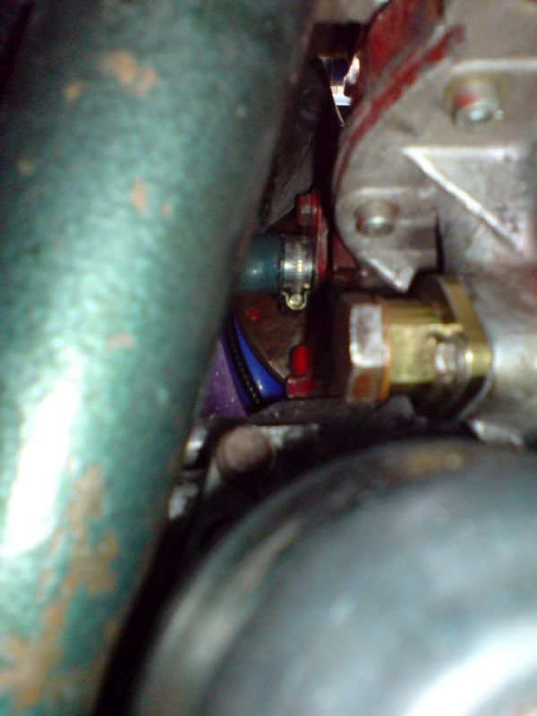

so far this weekend, have fitted a magnet into the oil feed to the oil pump. the main reason for this is to prolong the life of my wee engine. and particles that do happen to get past the gauze on the central oil pickup will be hopefully stopped by this!
it goes in where the blanking plate is on the gearbox.
comparing the new and old
and the new one fitted.

quick one is that blanking plate were the old fuel pump was??
