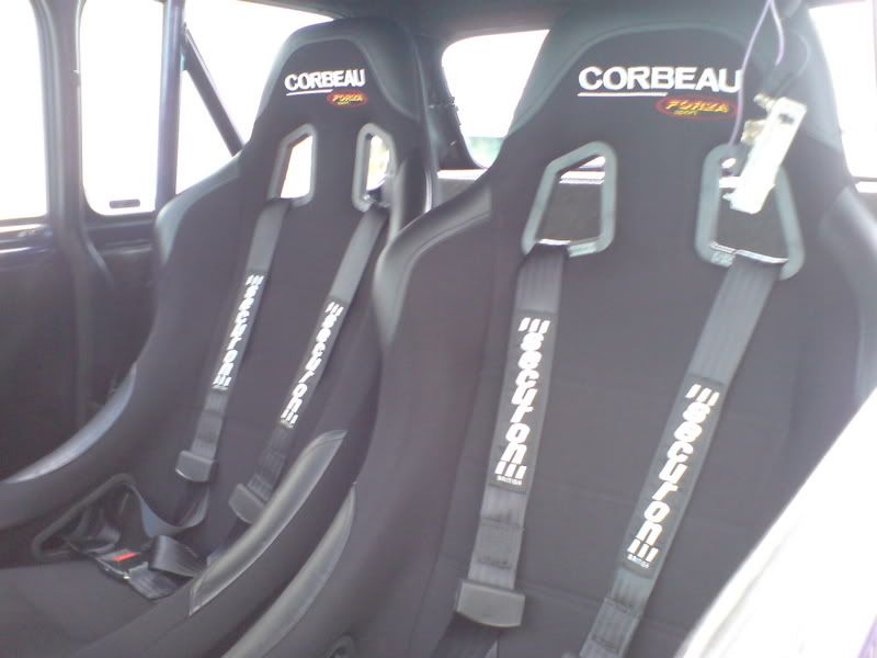

my other seat finnaly arrived! but not all was fine and dandy. it appeared that the subframe they sent me was the wrong type, as it was completely different compared to my other subframe looked almost universal. so a quick call later and it turns out this is the only subfrmae corbeau do now. it fits, but it just doesn't seem right. it will do for now, but i might see about getting a earlier one sometime in the future.

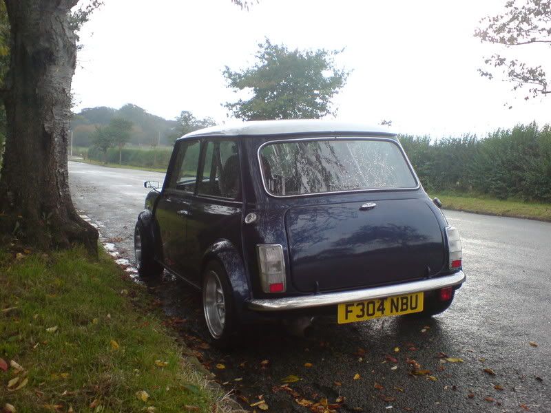

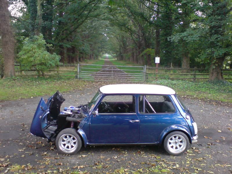

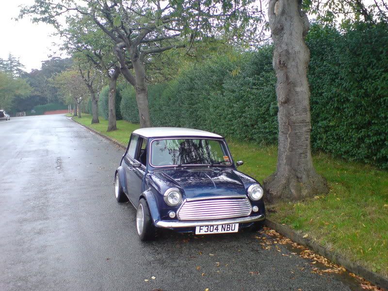

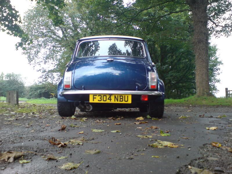

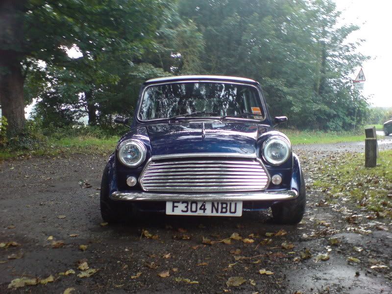

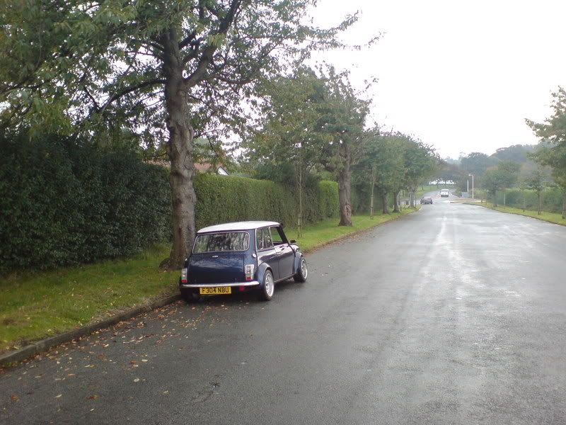

well shes on the road
sailed through the mot, just adjusted the emissions so she would pass. i've taken her for a drive 2 times so far, and i can feel every bump in the road! don't really want to use it till it has been setup properly, so i've booked a rolling road session for tuesday. i'll get some more photos up by next weekend!

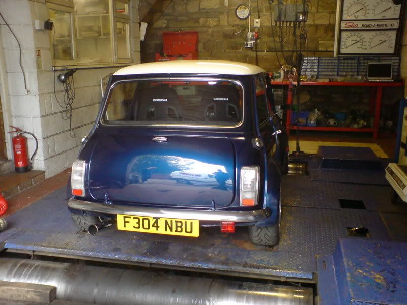

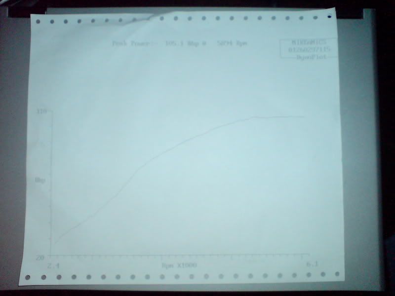

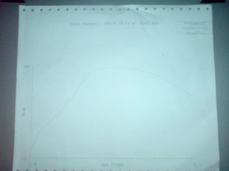

an eventfull day today. took the mini down to mikeanics in congleton (rolling road). got there for around half one. watched for half an hour or so then went for some grub to let him get on with it. overall results were 105 bananas and 110 curly whirlys! its only running 5-6 psi of boost i think he said, this is due to an unknown compression ratio, which i will work out soon. also i could get a few more horses out if it if i ran bp8es plugs but i not bothered right now. also it appears i'm not running a standard dizzy, so he had to strip mine and alter it. i'm am more than happy with this though, as on the road it pulls really well. i'll take a picture of my graphs, but for now this wee pic will have to do.
i can reccomend him to anyone whether its a turbo mini or not, great guy. also along with the faults you find when first driving, i've got a knock noise from the top engine mount, the exhaust rubs on the body right by your feet, and the rear suspension is scraping the rear arches. other than that its sweet!

heya mate, the dizzy was purchased new from avonbar, i beleive it to be a turbo dizzy unless it was modded to suit a certain set up which they didn't tell me.....
that being said ofc i think W&P did have some issues with the dizzy and getting it in correctly so i hope they didn't change it without me knowing to quick fix things. i did have many issues with them about the quality of work done on my car so i'm not gonna rule this option out.

graph printouts

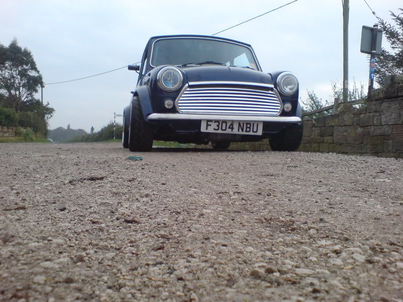

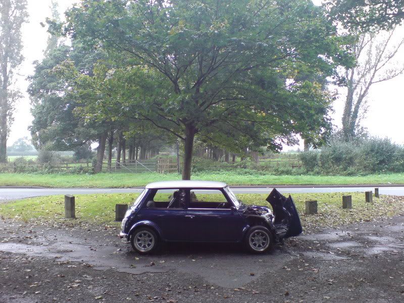

cheers, and to think it used to look like this
only took 2years.....
