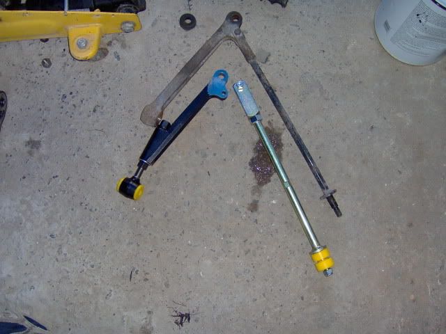

tada! re-named my title, up to now i have obtained some fully adjustable bottom arms and tie rods. poly bushed the lot! thanks has to go to the people on this forum for helping me choose the right arms, though i am far from finished............................ some pics for you all.

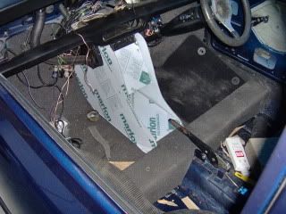

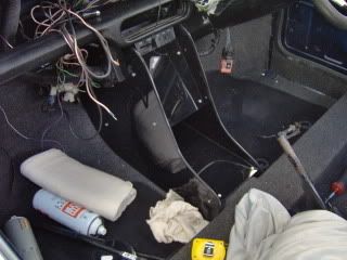

Looking nice :D tahiti blue looks amazing in this weather and is that a perspex centre console?
wayne
#51 steveobennet
steveobennet
  • 944 posts
  • Local Club: stu's turbo club
Posted 20 July 2006 - 06:24 PM
gettin the car out in the sun makes this paint look superb! shame its going to be finished around christmas time! yep the center console is made out of perspex, did it myself to improve leg room around the pedals.

more hands is not what i need, its the money side! (hint hint) the earliest this is going to be ready by is november, which will allow me to adjust to the mini and bed in the engine, brakes etc, find any problems, or replace anything that breaks. all before next summer comes along!
center console 50% complete

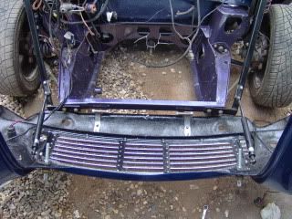

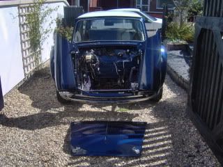

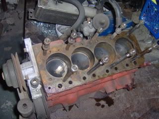

superb advice neil g, it did cross my mind that i'll need to tie them to something......... right what have i done so far. put some gas struts on the front end so it wont hit the floor if i let go. they are from a 3000gt(only 99p!) but do the job.
finally got some wheels for the bugger! i was set on the minispeed black ones but a change of heart (and rubber choice) sent me the way of the trusted superlites!
experiencing problems with the front coilovers too. at the moment its as low as it goes and it hit the subframe! i've going to make some new bottom mounts to bring it away from the subframe and give me some more movement and lower height!
finally i might have in my hands what could be a 1430! got it for free, but it is in bad condition, hopefully some spit and polish will get it looking better!

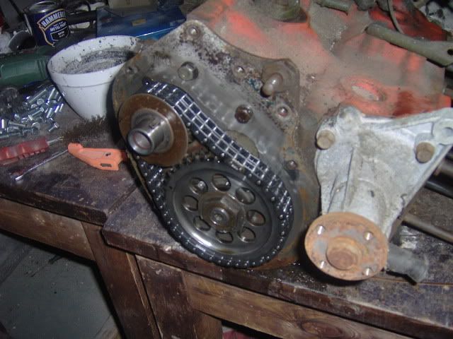

isnt there supposed to be a chain tensioner there? sorry if its a stupid question
#57 steveobennet
steveobennet
  • 944 posts
Posted 13 August 2006 - 06:02 PM
ain't got a clue! the engine was given to me like you see it. i may end up exhanging this for an engine kit, maybe a 1380. i'd love to find out what this is but to be honest i'd prefer a brand spanking new one to go in, just need to sort out the gearbox side then!

Looking good mate, nice touch with the old strut to open and hold the front end.

Keep that duplex timing chain Stu, they are alot quieter and hence more comfortable, will have to pop round again sometime to see it in the flesh, all is looking good! But as I say, the ^under wheel arch pic^ confuses me, specially that bump on the subframe, should it be there? How low is it set now then?
