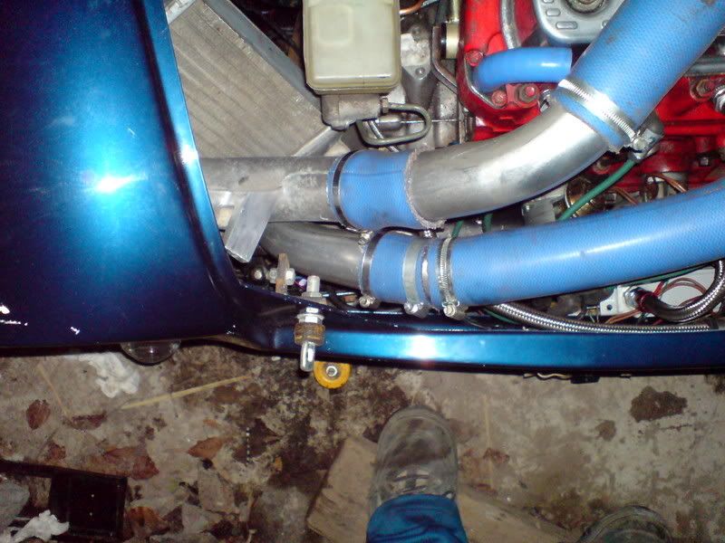

wow!! thats a tight fit!! lol.,. good use of space!! top marks!!

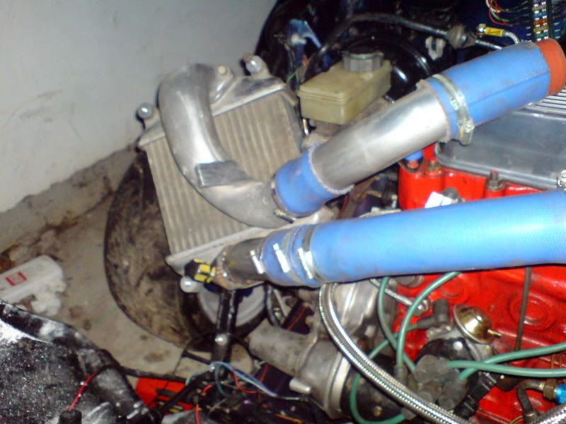

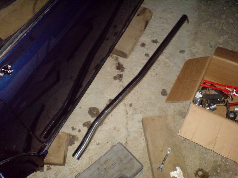

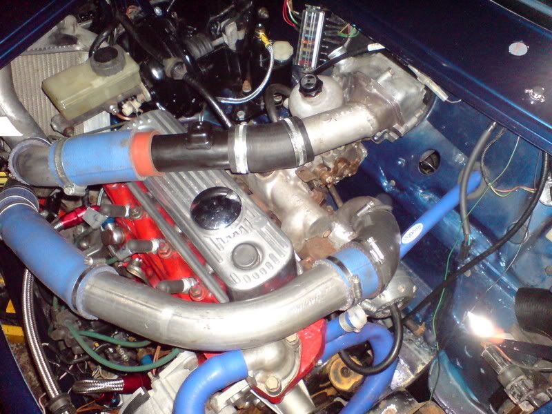

got myself a straight piece of pipe, stainless, to link my turbo down pipe to the rear
have been sorting out the front hubs and the alike, just tightening bolts to the correct torque, finally bleeding the system, fitting the correct high tensile bolts where they are needed! but my main focus was the boost pipes to and from the intercooler. i have the one from the turbo sorted, but the one to the carb hits the inside of the of the boonet so i may have to reroute it or adap it.
plenty of room!
just incase you were wondering yes it is exhaust pipe which i have used, i'm just contamplating on a finish what do you reckon, polished, painted silver or painted black?

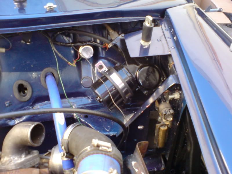

have almost completely wired up the fuel pump.i have run it by the fusebox, and fitted an inertia switch just incase the worst should happen. have also been figuring out where each wire goes. its simple when i know which does what, but so wires i'm still pondering about.
also removed my wiper motor, cleaned it up and sprayed it black. a new connector plug was needed after my old one pulled of the connectors with it!

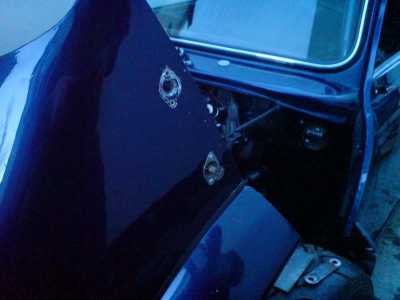

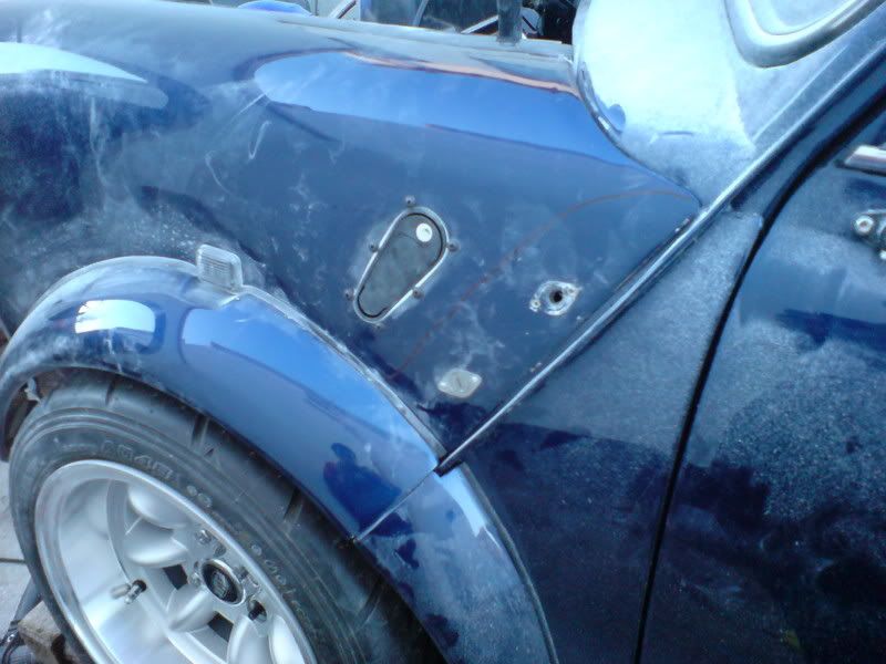

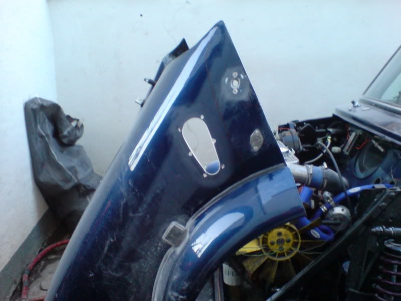

right as you may know i have been changing my mind through out this project, and have done again. the way my flip front is secured is by using dzus fastners. to be honest they don't really work riveted onto fiberglass. as below shows

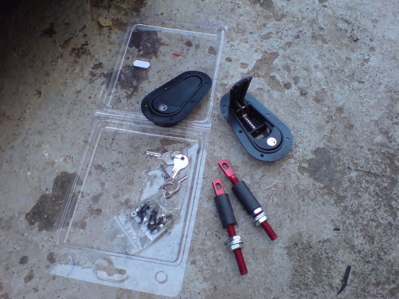

so i looked for something to replace them, that also has a locking mechanism. hence cometh (if thats even a word) these superior aerocatches
they are basically the same as bonnet pins. two versions are available locking and non-locking. both types are avaliable in a flush fit and a bolt on top fit. the ones i choose are hidden under the bodywork to keep a smooth look to the exterior. also the pin can enter directly from beneath the pin, or from either side. they come with all fixings and a template, making marking easier.

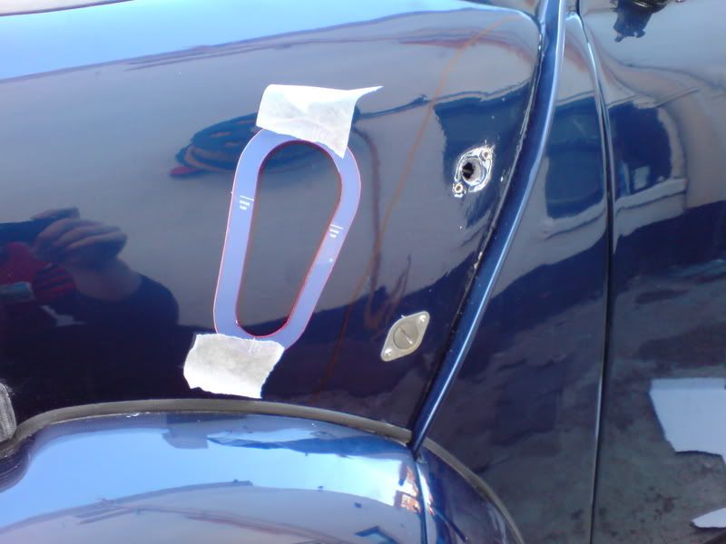

i hate cutting up perfectly fine bodywork, but out with the dremel and a hole is cut.
some sandpaper, and a drill and the hole is ready for test fitting

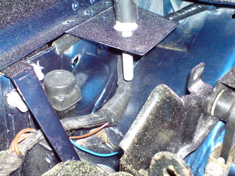

now where i am mounting them, the arch does have a minute curve in it, but when bolted on the aerocatch sits snug with the body
just imagine it without the dzus. should have the pin mounted on the weekend, and we shall see whether it holds the front tight enough.

basically, they were looking a little shitty, starting to rust, and its not even on the road yet.
also riveting them on to fiberglass isn't really a long term method of keeping them on, as 2 have fallen off now! hopefully these aerocatches should do the buisness and keep it held down.
