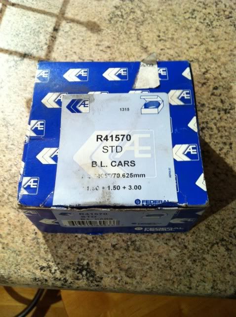

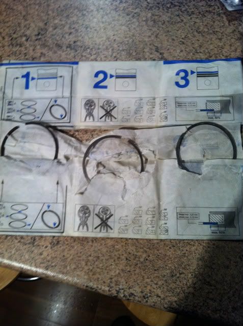

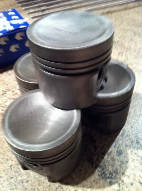

As per my PM, Here are some pics..
Gudgon pins are in the pistons...
The rings are brand new...Ive had them lying in the garage for a few years.
Edited by AndyMiniMad., 05 January 2012 - 06:02 PM.
#64 PhilipGCaldwell
PhilipGCaldwell
  • 870 posts
Posted 05 January 2012 - 06:05 PM
they look in excellent condition Andy

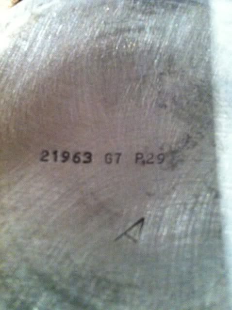

Posted 05 January 2012 - 06:09 PM
They do look good mate just wondering what pistons i have at the moment 21962 p4 x11 id5 got me confused are they standard?
#66 AndyMiniMad.
AndyMiniMad.
  • 3,295 posts
  • Location: Under The Bonnet.
Posted 05 January 2012 - 06:13 PM
Yeah they are std...if they were over bored pistons they would be stamped with the over bore size..+20. +40 etc.
If the machine shop reckon your pistons are ok...you can get the rings on minispares web site...
http://www.minispare....aspx?pid=37903
Might save you a few quid..
Edited by AndyMiniMad., 05 January 2012 - 06:16 PM.

The size of the dish in the top of the piston is different. the Higher comp pistons have a smaller dish and so will squash the fuel air mix that little bit more..giving a bigger bang and therefore more power... I think yours are 9.75 to one and mine are 10 to one...but im not totaly sure on the compression figures..the Mg engine had the highest standard compression ratio of all the A+ engines and in my opinion the best standard cam..
