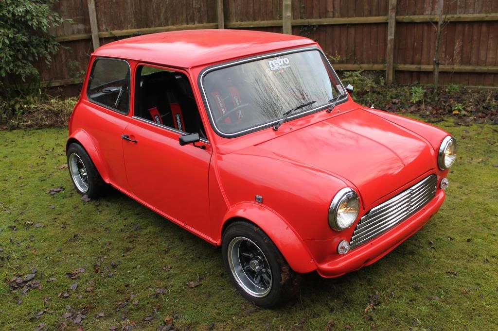

FINISHED!

Engine:
Standard 1275cc four-cylinder carb A series; 3" side-exit Sportex exhaust; K&N performance air filter
Chassis:
12x6" Minilites with 165/60R12 Falken tyres; Lowered on hi-los all round; GAZ adjustable shocks all round (lowered-length); -1.5o front negative camber arms; -1.5o rear negative camber brackets; New strengthened genuine rear subframe; Front polybushes; Heavy duty tie-rods;
Exterior:
Full respray in Maranello Red; De-bumpered front and rear; Mk1 bonnet conversion; Debadged bonnet; Mk1 grille; Clear indicators; Group 5 fibreglass wheel arches; Wiper holes deleted; Single-seater (Formula Ford) door mirrors; Opening rear-quarter window conversion; Full red rear light lenses; Smoothed and debadged boot; Number plate light housing deleted (replaced with number plate bolt lights); Pressed plates; Fog light relocated to behind centre of rear valance
Interior:
Full respray in Maranello Red; stripped of all carpet and sound-deadening; Rear seats removed; Cobra Monaco S bucket seats; Securon 3" 4-point harnesses; Safety Devices roll cage with diagonal bar; Carbon fibre wrapped dash board; Deep dish steering wheel; Fire extinguisher bolted to passenger footwell; Re-routed wiring through silicon hoses along floor; Engine start/ignition button/switch; 2x6" speakers; Sparco gear knob; Comic strip door cards; Stickerbomb'd rear view mirror, speedo housing and stereo surround
