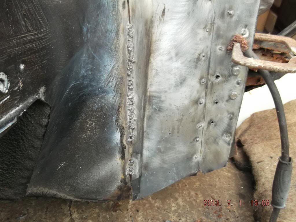

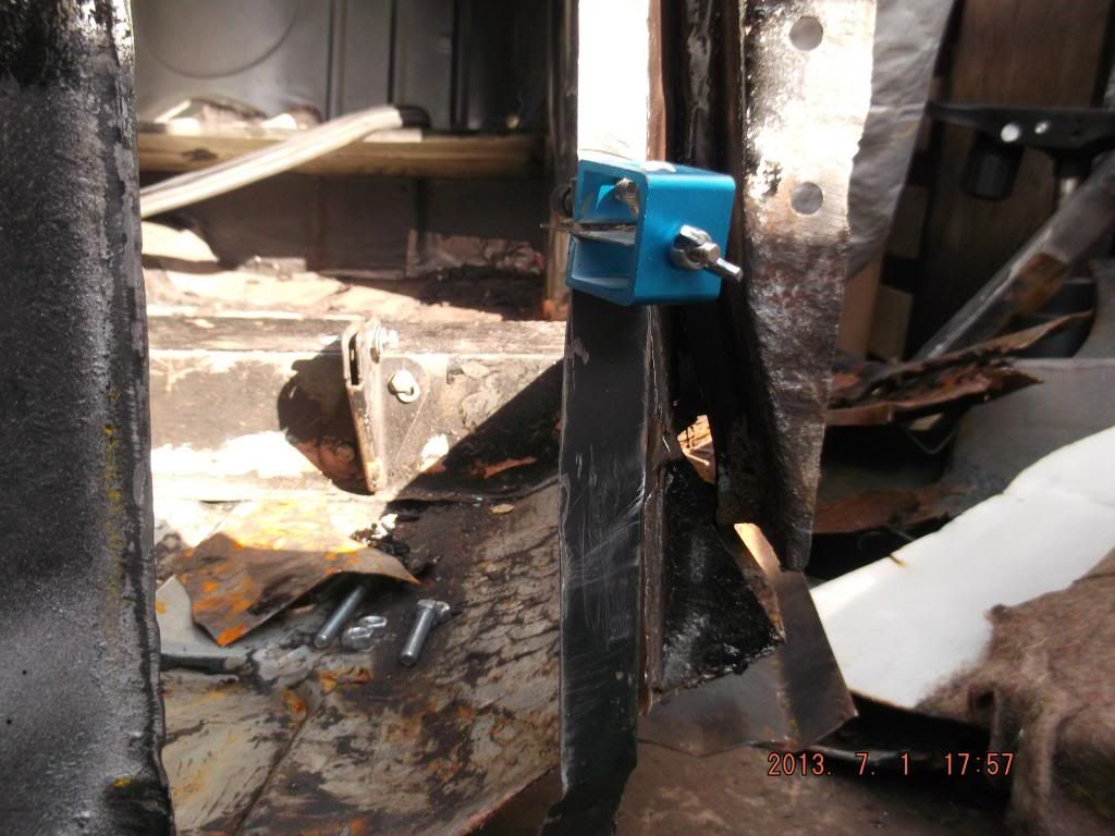

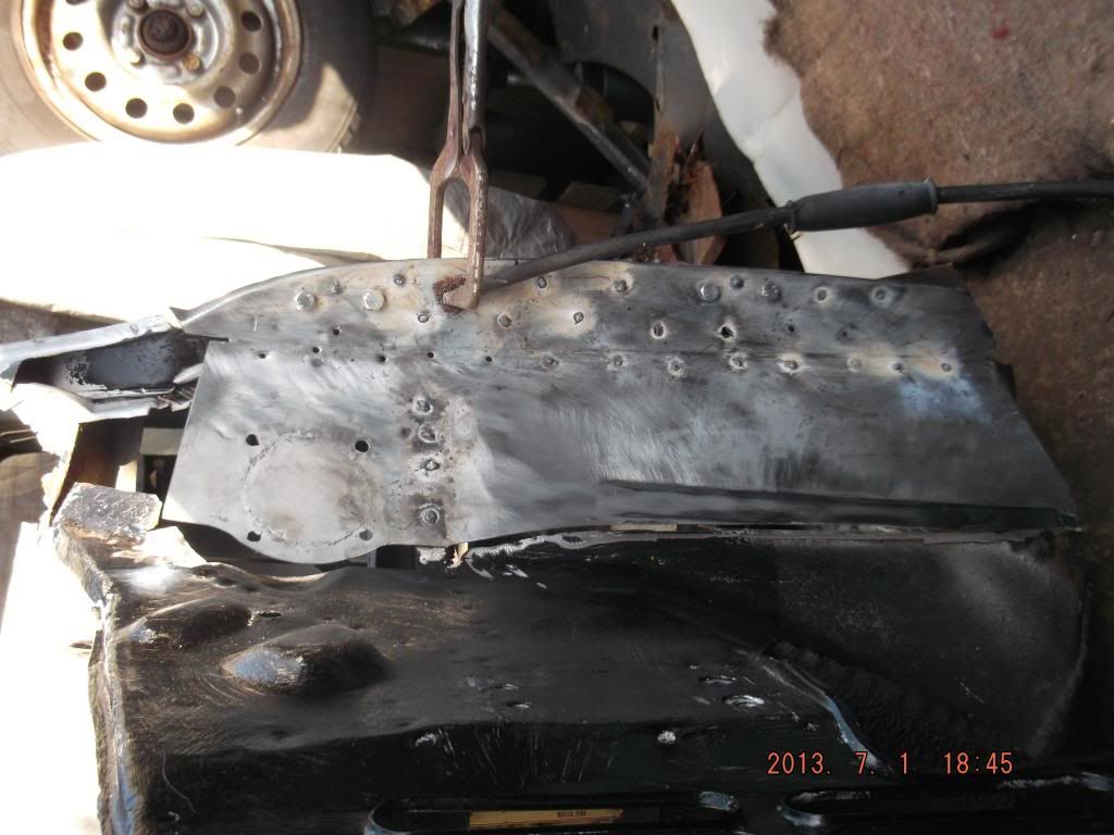

Heres the update on Checkmate!!! WOOP WOOP :lol:
So got the nearside inner flitch prepped and welded in today, i need to weld a tad more on the main area to the rest of the inner wing but its in which is the main thing :proud: .
I havent plug welded before so thought id try on this area to see what its like....To be honest im as chuffed as punch with it haha.
I got the bottom lip made but neglected picturing that as i was on a roll for once since the beginning of the "strip" ;D .
Heres a few pictures for you to seeeeee.......
Mocking the new lip to plug weld to...
Before:
During:
No after im afraid :lol:  :lol:
Plug welding the flitch in:
Gap became quite abit bigger than before so having to bridge across >_< :
Thats it only three pictures but im happy with the amount done to be honest,
Next up is to weld in the top flitch panel i made a while ago so i can then cut this side of the dash rail out and start on the bulkhead again.
Cheers
Cliff

i had this to when i done the rear quarter the gap was bigger next time i will cut it that bit smaller. nice work as allways tho.
