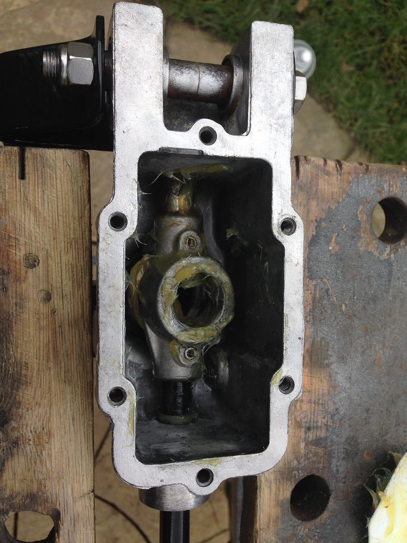

I've spent the day refurbishing the gear selector, here's a run down of what I did.

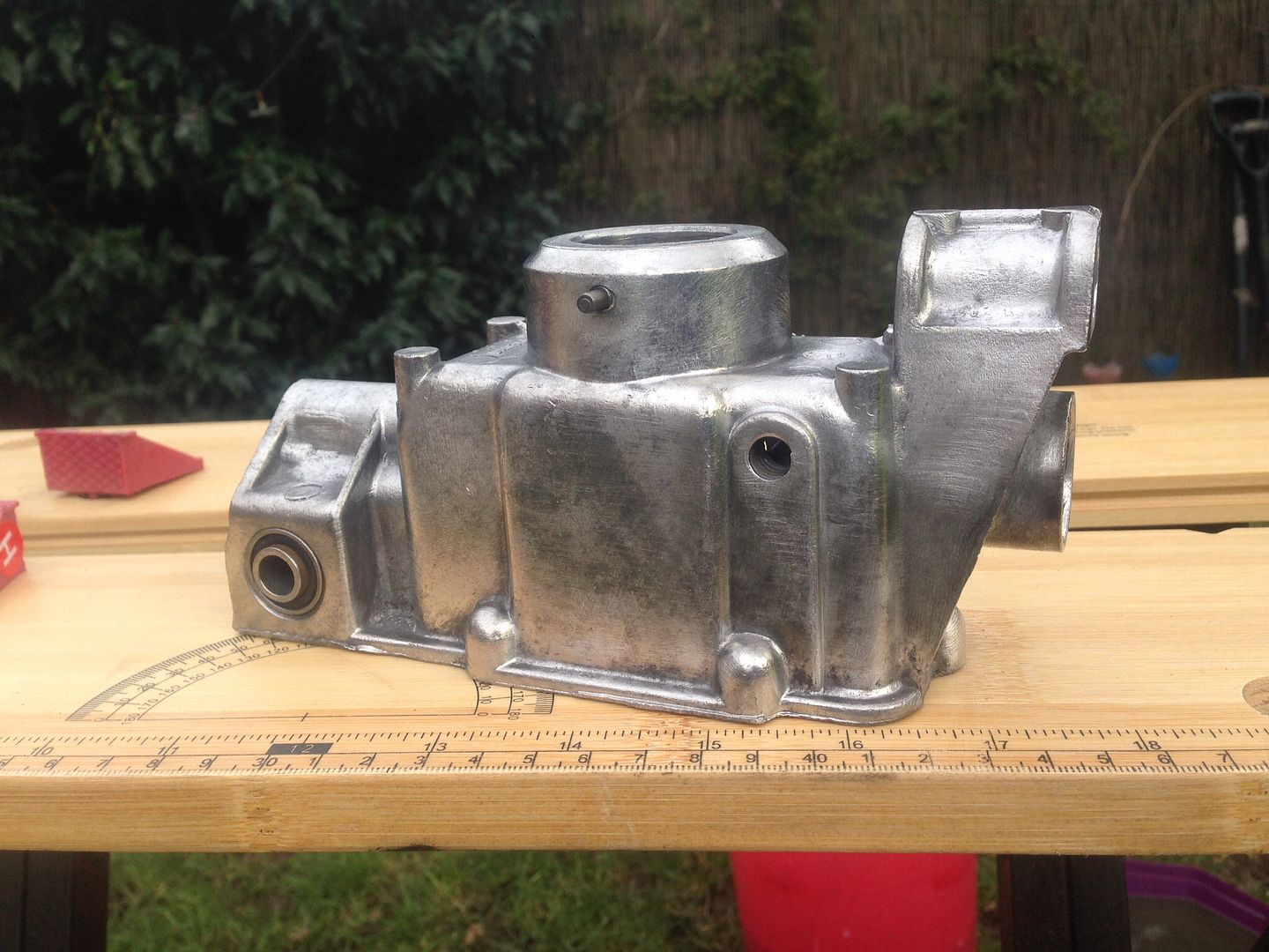

I degreased and wire wheeled the alloy housing first, the old grease inside was a pig to clean out as it had turned into what resembled cheese string. Here it is -

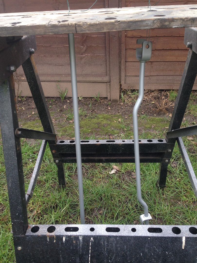

Next I wire wheeled and zinc primed the two arms -
126de2014d08fc8f48002632cd33ee37_zps1612

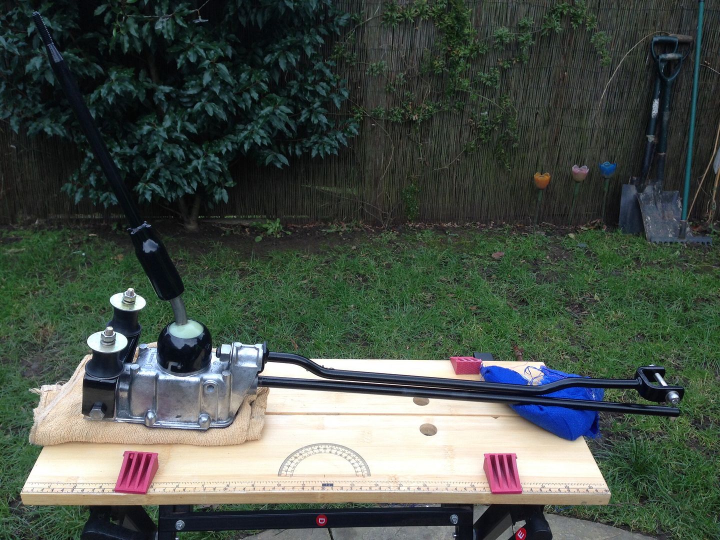

I also painted these gloss black but didn't take a picture. After leaving those to dry for a while I started to assemble the selector. I fitted the lower arm back into the casing and knocked in the roll pin that connects it to the 'yolk'. Then packed it full of fresh grease -
79b405dae72357c77bad9846493c35f3_zpsb048

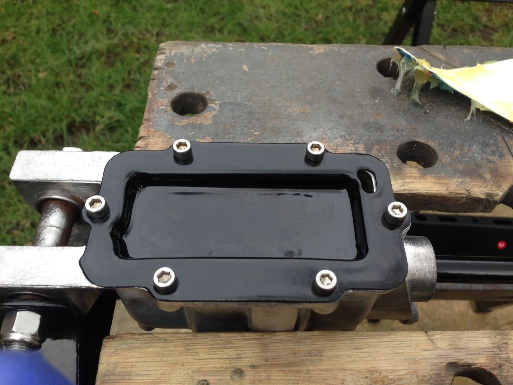

Happy with that I closed it off with the plate I had powder coated, I also replaced the screws with stainless allen head bolts -
934eb21f653d885fd1087590912801e5_zps926e

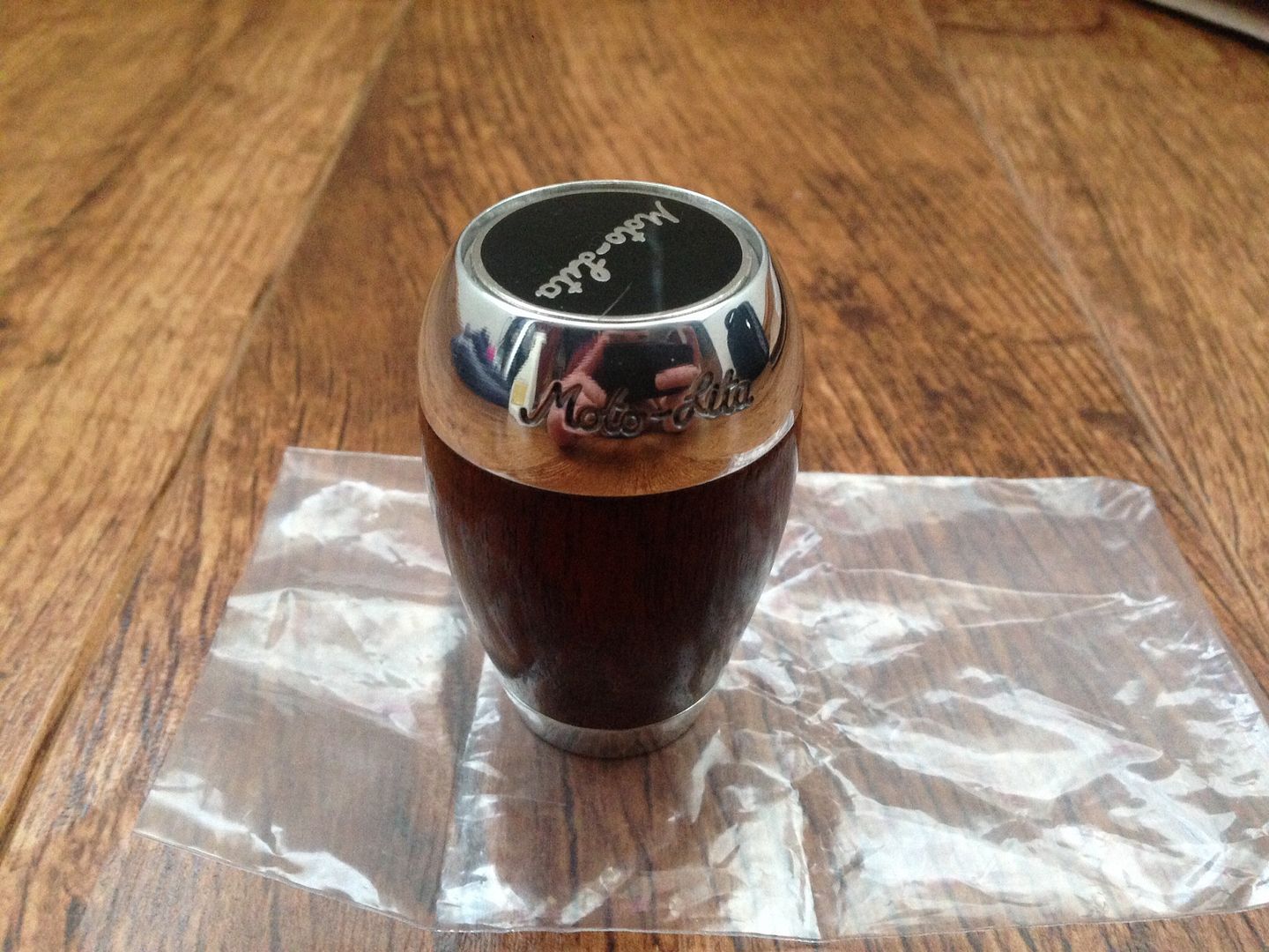

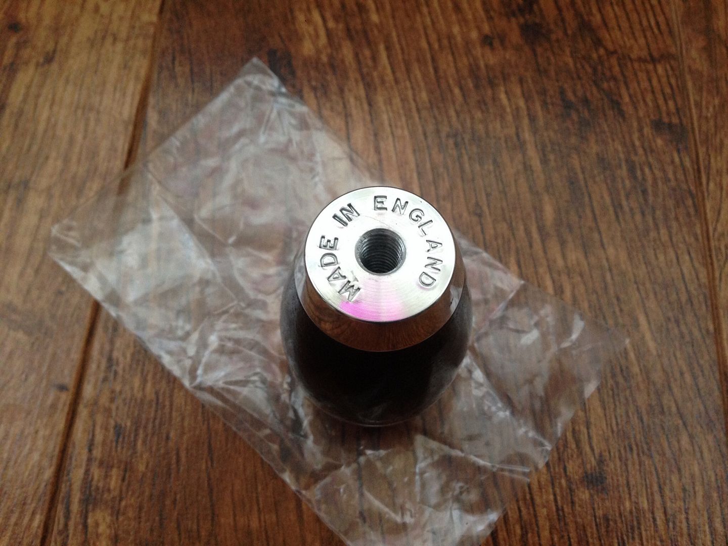

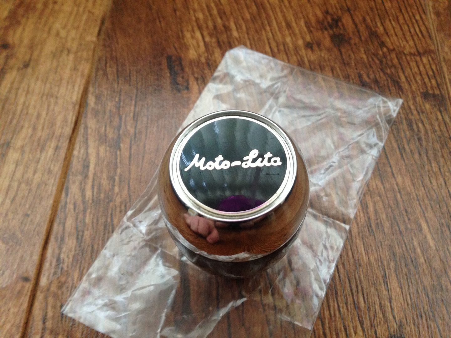

I got a Moto-Lita gear knob for Christmas, it's new old stock and was quite expensive, but will tie in nicely with my other Burr furniture -

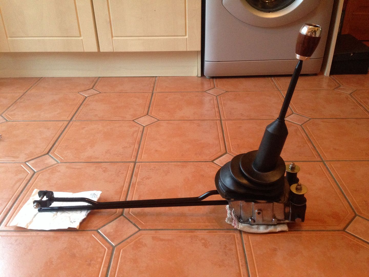

So I got that fitted along with the sponge and rubber boot, here's the finished thing ready to go in the car -
5f161c69e28cc31950aac144631aa10a_zpse35e
Will probably get that in tomorrow.
