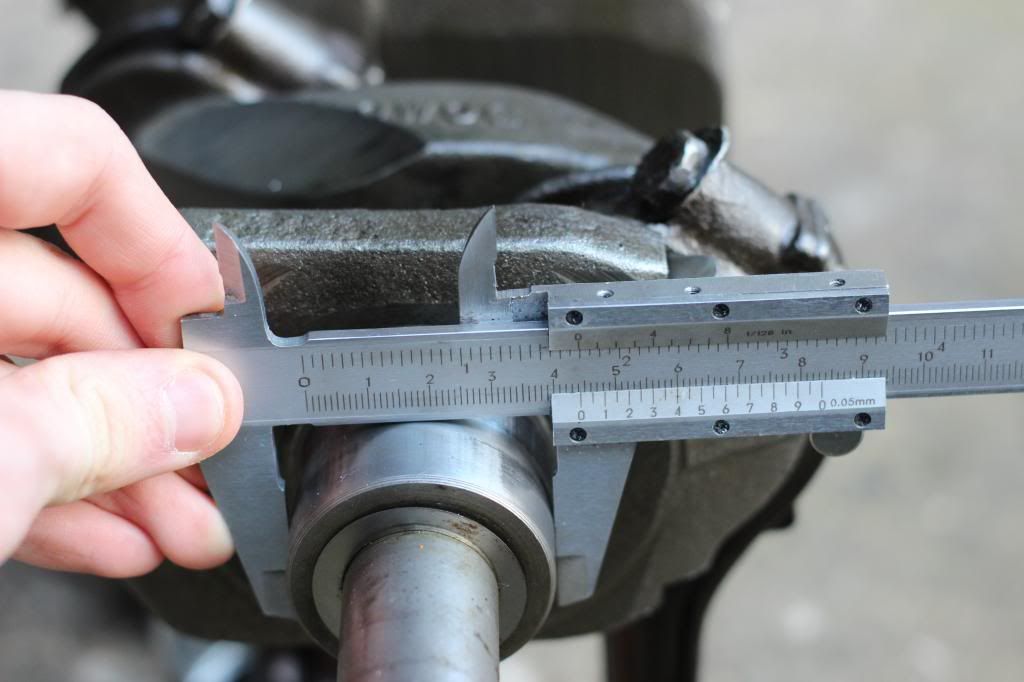

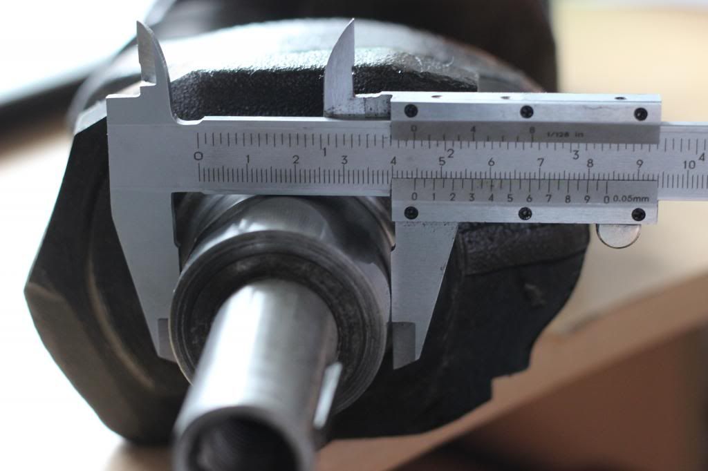

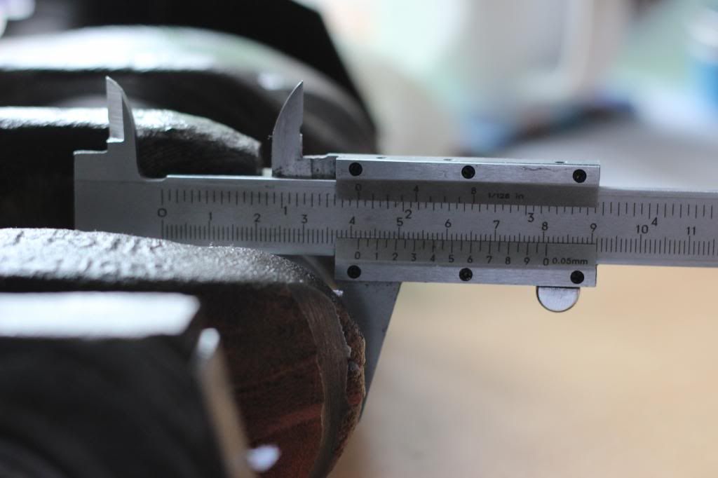

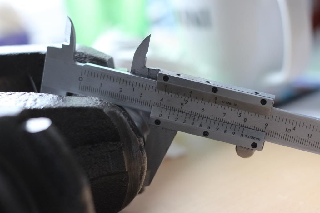

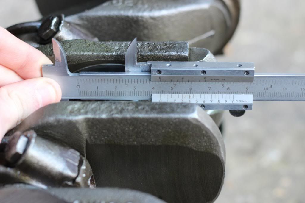

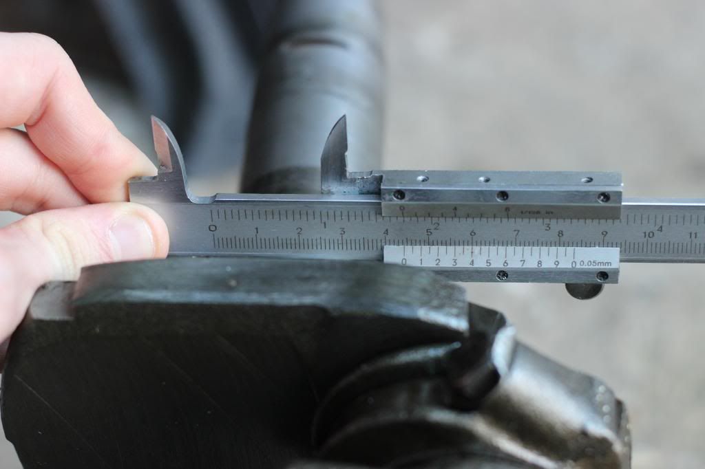

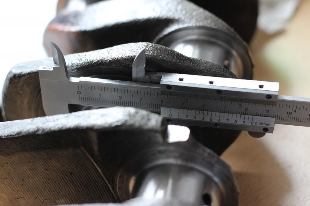

Well i measured the journals with a vernier and this is how they cam out, starting the flywheel end:
Flywheel main:
1st big end:
2nd Big end:
Centre main end:
3rd Big end:
4th Big end:
4thbig_zps9c7cfeee.jpg?t=1395145355
Pulley main end:
I will check them again with a micrometer, but they seem to be pretty close within the limits to me
Cheers,
Iain.
Edited by IainNeon91, 18 March 2014 - 12:28 PM.

Is that the original crank or the 'new' A+ one?
#22 IainNeon91
IainNeon91
  • 1,288 posts
  • Location: Norwich
Posted 18 March 2014 - 01:51 PM
This is the re balanced and polished A+ one. Its the original crank that the pistons and rods I bought came off
Edited by IainNeon91, 18 March 2014 - 01:51 PM.

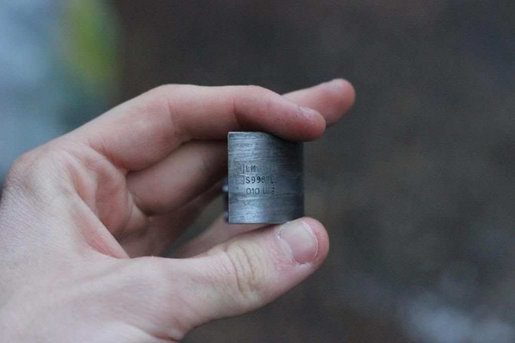

I will go check to see if there's anything stamped on the old bearing shells
#27 IainNeon91
IainNeon91
  • 1,288 posts
  • Location: Norwich
Posted 18 March 2014 - 05:41 PM
You sure know some stuff Copperman!
No doubt, all of the shells said '.010 U/S'
5545158a-abba-4794-8986-4004e2d19ca9_zps
Edited by IainNeon91, 18 March 2014 - 05:43 PM.
#28 Cooperman
Cooperman
  • 23,569 posts
  • Location: Cambs.
Posted 18 March 2014 - 07:10 PM
There you have it, Iain. So you have no engine problem, just a need for the correct shells.
