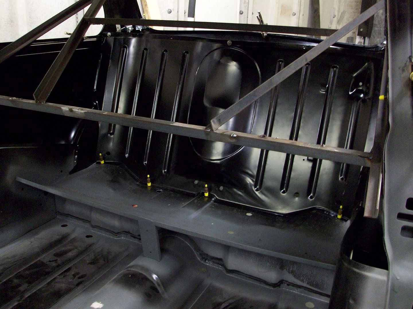

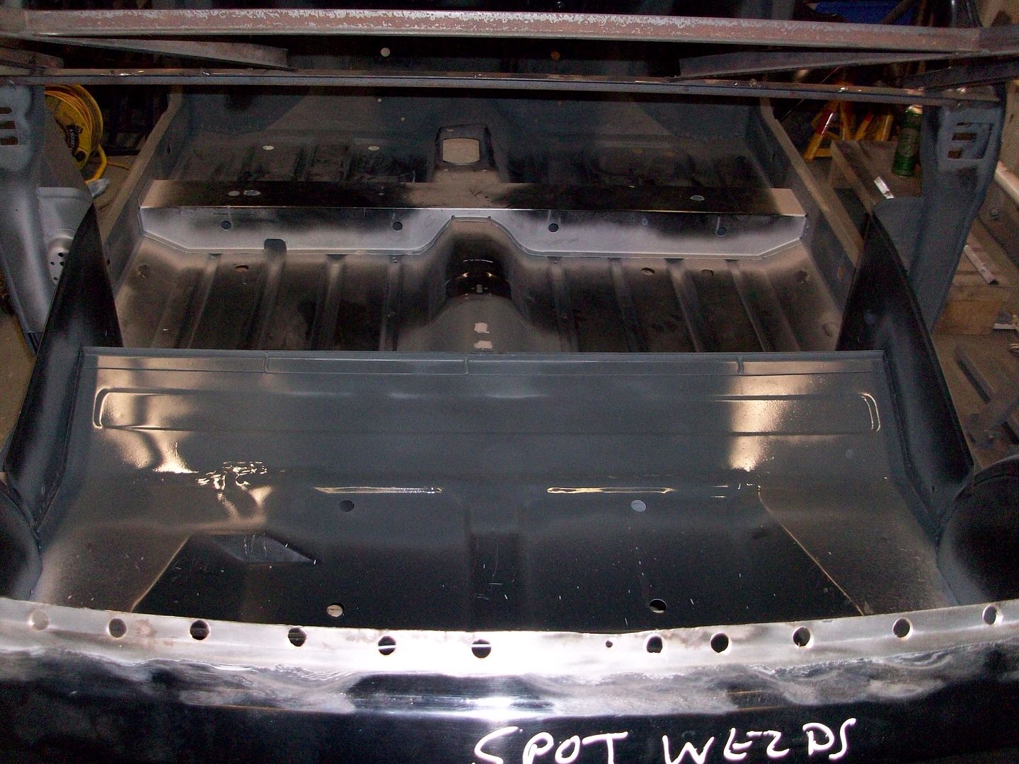

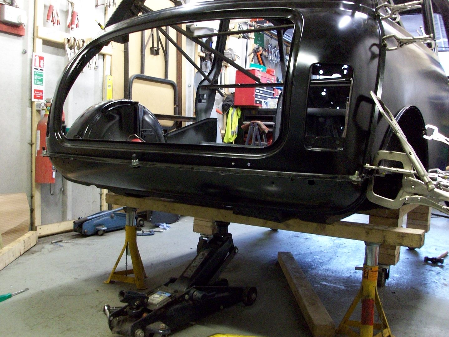

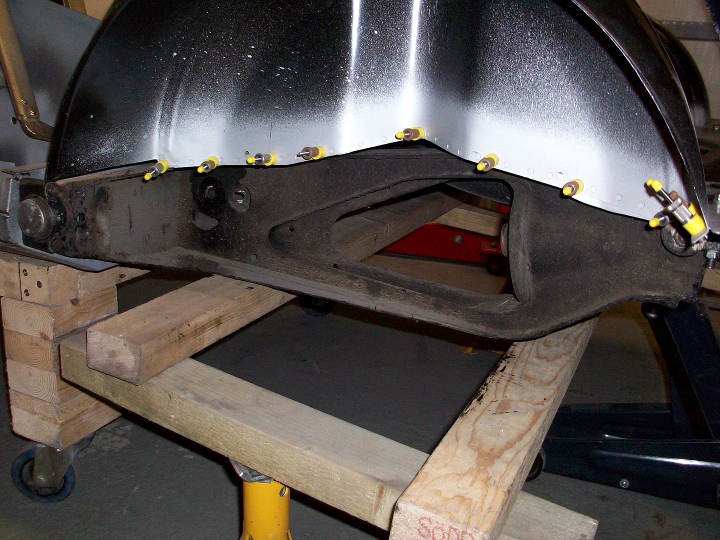

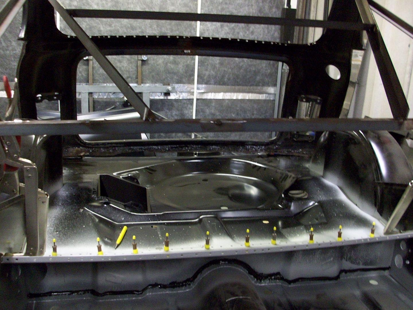

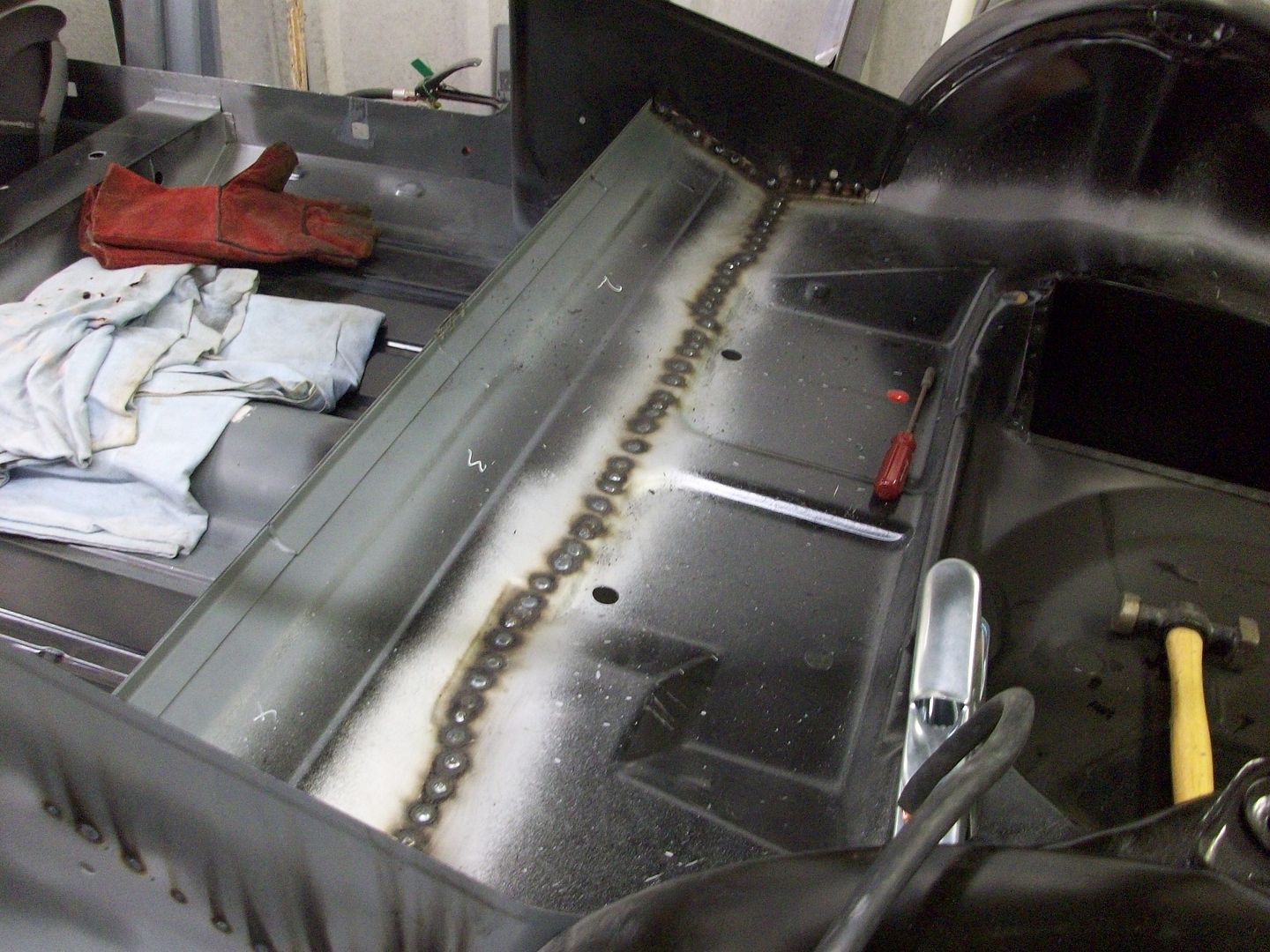

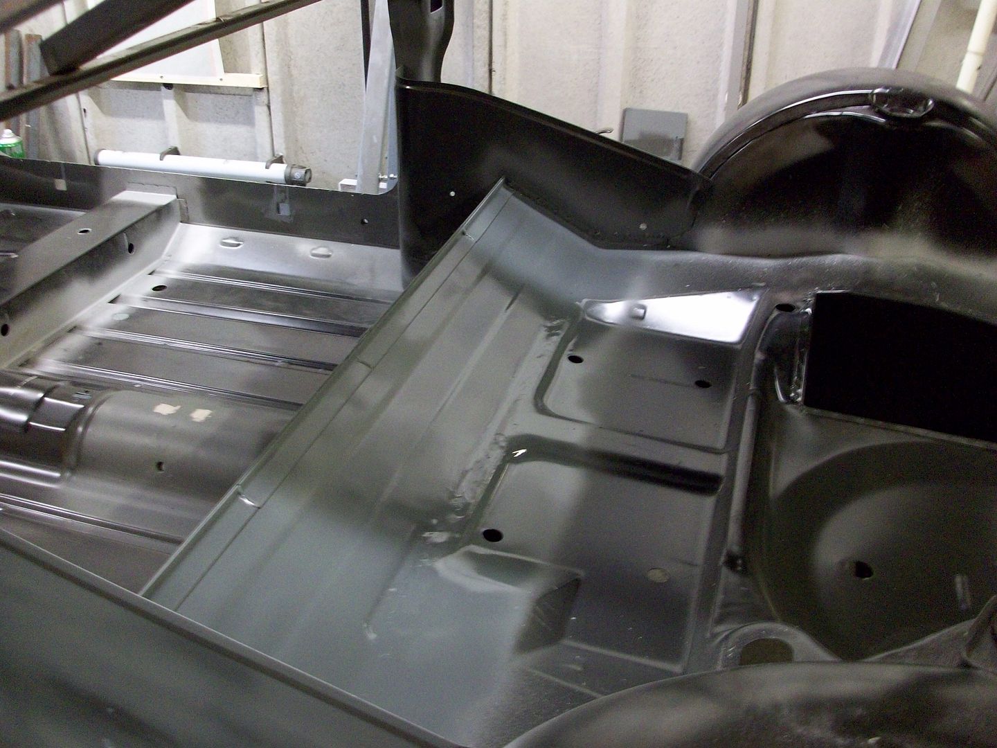

Boot floor and rear arches back in this w/e just to make sure everything still fitted ready for welding.
Thought I'd just pop the rear subby on just incase there was a problem. Result it fitted perfect.
Then welded the seat front strengthening lip into place.
Boot floor now welded to the heelboard and companion bins.
All ground down with a coat of primer.
Ger

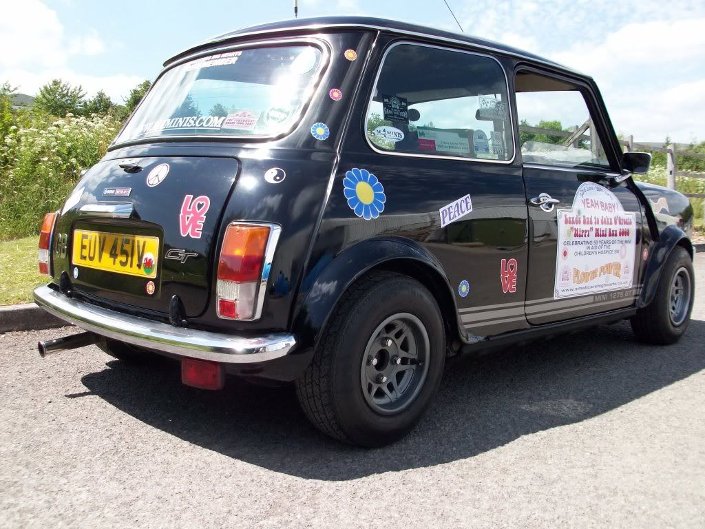

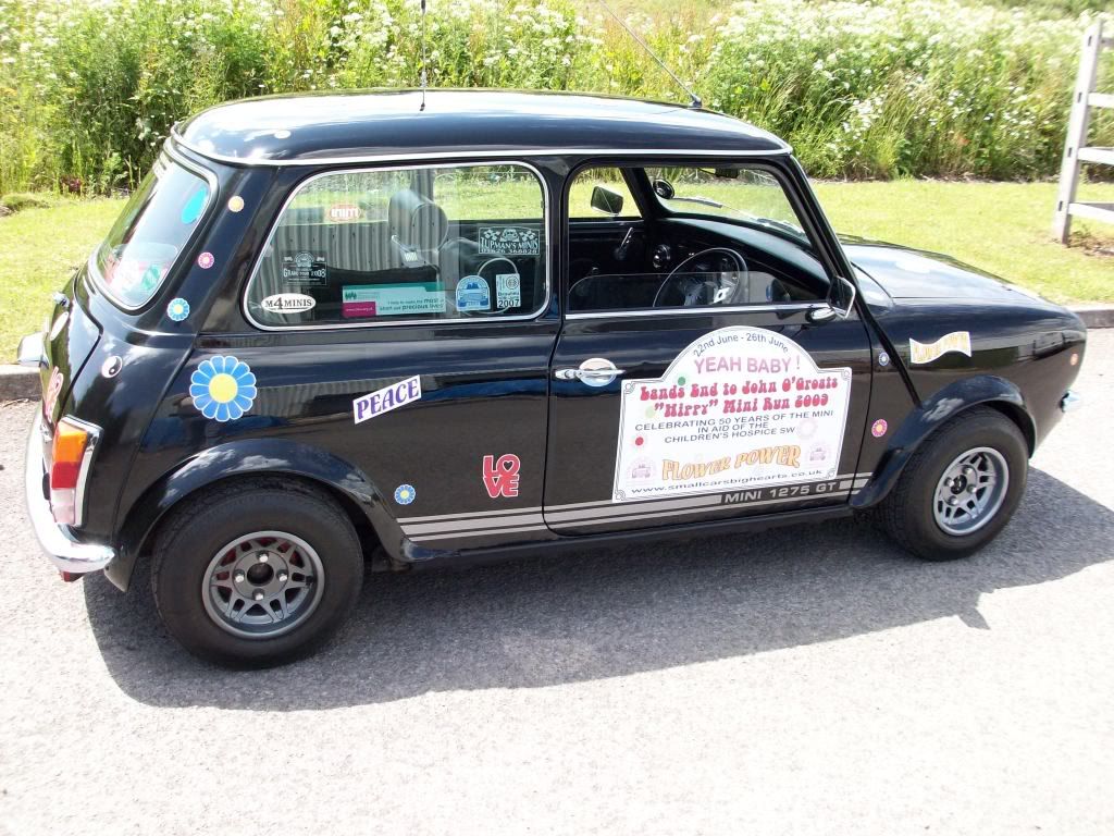

And my favourite one - In Switzerland on the way to the 2013 IMM in Italy
Ger

Will16 - Happy to oblige.
Ger
Awesome! Easily my favourite wheels :wub: suits the Clubby so well

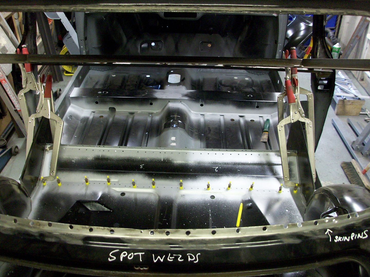

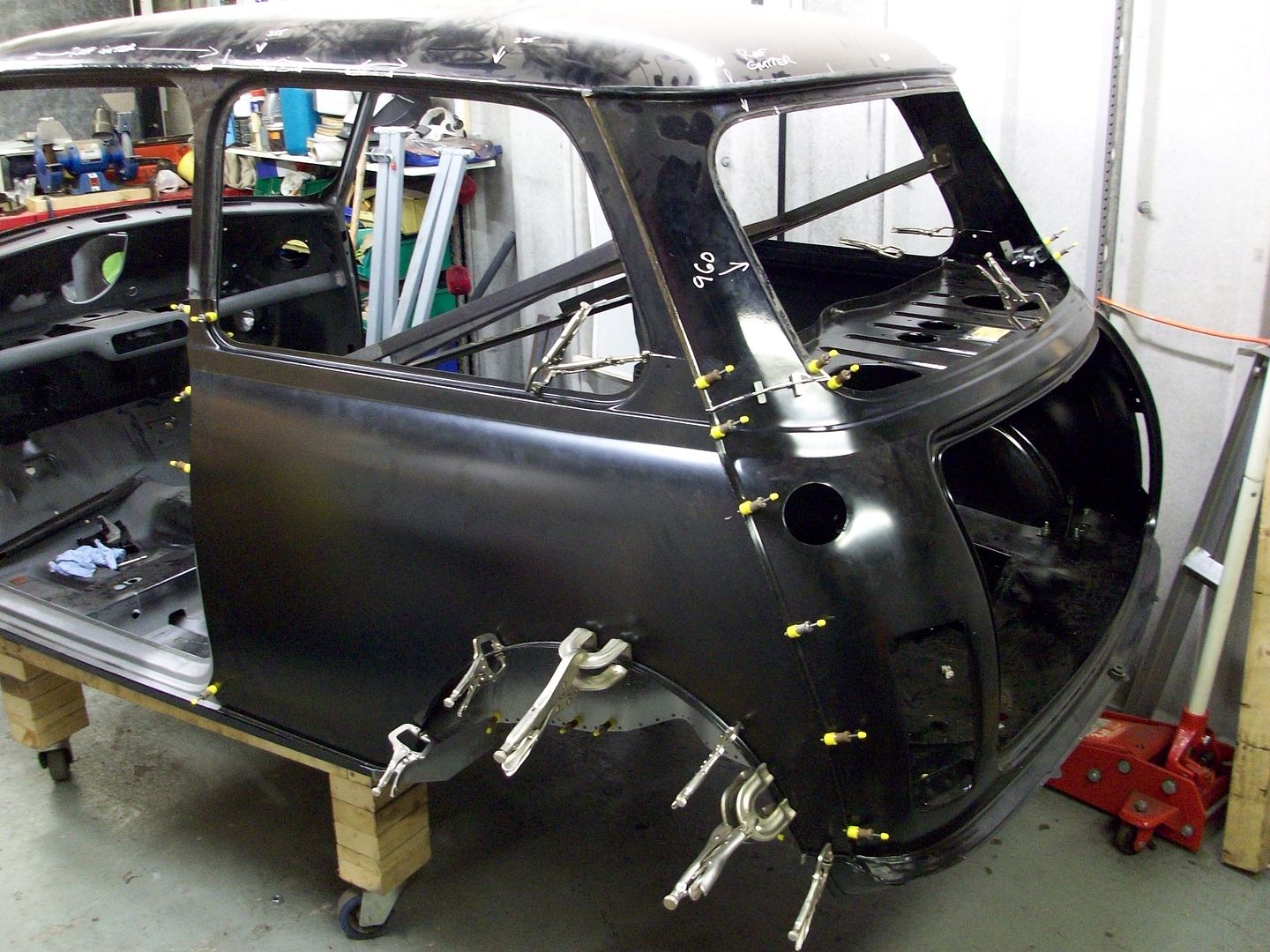

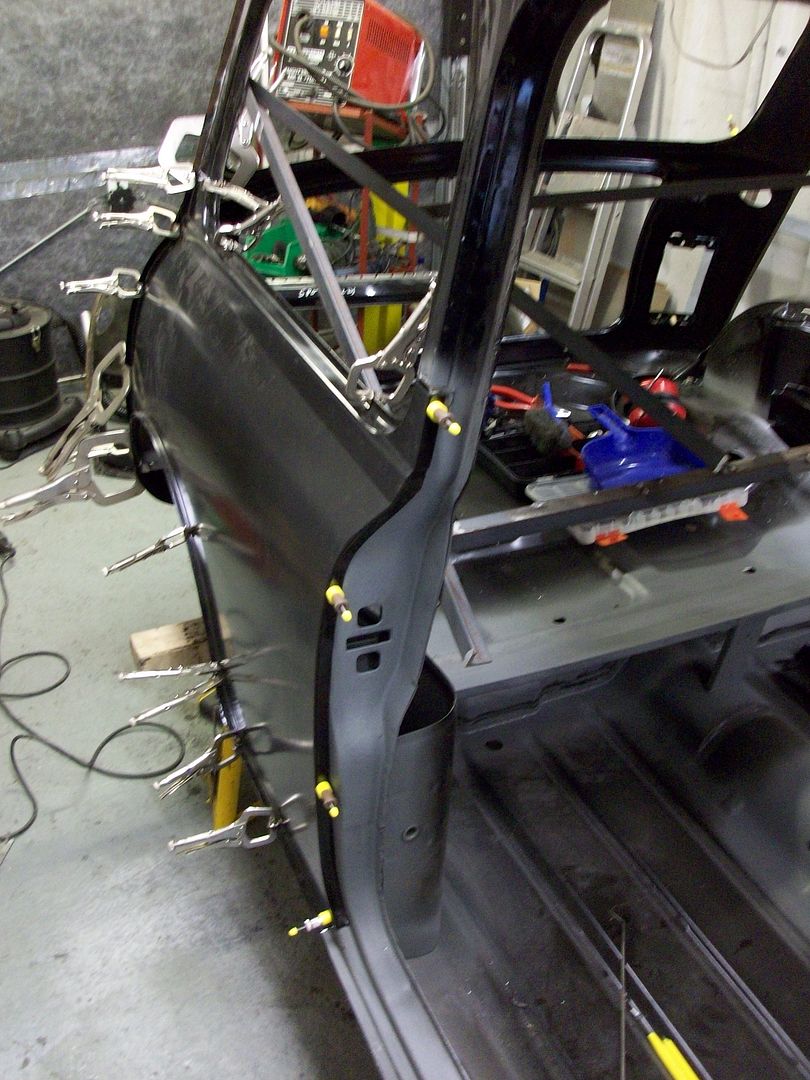

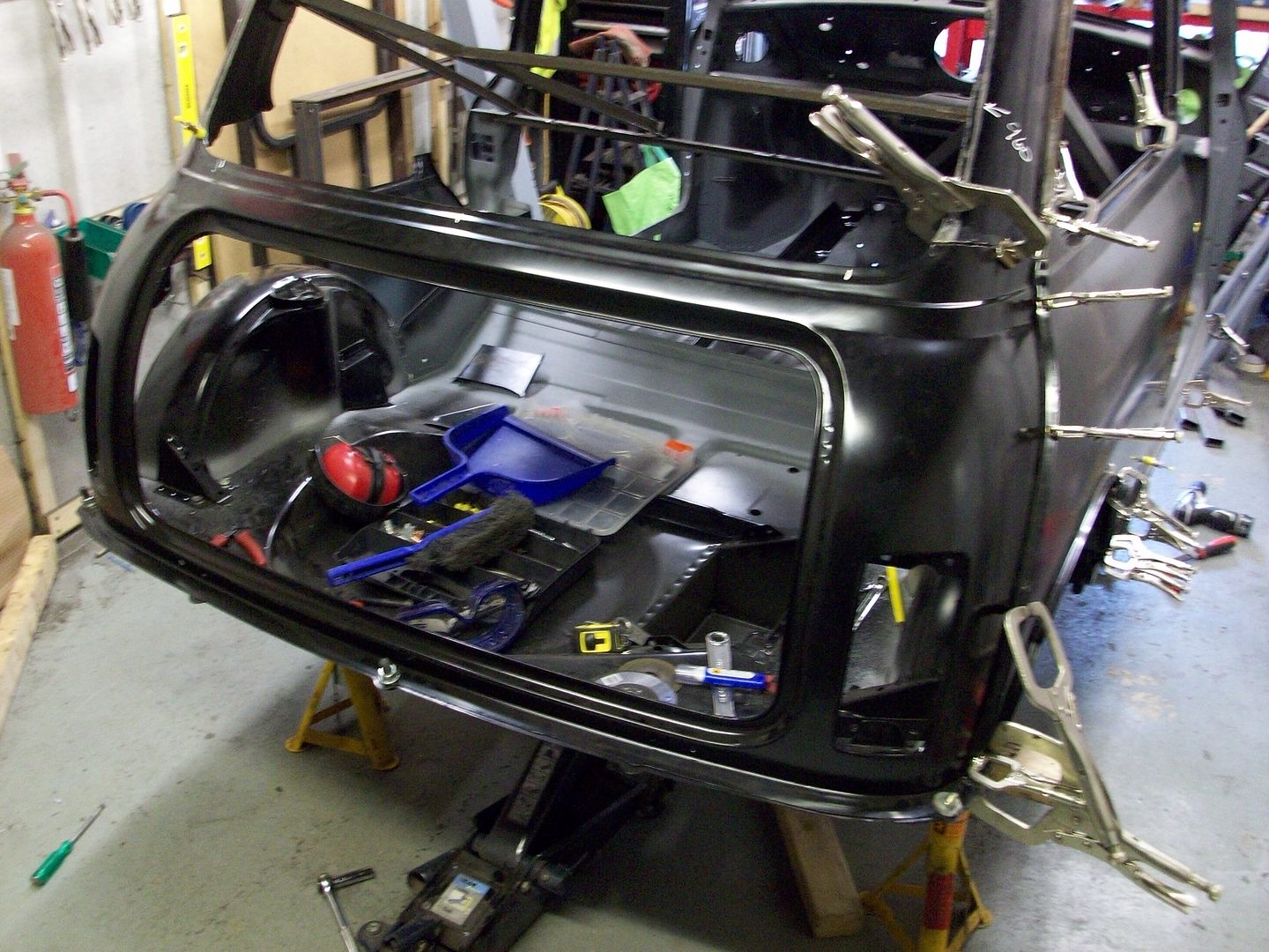

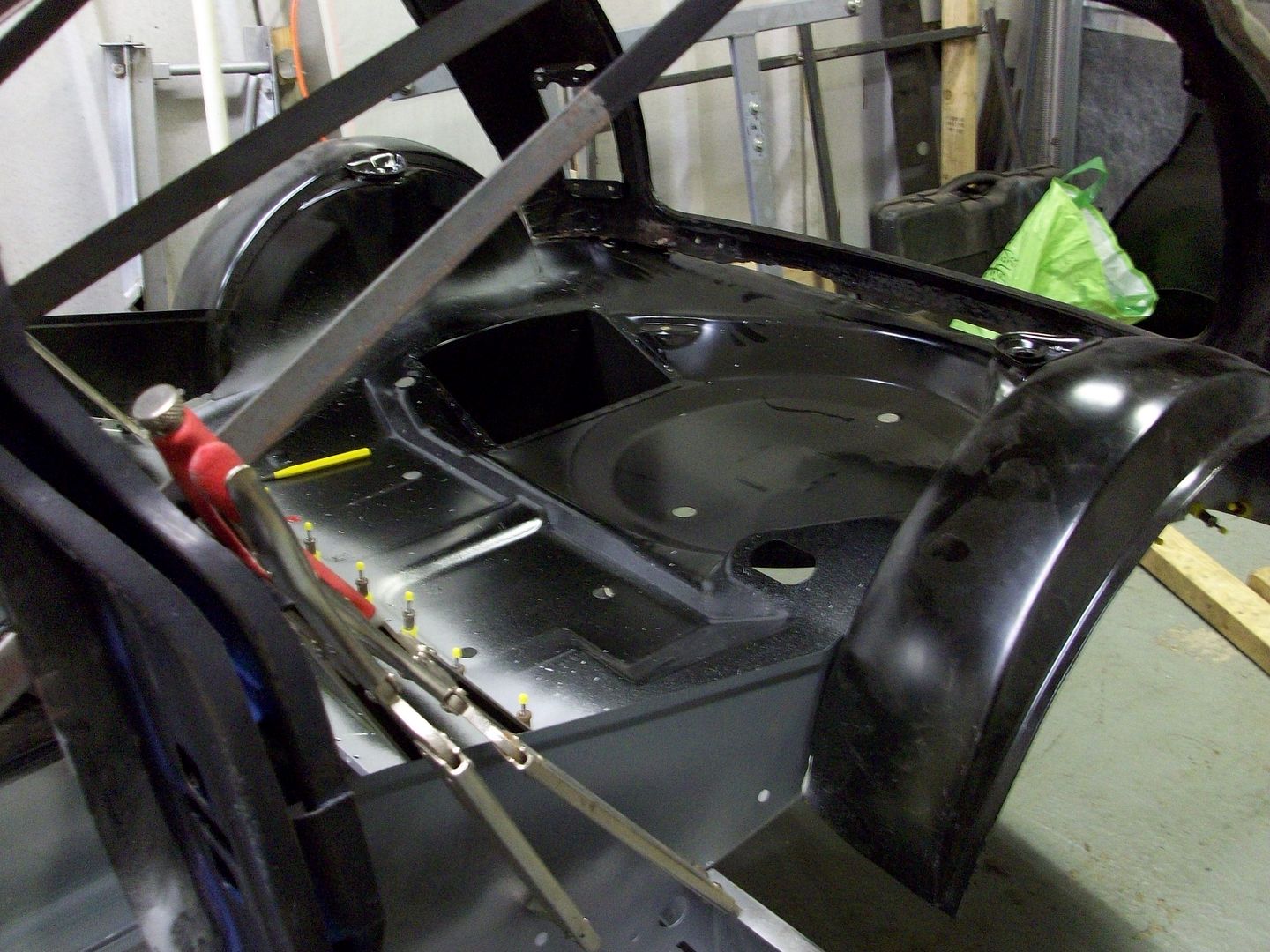

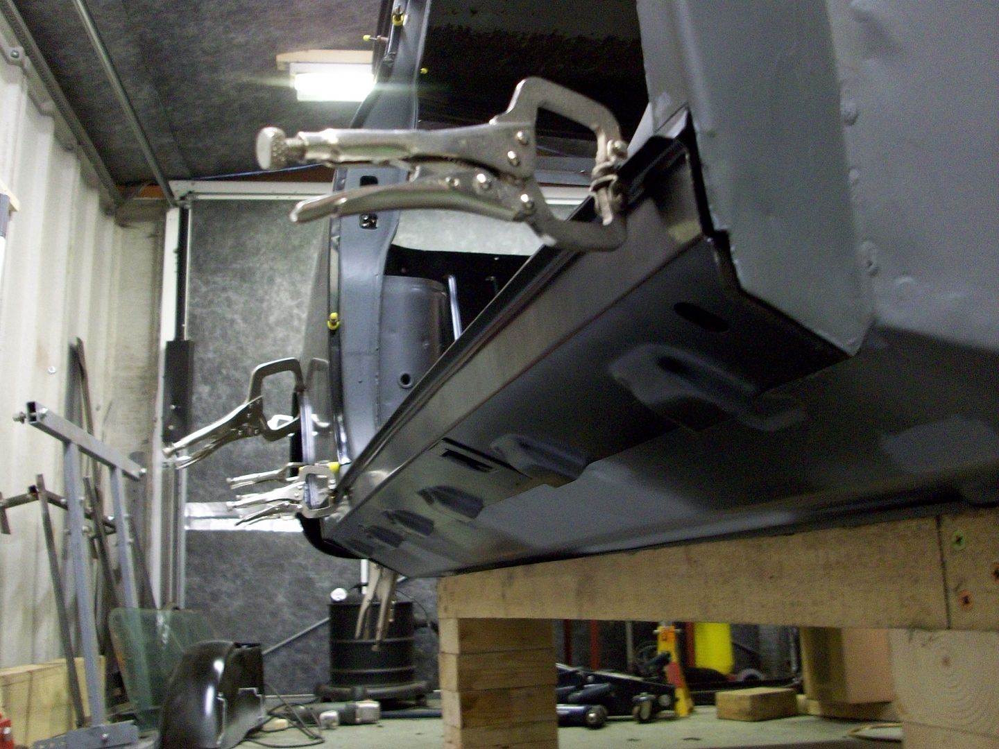

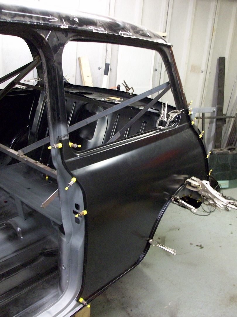

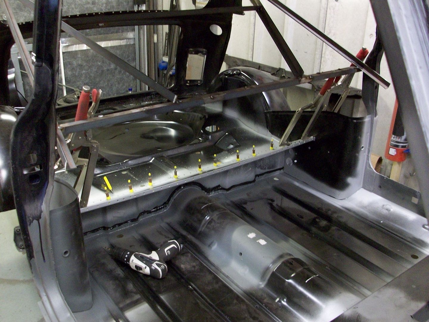

Right then. After my monumental *******up of my last attempt, and replacing the panel I damaged by not taking my time and getting frustrated, this w/e I took off all the rear panels back off and refitted them a bit more methodically. After many cups of coffee and several packets of biscuits this is the result. Still a few tweals but overall I'm pleased now.
Ger
#150 alchall
alchall
  • Just Joined
  • 604 posts
  • Location: Chorley
Posted 03 November 2015 - 09:16 AM
What had gone wrong Ger?
