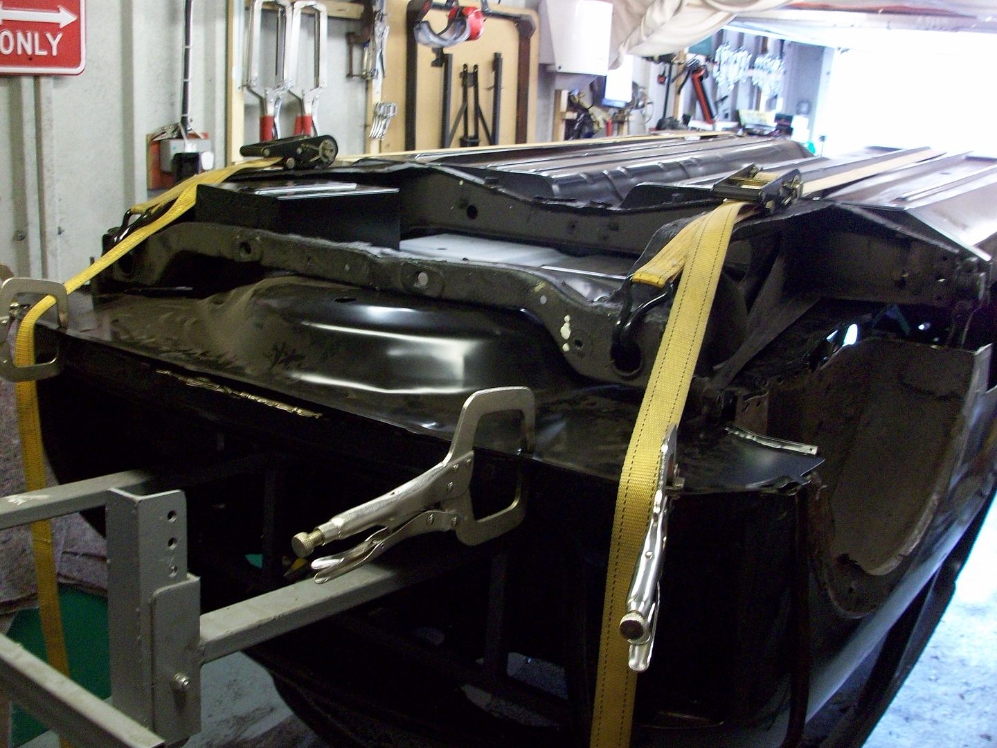

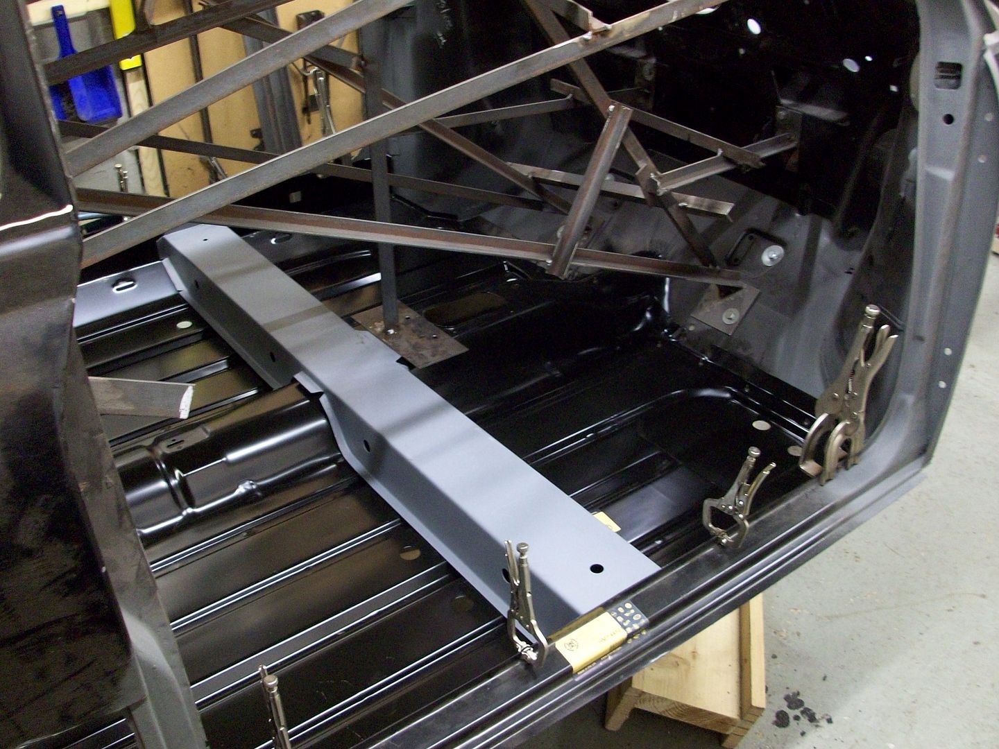

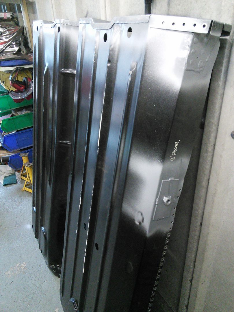

Made a start in putting in the floors.
Not welded in yet but clamped to check positioning.
Ger

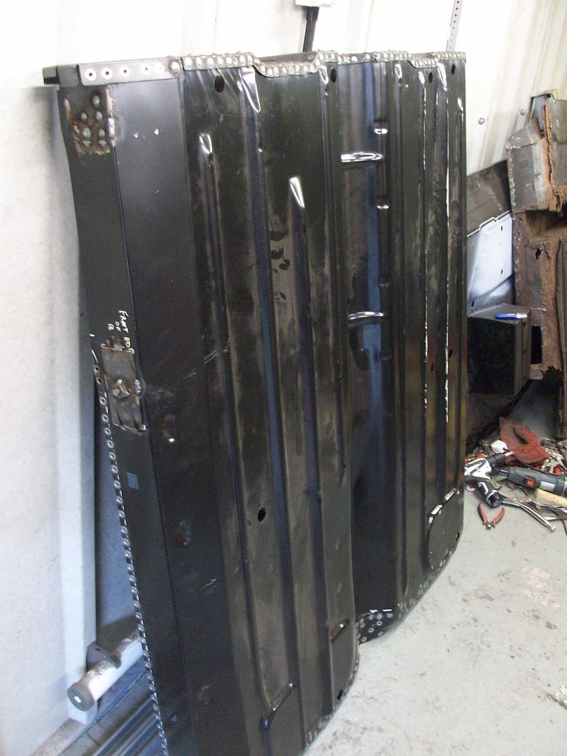

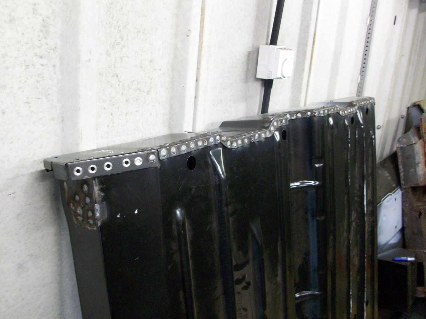

Posted 24 August 2015 - 06:30 AM

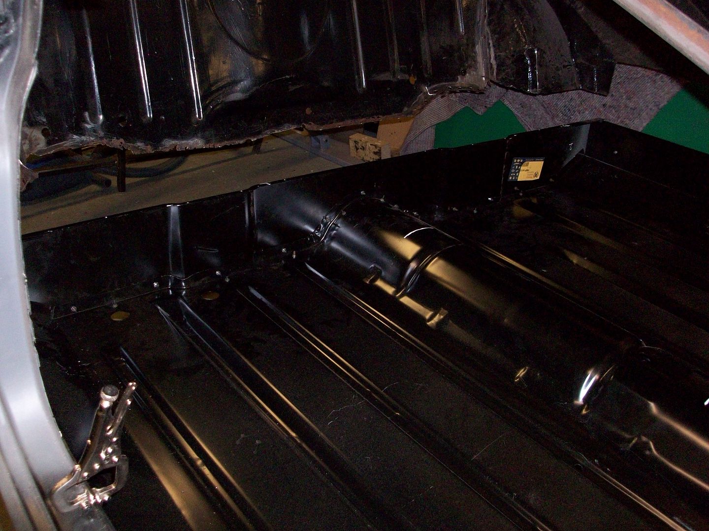

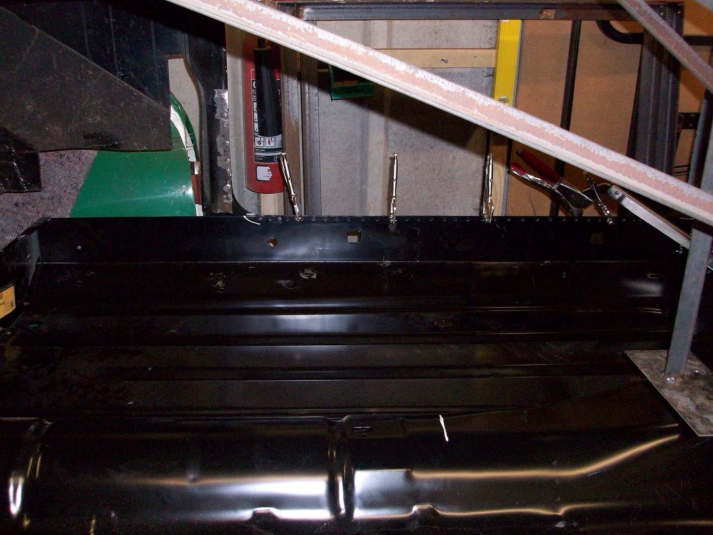

More checking alignment.
Finally last w/e heelboard and floor prepped for welding.
Weldathon on bankholiday w/e it is then.
Ger

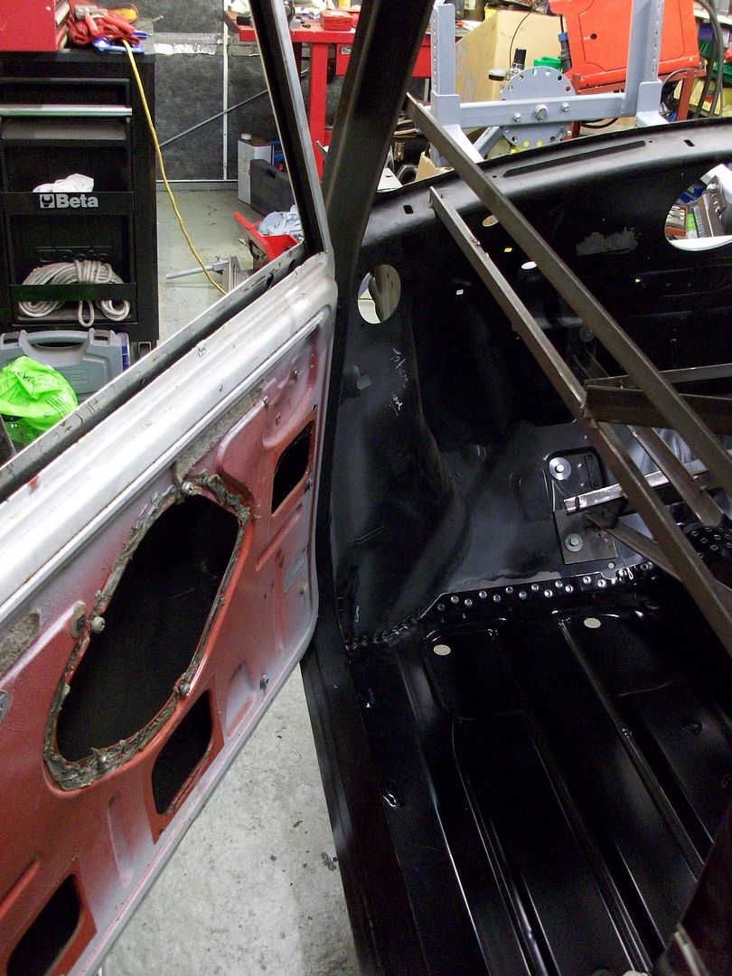

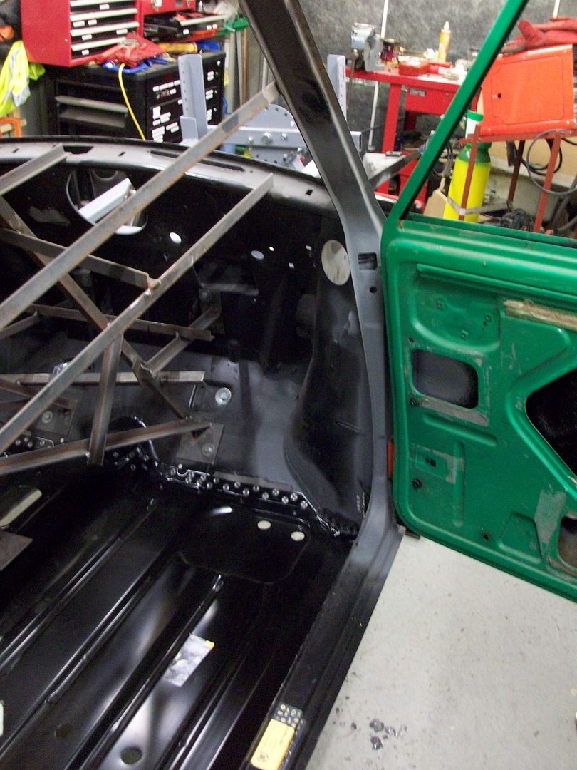

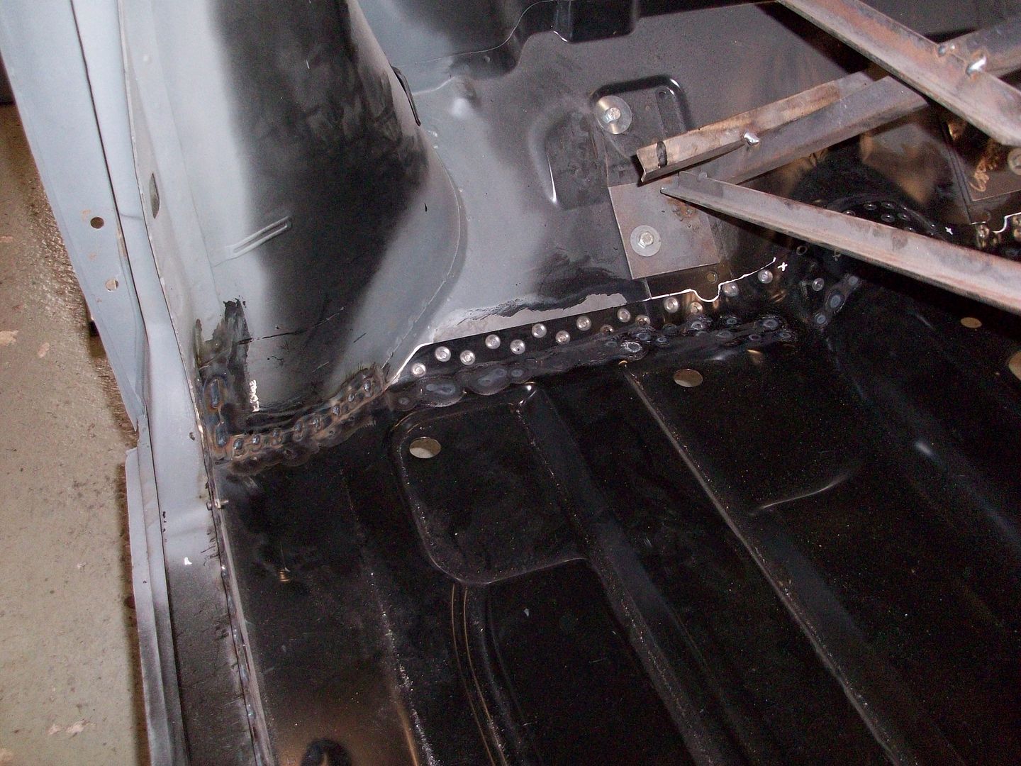

Posted 01 September 2015 - 08:00 AM

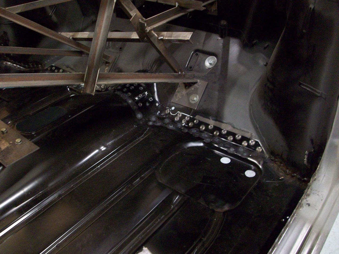

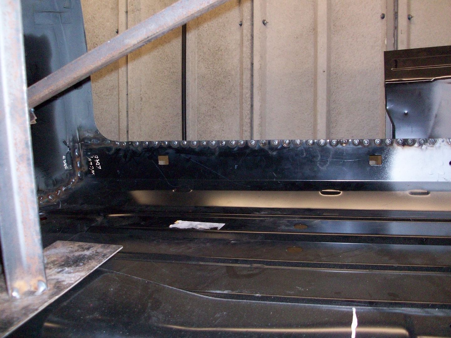

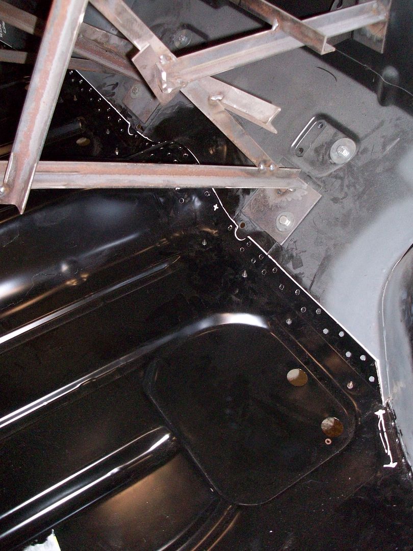

Had a busy bankholiday w/e. Welded the heelboard onto the floor pan.
Made a couple of lower seatbelt mounting plates - prob. a bit OTT as they were made from 3mm steel. Those were then welded onto the floor.
The welds were then ground down and zinc primered.
Then refitted the floor to the bodywork along with refitting the doors just to check that they still lined up to check theat there were no issues.
Then made a start at plug welding the floor in.
That was a lot of plugwelds.
I've still got some more plugwelds to do inside but I'm now able to remove a bit of the bracing so it won't be such a Krypton factor to get in there to do them.
Ger

#113 Ben_O
Ben_O
    Mill Road Garage
  • Paint Doctor
  • 9,794 posts
  • Location: Isle of Wight
Posted 01 September 2015 - 08:45 AM
Excellent progress!
Have fun grinding down the plug welds  :lol:

Would you agree that doing a whole floor pan is one of the easiest things to do. Looks good and definitely putting the whole floor pan in seems like you have taken a load of jobs off of the list in a short space of time

minimissions - Yer a big tick off my list.
James_eaton_thewholething - It was always going to be a complete floor cause of all the rot. Yer one big leap forward.
