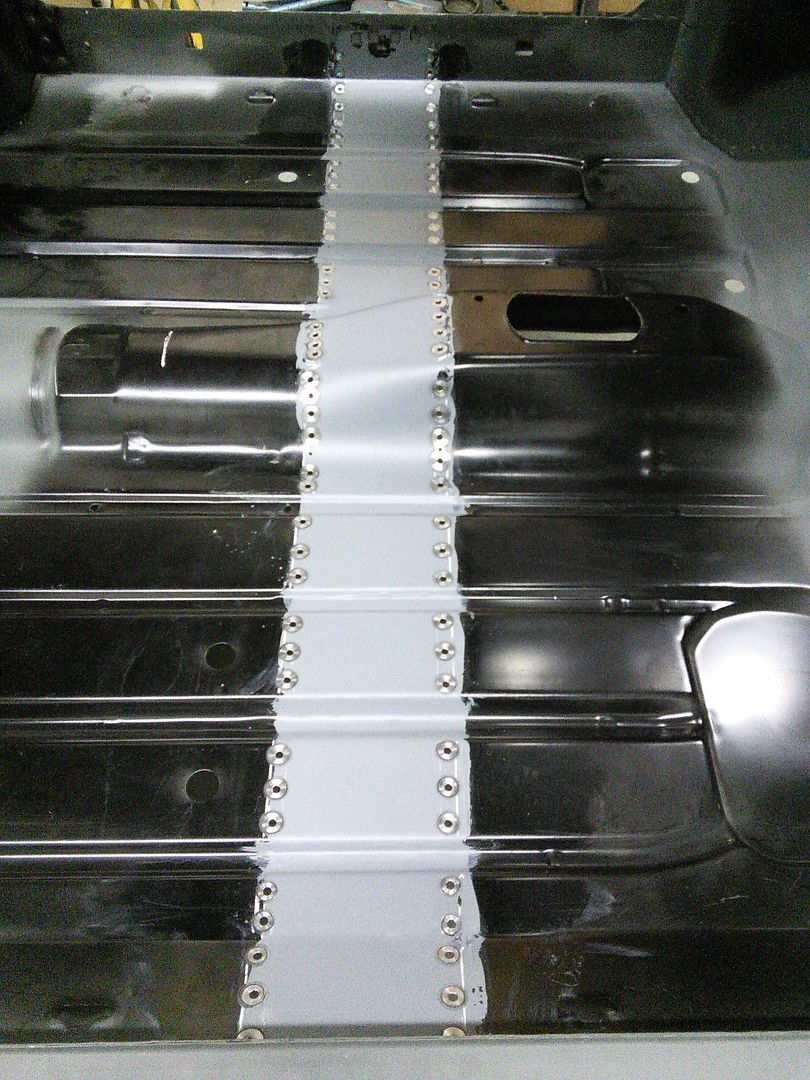

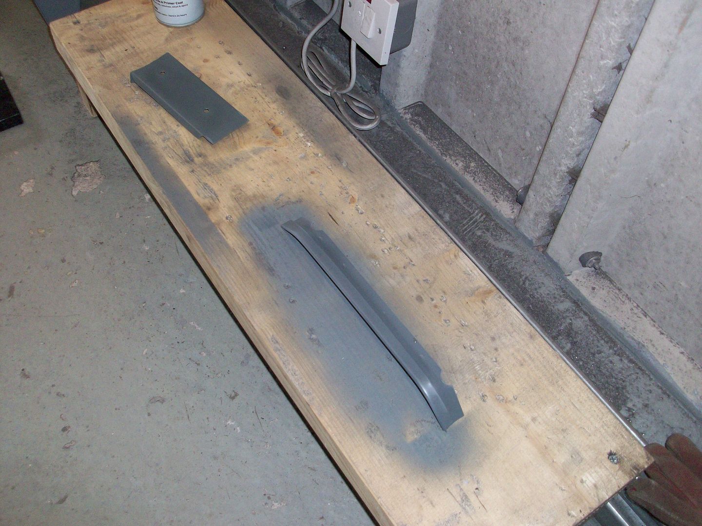

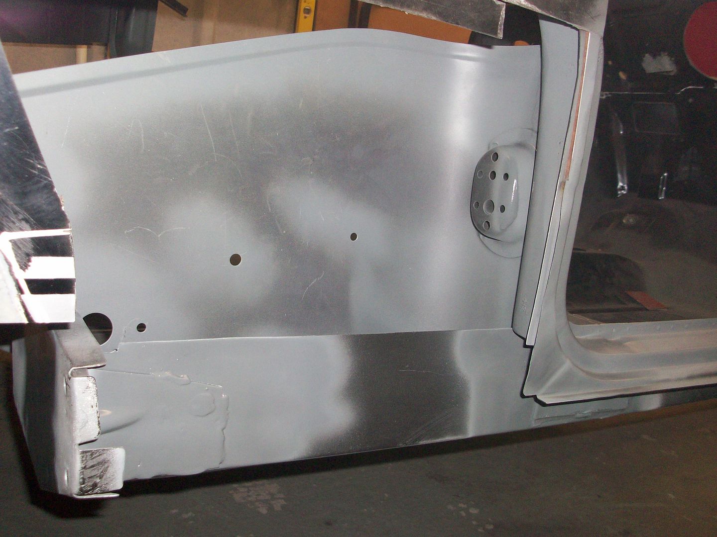

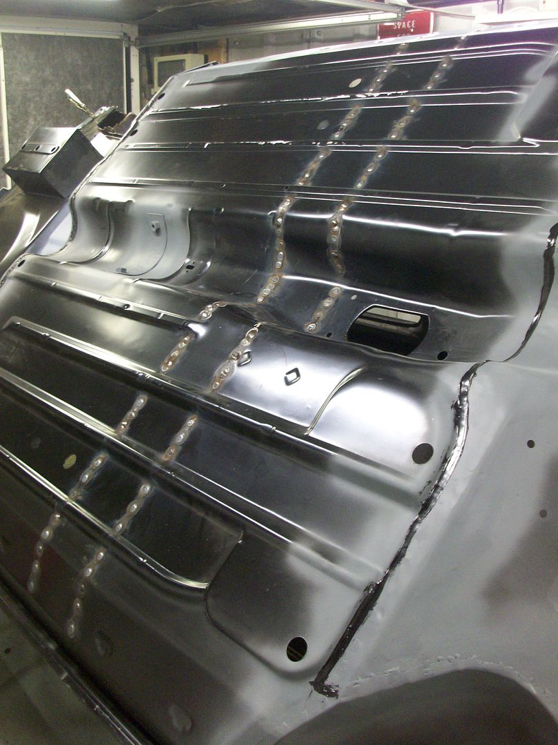

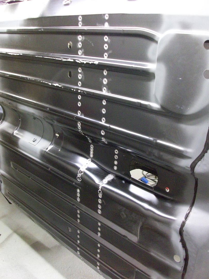

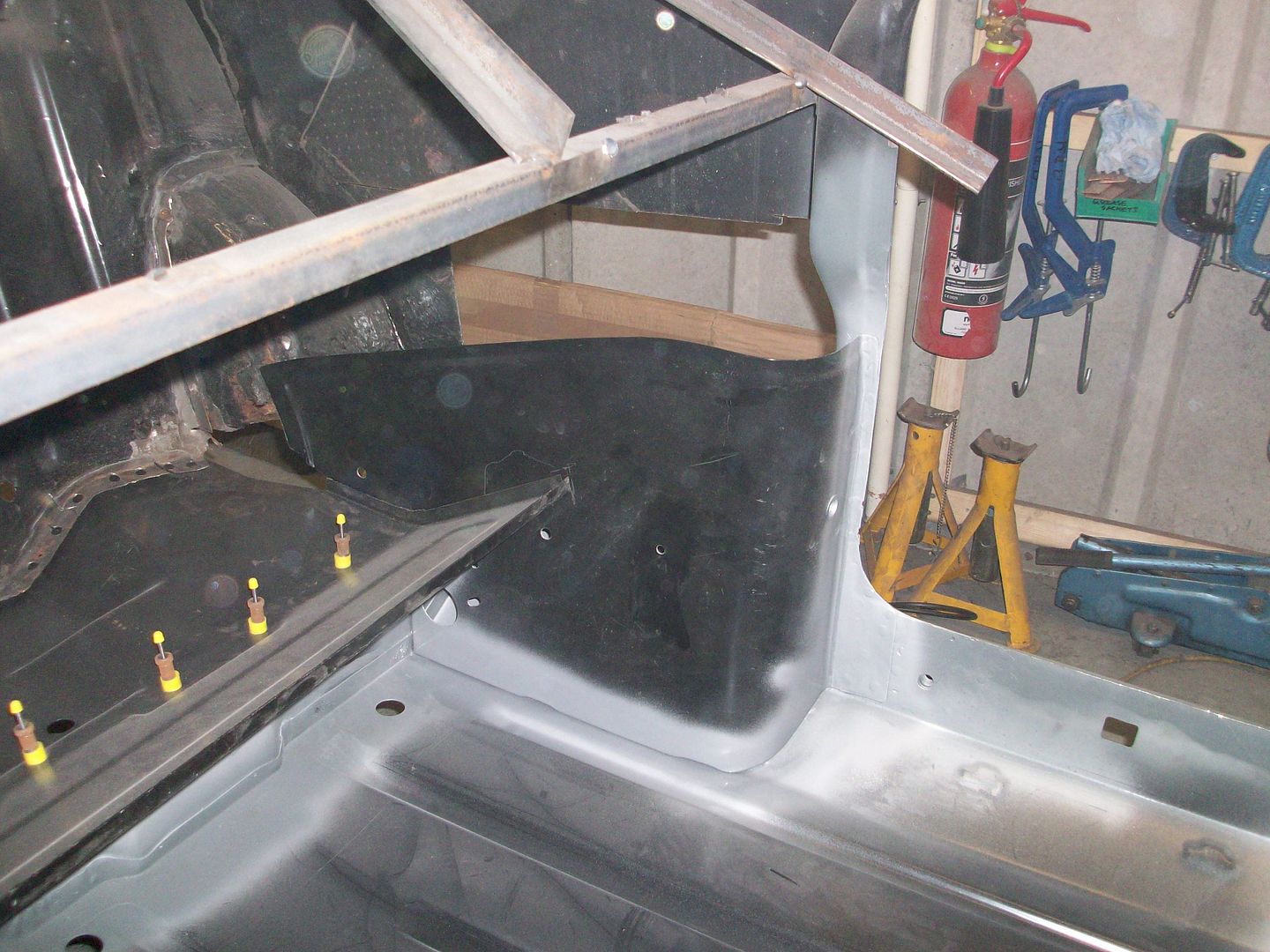

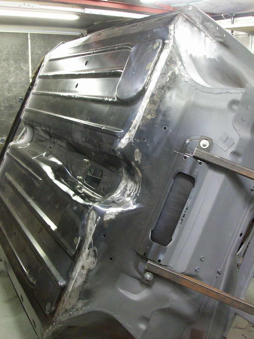

Not a lot this time, but it turned into all w/e.

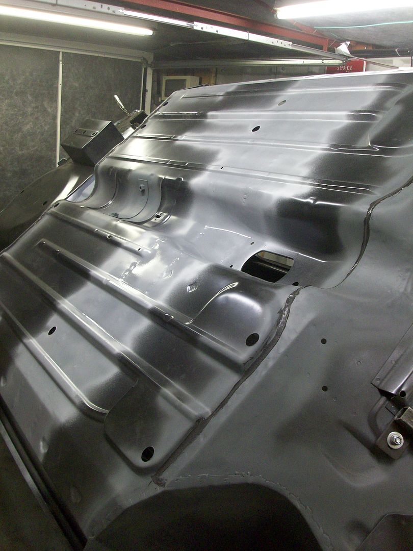

Took out some of the bracing for the front of the shell so it would be a bit easier to finish off welding the floor.

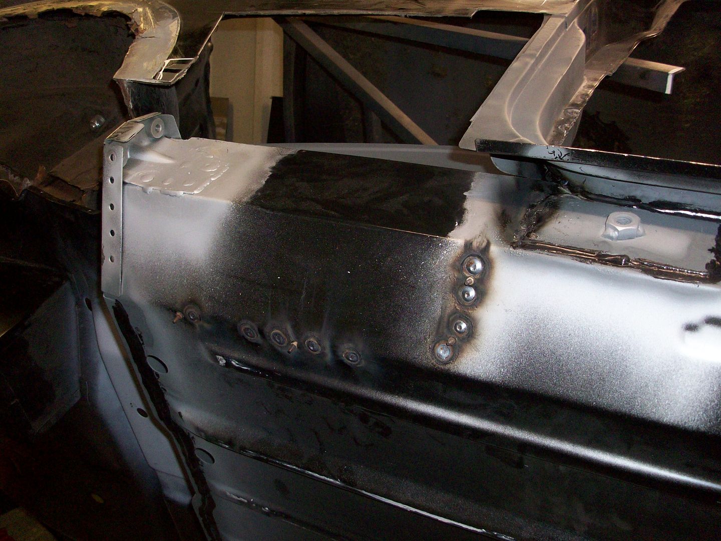

Just grinding down all the plugwelds on the floor and priming them.
Also made a start in putting in the seat crossmember.
Ger

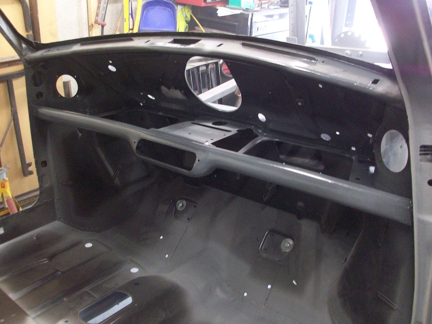

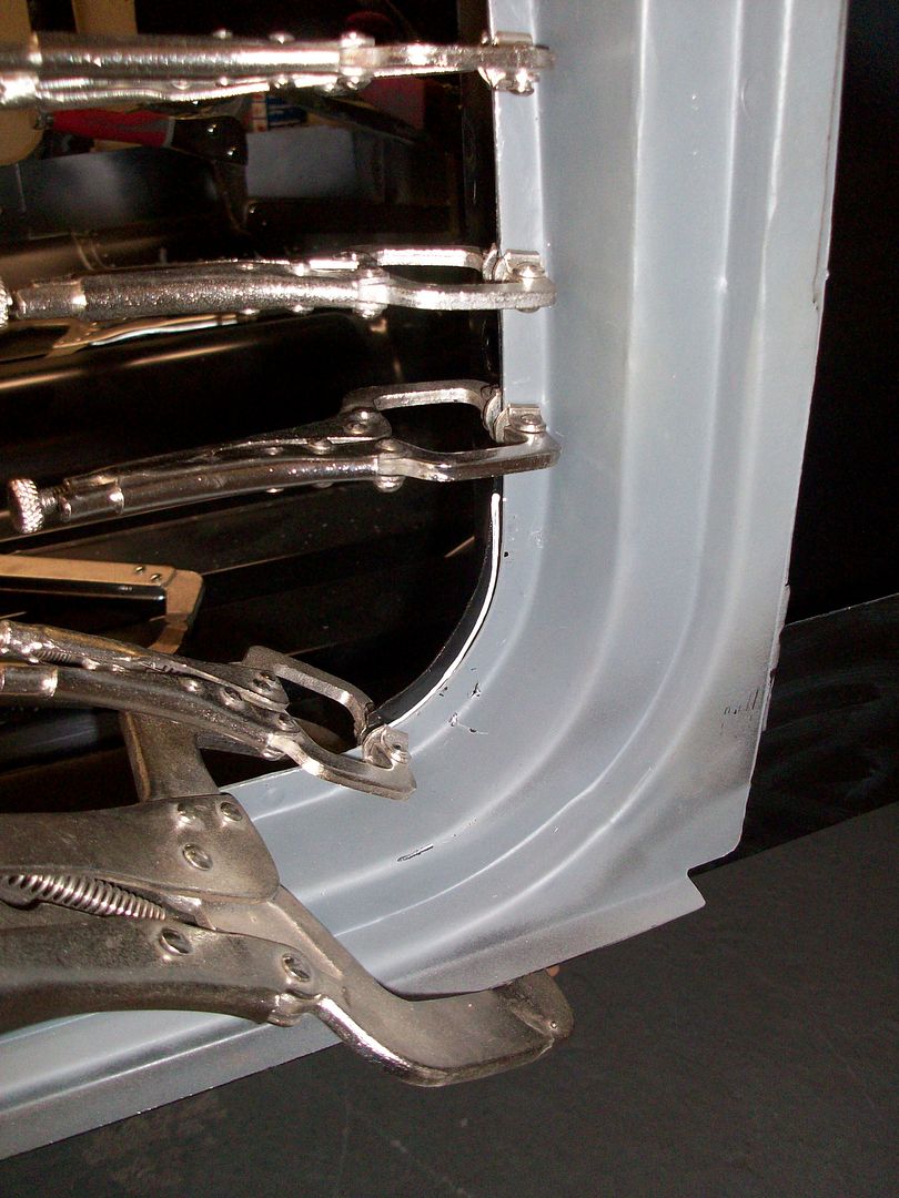

Posted 14 September 2015 - 11:45 AM

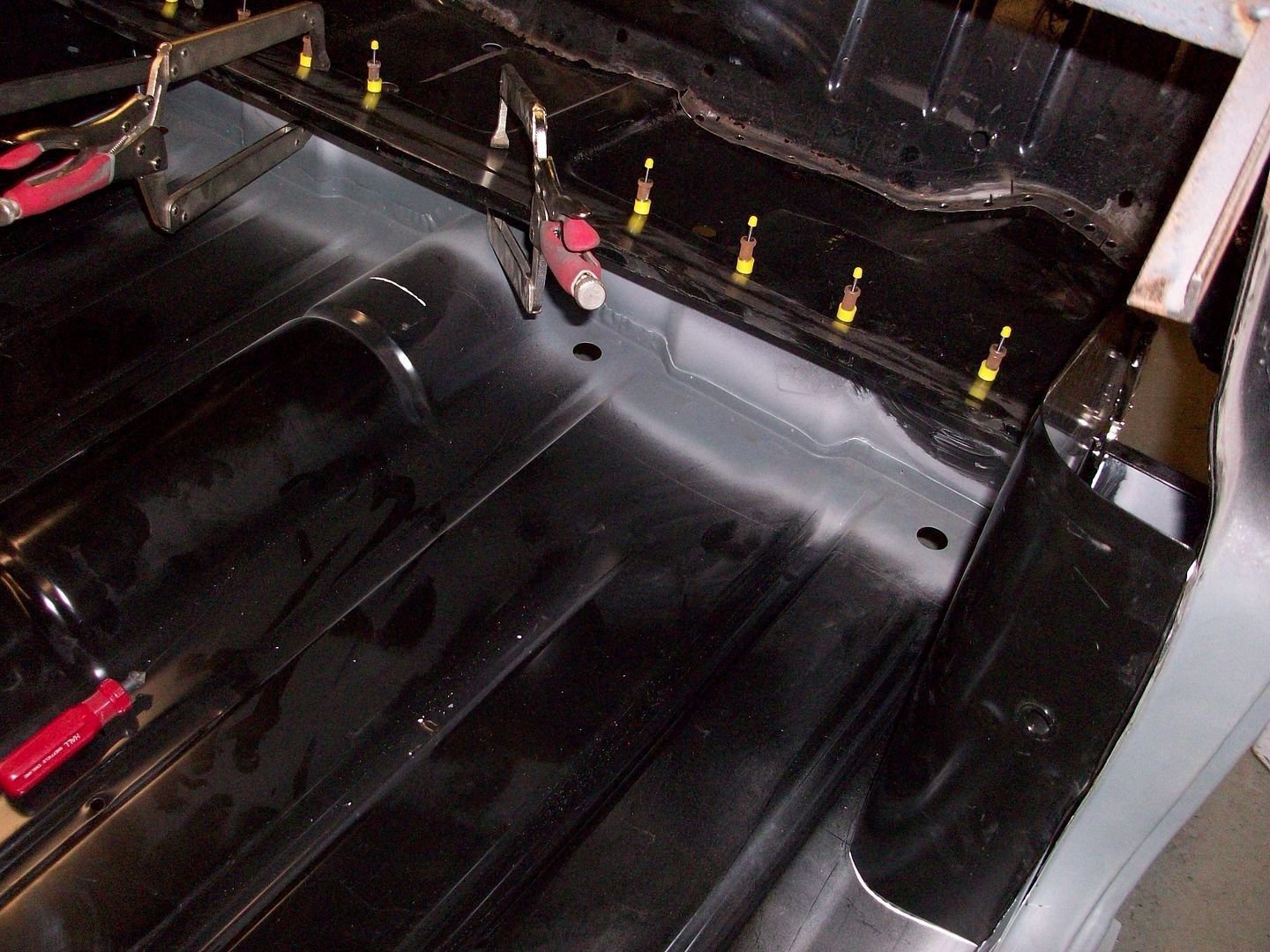

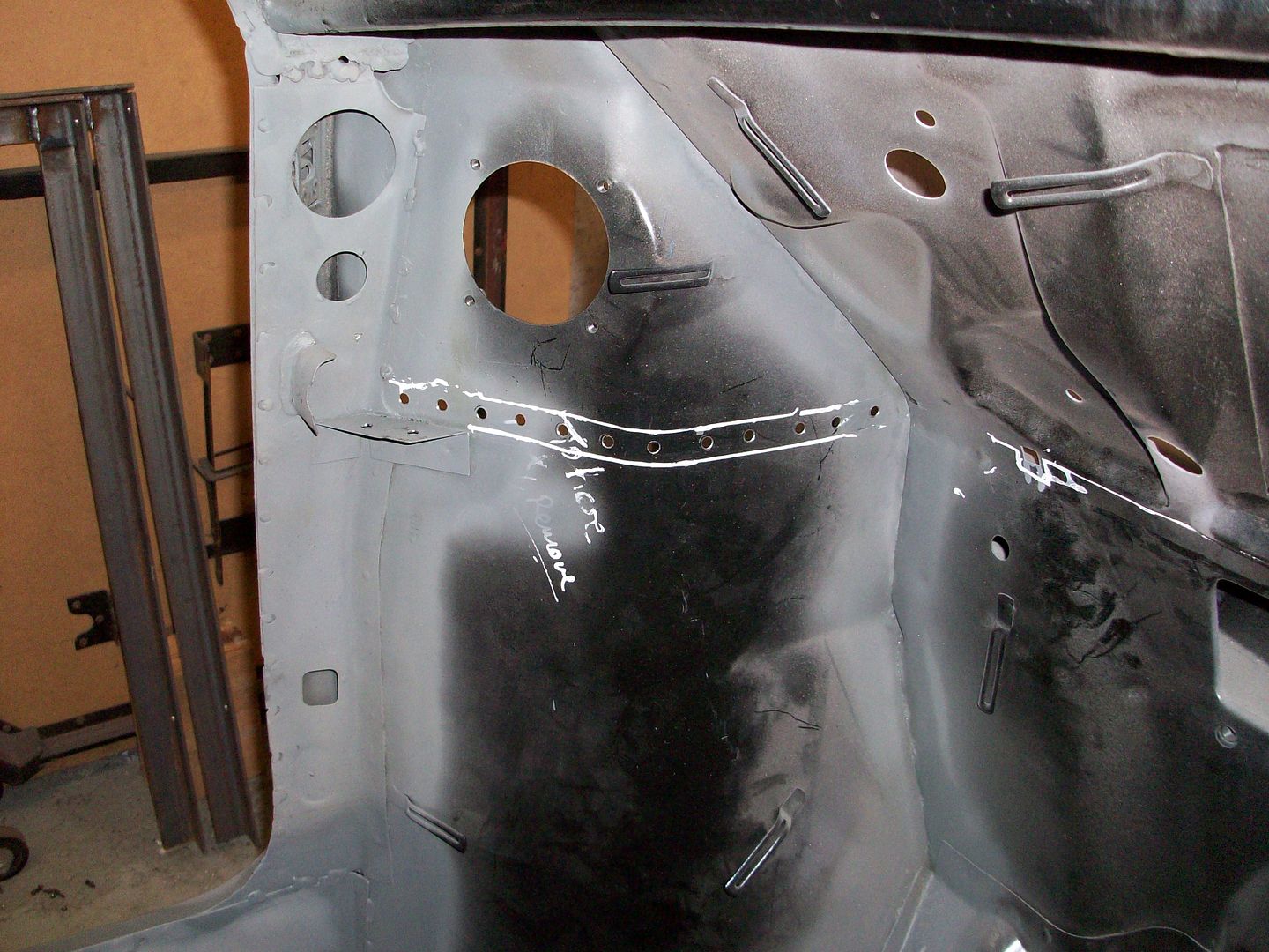

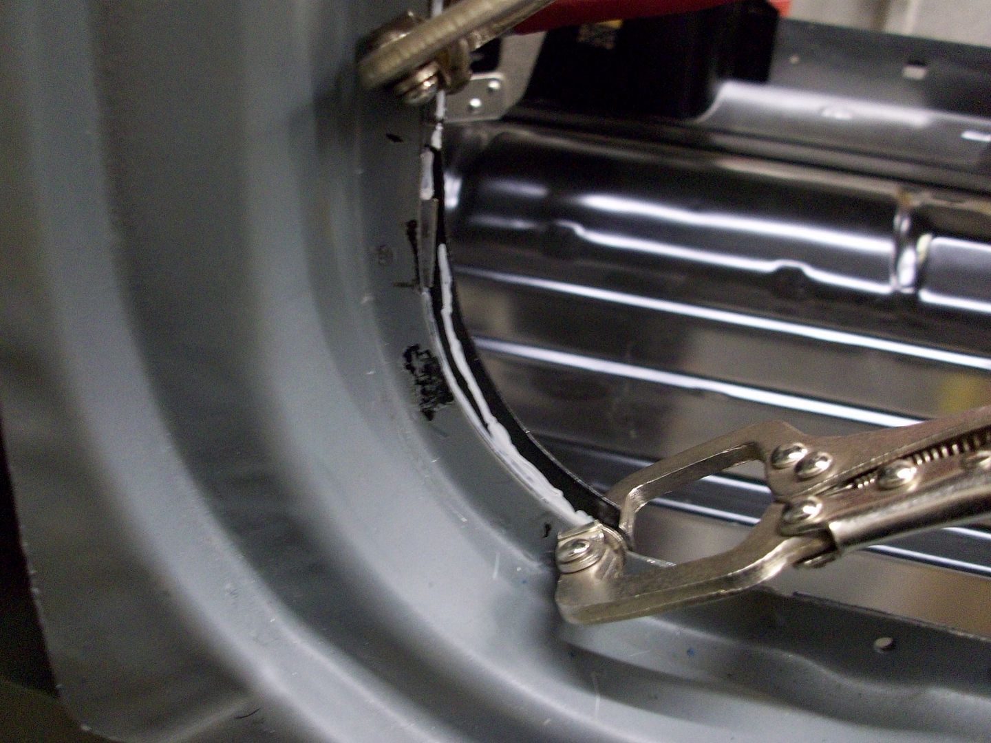

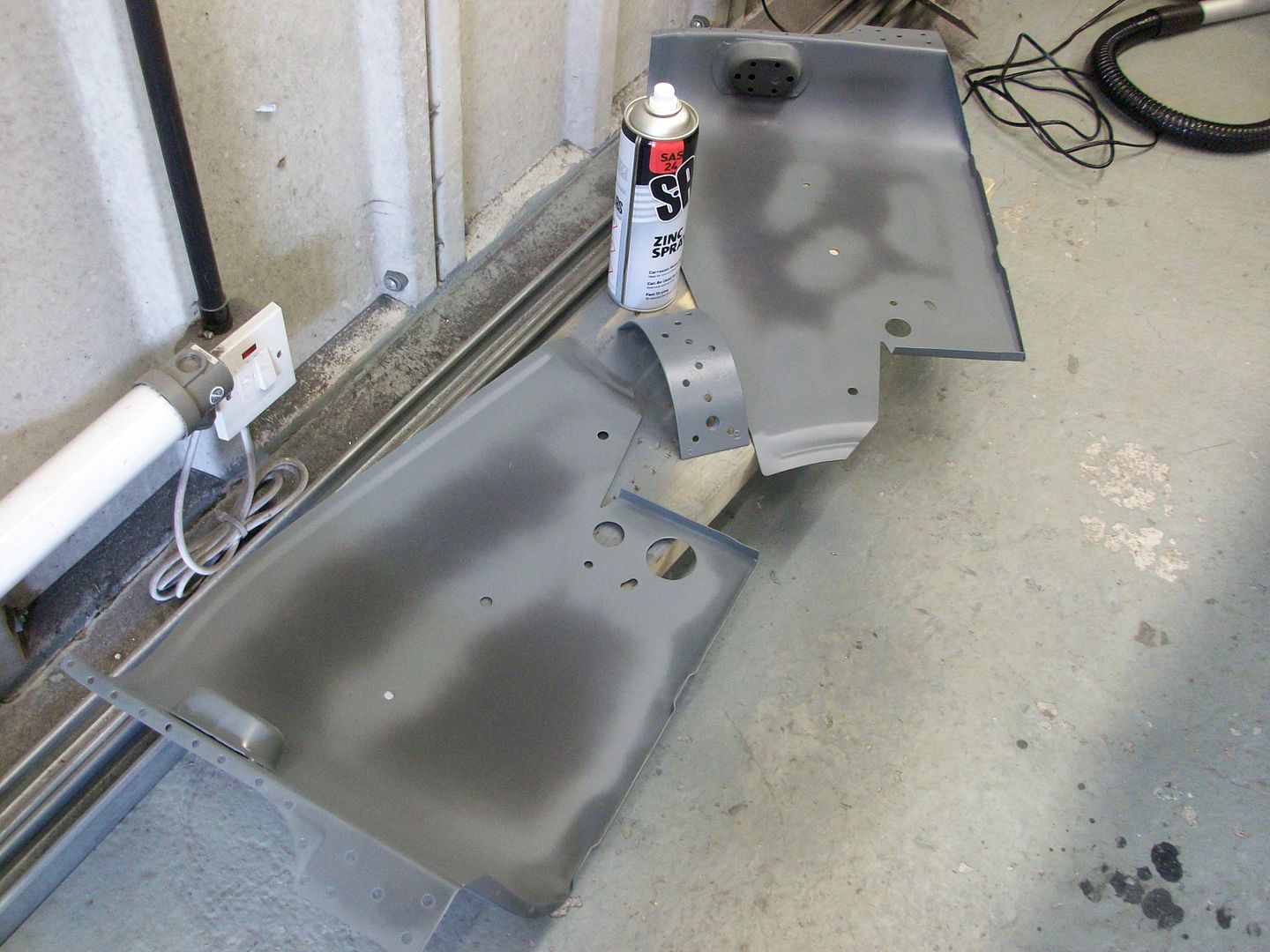

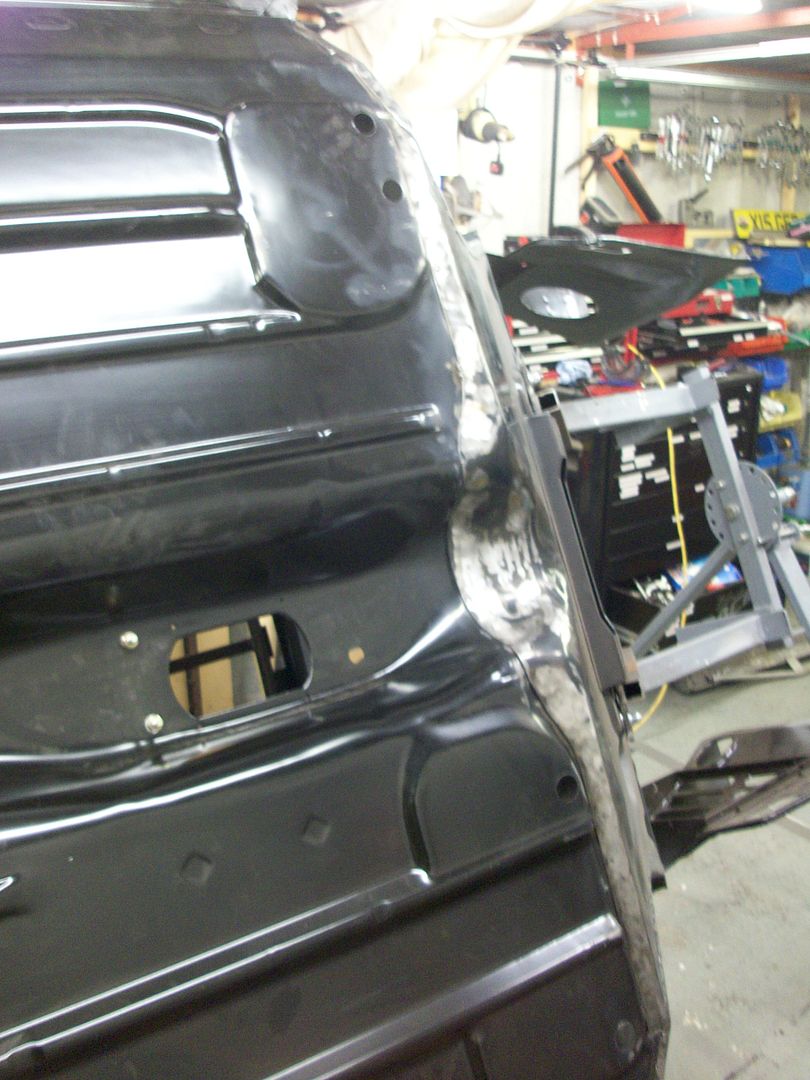

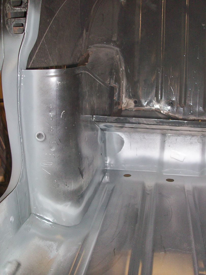

Not a lot done this w/e but a lot of time doing it.

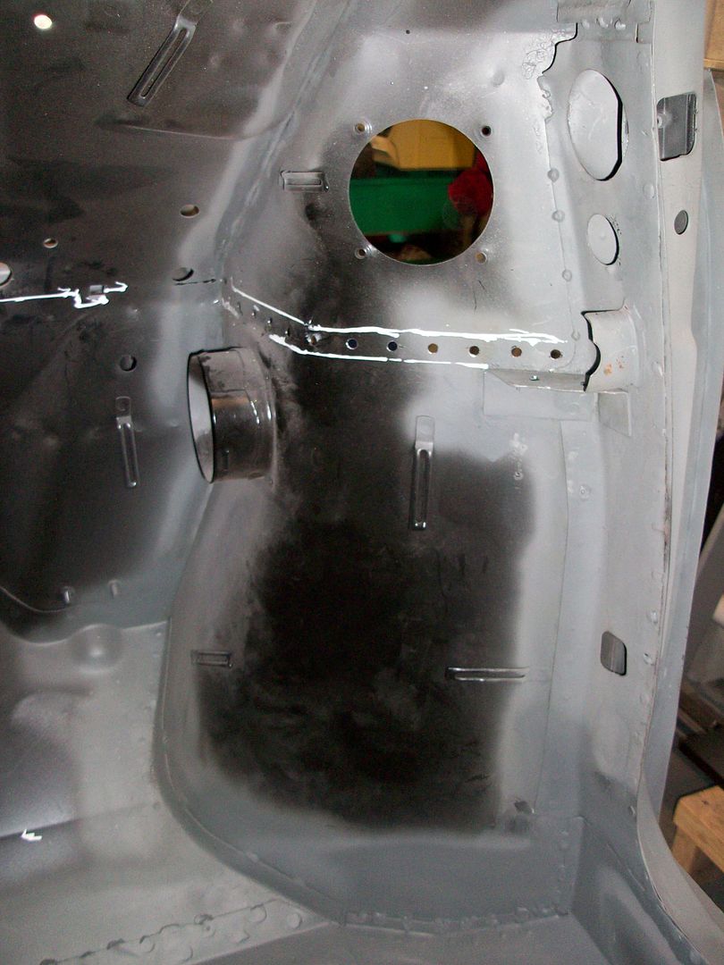

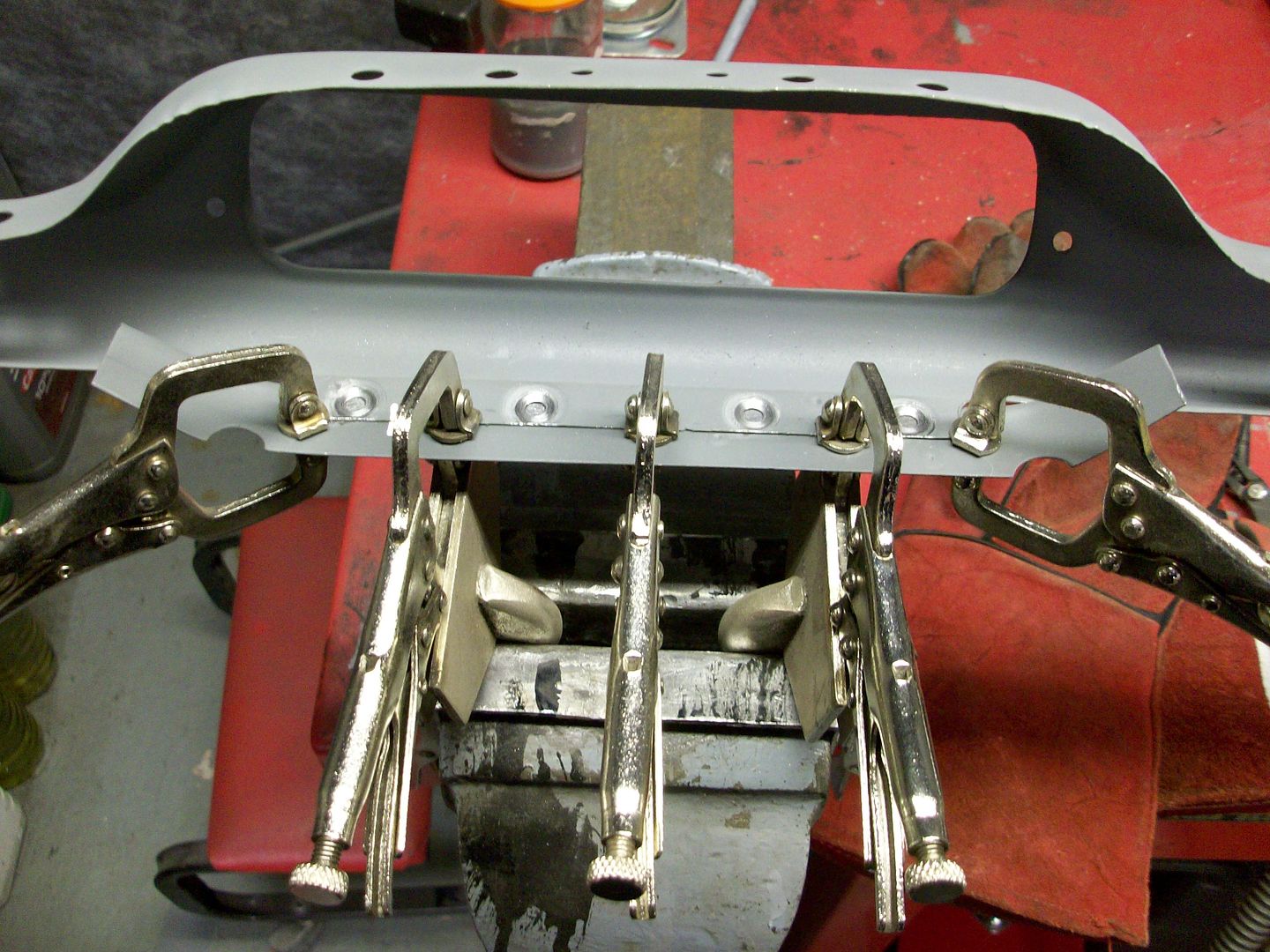

First off made a bracket that goes from the tunnel to the seat and primed that along with priming the small piece of metal from the lower dash.

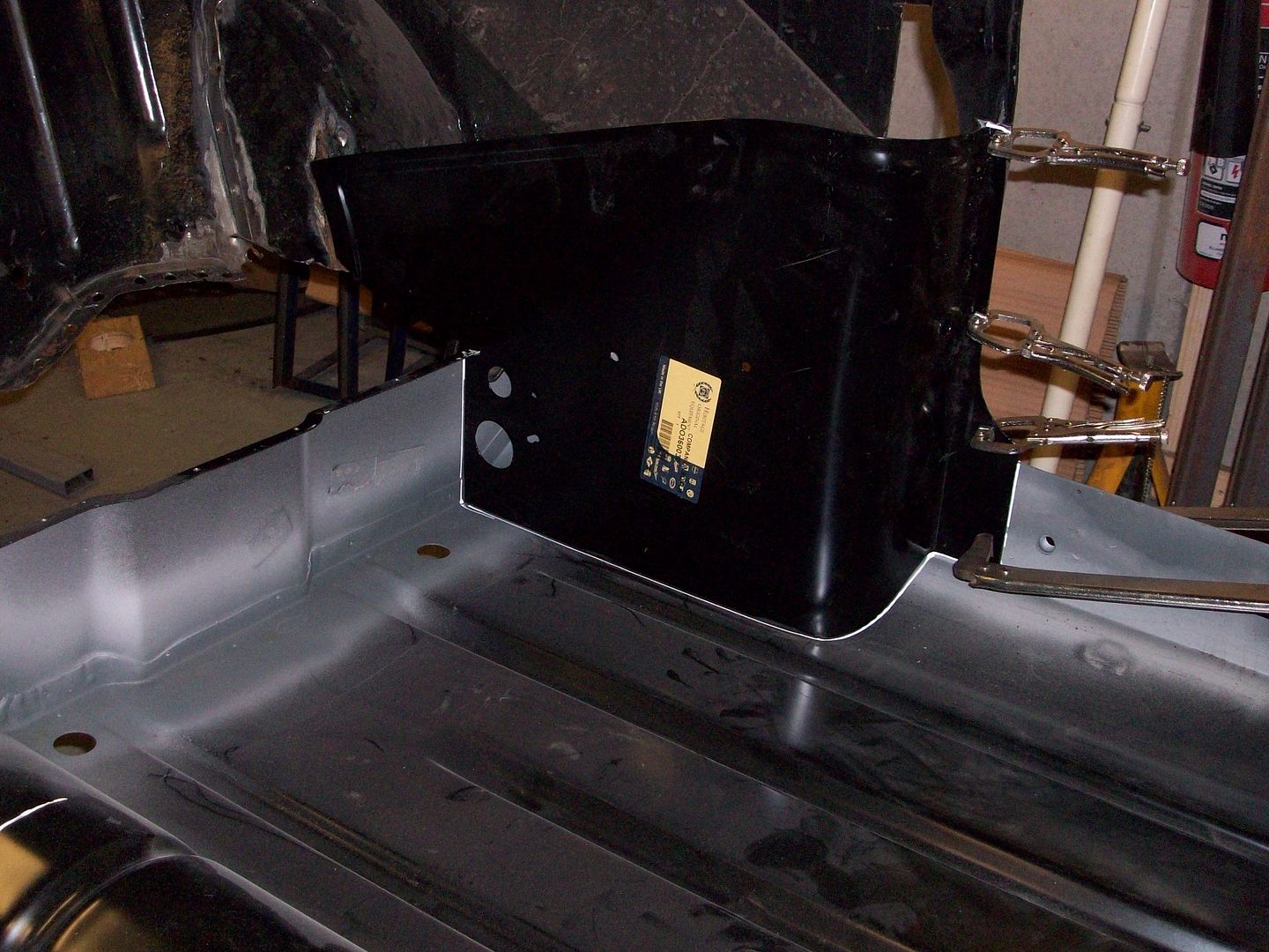

Then made sure the companion bins were a snug fit. Marked the floors and drilled ready for plugwelding.
Then had a good hour in getting the lower dash to sit against the bulkhead and the flitch panels.
The dash was stripped back down and the holes were drilled in the flitch panels for the welds.
As I'm re-using the original dash front that'll be stripped to make sure that there's no rust and zinc primered.
The seat cross member is to go in next then I can make a start on the boot floor.
Ger
Edited by ger, 14 September 2015 - 11:46 AM.

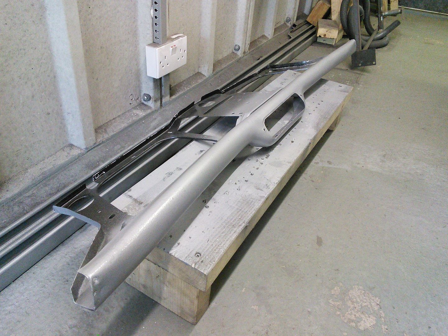

#125 ger
ger
  • Just Joined
  • 233 posts
  • Location: The Land Of Song
  • Local Club: M4 Minis

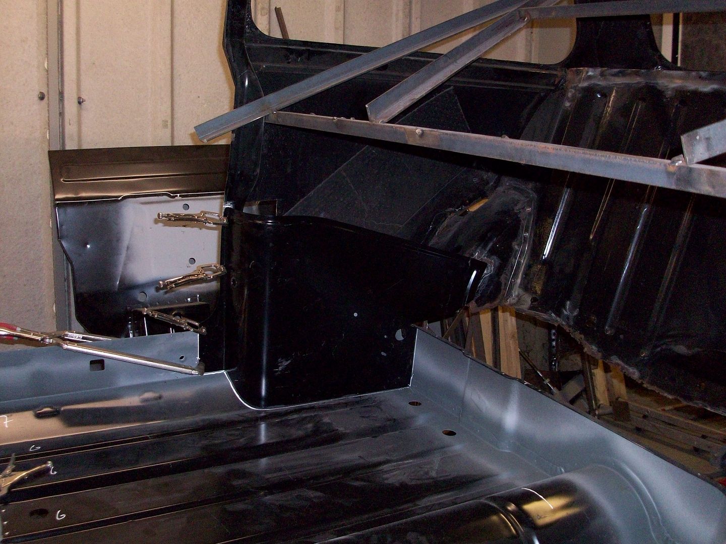

Posted 29 September 2015 - 07:39 AM

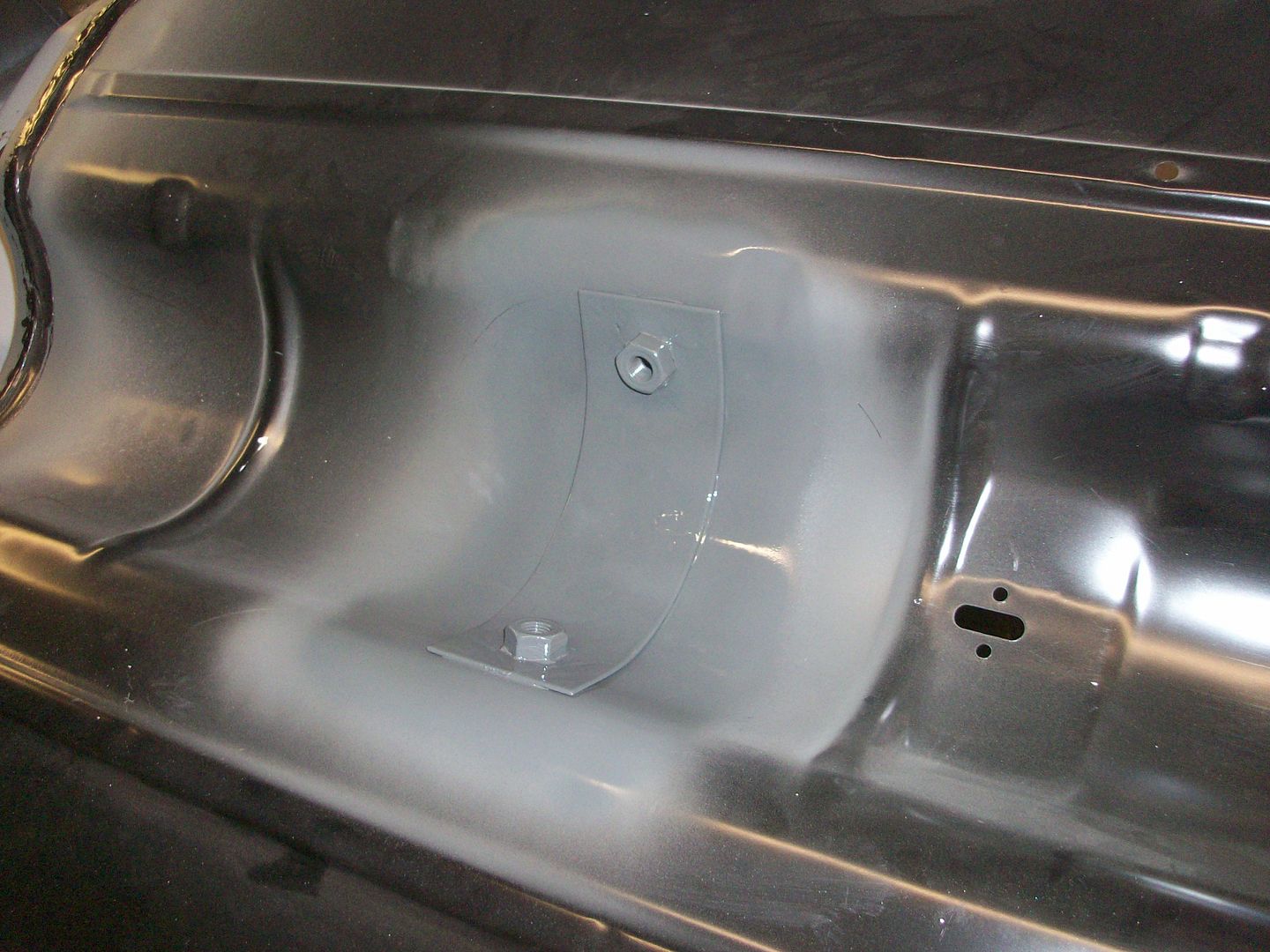

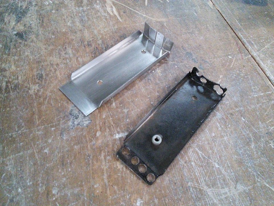

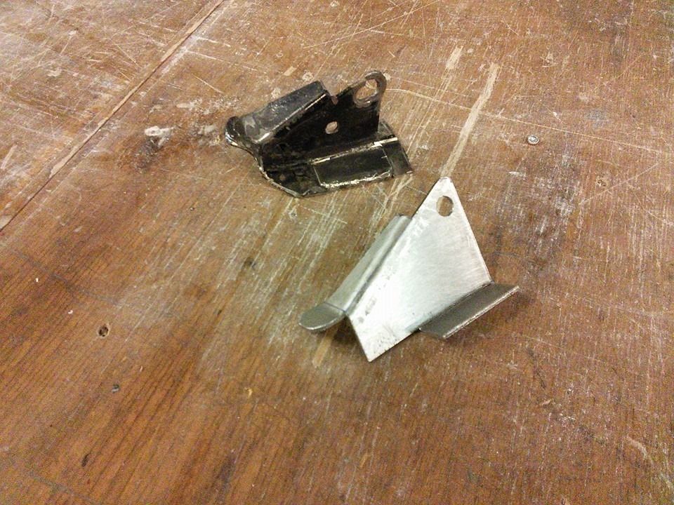

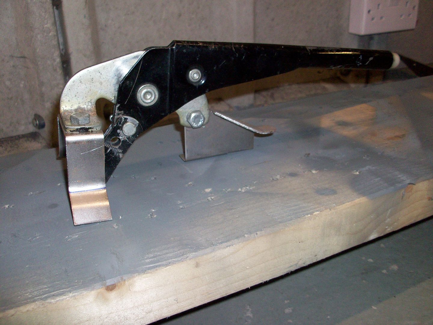

A bit of an update for over the last 2 weeks.

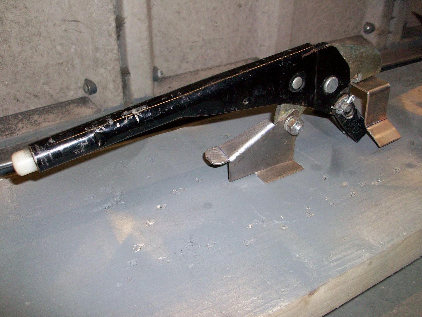

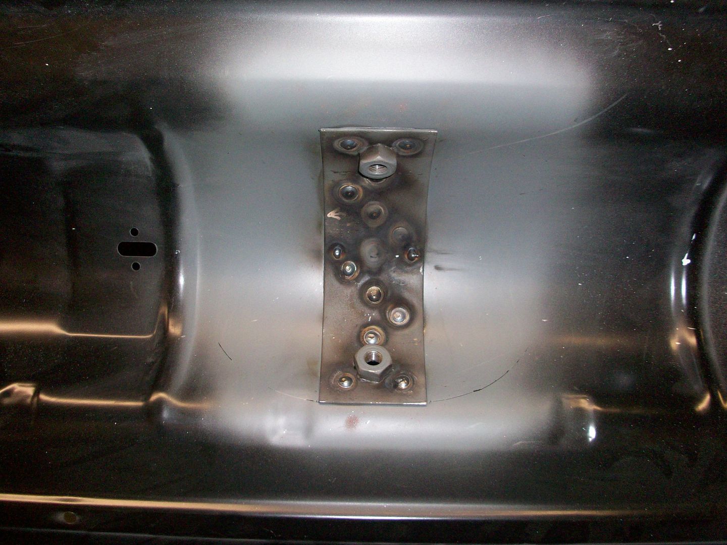

Made a few more bits and pieces - two brackets for the handbrake.
Wiring loom tags for the new boot floor.
Also seat to tunnel bracket.
And while I was at it I thought I would put an interior light on the drivers side so I made a bracket for the additional light.
Not a lot but some pennys saved.

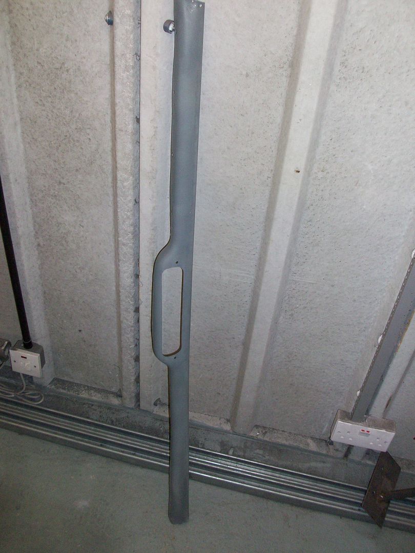

Done a bit more of the jigsaw just to make sure that everything fits.
A little more adjustment and prep for welding.

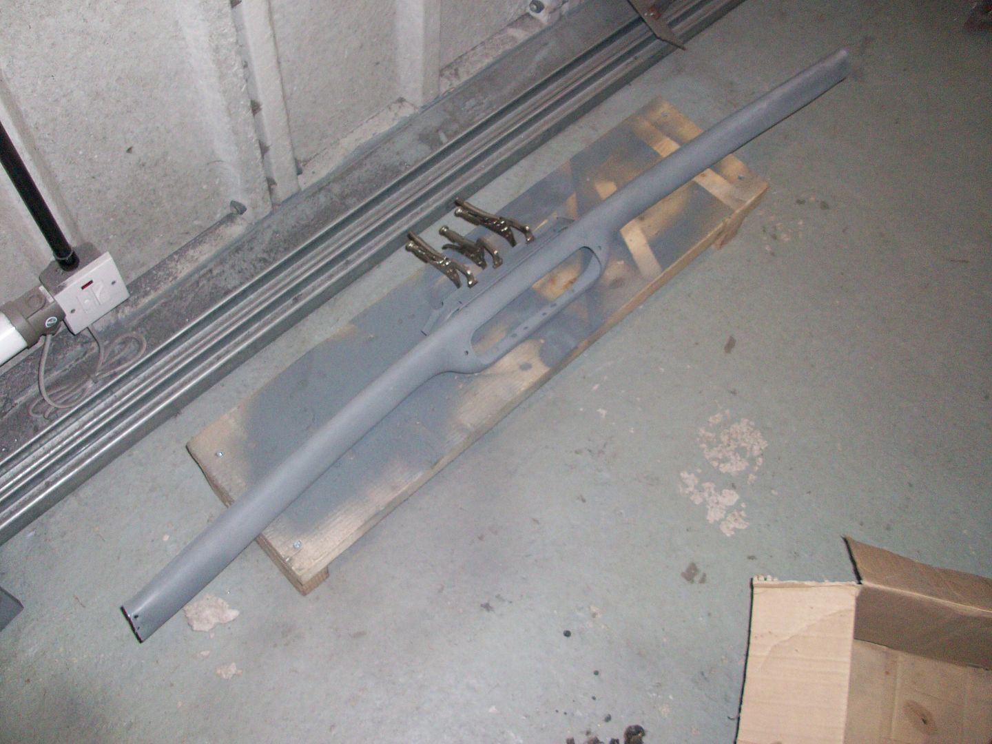

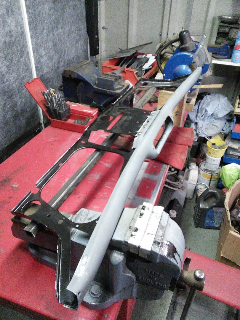

Stripped down the original dash rail and primered, ready for welding.

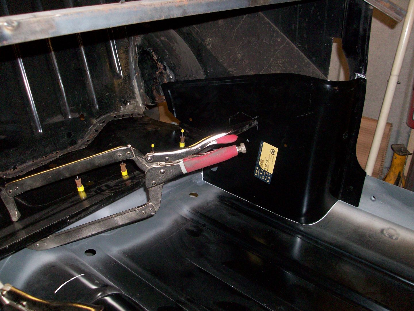

Last w/e a bit more welding done.
Only got the one companion bin done, but at least its progress.
Ger

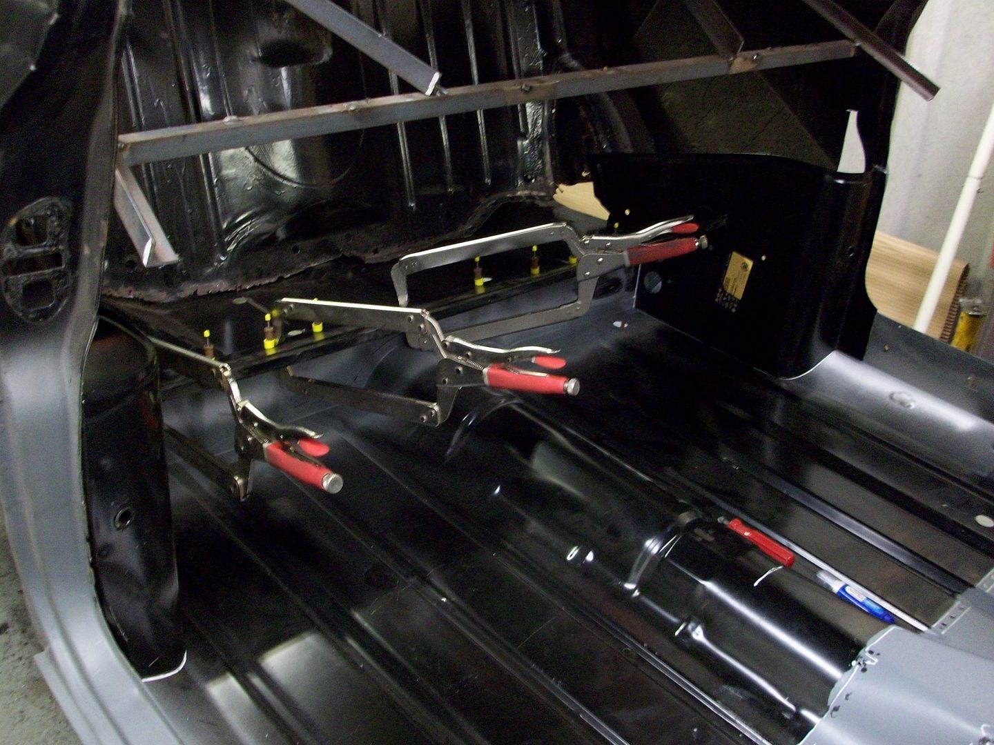

#130 ger
ger
  • Just Joined
  • 233 posts

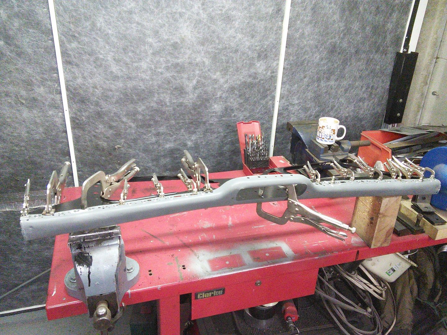

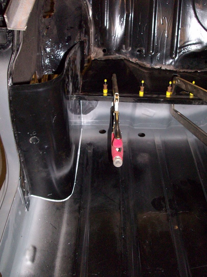

Posted 05 October 2015 - 07:06 AM

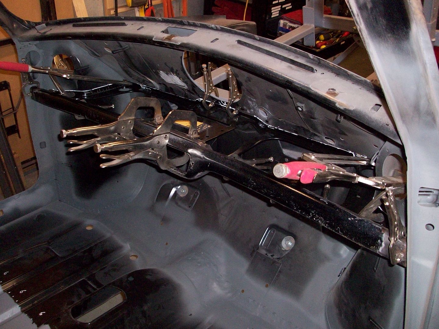

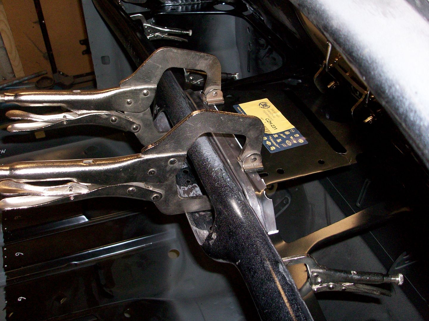

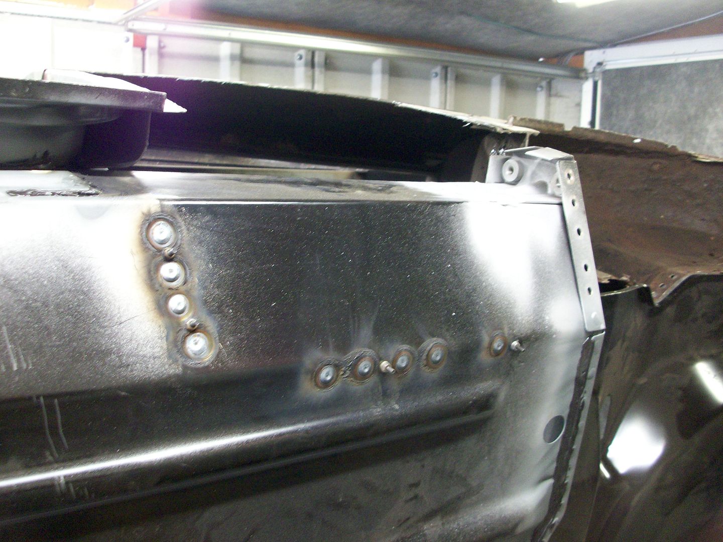

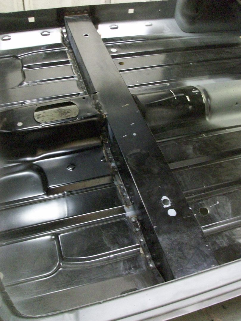

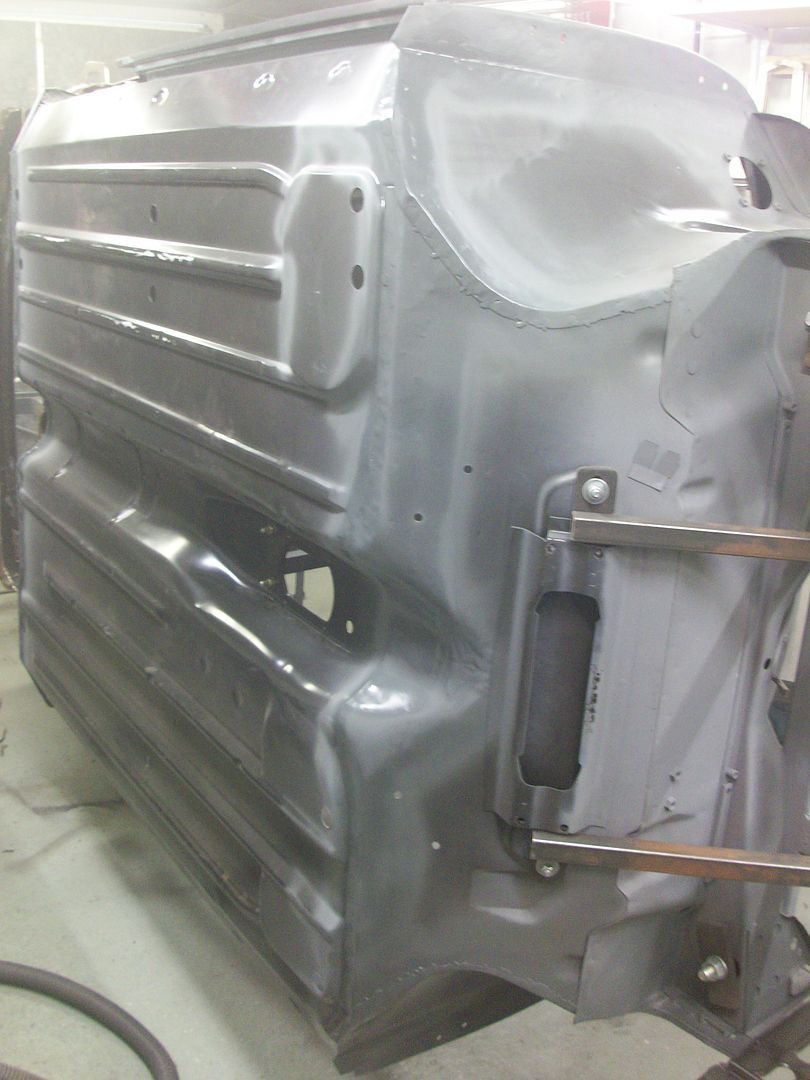

A very productive w/e. Passenger companion bin welded in.
Seat x-member also done.
Welds ground down and primered

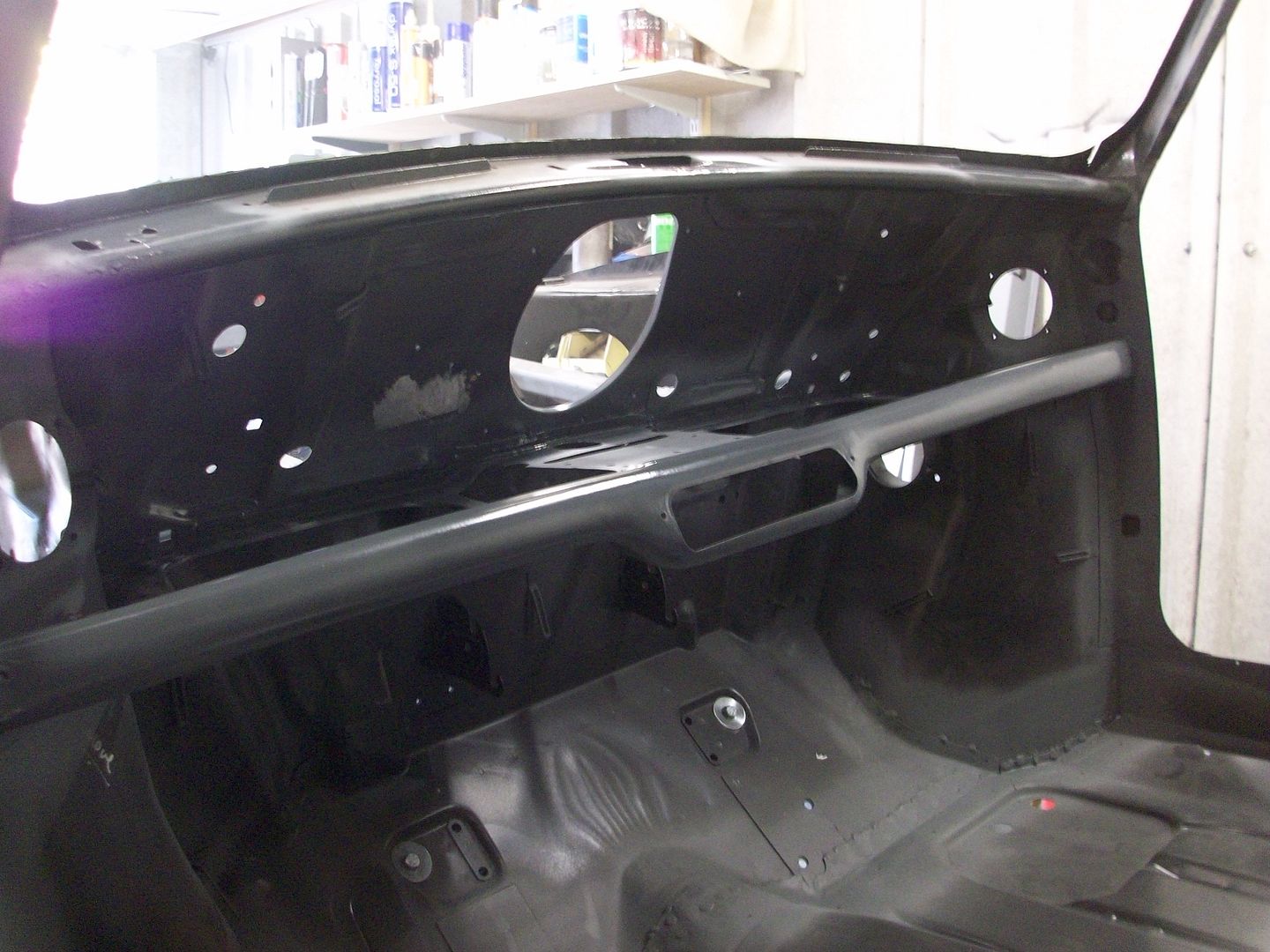

Lower dash parts now welded together and primed ready to be fitted.
 You can never have too many clamps.  :lol:
Ger

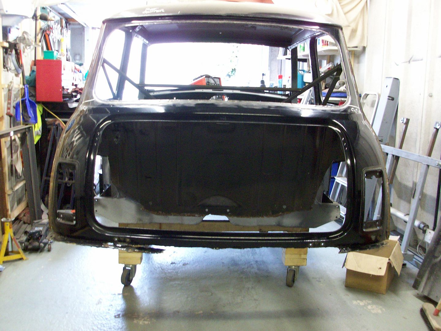

Posted 12 October 2015 - 11:56 AM

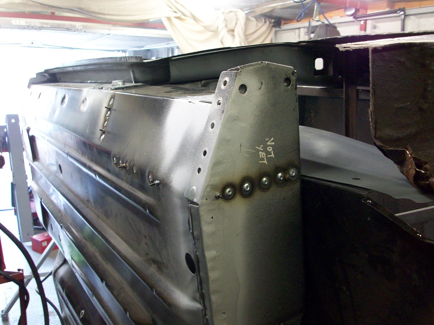

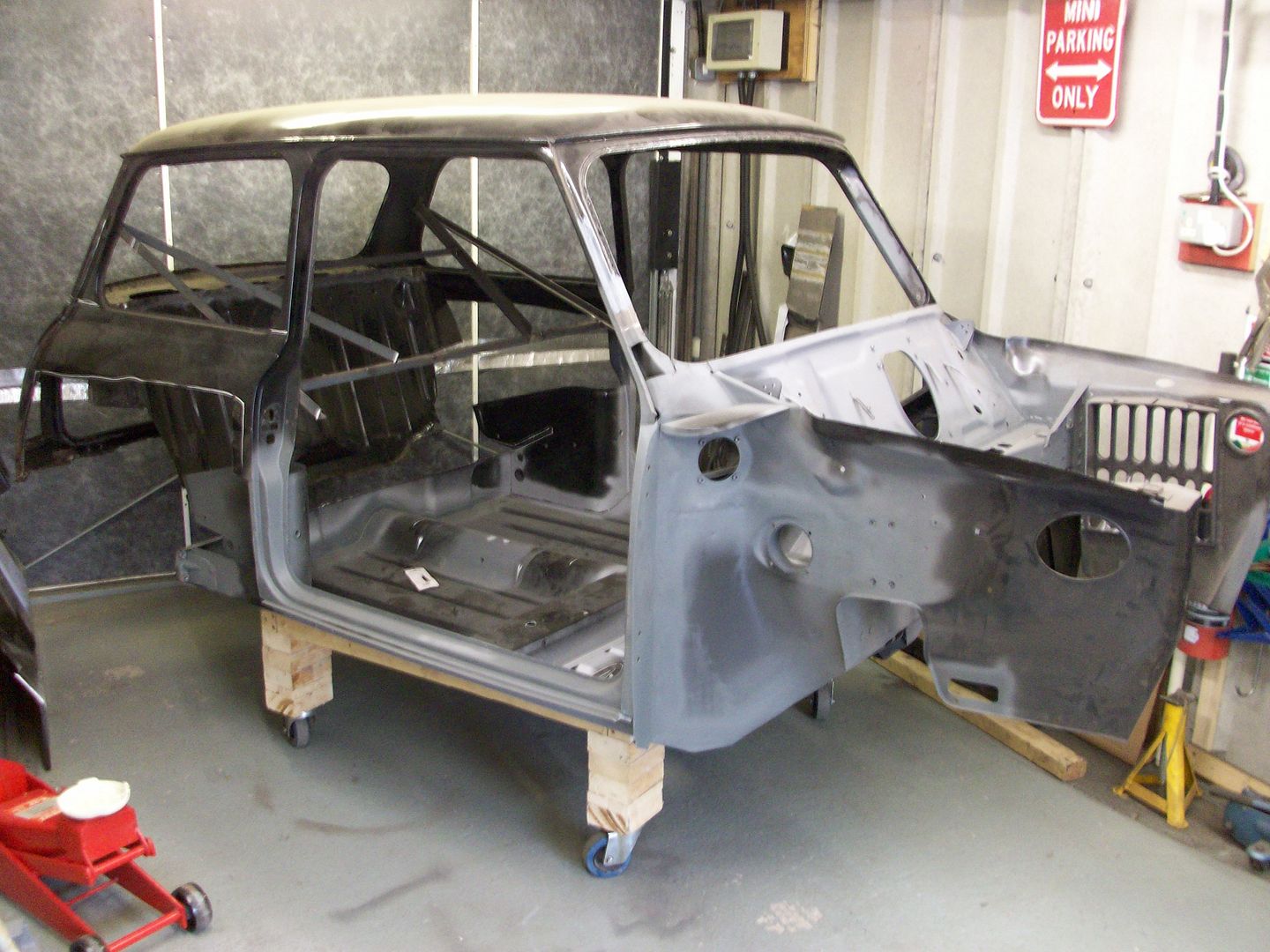

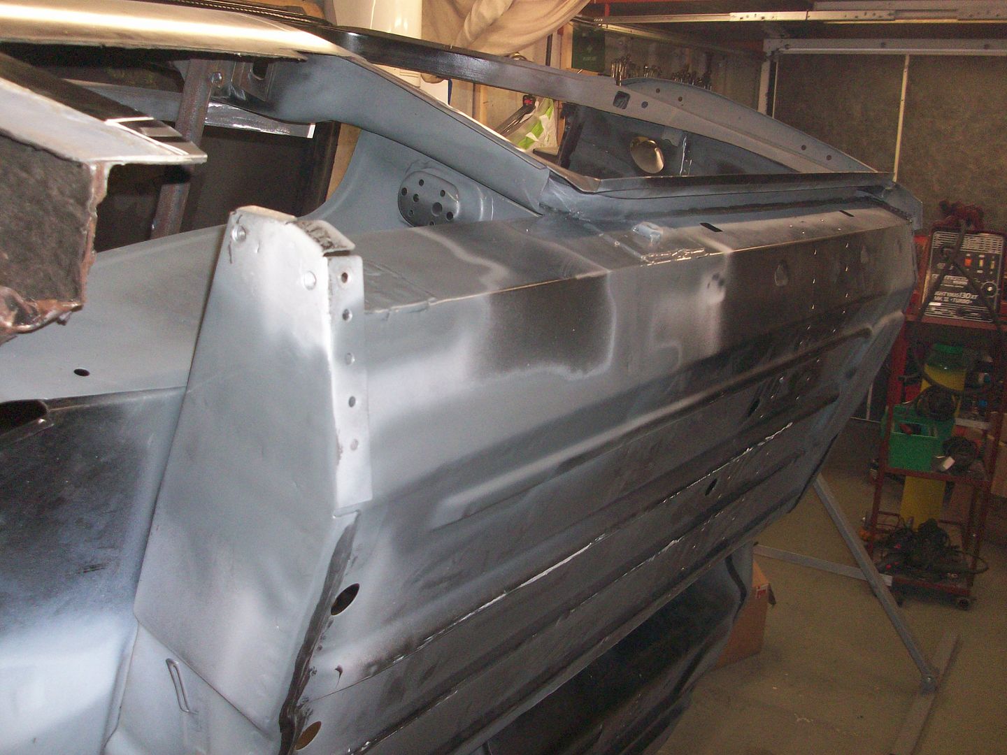

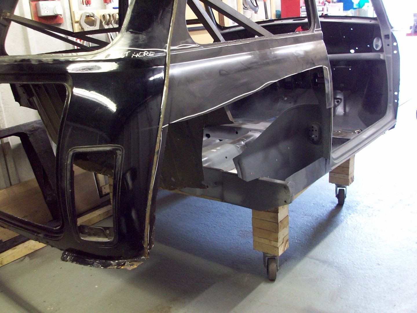

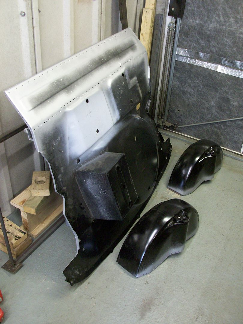

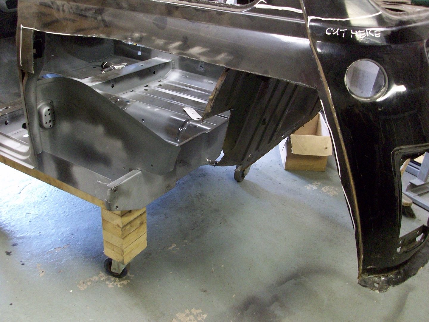

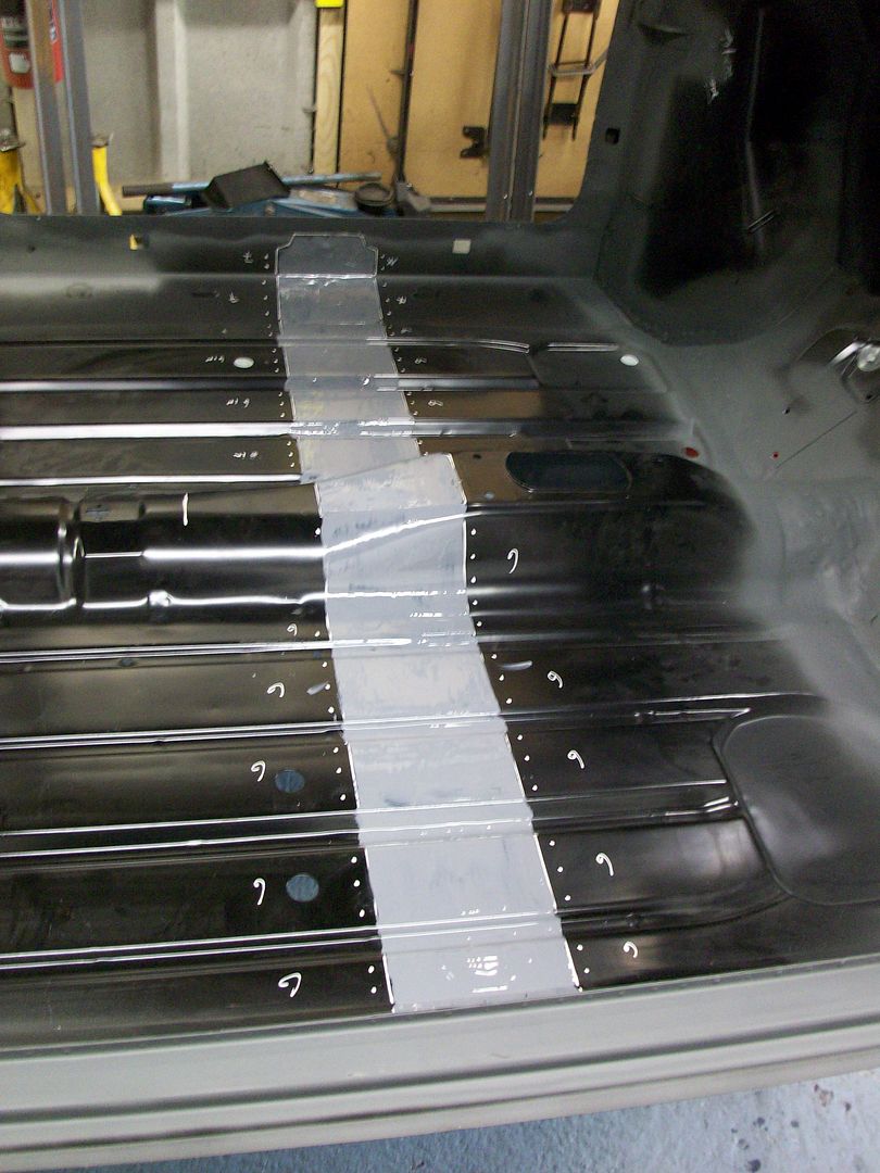

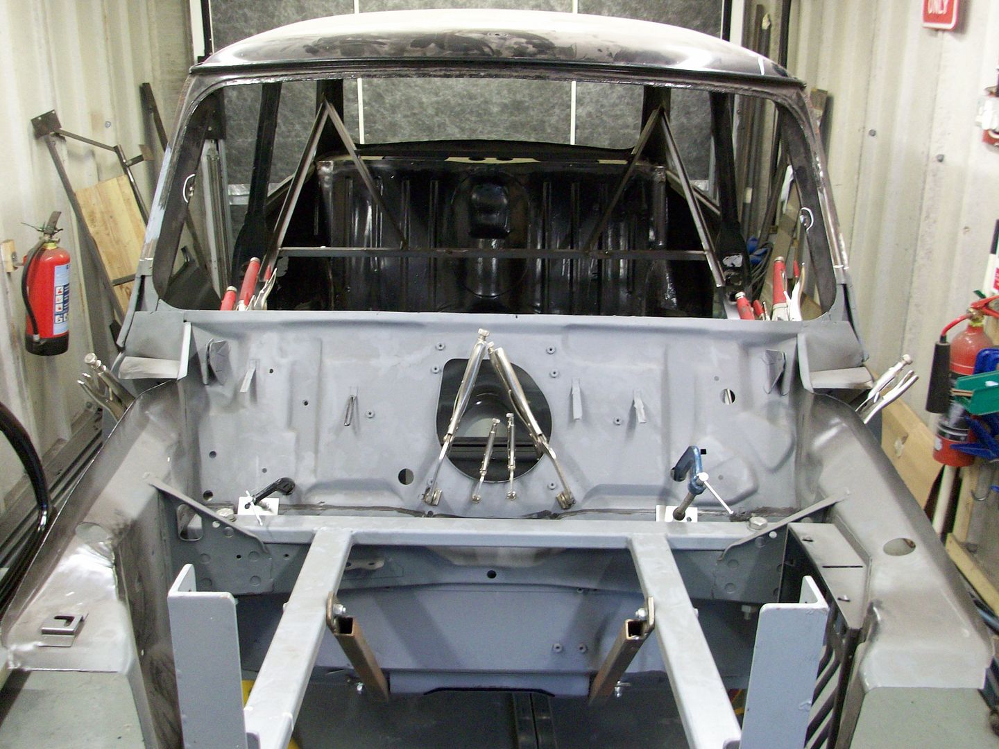

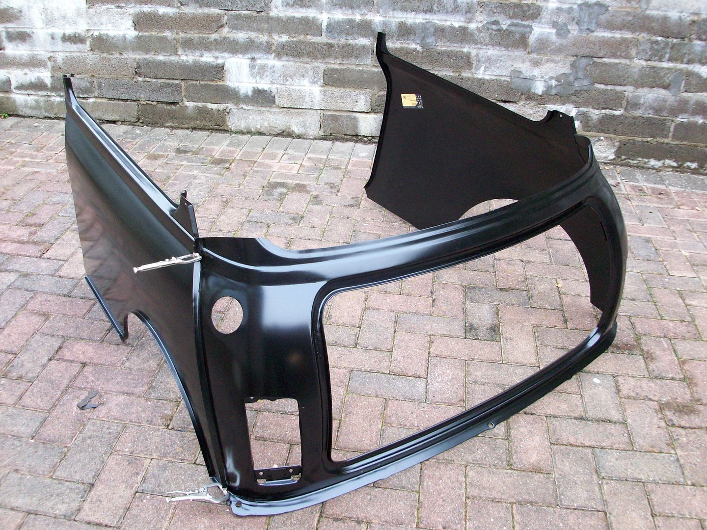

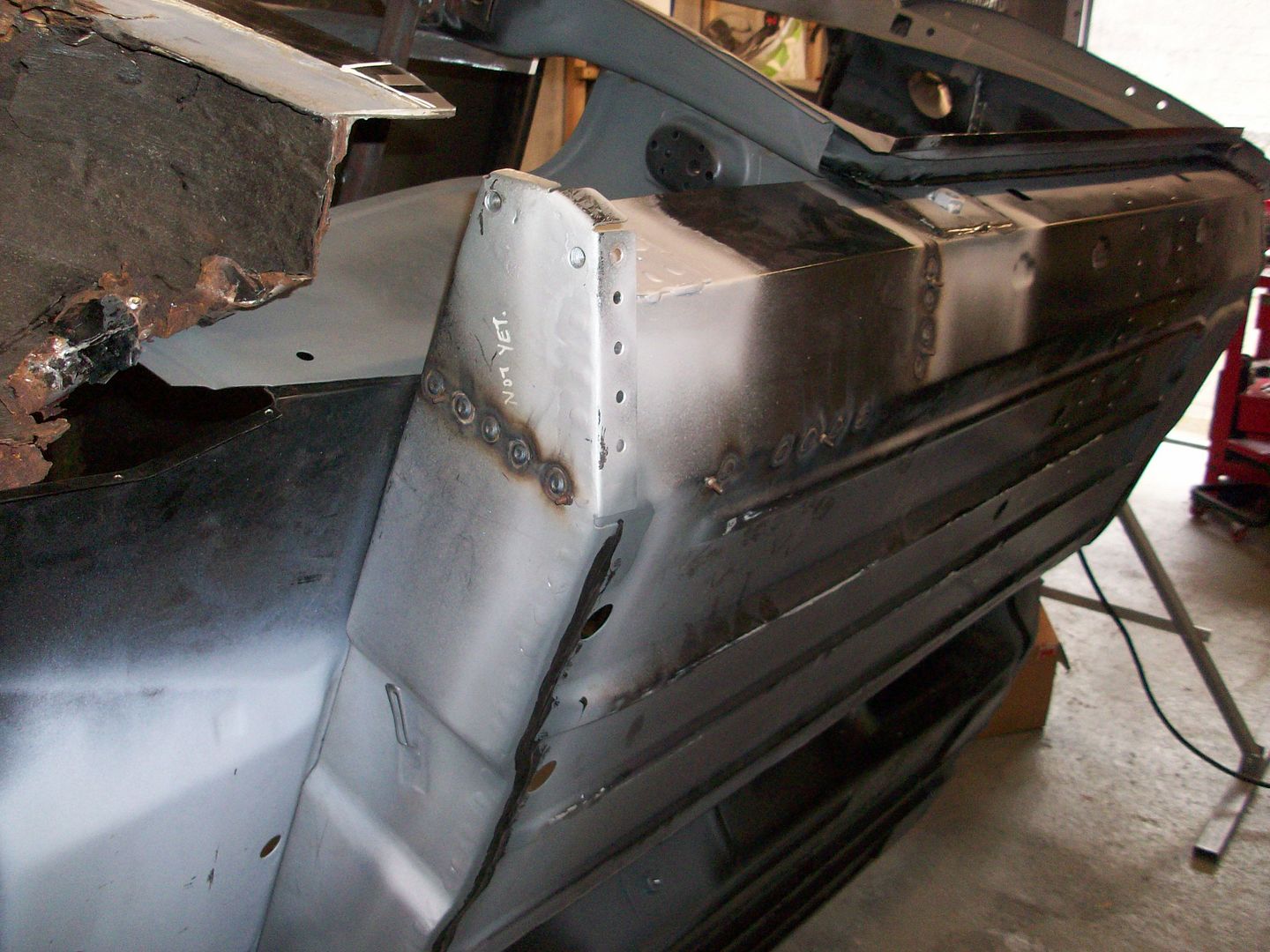

I booked last Friday off to have a long w/e working on The Tart and look what turned up.... Oooooh.... The Tarts new arse.
Welded in the lower dash and finished off with a coat of primer.
On Saturday took her off the spit and put back on the trolley to cut out the rear ready for the boot floor.
And a bit of prep to the boot floor and rear arches ready to be fitted.
Ger
