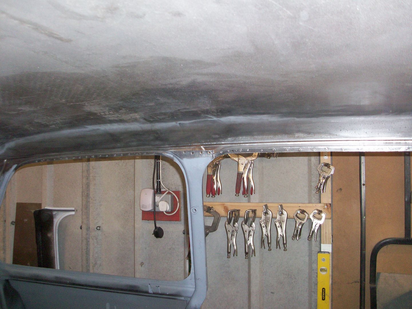

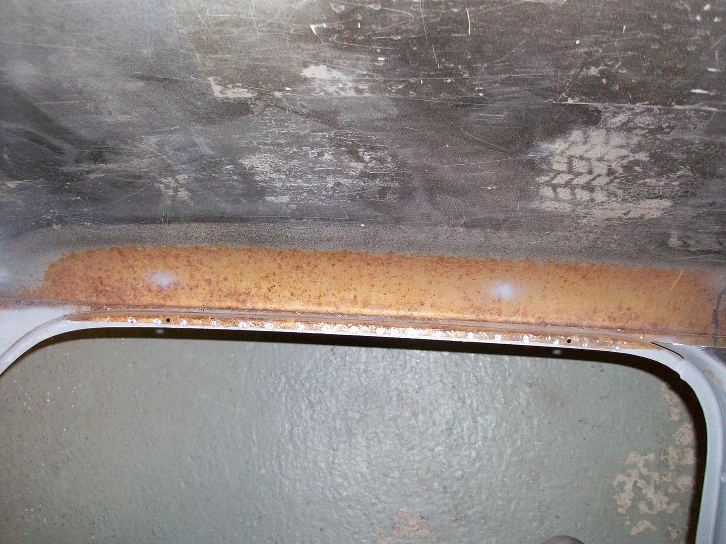

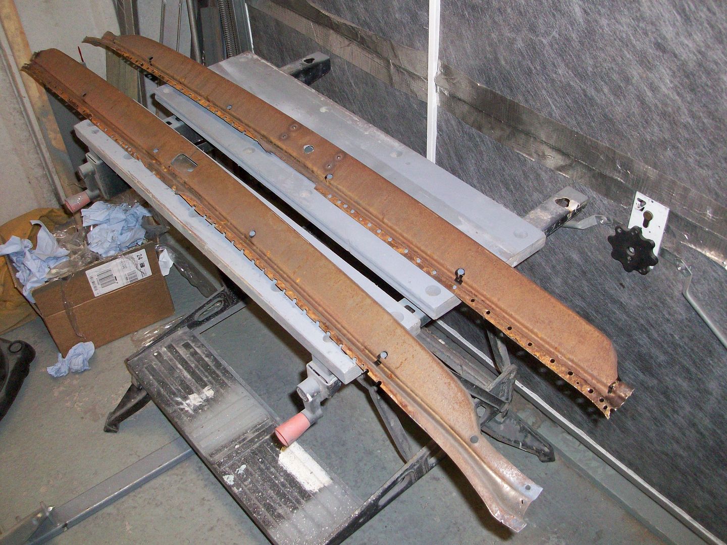

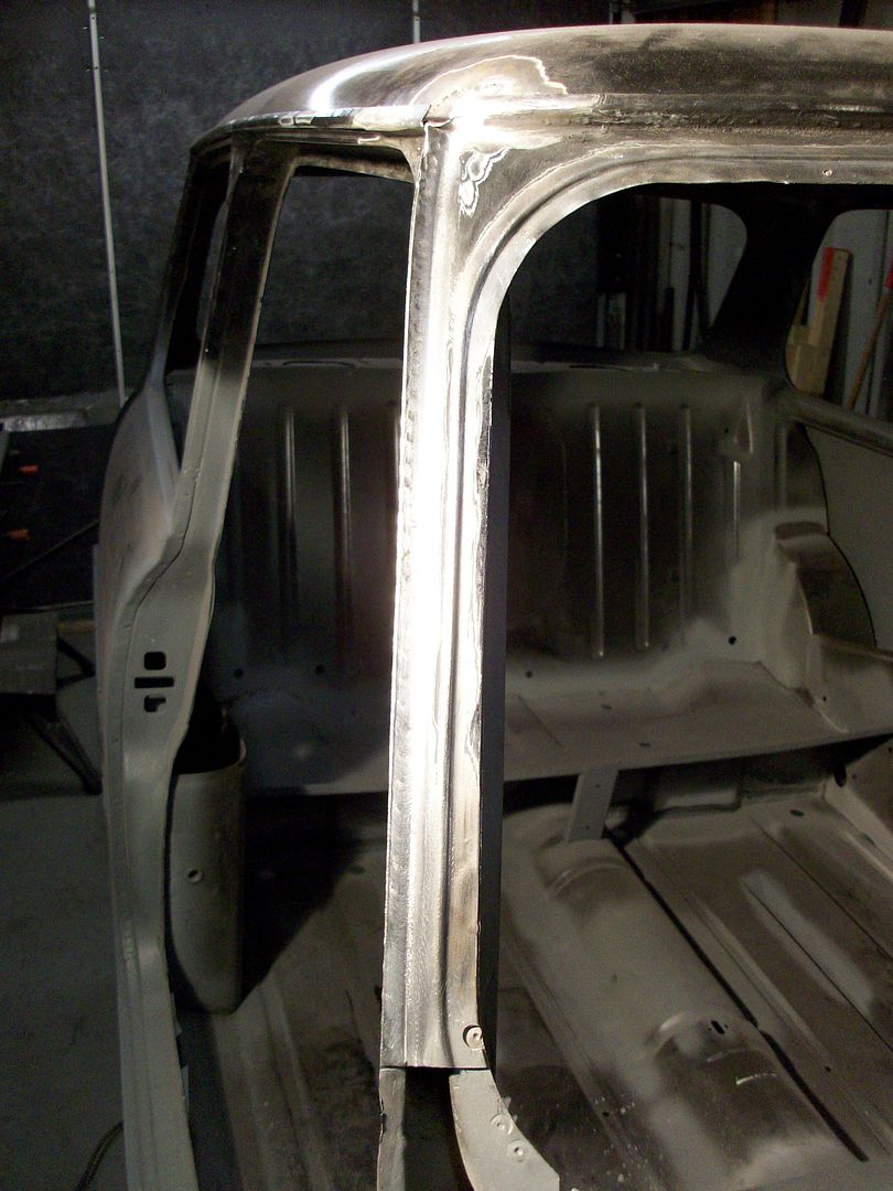

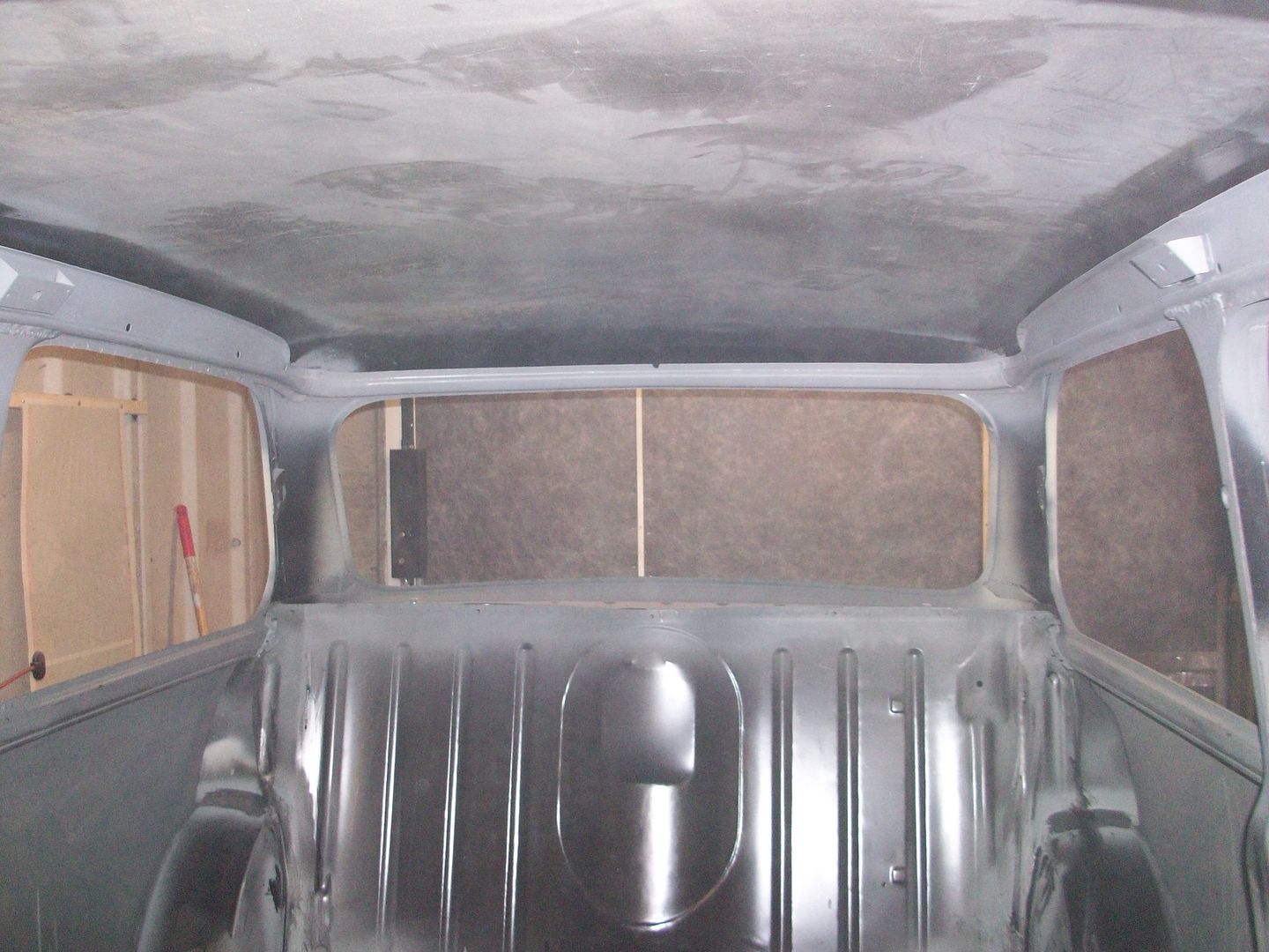

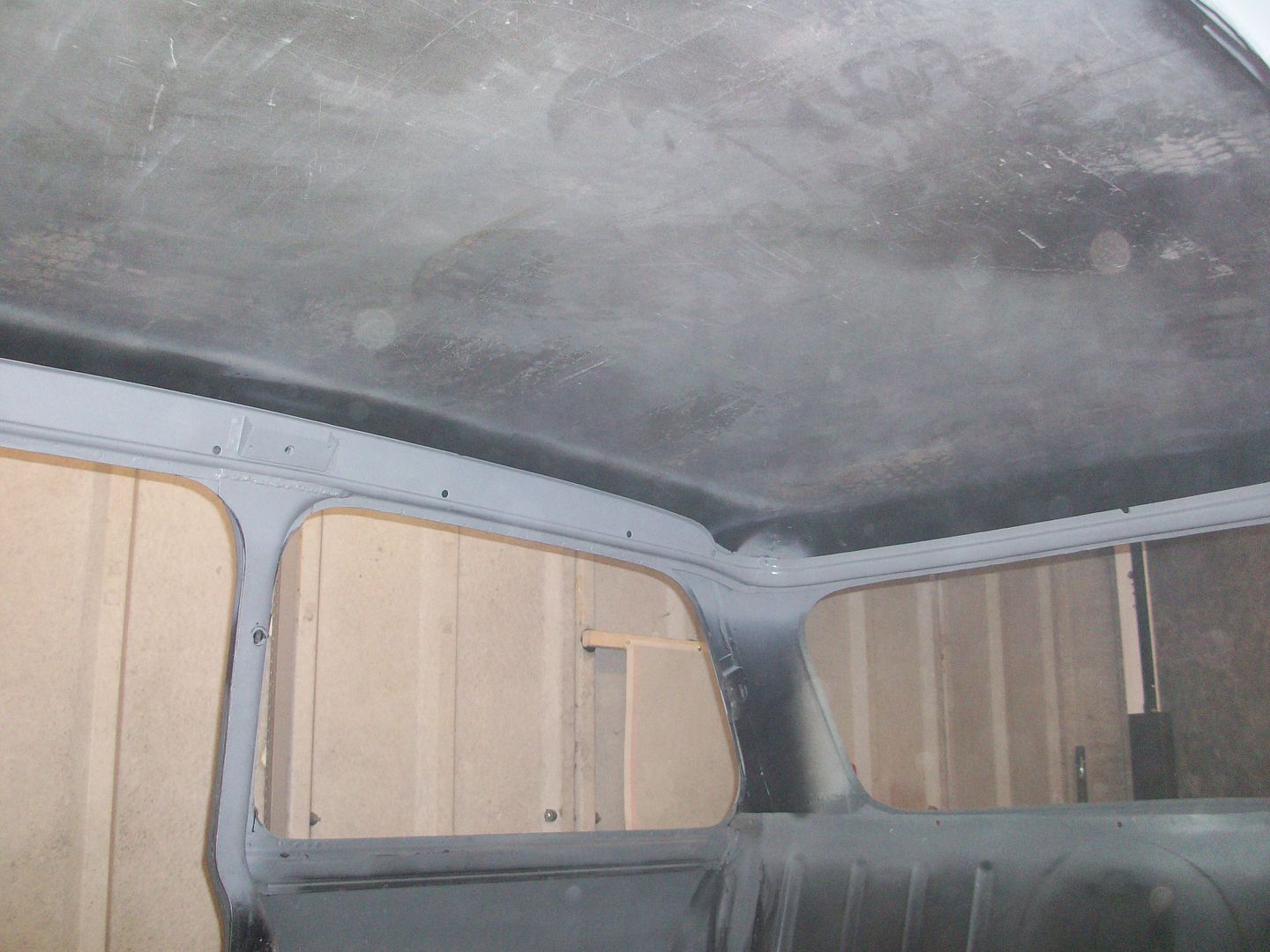

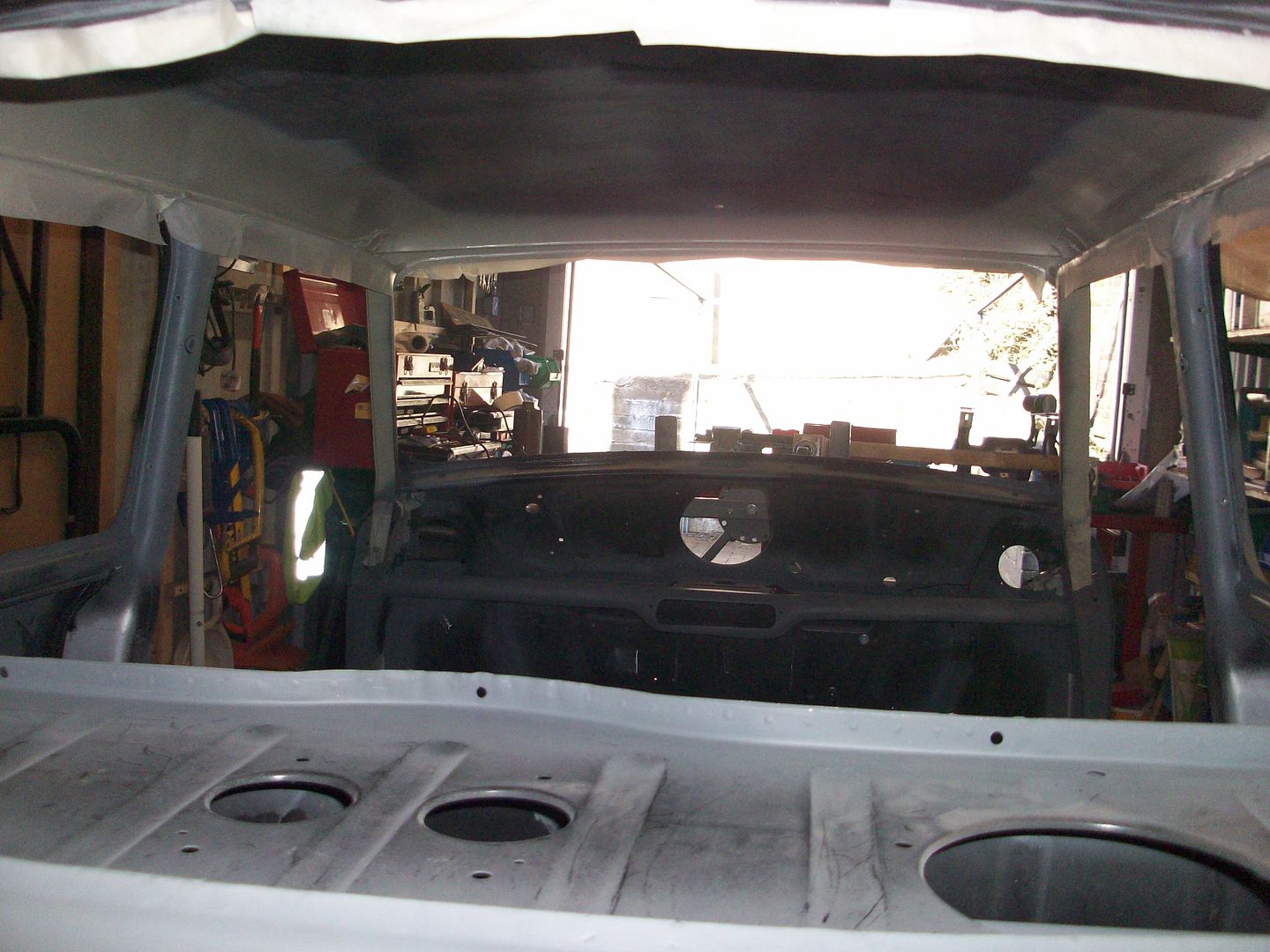

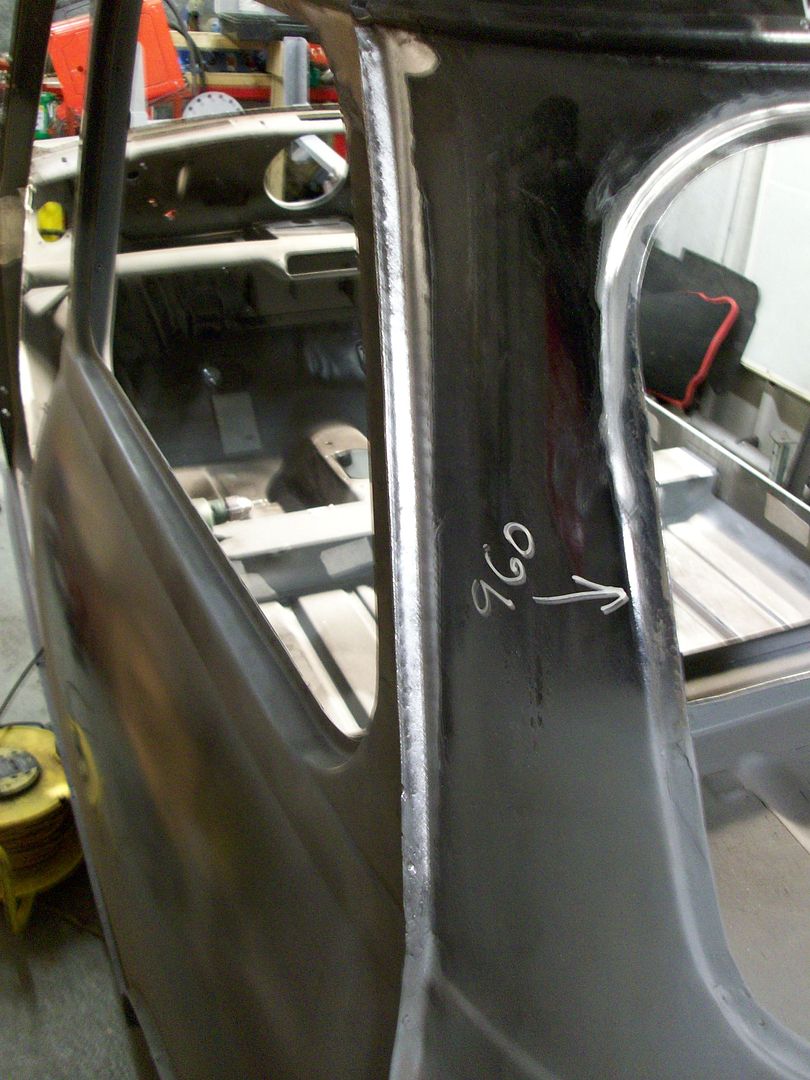

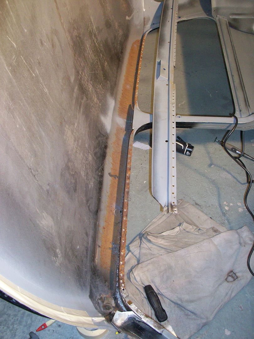

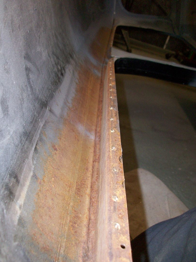

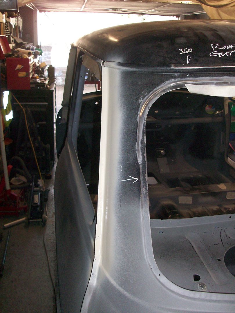

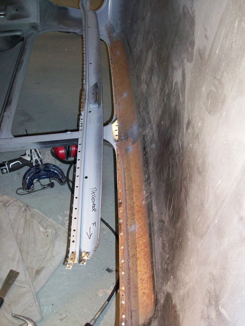

As I had already taken off the front and rear cant rails and found rust, the side ones had to come off as well.
Sure enough there was rust behind them - not suprisingly as there was no paint.
After a quick tickle with a wire brush - much better. By no means finished but i've got the most off.
Insides of the rails de-rusted and etch primed.

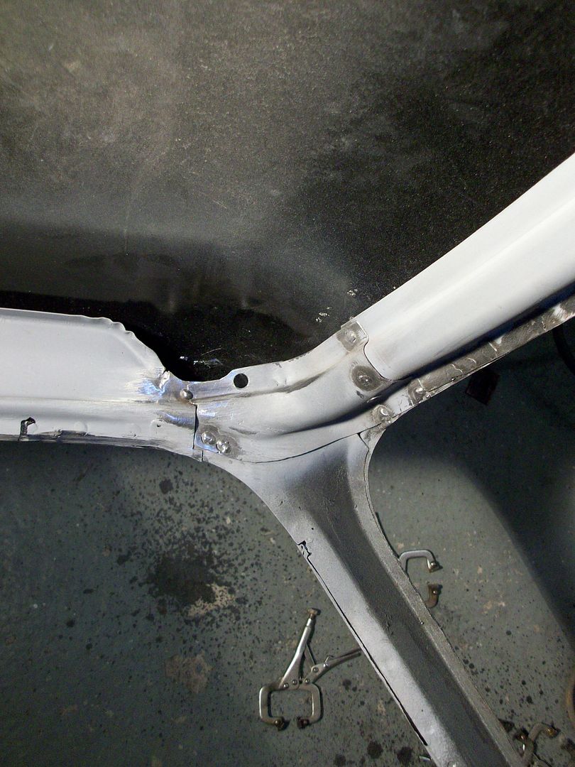

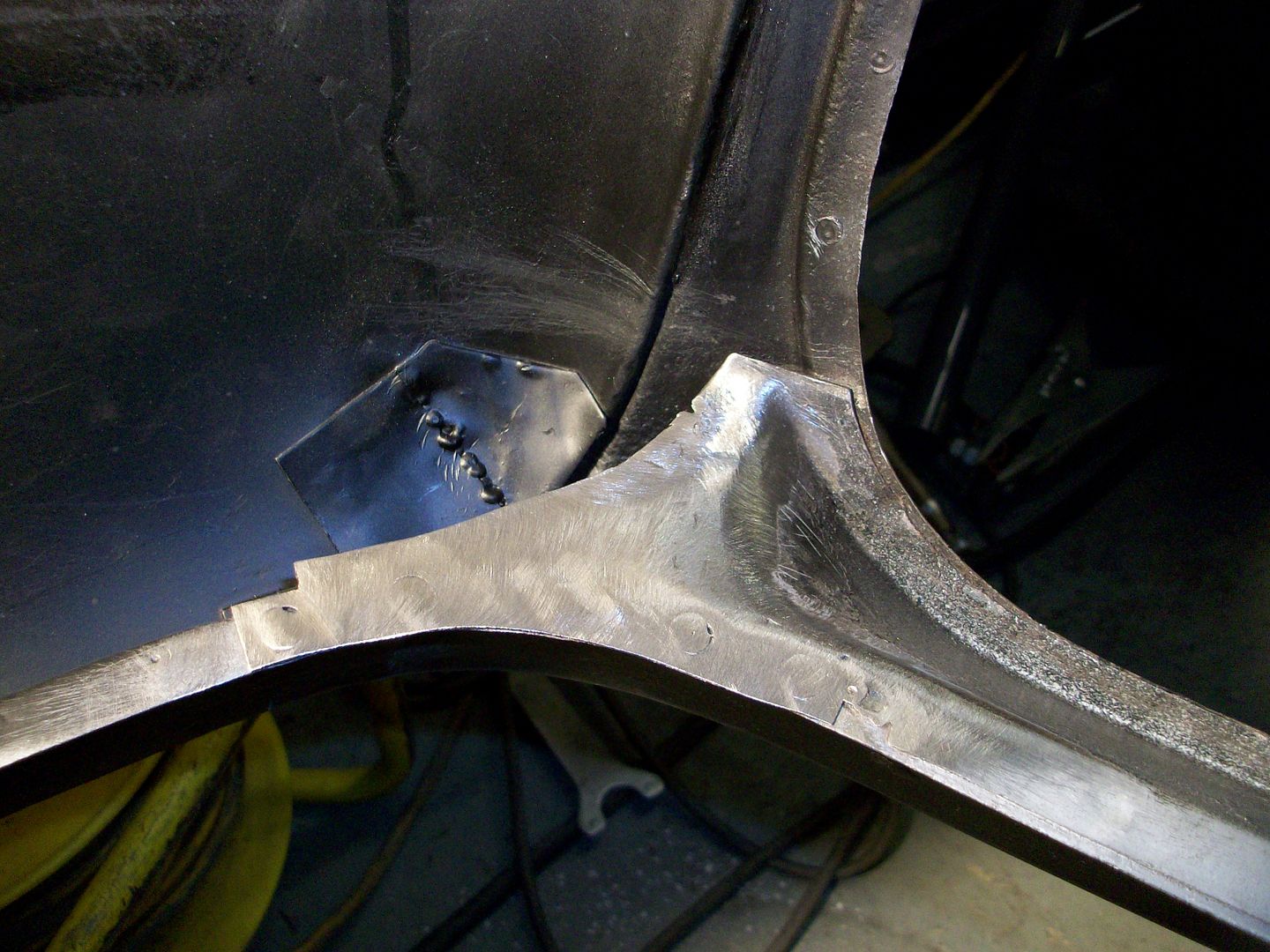

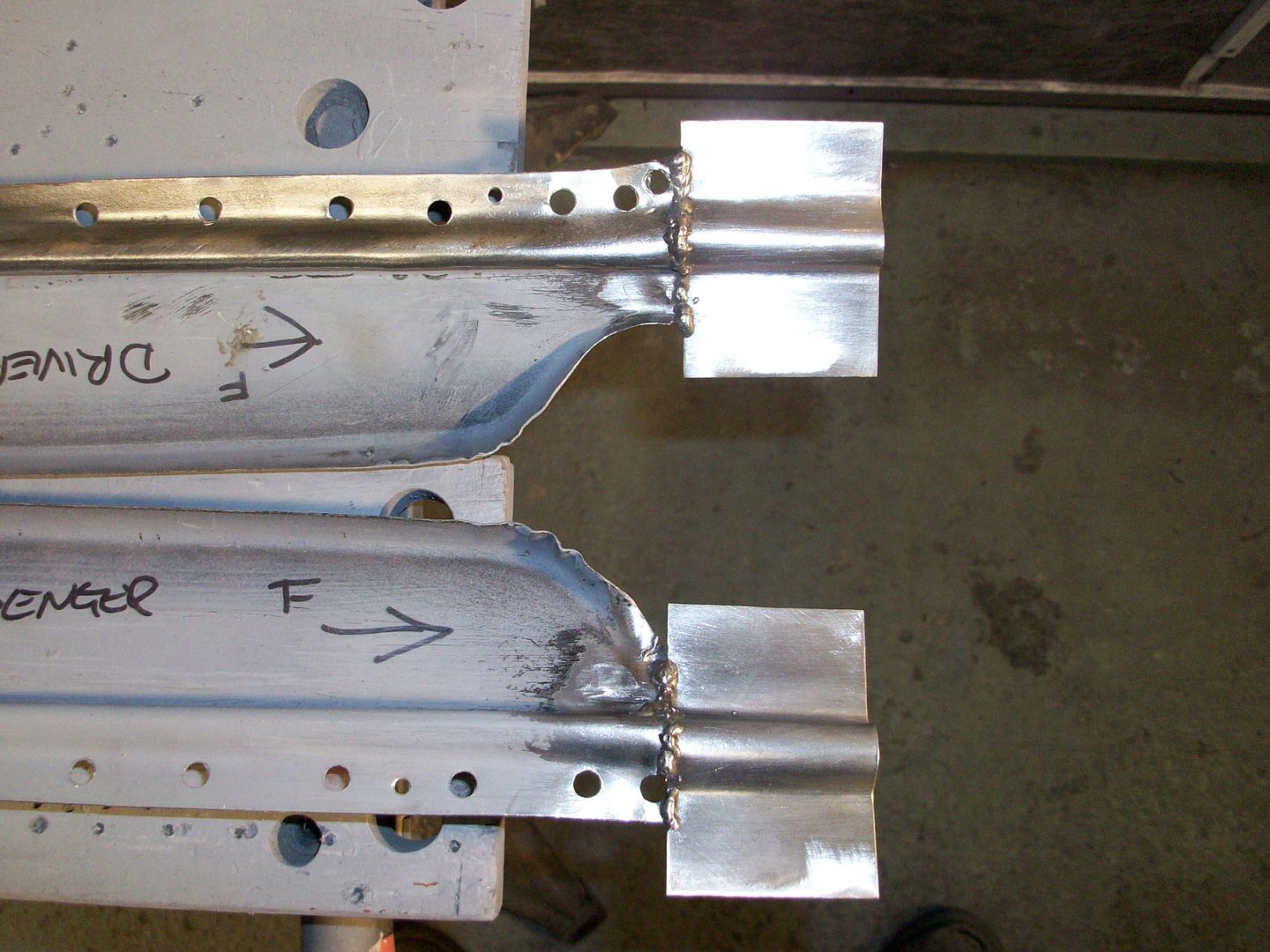

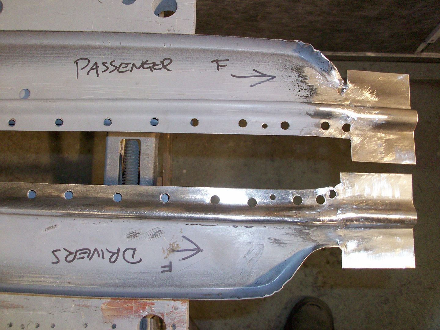

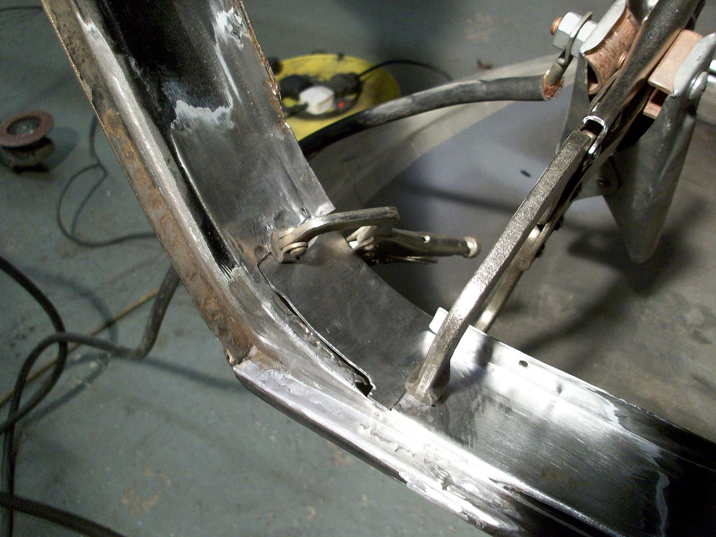

There was a bit of damage to the ends that go on the A-pillars so I made a couple of bits with the same profile to repair them. Not bad made by hand.

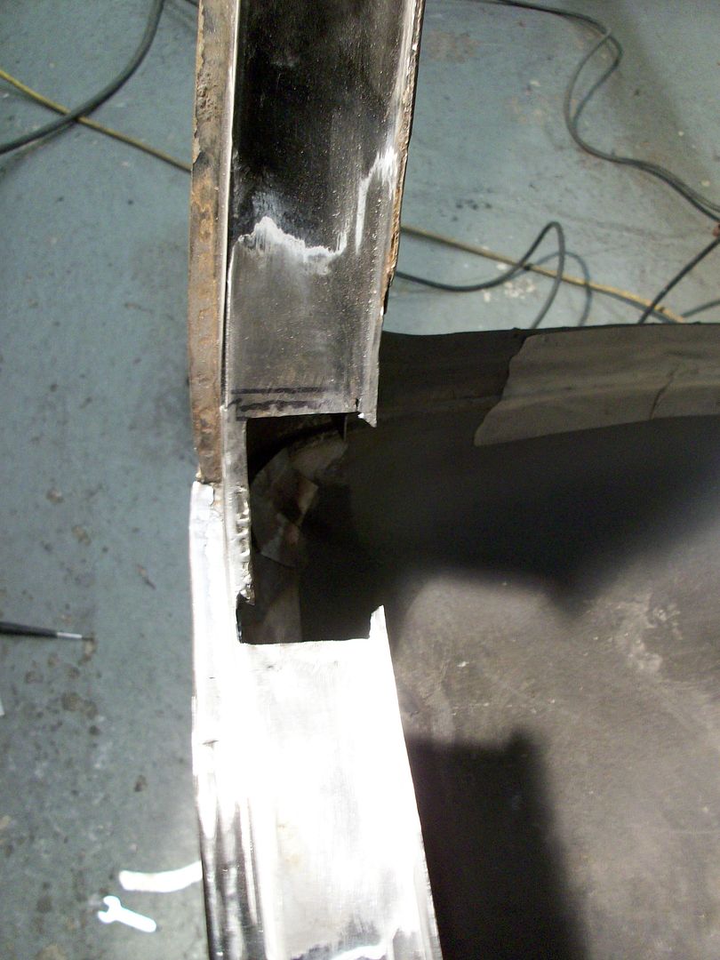

And found yet another hole in the drivers door frame so cut that out as well.
Plodding along slowly.
Ger

#218 alchall
alchall
  • Just Joined
  • 604 posts
  • Location: Chorley
Posted 14 March 2016 - 11:00 AM
Blimey that's more rust than I expected you to uncover, especially up the inside of the roof!

Hi Psycho-biker.
I think you'll find rust there on most unrestored ones as there is no paint behind there. But mine wasn't bad for a 36 year old one.

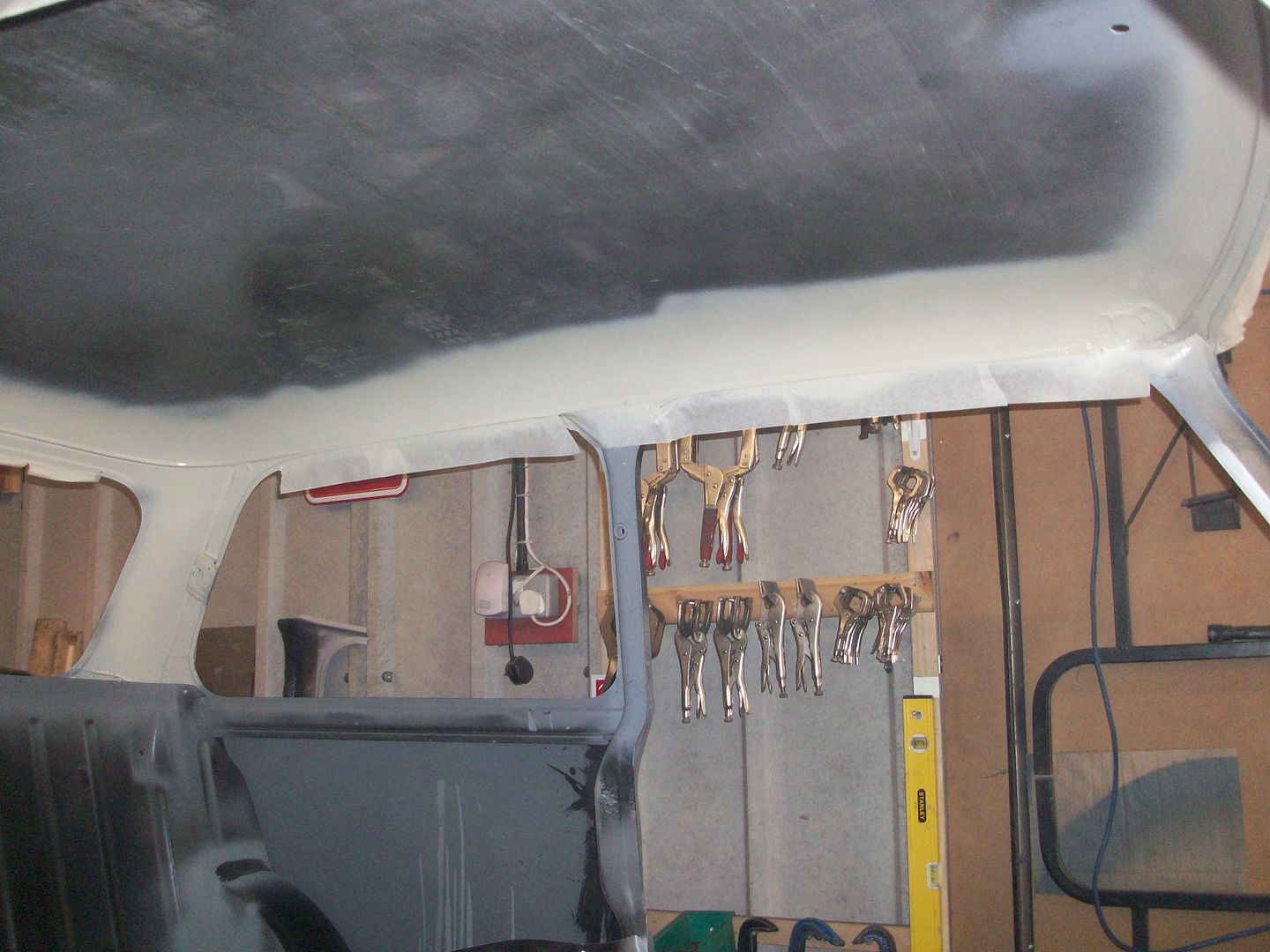

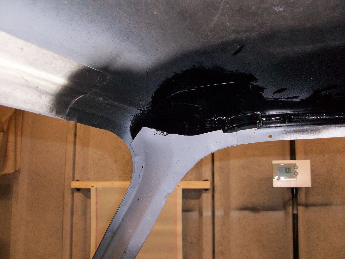

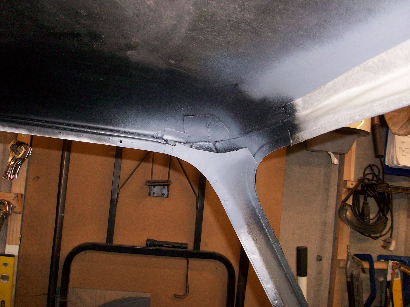

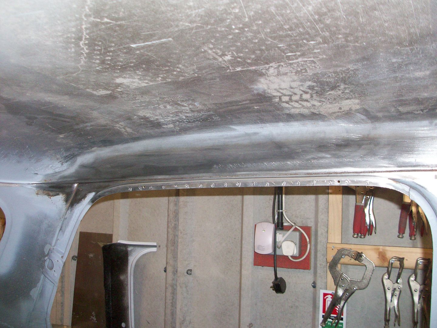

Posted 04 April 2016 - 11:09 AM

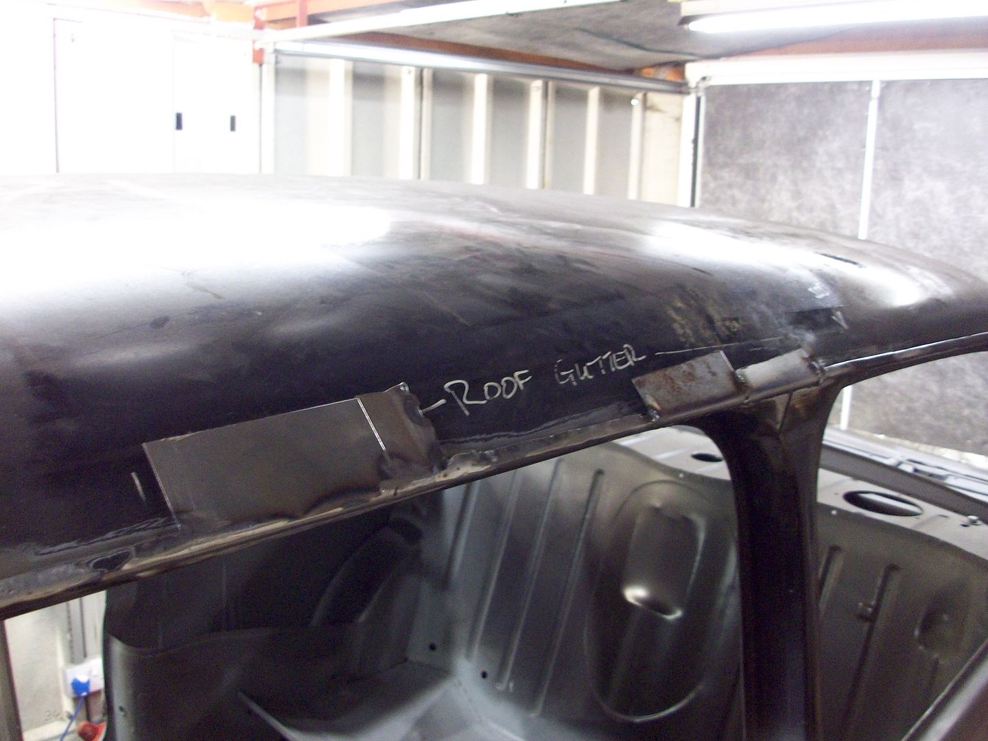

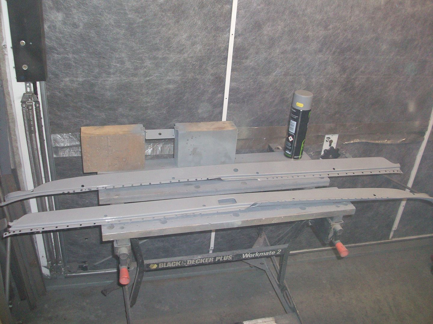

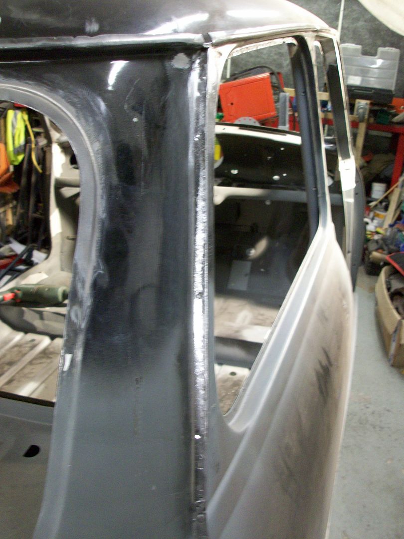

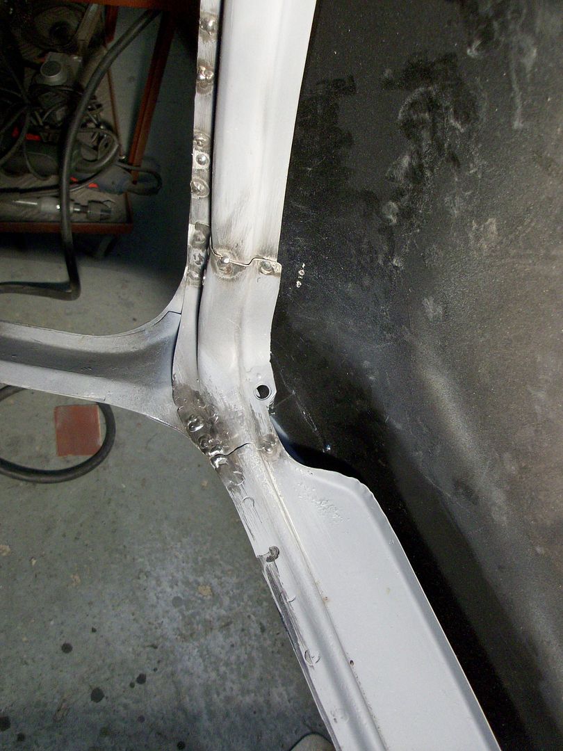

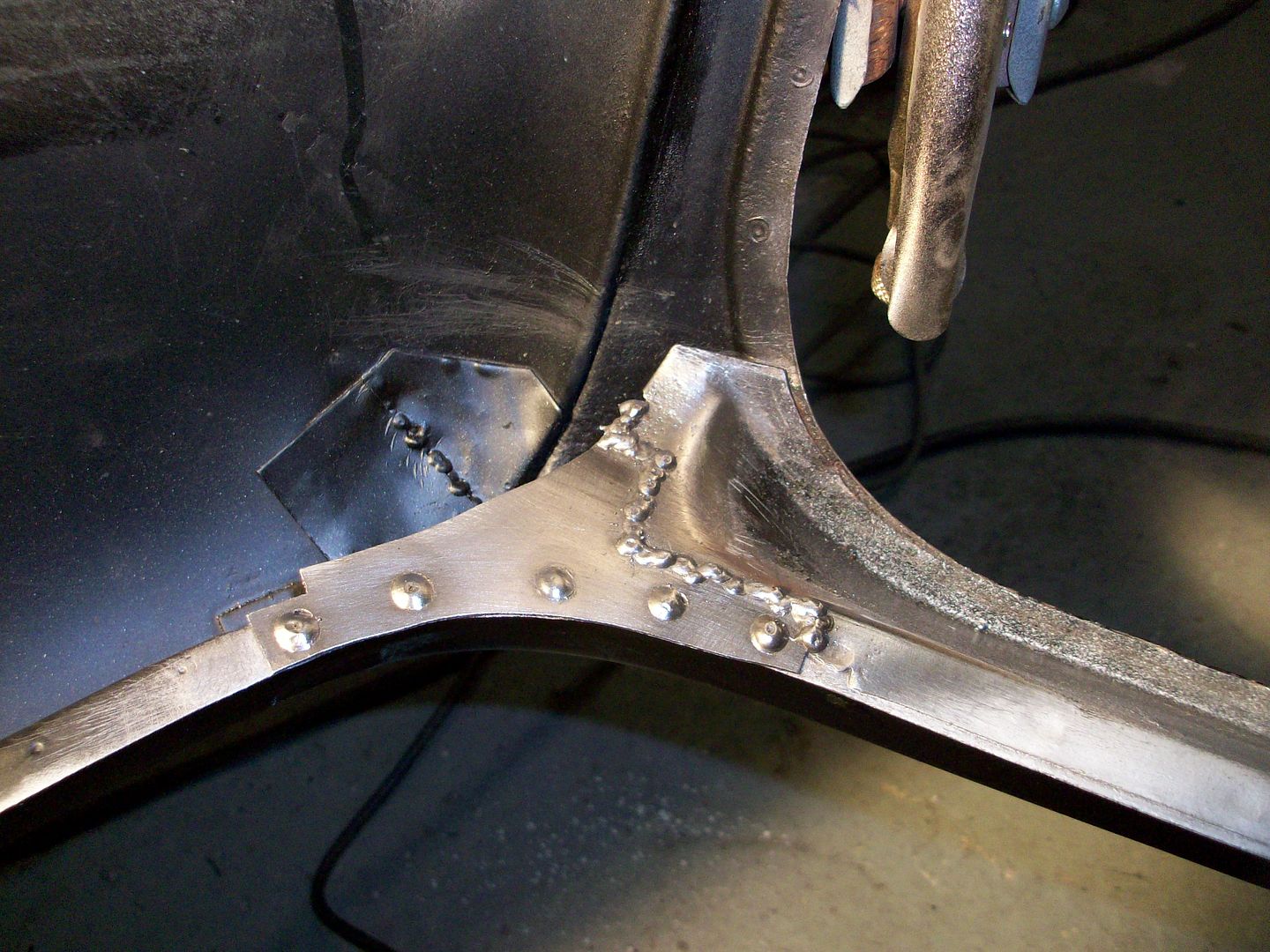

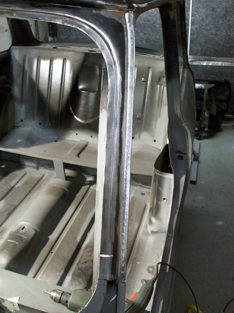

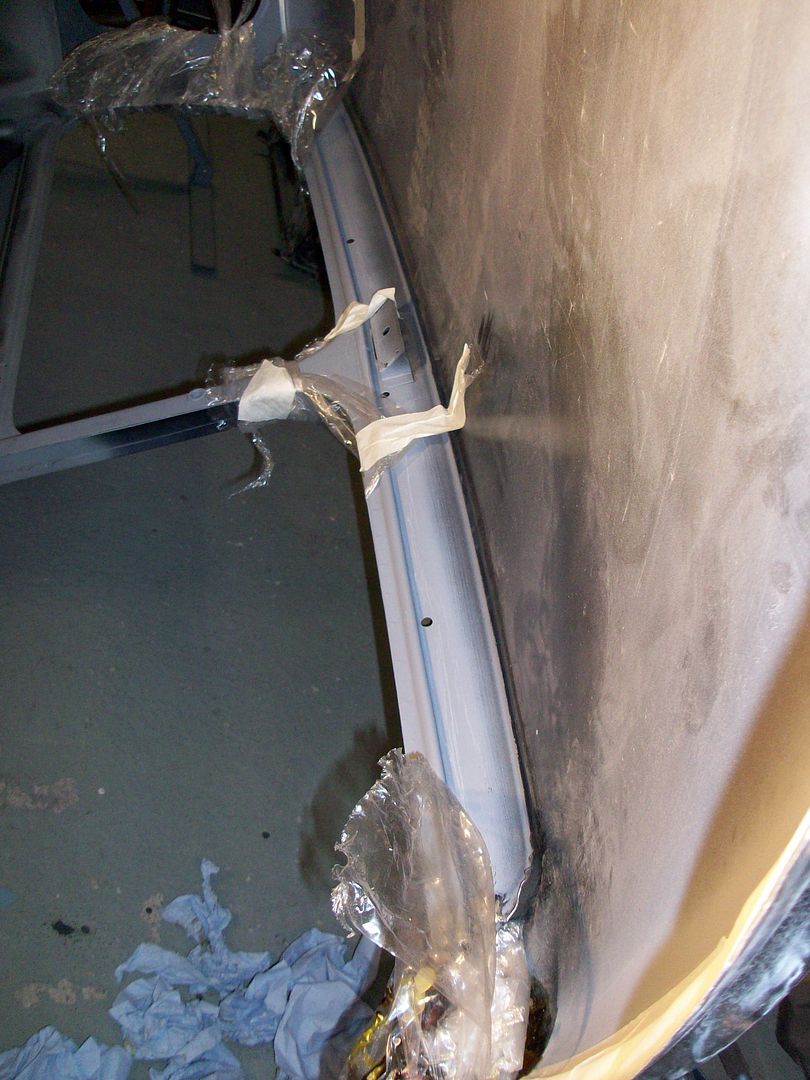

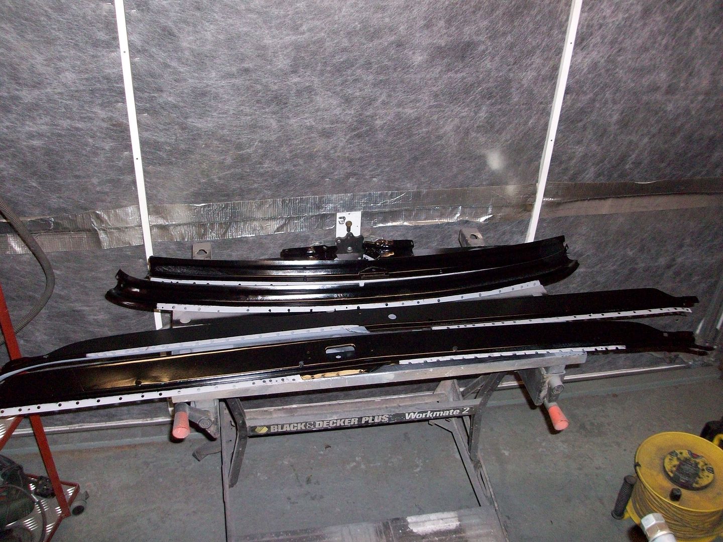

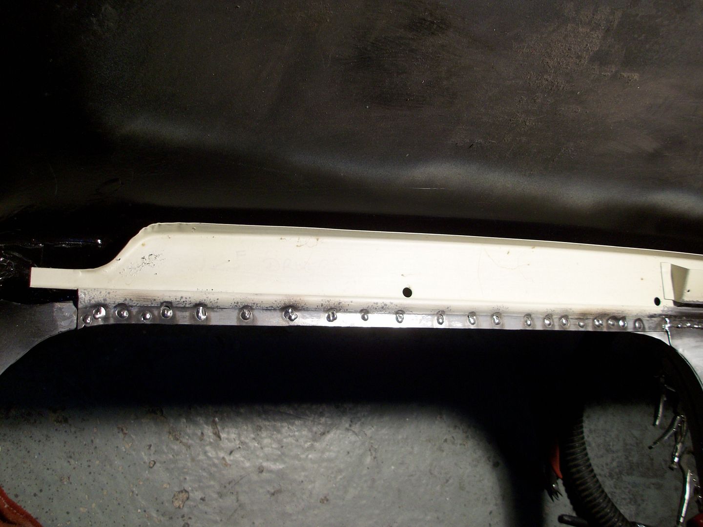

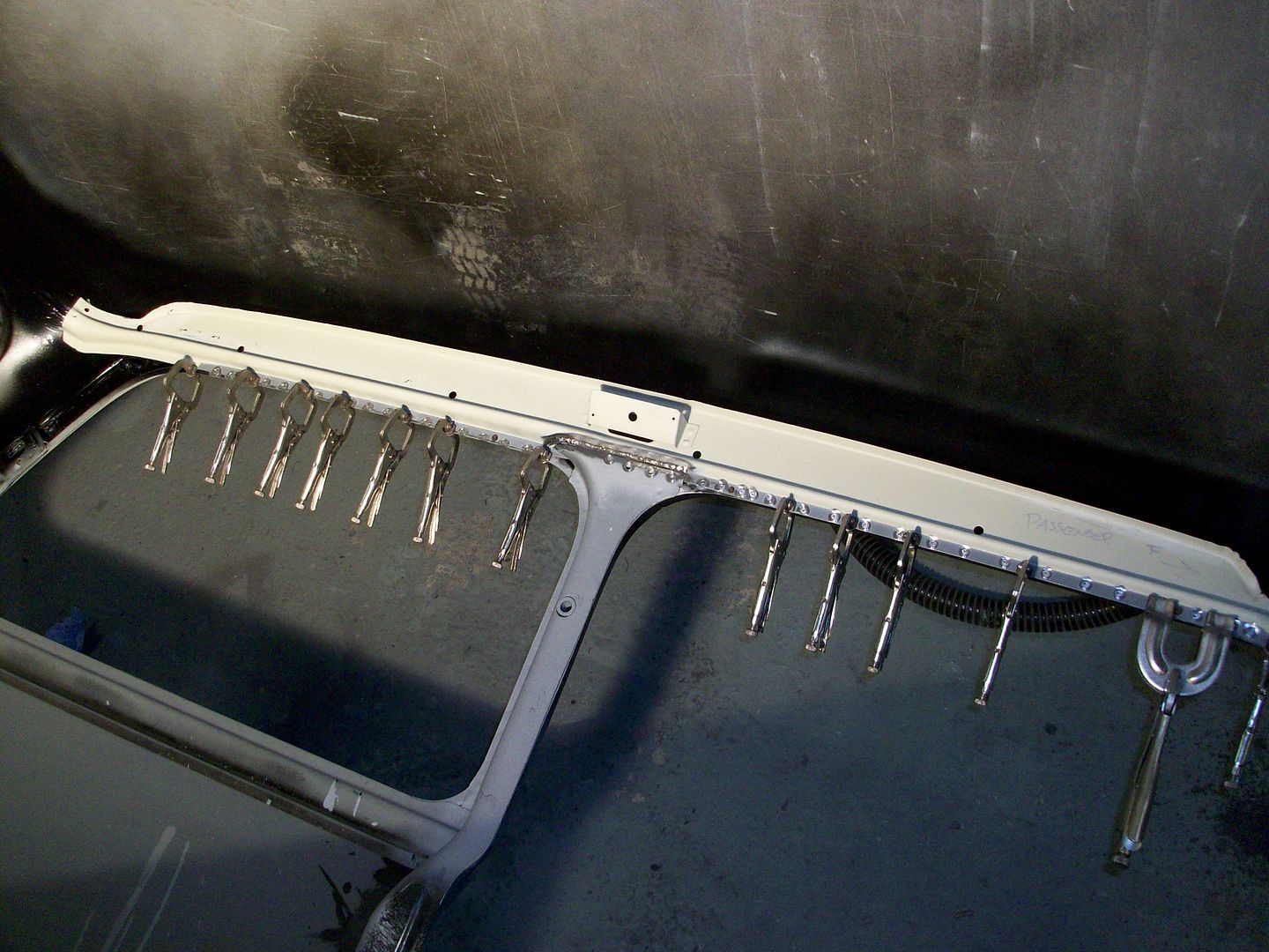

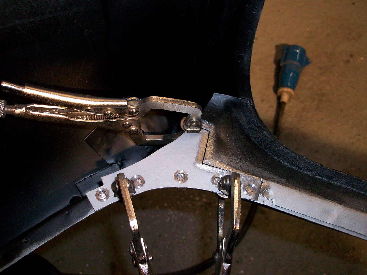

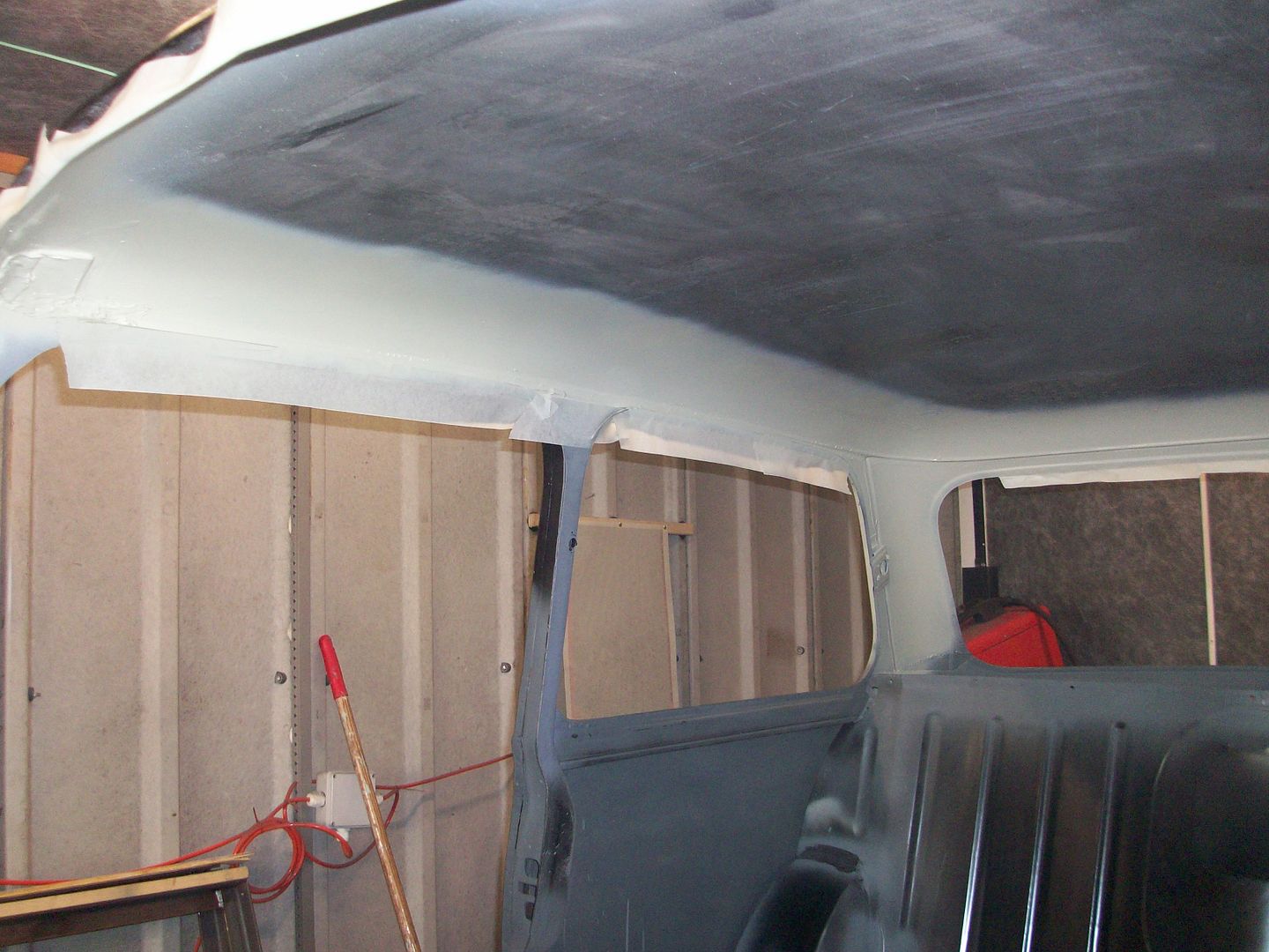

Bit of a long update over the Easter holidays but bare with me.

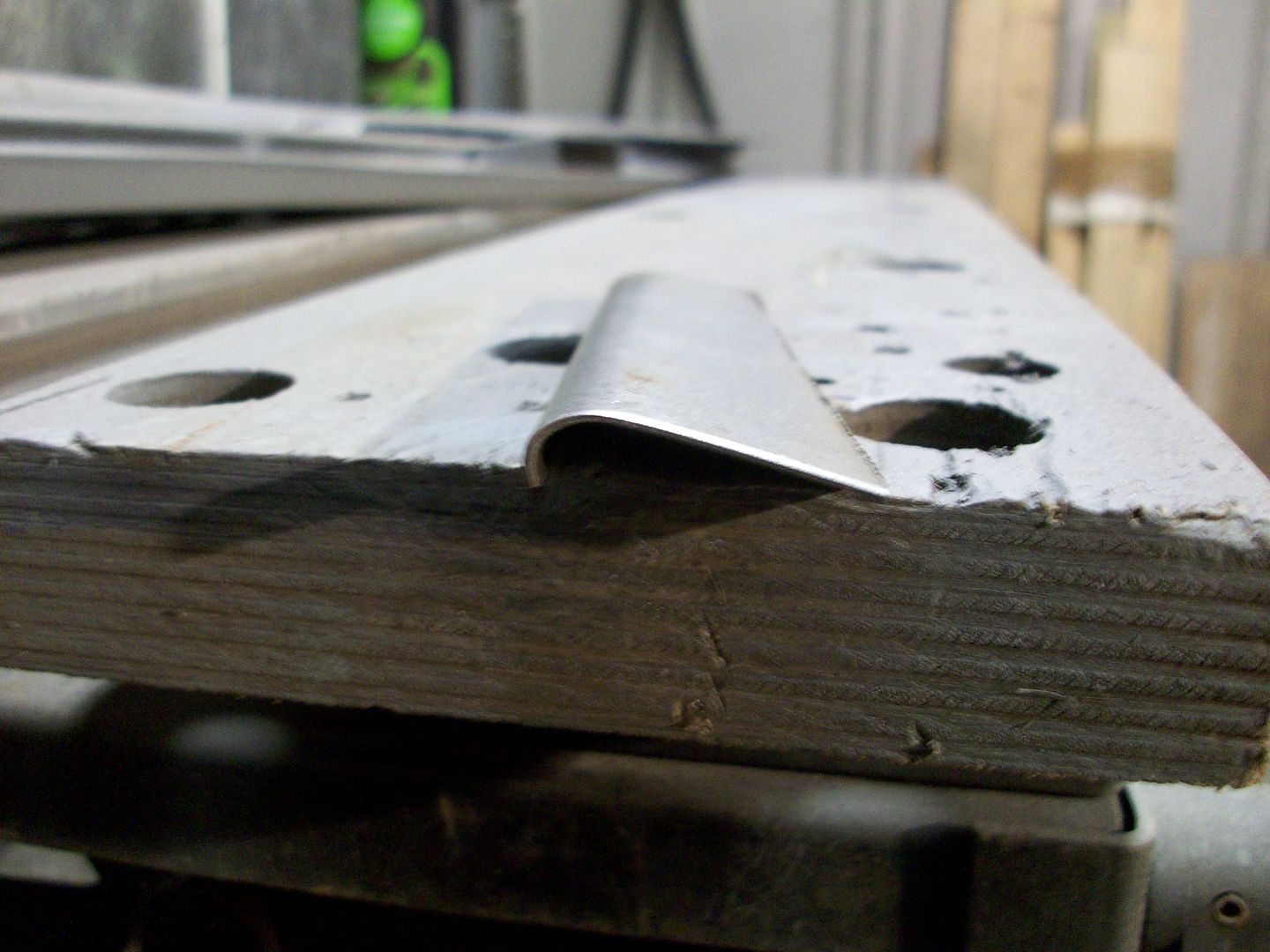

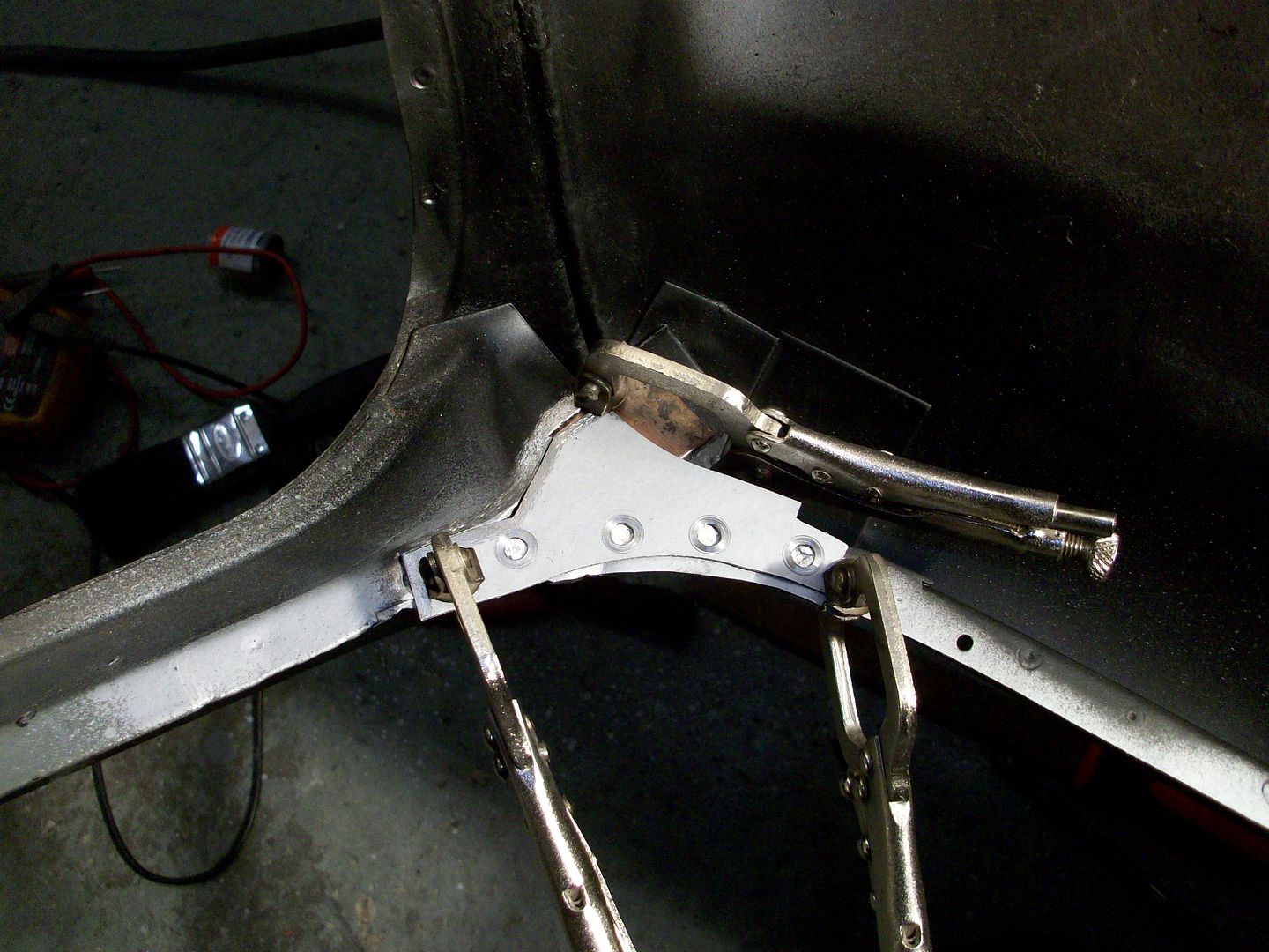

Repaired some some of the rusty gutter rail, cutting out the crap, bending metal to the profile then welding back in.
Replaced the rust I previously cut out from the opening of the drivers door.
De-rusted the original front an rear body seams and coated them with epoxy primer.

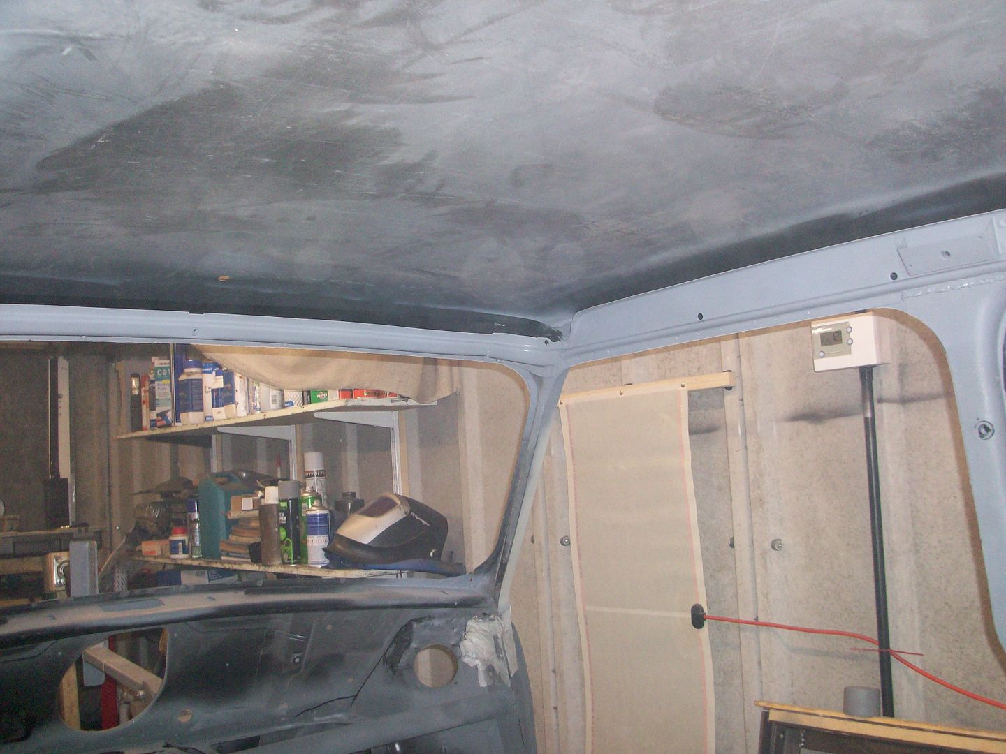

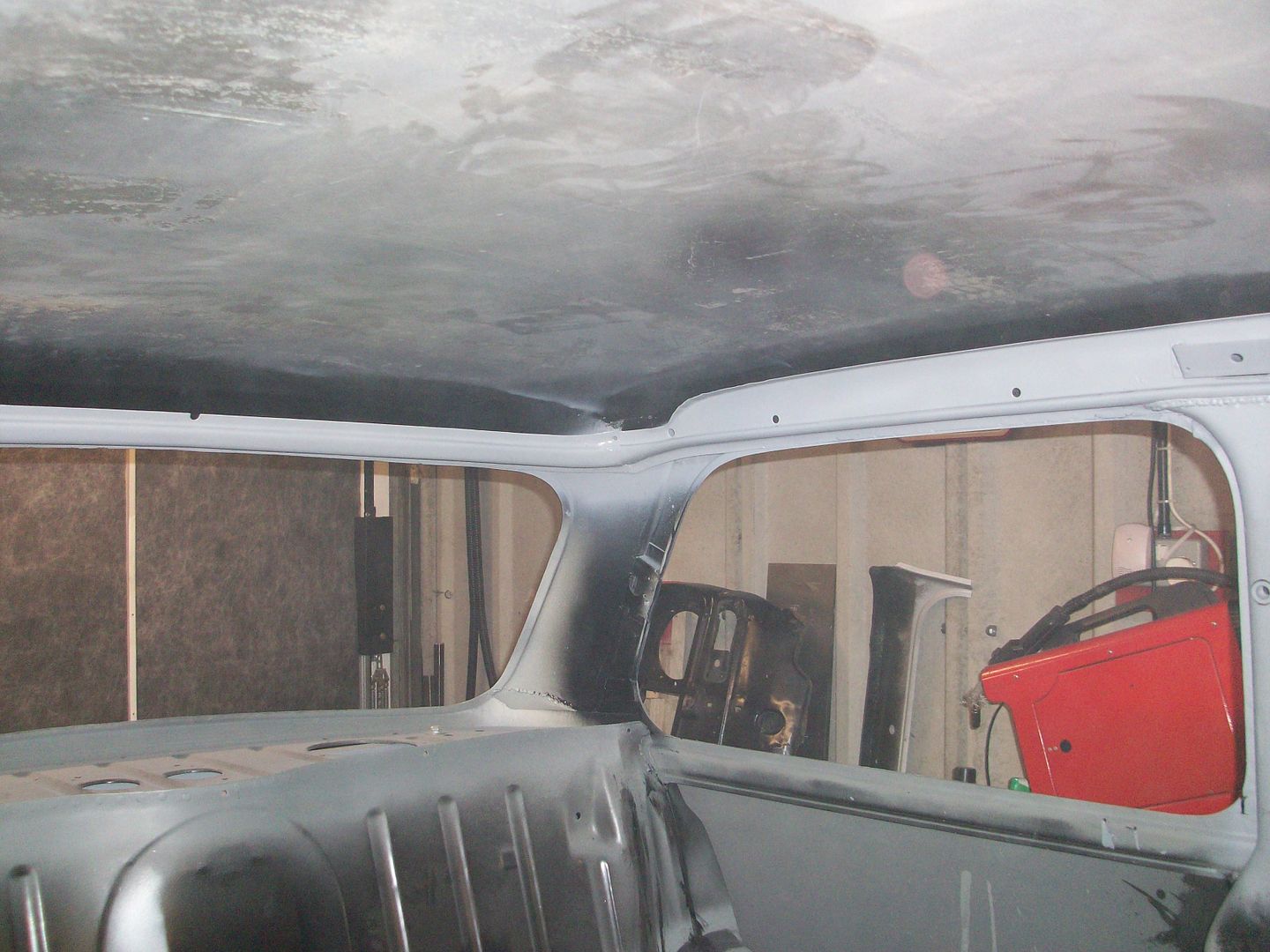

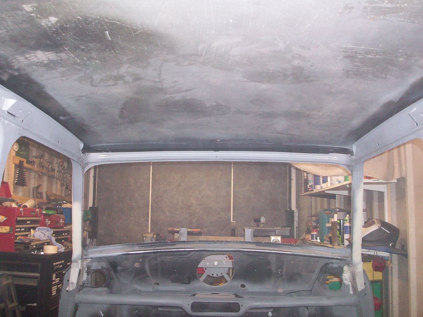

Also gave a coat of epoxy primer to the roof area behind the cant rails.
Repairs to the both the front of both the side cant rails.
After priming the cant rails with several coats of primer they had a few coats of black paint.
Repairs to the tops if the A-Pillars.

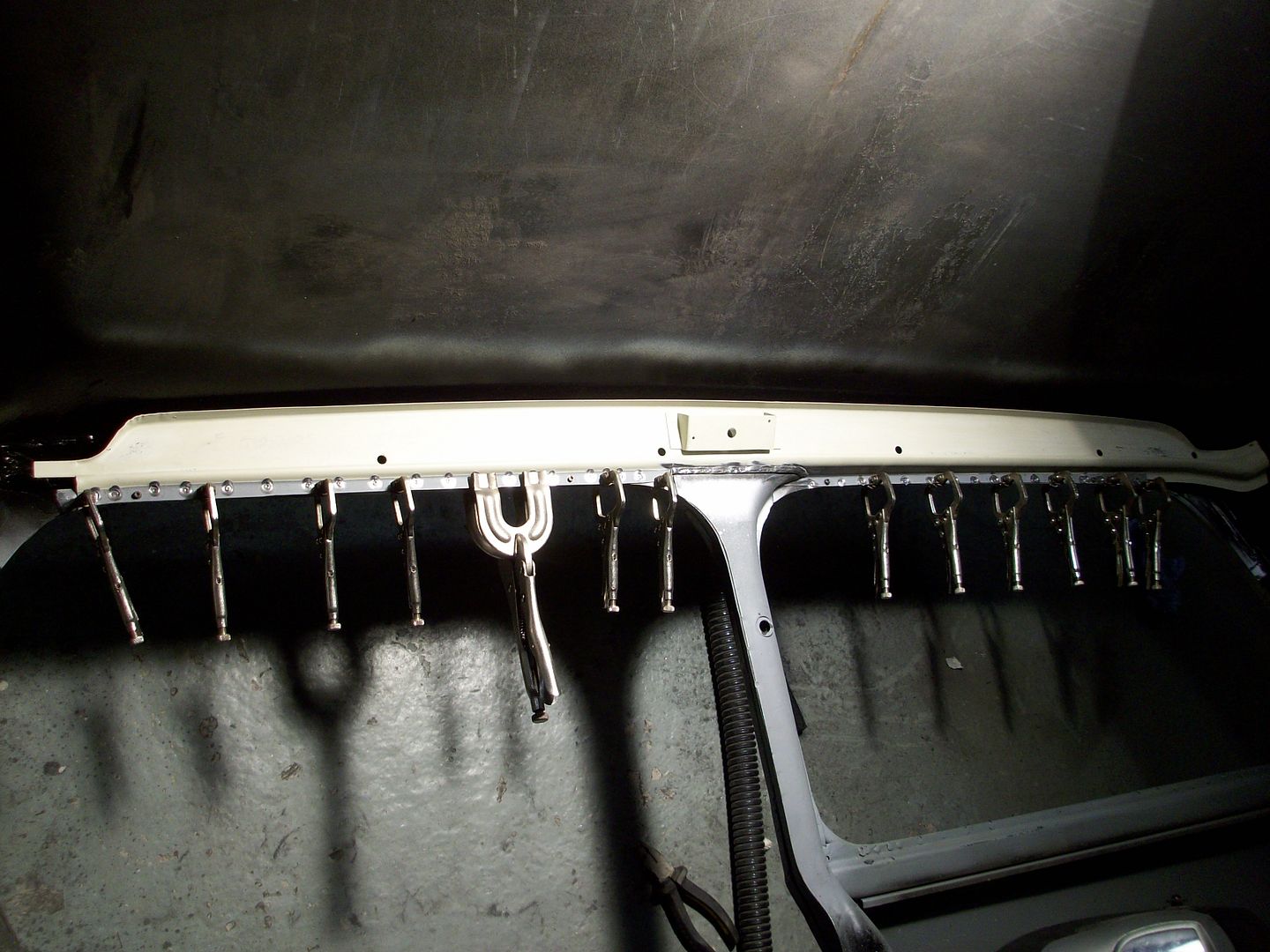

Cant rails welded back on and a couple of coats of primer to finish.
A couple more of the jobs off my list.
Ger

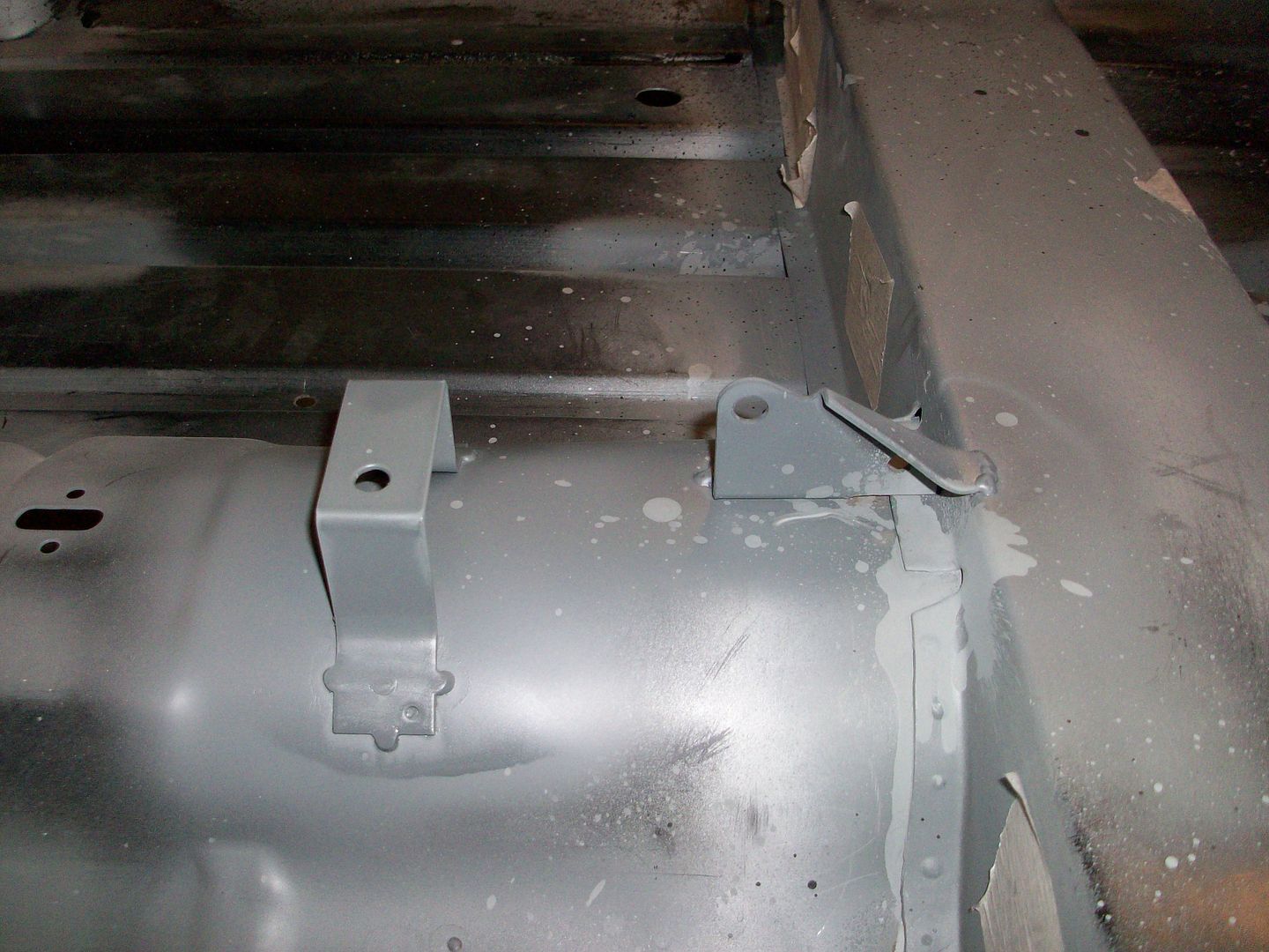

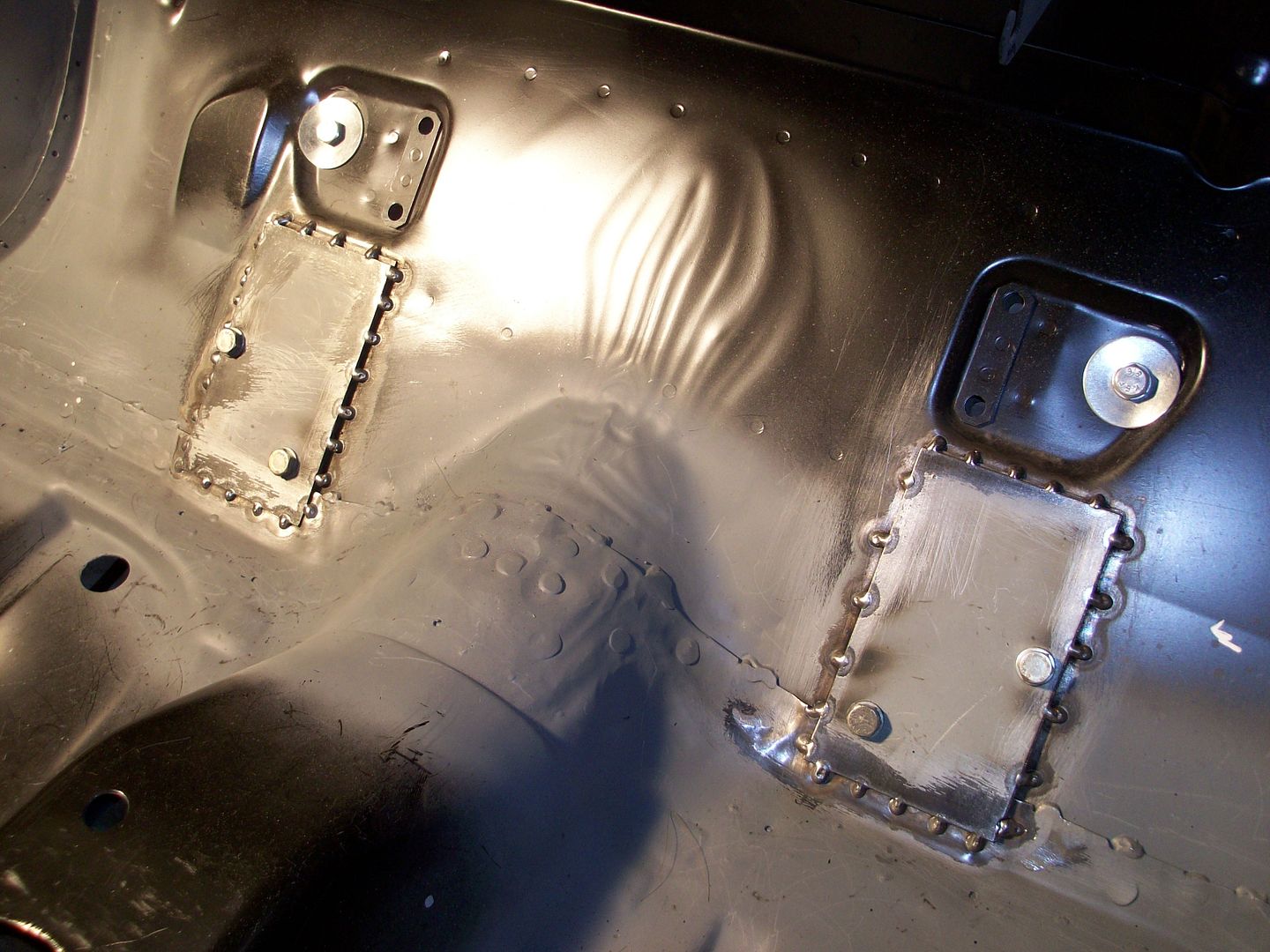

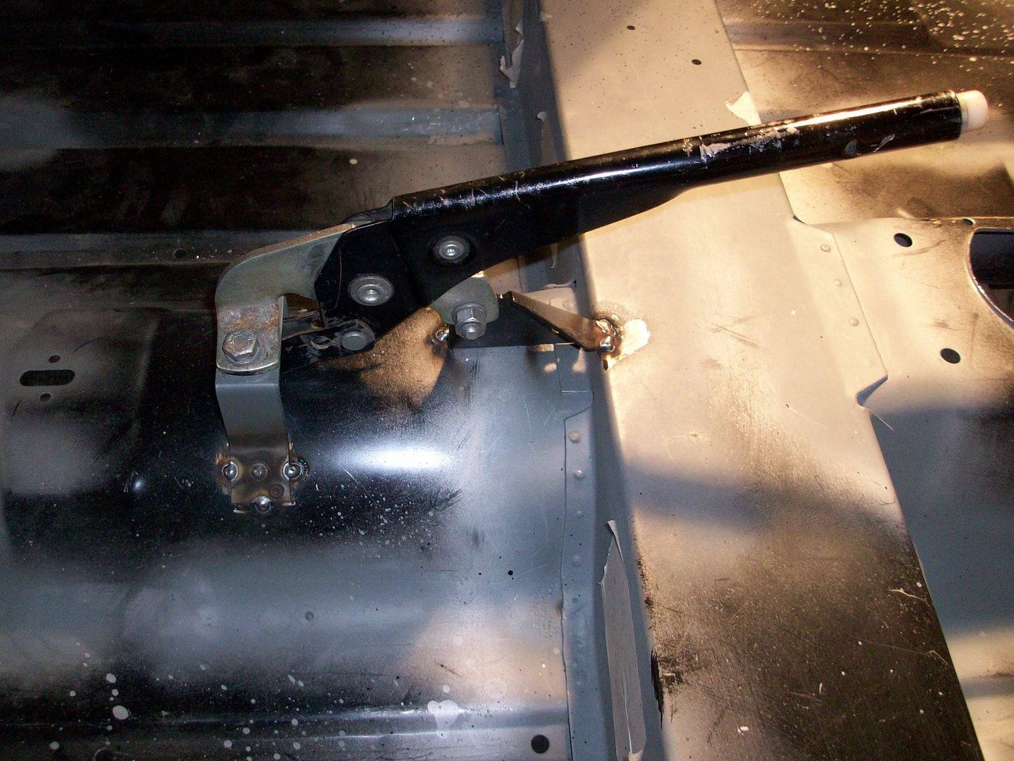

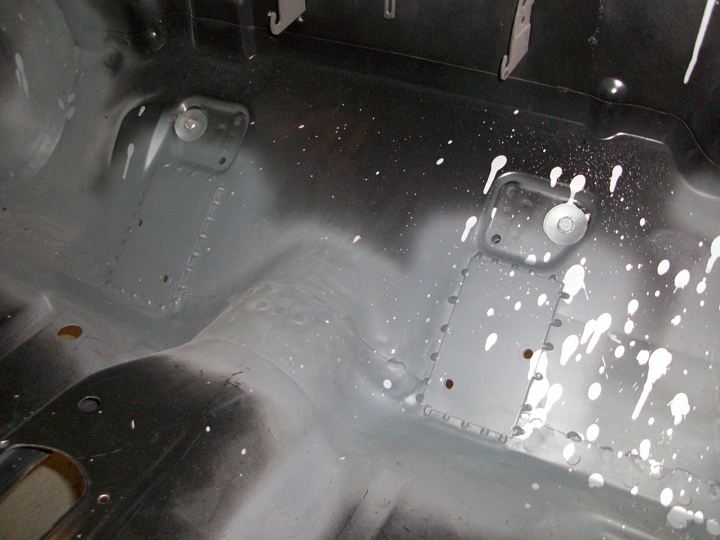

Just a couple of jobs this w/e.
Welded in the handbrake mounts.
And made a couple of reinforcing plates for the front subby rear mounts from 3mm steel as the old girl will once again have solid mounts on the front.
With a coat of primer.
Like I said not a lot this w/e but another two jobs ticked off my list.
Ger
